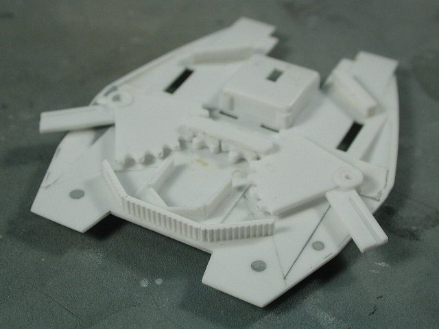

This shot shows the corrugated "fencing" I put in (with styrene bought from a local train hobby store - comes in sheets) so that you don't see into the fuselage. I originally fitted the Valkryie against the booster packs to get a tracing of the swing wing's inner most swing extents to get the line to glue these styrene strips to. I was too cheap to use the PE parts that Hasegawa provides for this area. :D

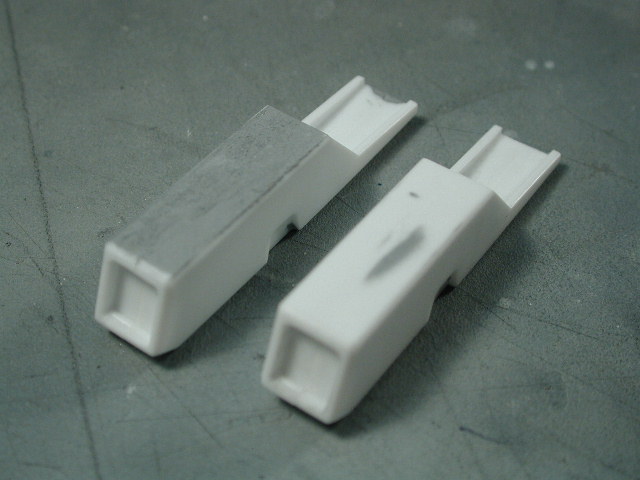

Hmm, the new boards handles attachments differently now (is there a way to get it to show like the old way - instead of clicking on them and having them open in a new window?) or do you guys prefer this way?

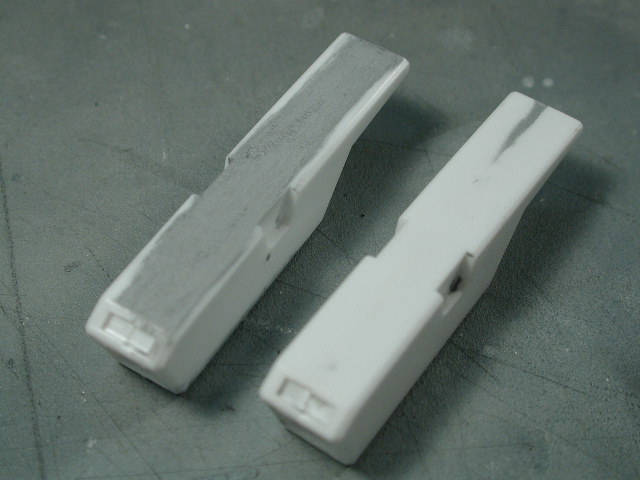

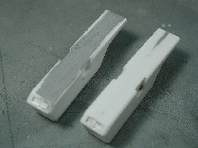

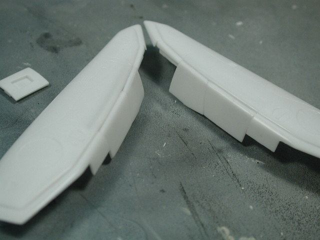

Anyways, the arms are show below, with the left before the sanding (a little overkill on the tamiya putty - but there are some severe elevational differences sometimes especially with flat parts) and the right after sanding (you see most of it is sanded away, but there are a few sink holes that remain)

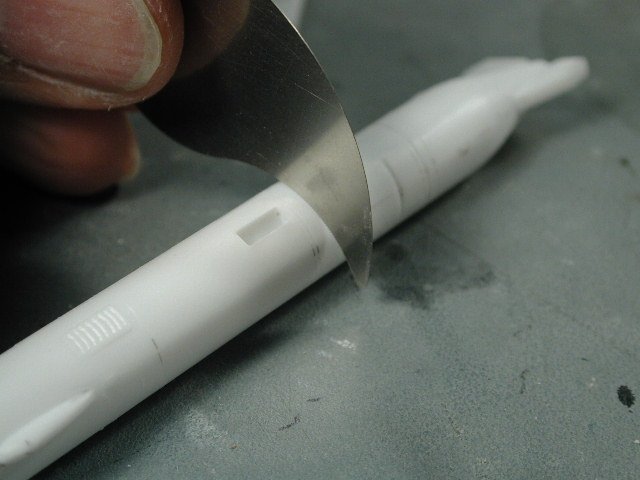

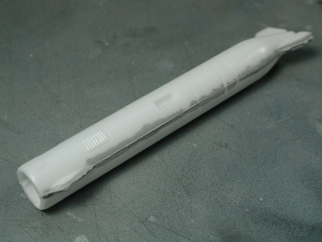

Here's the gun pod - originally glued together last year (with excessive glue so that it oozes out to fill in minor seams) plus I "painted" Mr. Surfacer 1000 to make sure its all sealed in. I intend to use that Alclad metalizer here, and its very unforgiving - any blemishes and it shows!
Link to comment
Share on other sites

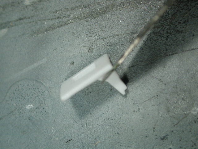

Here's the same seam after sanding (notice that I took most of the Mr. Surfacer off - its almost used as a marker for me, especially on white plastic of how far I still have to sand down to the seam). I'm using the Hasegawa PE micro saws to "re-etch" the circular panel lines that have been lost due to the sanding

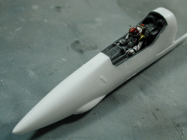

Here's the nosecone forward fuselage - the part I spend the most time sanding. The nose seam has to be perfect - its the thing most people (incl me) see first on the model. I followed the same technique as most of my other pieces - put a little more than needed tube cement on the seams so that some of it oozes out (becareful to not put too much - otherwise the cement may continue to melt the styrene and cause sink depressions) and paint the seam with Mr. Surfacer 1000.
I sand down until the entire seam dissapears and that you can run your fingernails across the seam and its perfectly smooth.

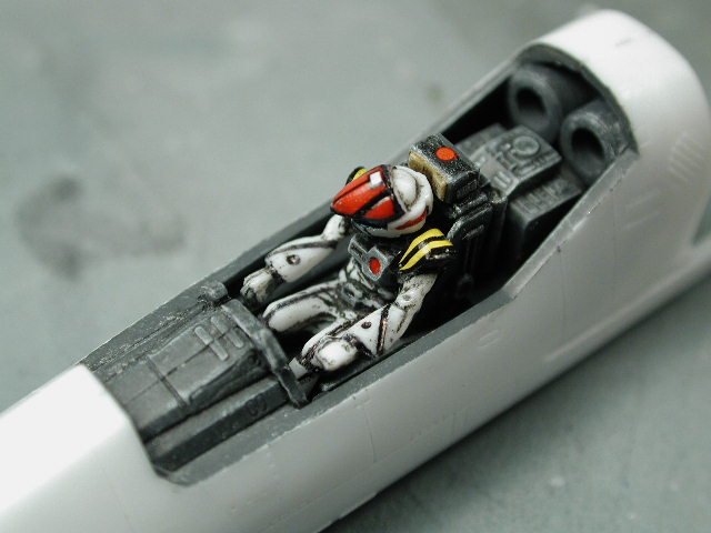

I then washed the assembly, decaled the pilot and cockpit control panels and gave both a bit of white dry-brushing to highlight the details (I did a dark wash last year that picked out the crevices). I'm not going to go overboard on this, since I intend to keep the canopy closed, and with the distortions in the canopy, not real details can be seen. Ok, I've started to cut corners on the cockpit... I rather spend the time on detailing the rest of the Boosters. And yes I know, its the wrong pilot - I'm a bit impatient, and I've really been wanting to see this Booster kit on my display shelf for over a year now - so I thought if I corrected the pilot for the TV-version, that itself could take a week or at least a few days - plus sculpting such small collars is not my strong point anyways. Plus I like the DYRL pilot suits so much better than the disco collars! :D

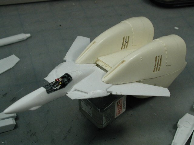

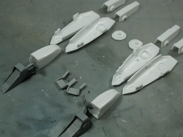

I thought I'd dig out the pieces required for the legs and do some pre-assembly to see how this thing all comes together to fit with the resin Boosters.
It was so nice for the captain to provide us with the forward intakes so nicely casted allready assembled without the seam. I intend to wash all the resin pieces soon (before I work with them) but I need to go out and by Comet first - its a good idea to scrub all resin pieces with a toothbrush and Comet & detergent to remove any mold release agents that always come with resin kits.
Link to comment
I just couldn't resist - I had to piece something together before I could leave the table for today! its looking good so far...
I still intend to make the Valkryie removeable if I can help it - well see if that's possible, but so far its seem as though the Captain has made such a perfect fit that I might not need anything - friction my just do the trick. We'll see when I get the legs together - theres a large chunk of resin I have to remove to get the legs and feet into the Boosters. Plus there's a bit of clean up on the Boosters themselves (my cast had a few bubbles in the vents and forward part of the Boosters that needs to be filled and sanded first)

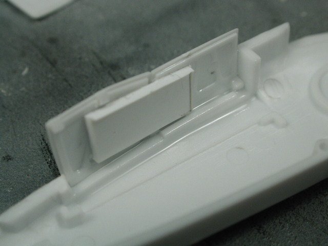

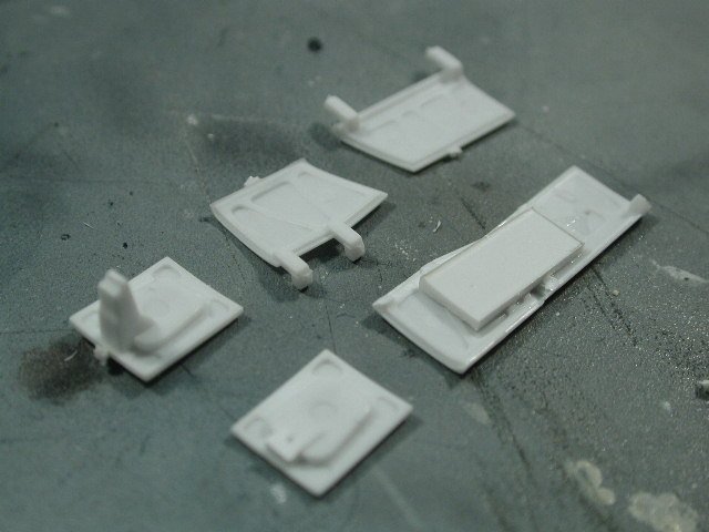

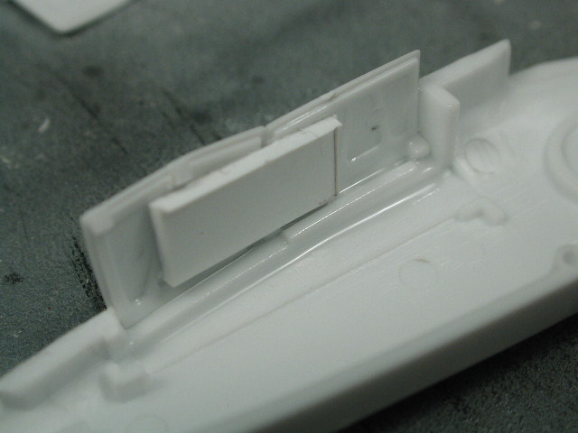

Closing the rear landing gear doors - there's no right way to do this, I've done it differently on every one of my models, but with each one, I use less and less re-inforcing. I always glue the doors together first with a styrene strip in behind for reinforcing, since the actual edge of the doors isn't enough meat for the glue to properly work with.
Link to comment
Then I glue the doors to the side of the leg that has a portion of the door round over - this side is more important than the otherside because its pretty crutial to get that reveal seam as smooth as possible.
I add some liquid cement to the backside to fill in the gaps.

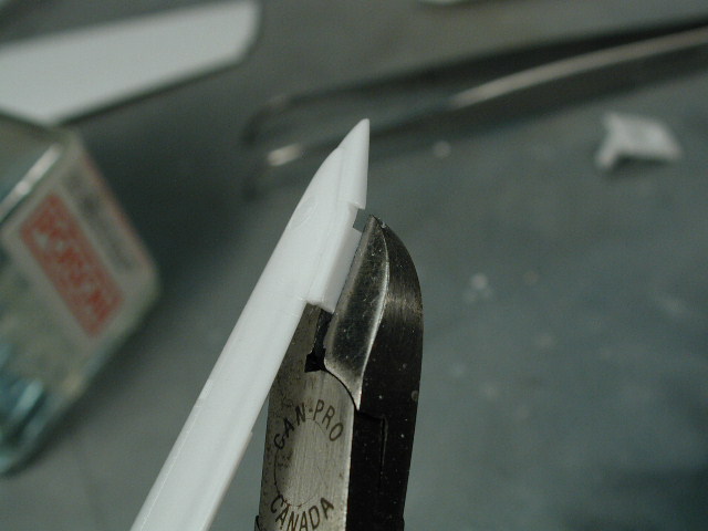

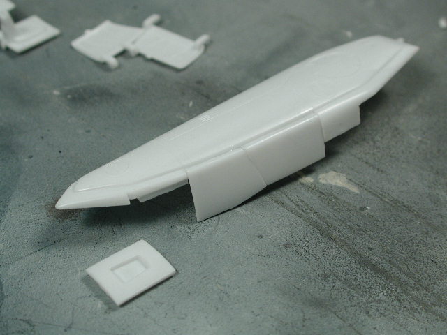

The forward doors are a little bit tricker. I used to just shave back the bump behind the door to get a nice flat door that will lay in flat against the leg opening - but that often hampered the mounting of the green/red leg lights later on. So I decided to cut away the leg portion of the mounts and allow the forward doors to seat in complete with the light housing.
However I still have to cut the support leg off each of these forward doors.
Link to comment
Here's a shot of the two leg halves with the gear doors glued in. The doors are not correctly molded to the curvature fo the legs themselves - but its nothing that a final sanding won't cure.
The forward gear doors are left off until the two halves of the legs are glued together, they still needs to be shaved down a bit for a better fit. And I can't glue the two halves together until I spray and finish the feet/afterburning cans.

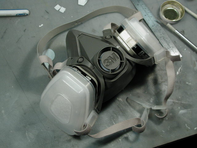

Safety first! I've been wanting to build a proper vented spray booth for years now, but in the meantime, I'd make do with a facemask. I've been spraying with my airbrush for years without any kind of protection, but January 16th of this year, my best friend Dan Lee died of lung cancer at the age of 35. He never smoked a day in his life and lead a very healthy lifestyle. However, we've been building models since highschool - and breathed all kinds of crap into our lungs - we were young and invincible! He was convinced that it must of been the chemicals we've been breathing in. Especially laquers which is an organic compound and highly toxic. So in lue of a proper spray booth for now, I implore you to use a proper facemask. I used to use the filterpaper mask that goes over your nose and mouth, but it didn't form a tight seal around the face. After consulting with our scenic artist, he swears by this mask from 3M which I highly recommend. There are replacable filter cartridges on either side for organic compounds filter 6000 series. So please, even if you have a spray booth, it might be worth considering this mask as well. Especially when we spray not only laquers but the Alclad metallizer stuff with real metal particles in a laquer suspension - double whammy!

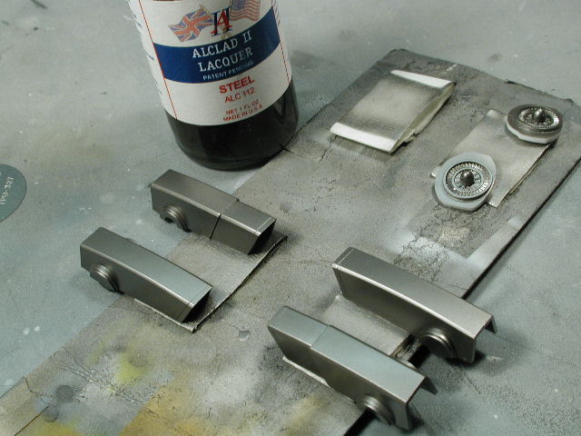

Here's a shot of the foot/nozzles, make sure to carefully sand the sprue attachment points with a fine 600 grit paper, these Alclad metalizers are very unforgiving and any scratches and blemishes telegraph through.
