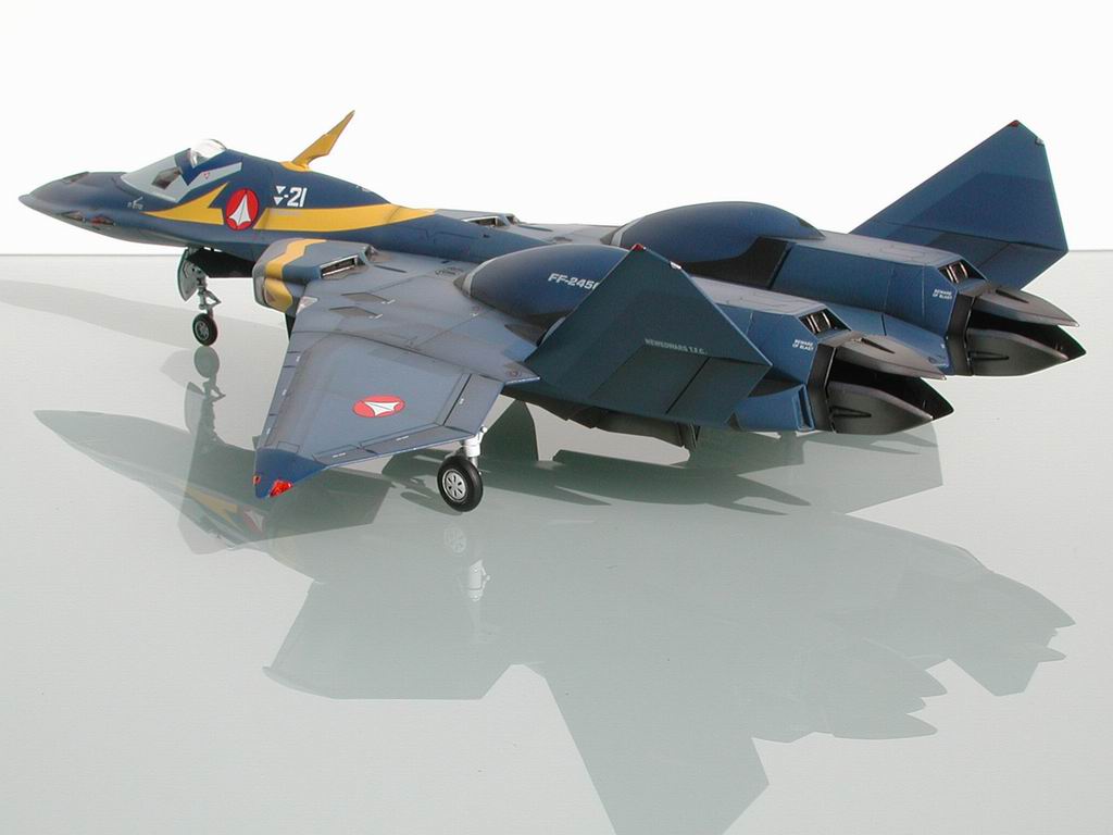

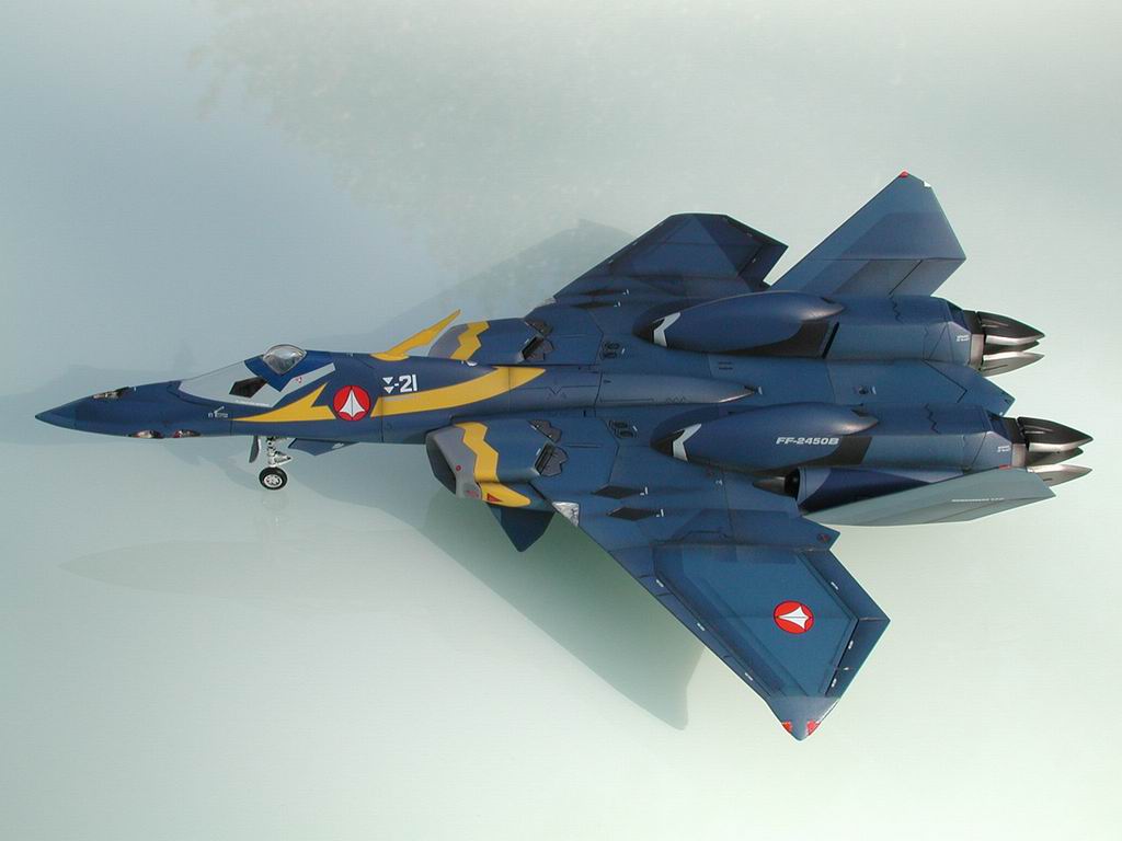

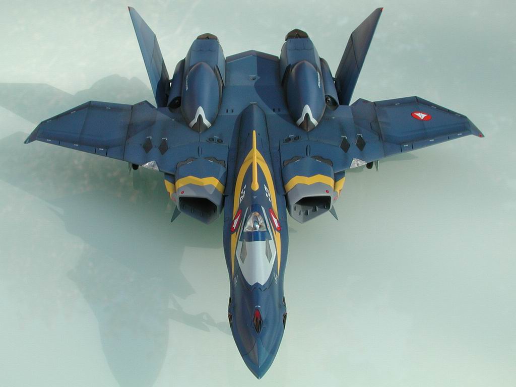

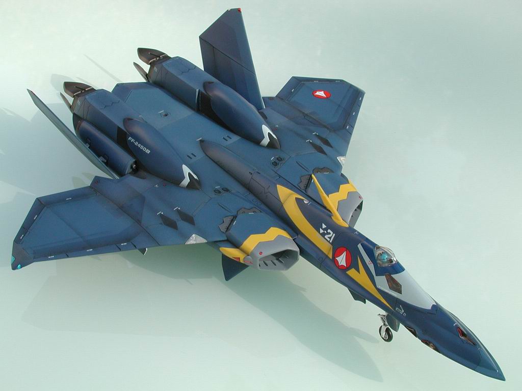

wm cheng Posted October 9, 2003 Posted October 9, 2003 Hey all, I've finally finished my YF-21 - and I've got sun today. So here goes...

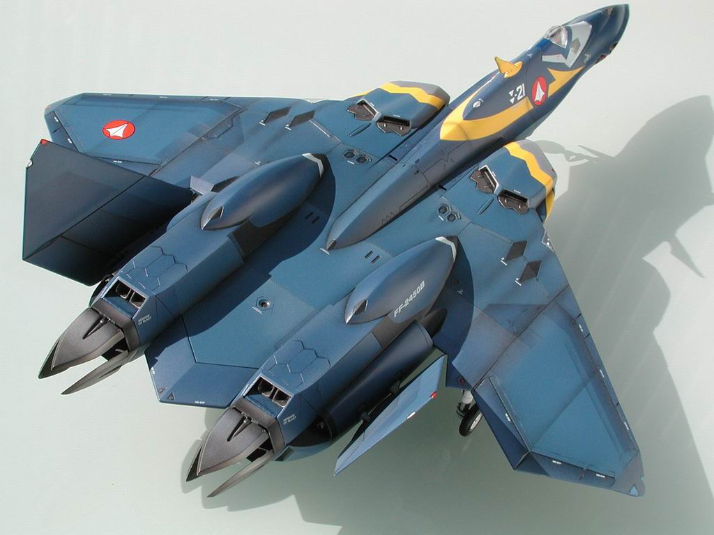

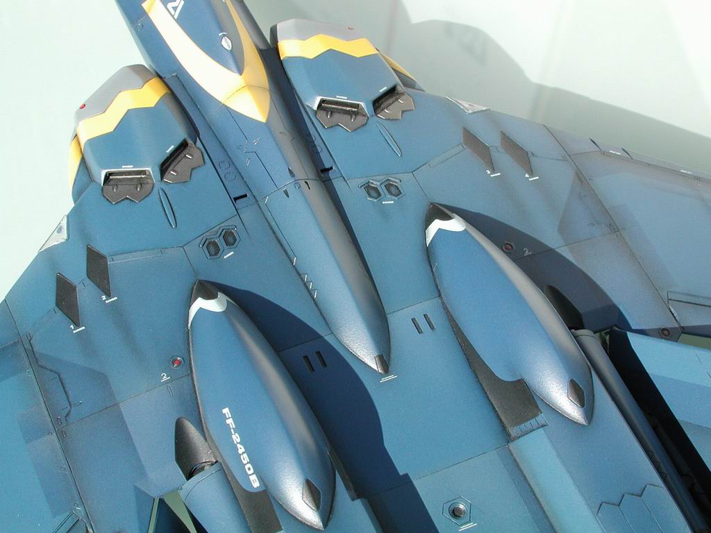

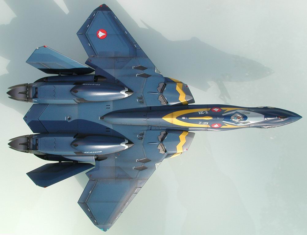

wm cheng Posted October 9, 2003 Author Posted October 9, 2003 Detail shot of the back plate - I'm pretty happy with the subtlety and smoothness of the finish - unfortunately the photos don't really show it.

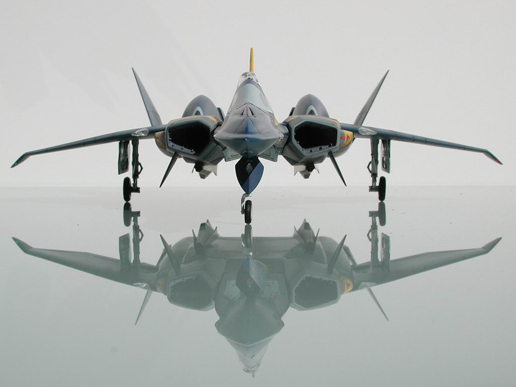

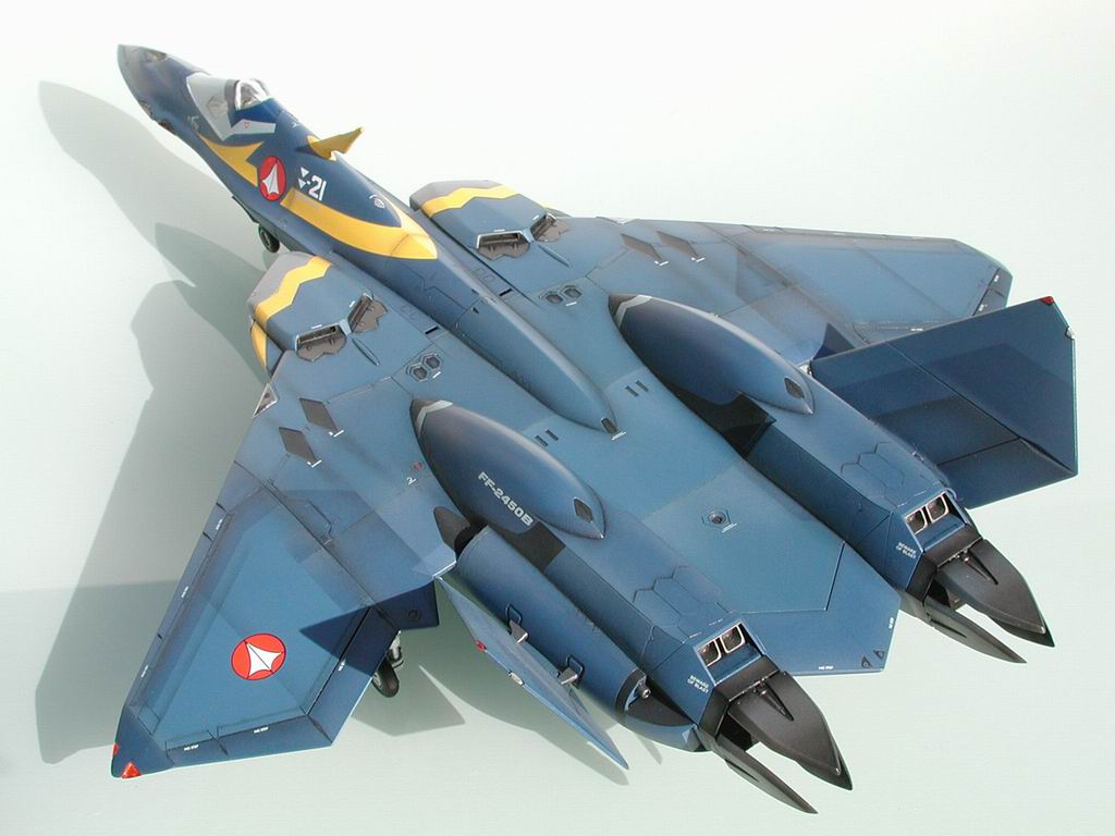

wm cheng Posted October 9, 2003 Author Posted October 9, 2003 Making our way around... The rear rudder/stabilizer and vectoring fins are still fragile after construction - I think the connection points are just too small and weak.

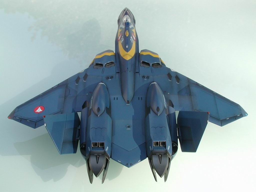

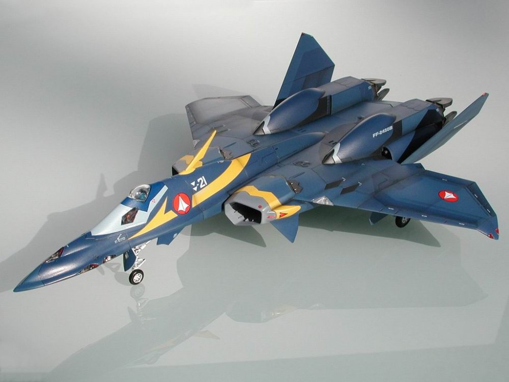

wm cheng Posted October 9, 2003 Author Posted October 9, 2003 Rear shot - a little wear but not really battle worn

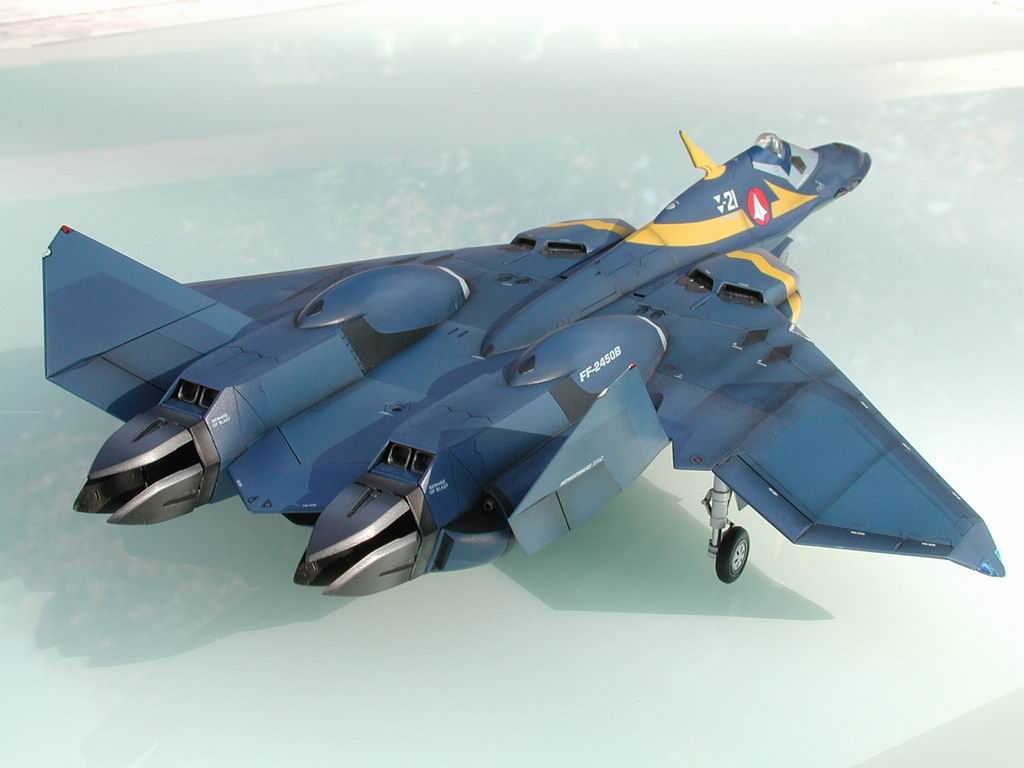

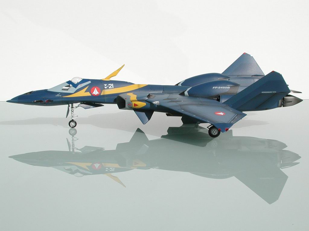

wm cheng Posted October 9, 2003 Author Posted October 9, 2003 Head on... I never knew the YF-21 had such a nice front silouette.

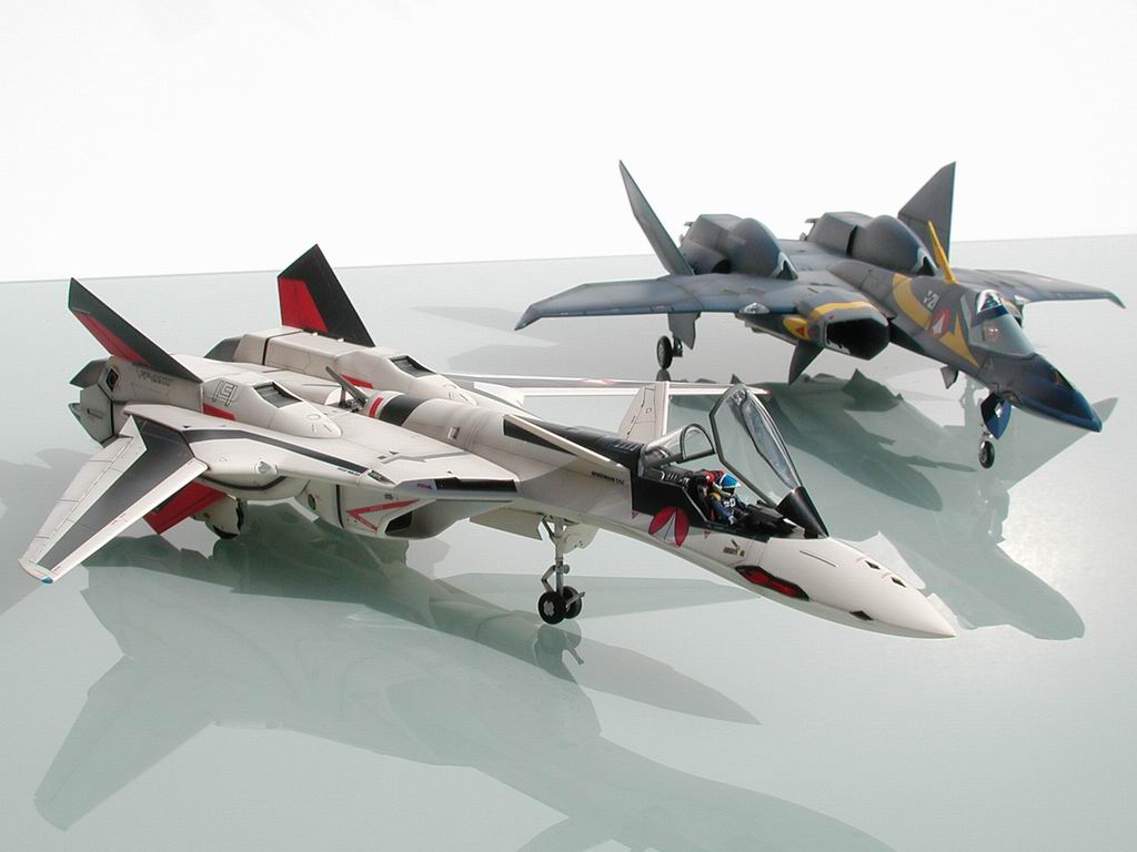

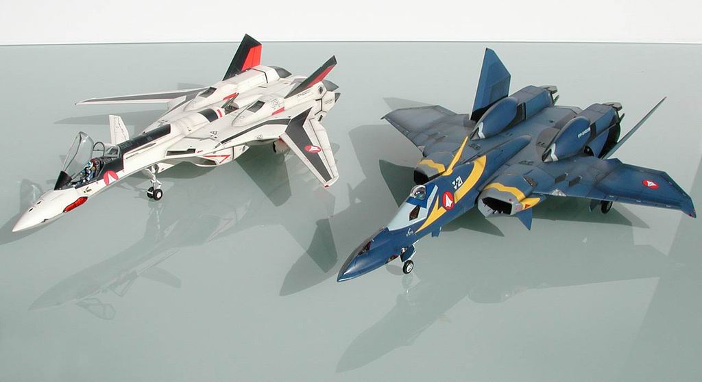

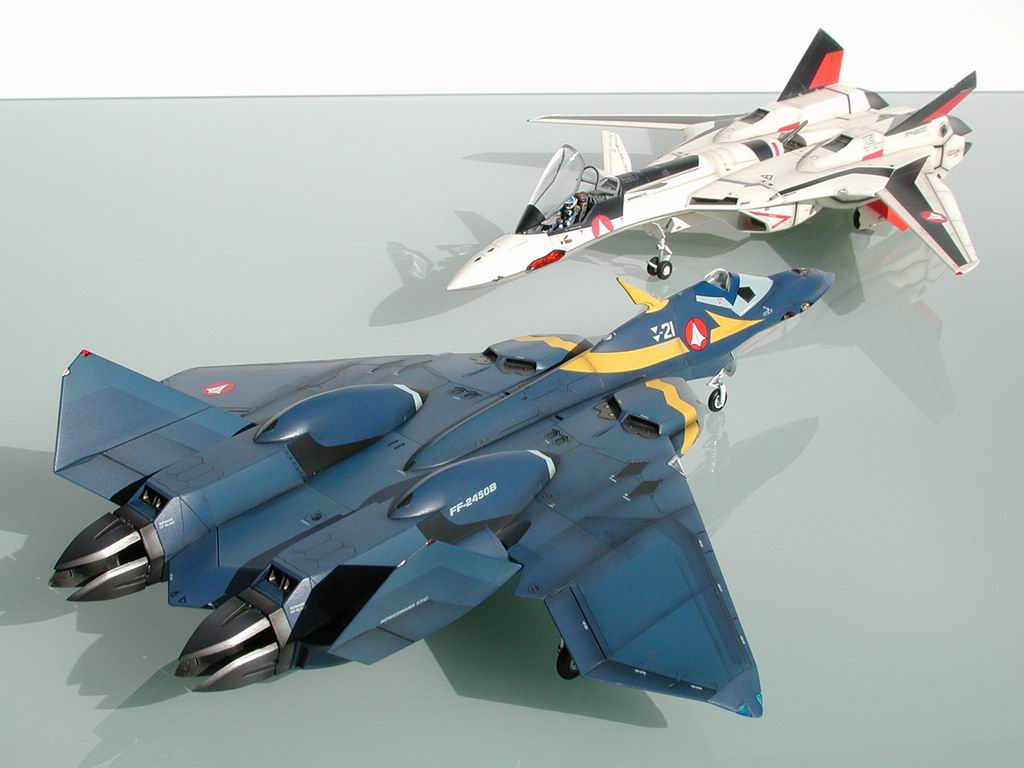

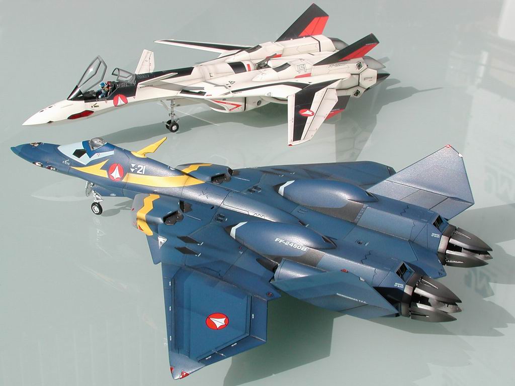

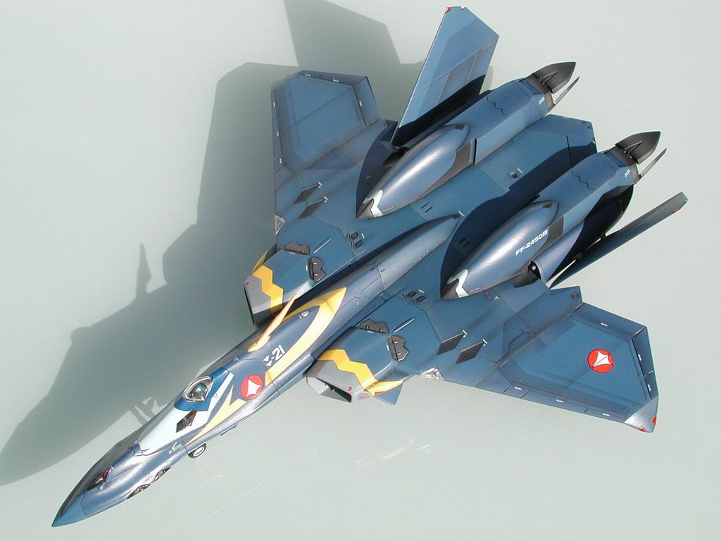

wm cheng Posted October 9, 2003 Author Posted October 9, 2003 Okay, everyone is asking for shots with my YF-19.
wm cheng Posted October 9, 2003 Author Posted October 9, 2003 Side by side - its still tough to make the blue scheme convincing.

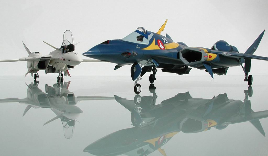

David Hingtgen Posted October 9, 2003 Posted October 9, 2003 I still want to see you do an F-14/15/16 in 1/72 for some scale comparisons. Also--quit fretting about making the deep blue paint look convincing/real, it exists in real life:
David Hingtgen Posted October 9, 2003 Posted October 9, 2003 Best color shot I took: (and #4 is piloted by a fellow Iowan, BTW)

rocco_77 Posted October 10, 2003 Posted October 10, 2003 wm cheng, you are just amazing..... That is one beautiful job on the -21. THANK YOU for not making it PURPLE! I love the shading you put into the wings and rear stabilizers. The striping effect really adds a wonderful detail to the finished piece. And you are right about the front shot. VERY menacing! Just amazing work. B)

J A Dare Posted October 10, 2003 Posted October 10, 2003 Please any and all criticisms welcomed - thanks for tuning in. Hey Wm, you've built such a beautiful bird, I love it. However, there are 1.5 things that kind of bother me. 0.5) The canopy decal. When direct sunlight shines on it you really see the difference in blue on top of the canopy compared to the fuselage blue. You see this in your first 2 photos. However, in other angles it blends pretty good. 1.0) For some reason, the gray color of the intakes make them look "plastic." I noticed this in your front birds-eye shot. Maybe a little more weathering would make them look more real? Or are they suppose to be that color?

wm cheng Posted October 10, 2003 Author Posted October 10, 2003 Thanks for all the kudos Hmm, the canopy blue still bothers people eh? I might do something about it - the jury is still out on this one yet - but if I have time next week, I try to blend it in more. I don't think I'll be doing a Mila red version anytime soon - the blue bothers me a bit - it really screams out anime in my flight line up, and I think the red would be worst. Thanks David, for showing me the blue angels, they make me feel a bit better. Very good tip about the tires, I remember I used to heat a screwdriver over the stove and lightly press that against the tires to melt them into a flat spot with a bulge. But David also made a good point about the high pressure modern tires. If I revisit the canopy colour, I may just file down an area of the tires to simulate this effect (Damn, it means I have to take the pictures all over again ). It would of been better if I filed down the tires before I glued them to the struts, this way you can ensure they rotate properly to the flat spot - but now, I'll have to be very accurate as to where the flat spot will be. Yes by all means you can weather after the decals. I weather before and after the decals. I weather before so that if I make any mistakes or do it too heavy, I can go back and remove some. Then after the decals again, to tie it more to the paint and re-do some of the panel lines. Unfortunately there are not much panel lines that crosses over the decals on this bird, and the demonstrator scheme precludes too much weathering. I don't know what you mean about the intakes - I guess they are a little flat. I airbrushed around the leading edge with a lighter grey to simulate wearing and give it a little shading - but I wouldn't know what else to do. They are darker than they are supposed to be - I painted them in neutral grey instead of sky grey. I knew they were too dark as a match for the grey of the decals, but I thought the decal grey is too light and thus too jarring for the dark blue, so I darkened them to tie in better with the blue body. Thanks, the comments have been most helpful.
