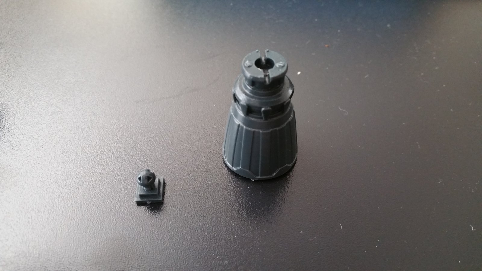

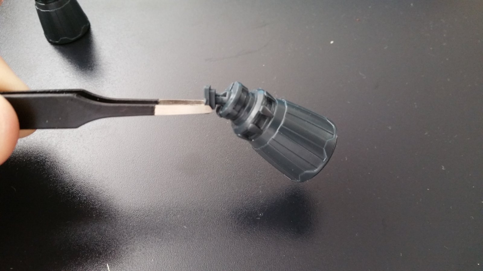

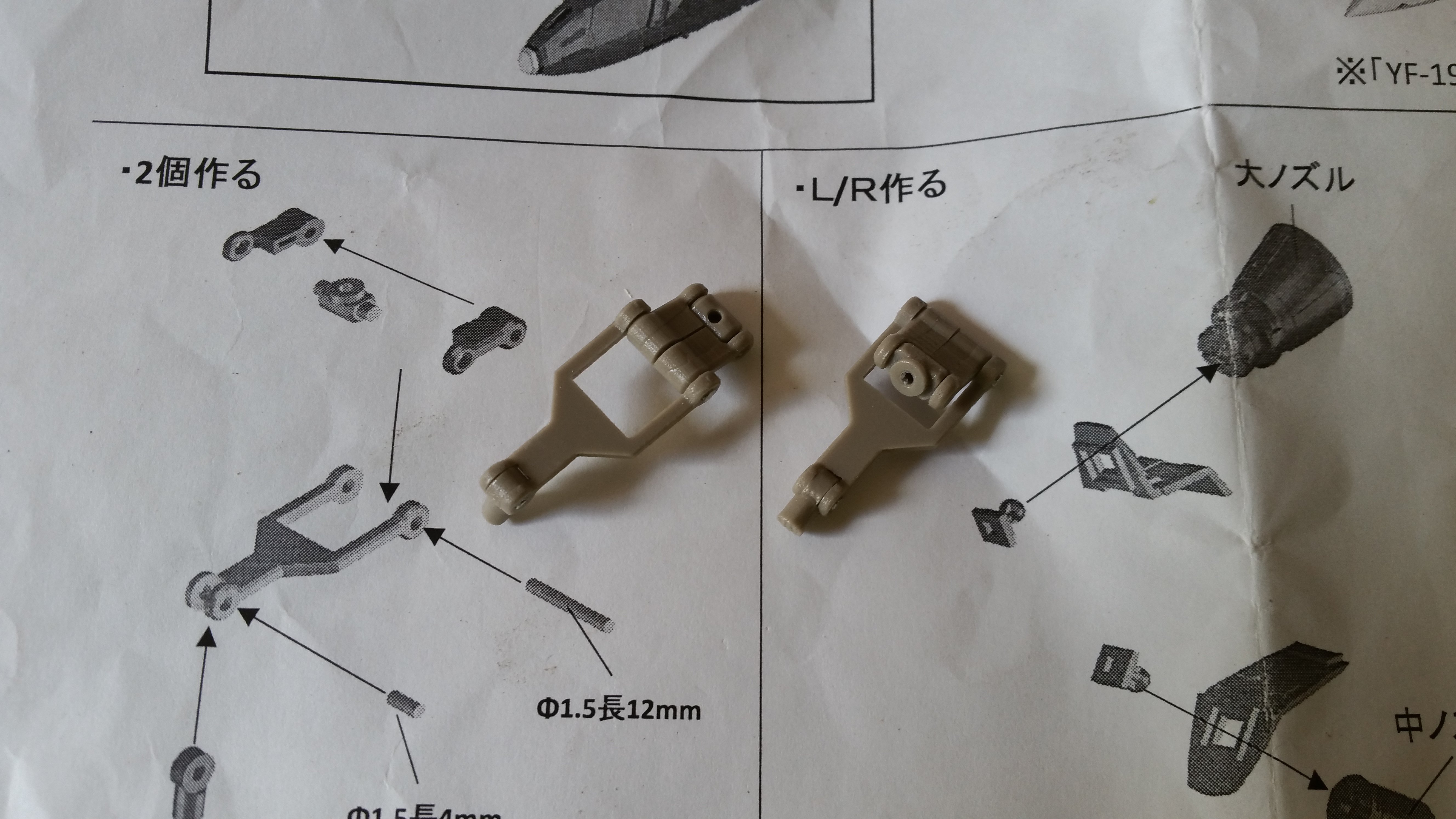

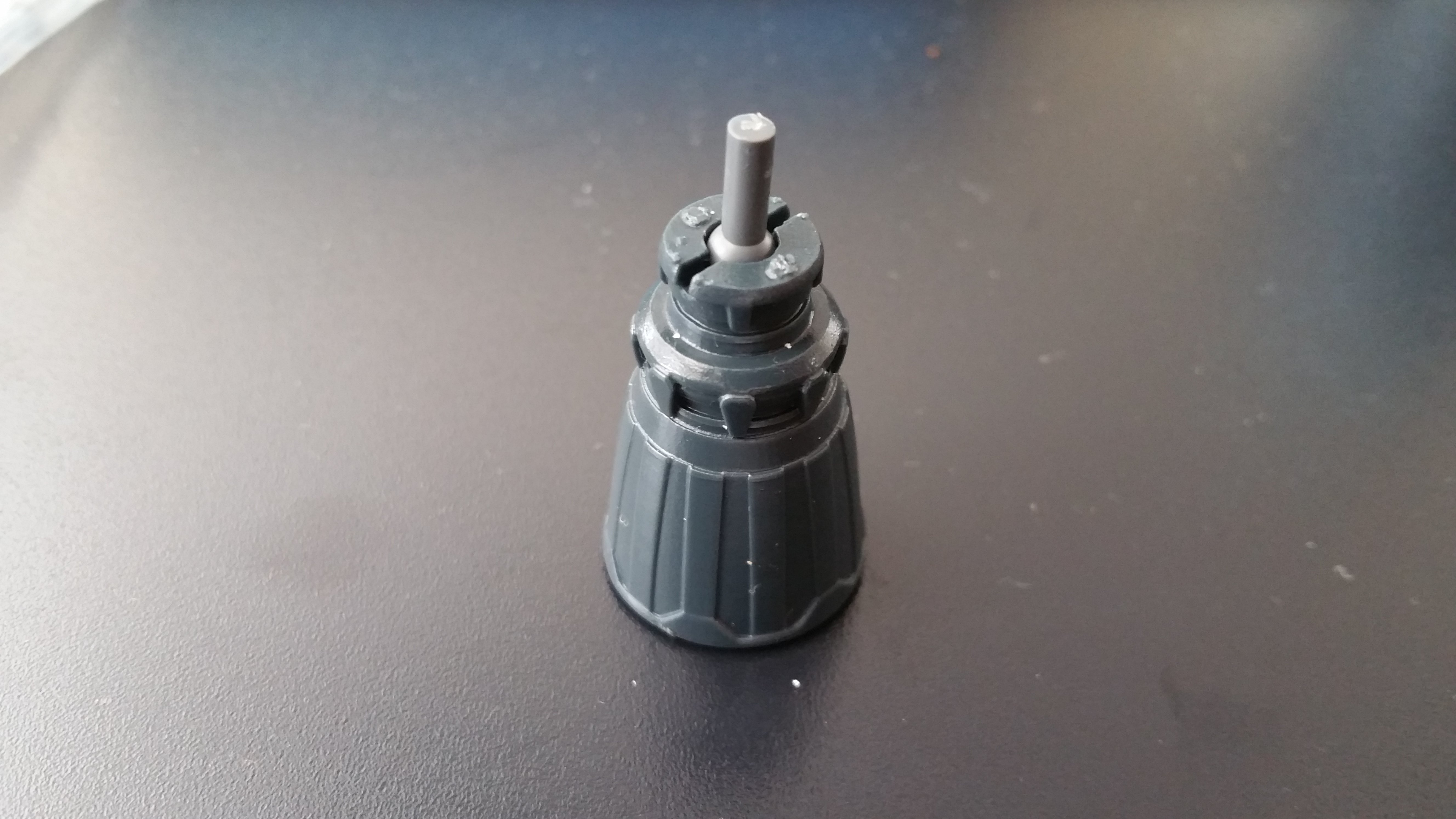

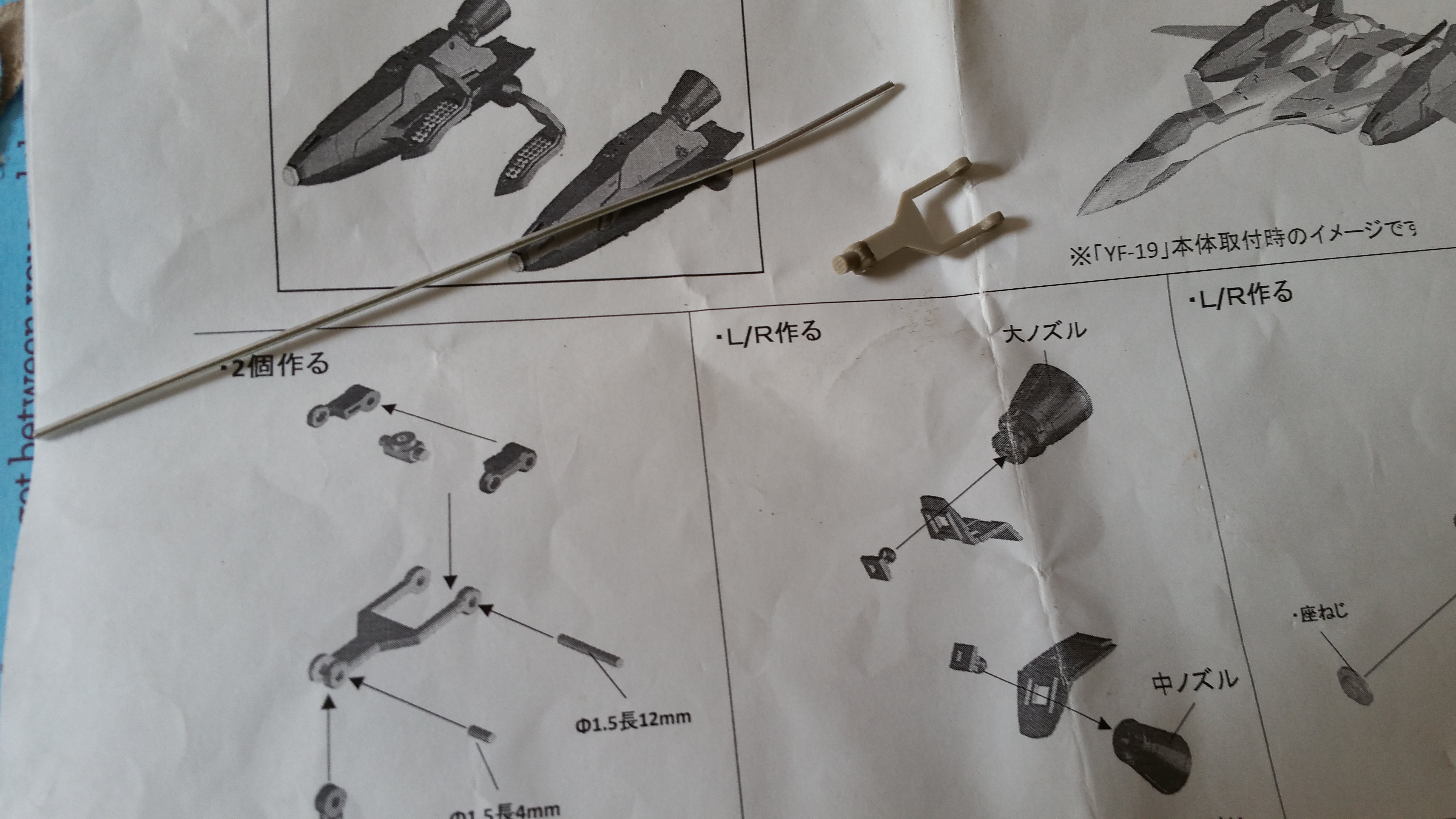

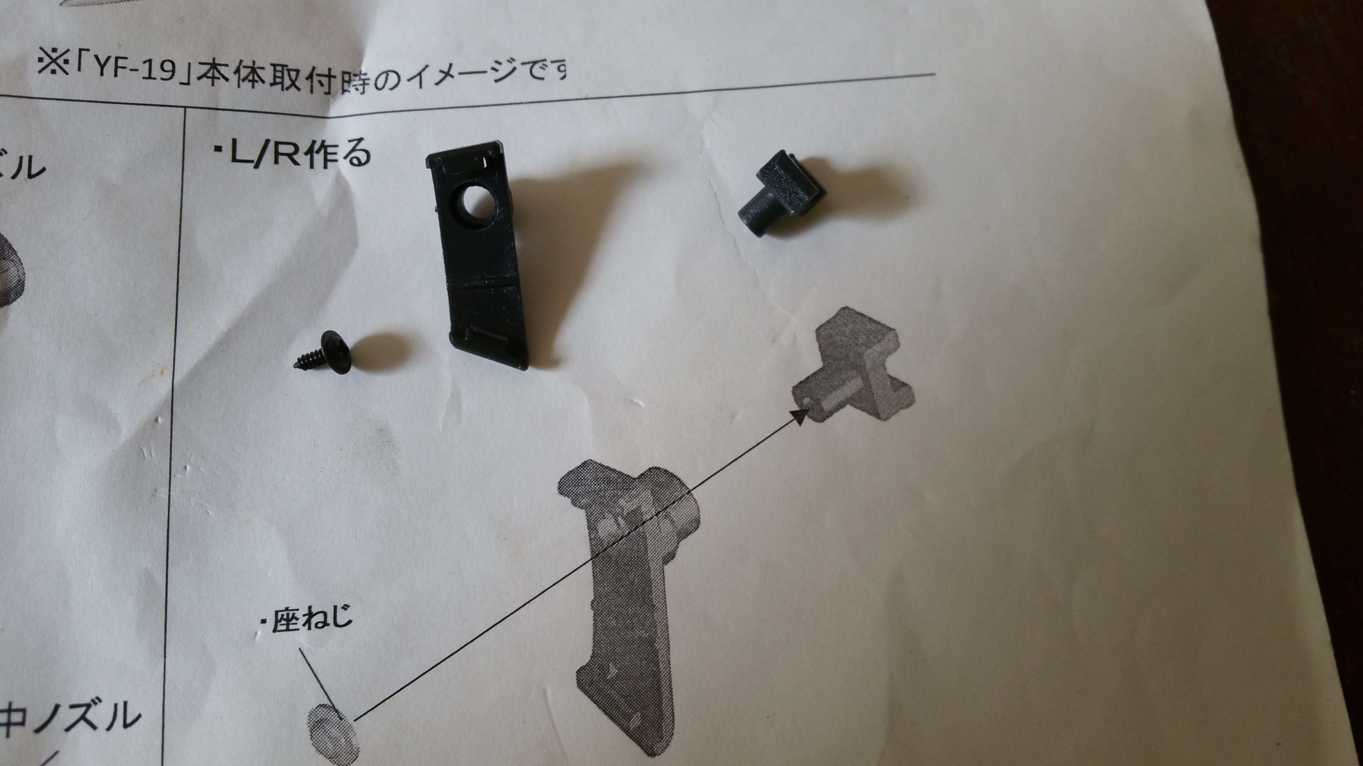

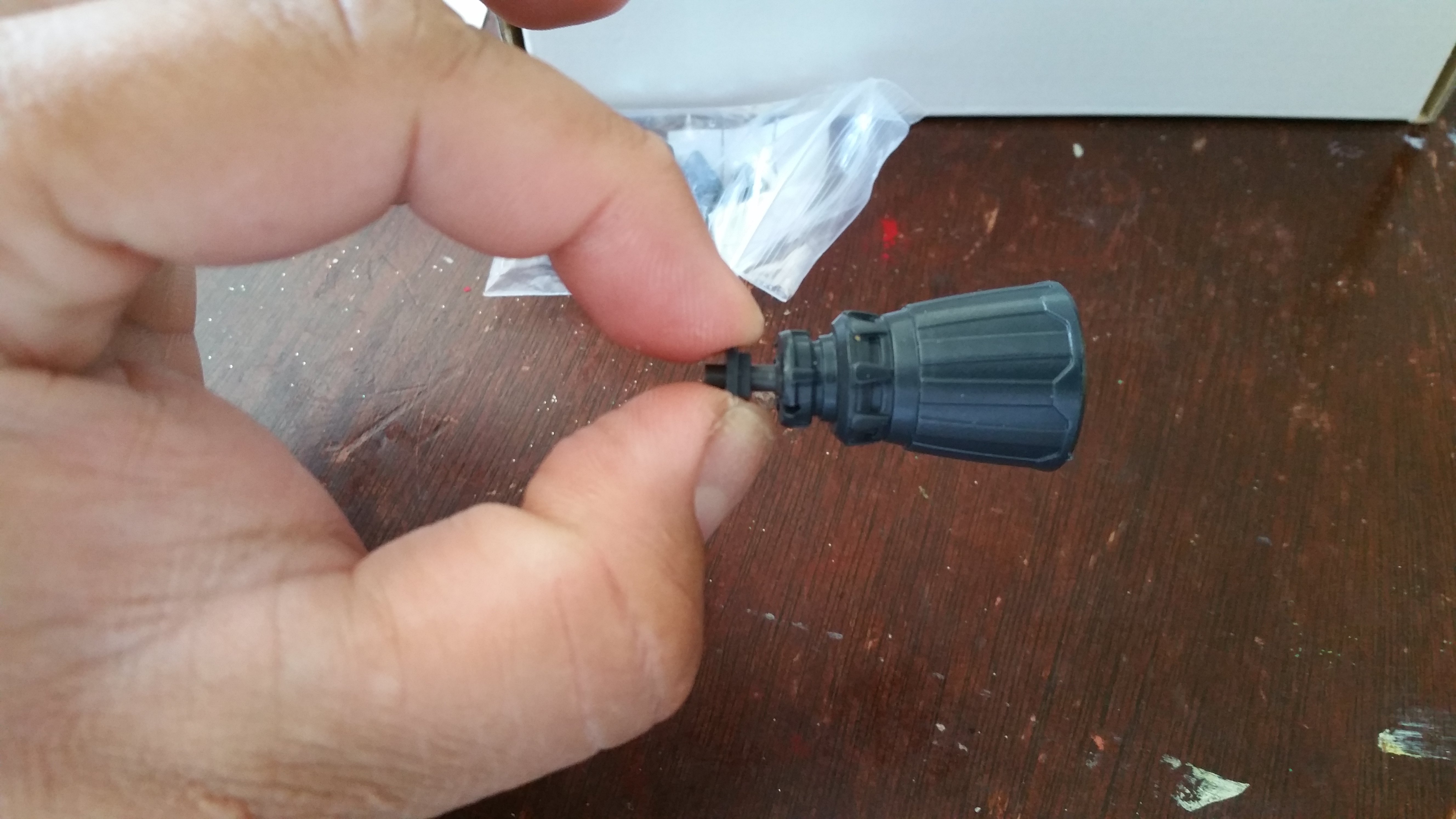

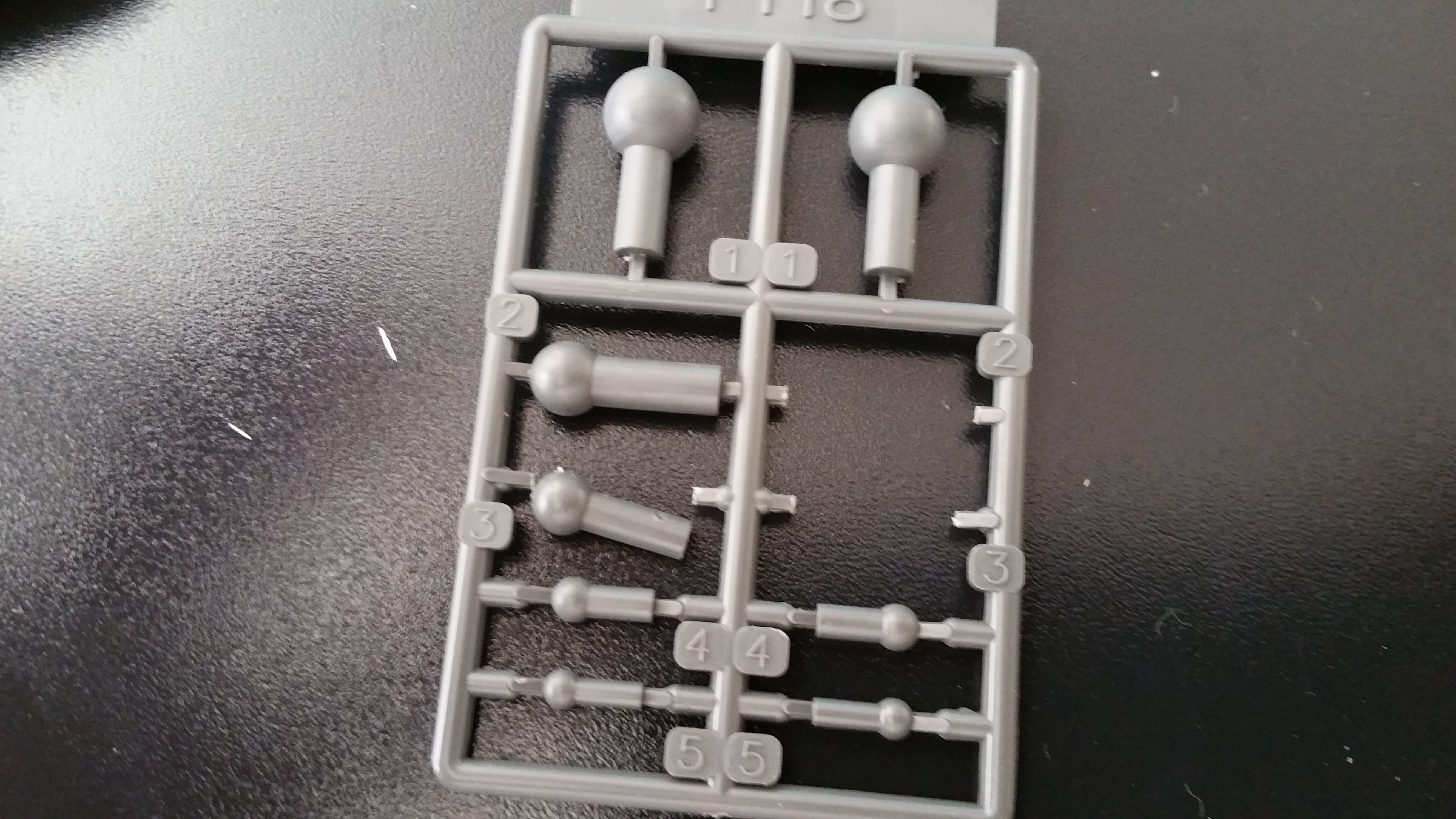

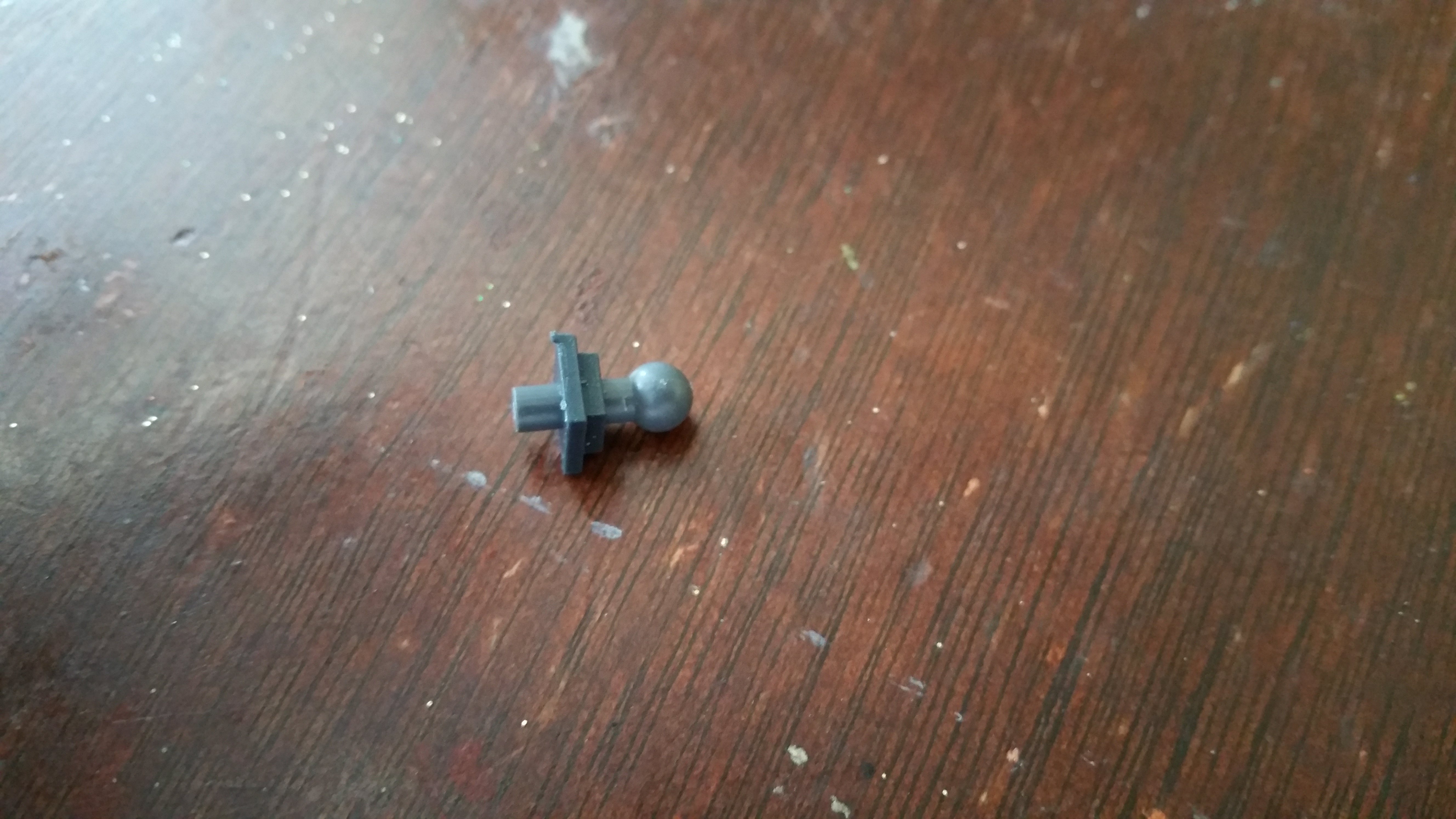

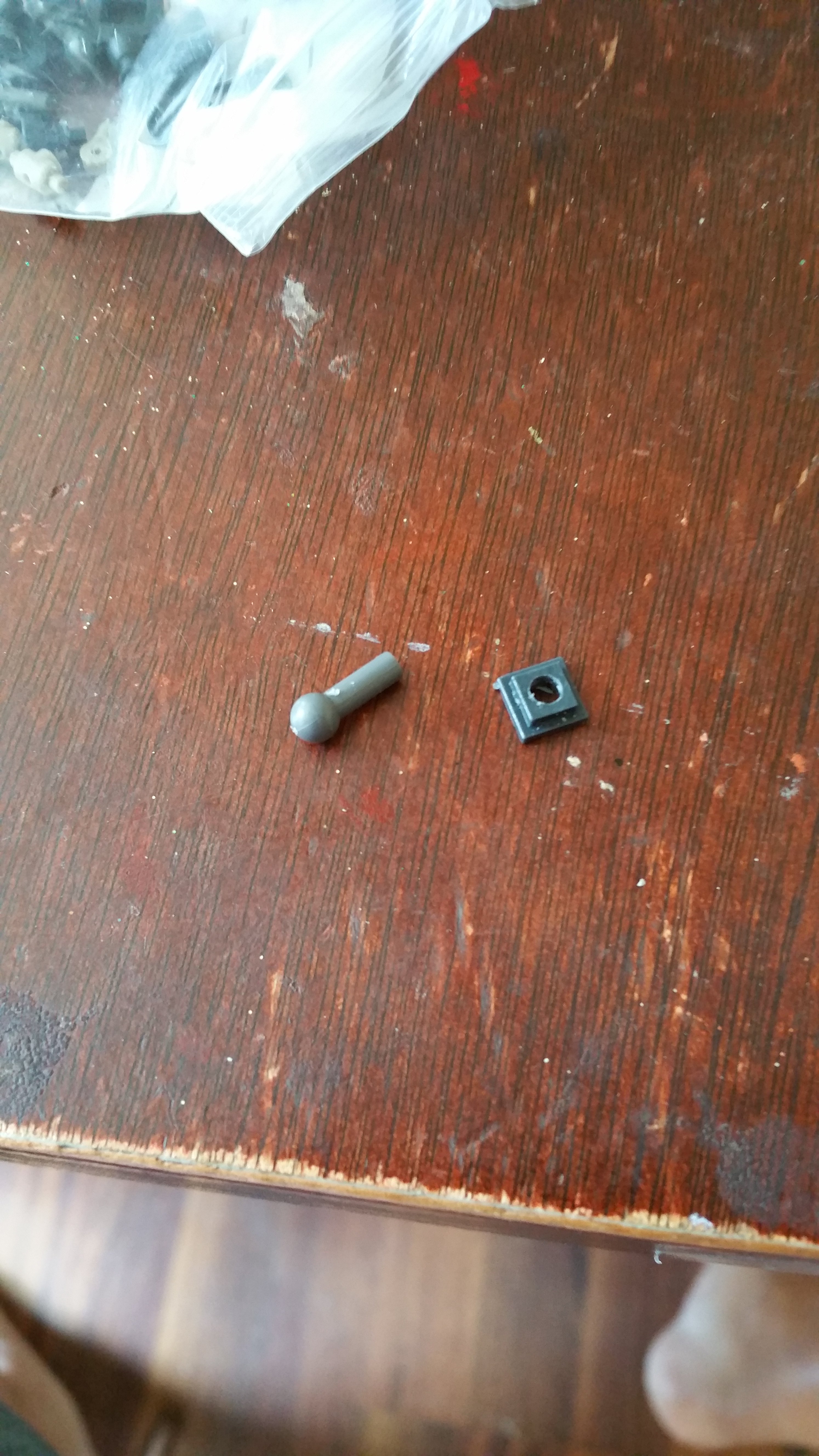

wmkjr Posted October 16, 2018 Share Posted October 16, 2018 13 hours ago, jenius said: ah, good call on HLJ, I can throw them in with the next shipment. Looks like those are cut to fit so it should work out for all my rod requirements. If you are able to track down other parts I should get, let me know! I also got this set for the thrusters. Here are some pics of the ball joints: Stock parts and when put together, the amount of looseness. Maybe you can use Future or something to build up the ball as an alternative. I cut off the ball ends and drilled a hole the same diameter as the Kotobukiya ball joints and trimmed the length to match. Here are pics of the instructions with the rod and missile arm parts unassembled and assembled (a screw/washer goes from the missile head + missile cradle + center hole in missile arm). Booster clip with parts:    Quote Link to comment Share on other sites More sharing options...
