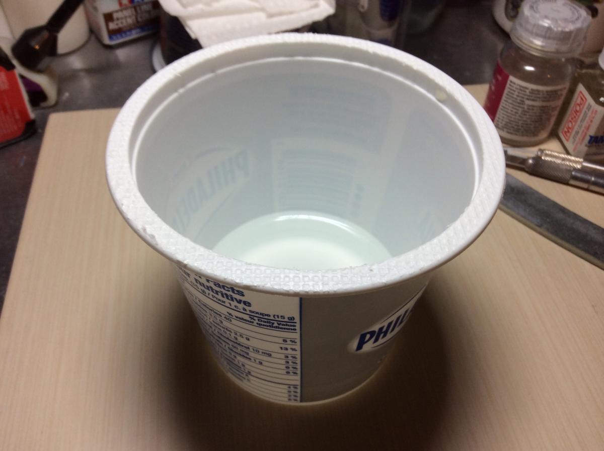

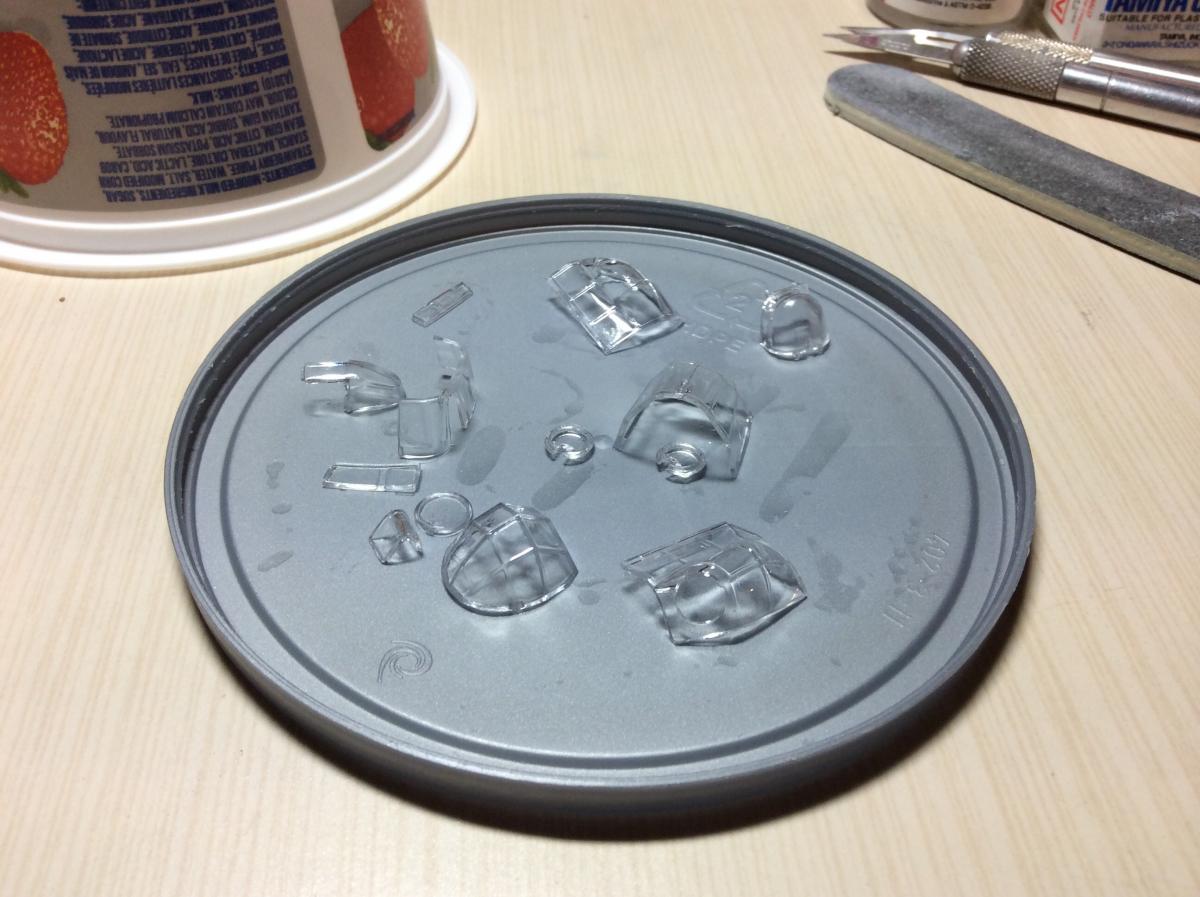

modelglue Posted November 20, 2014 Posted November 20, 2014 Yes, I regularly soak clear parts in future for 24hrs to let the coating penetrate any microscopic nooks present, then remove the part to rest on a paper towel and wick away any residual pooling future. I usually let it sit under some large bowl or container to keep dust off for ten minutes, then transfer to a plastic lid and upside down tupperware or margarine container to cure for a week. It will be dry to the touch after a few hours but you risk blemishing the surface if you get all touchy on it before it cures up. Future bath: Parts curing: I happened to have these in progress so therefore we get the benefit of photos , this should work the same for TF parts that are finished. But test it out before you commit Optimus's torso to a future bath.
GU-11 Posted November 21, 2014 Posted November 21, 2014 Thanks for the explanations, guys! @modelglue: can you reuse any of the FFP after dipping plastic parts in it? This stuff is like liquid gold. BTW, the overturned container idea is genius. The lid's wider area makes it less likely for parts to bump into each other, and you can simply lift the container up to check on the parts.
modelglue Posted November 23, 2014 Posted November 23, 2014 @modelglue: can you reuse any of the FFP after dipping plastic parts in it? This stuff is like liquid gold. BTW, the overturned container idea is genius. The lid's wider area makes it less likely for parts to bump into each other, and you can simply lift the container up to check on the parts. Yes, I keep it in that container with the lid on it, and just toss parts off the sprue right into it. Take them out with tweezers and shake off the excess FFP, set them to wick/dry on a paper towel like I mentioned earlier. I would do a test piece though, and note any discolouration of the FFP, as it can reabsorb itself and any paint you have coating an object dipped in FFP is subject to re-emulsification given a long enough bath (don't forget it is in there). I wouldn't take credit for the idea of the lid, it was most likely gleaned from some forgotten author or tip submitter in Finescale Modeller magazine, which I subscribed to on and off for a few years in decades past.
GU-11 Posted November 24, 2014 Posted November 24, 2014 Yes, I keep it in that container with the lid on it, and just toss parts off the sprue right into it. Take them out with tweezers and shake off the excess FFP, set them to wick/dry on a paper towel like I mentioned earlier. I would do a test piece though, and note any discolouration of the FFP, as it can reabsorb itself and any paint you have coating an object dipped in FFP is subject to re-emulsification given a long enough bath (don't forget it is in there). I wouldn't take credit for the idea of the lid, it was most likely gleaned from some forgotten author or tip submitter in Finescale Modeller magazine, which I subscribed to on and off for a few years in decades past. Yeah, I also noticed that the FFP tends to re-emulsify acrylic paint, even when I simply applied it using a q-tip on cured acrylic paint. With lacquers, it dries to a smooth finish in 3 days. With acrylics, it's still somewhat tacky after the same amount of time. I guess it's a good idea to avoid dipping in FFP if the parts are painted using acrylics. The credit is still yours, my friend, as I'm a big-time lurker at Finescale Modeler, and I never found the answer to all that until you told me.
modelglue Posted November 24, 2014 Posted November 24, 2014 I guess it's a good idea to avoid dipping in FFP if the parts are painted using acrylics.I would just test them first, you can always give them a quick bath in future and then remove them immediately. Cleaning the excess future off with a large paint brush of cotton bud will prevent a built up area which could interfere with transformation or overall uniformity of your finished work. You can also brush future on large parts, but it helps to have a lot of experience. I brushed copious amounts of future onto the revell/monogram shelby cobra car kit body shell, and it pooled something fierce in areas. I also neglected to have a "tent" for it to dry under so it attracted quite a lot of dust.The good/bad thing about future is that it will dissolve itself, which means bathing that shelby in a tub of future let me start from scratch. Another tip is to ALWAYS dip your canopies. Even if they are crystal clear they still benefit. Working on a 1/72 canopy for my P-61B, the canopy framing is present in abundance making masking a chore. Attaching it with white glue and presoaking the parts in future means that i can remove it and start again if I get bleed or residue which interferes with the transparent portions.
