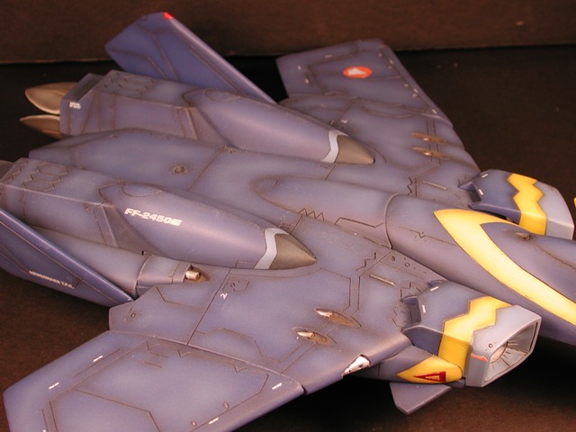

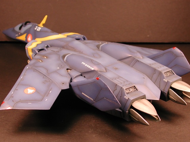

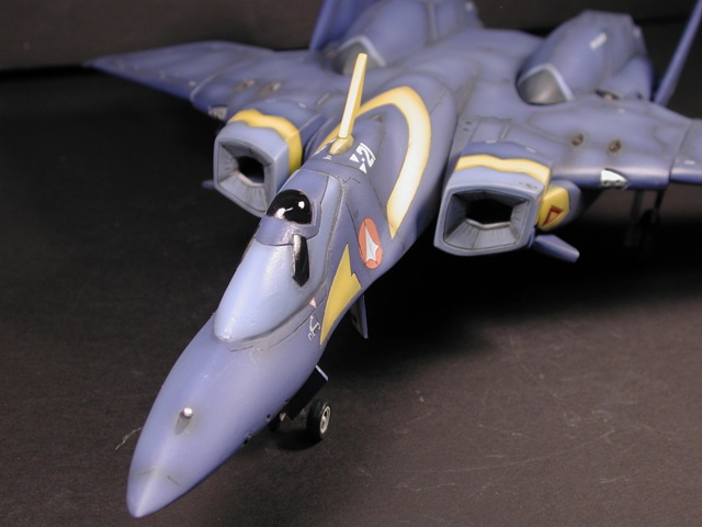

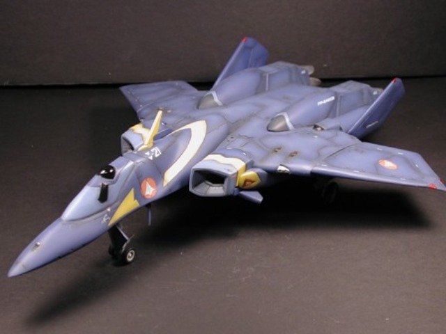

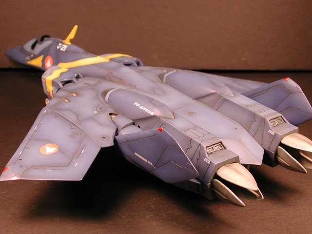

Kurt Posted January 7, 2005 Posted January 7, 2005 (edited) Hey everyone, I just completed this 1/48 YF-21 for a customer. It was a nice change from the custom valks I have been doing. For as simple of a design as it is, this kit was very difficult to build. There was a lot of clean up and modifying of parts to get them to fit. But I think it captures the look of the valk pretty good. I am also close to finishing the 1/48 YF-19. I just have one more challenge to overcome - the fitting of the vac-formed canopy. Should be done with in the week. Let em know what you think. Thanks! Edited January 7, 2005 by Kurt

rarityraider Posted January 7, 2005 Posted January 7, 2005 Very nice work, I love the painting and the colors you've used. Thanks for sharing.
nightmareB4macross Posted January 7, 2005 Posted January 7, 2005 Kurt, Nice work my man! I like color selected, that ghosted effect is great.

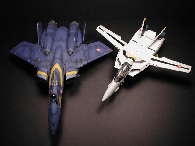

Montarvillois Posted January 7, 2005 Posted January 7, 2005 Beautifull !!! Can you post a picture beside a 1/48 VF-1 for size comparision please, assuming you have one. Thanks
astromanED Posted January 7, 2005 Posted January 7, 2005 I love it. The colors are very soft toned, if thats even a proper term. very nice

Kurt Posted January 7, 2005 Author Posted January 7, 2005 Hey everyone,I am also close to finishing the 1/48 YF-19. I just have one more challenge to overcome - the fitting of the vac-formed canopy. Should be done with in the week. Let em know what you think. Thanks! This thing is beauty. How long does it take for you to build a craft like this? I would love to see some pictures of the building process, if you have them. Good job! I did not keep track of the actual build time. I would guess around 20-30 hours. There was alot of clean up which increased the build time. Sorry, I did not take any in progress shots.

Montarvillois Posted January 7, 2005 Posted January 7, 2005 Thanks everyone! As requested..... GAWD !!! Thanks, it really looks great. So after all, the VF-1 is not sooo small compared to the YF-21.

hellohikaru Posted January 7, 2005 Posted January 7, 2005 Kurt Does the kit have any detail for the cockpit ?
Kurt Posted January 7, 2005 Author Posted January 7, 2005 KurtDoes the kit have any detail for the cockpit ? I don't recall if there is any detail casted into the cockpit. There was a seat included, I do know that. However I decided not to make this cockpit viewable. To do that you need to remove the "bubble" on top of the canopy and fit a vac-formed piece in there. This for sure would have been a major task. For the sake of my sanity and to not destroy the entire kit I just gave it a tinted window look.
Myersjessee Posted January 7, 2005 Posted January 7, 2005 KurtDoes the kit have any detail for the cockpit ? There is detail, but it's sparse considering the size, and there isn't a pilot. I had never thought of making it tinted...I'll surely steal that idea! (THANKS KURT!! )

Kurt Posted January 8, 2005 Author Posted January 8, 2005 excellent work Kurt. what blue/grey did you use. i really cant wait to get mine now. oh the agony. keep it up i cant wait to see the 19. what were the most troublesome areas of the kit? sean I used exactly what Hasegawa suggests on their painting guide. I think it was Cobalt Blue, Gunze Sangyo. The most troublesome issue with this kit where the amount of air bubbles in the castings. I must have spent a good 10 hours just on that, and I still did not get all of them out. There was also a fairly large chunk missing from the front of one of the engine pods. The areas that are painted black. I had to add a blob of epoxy putty and shape it to match. Most of the parts are nor perfect fits and take some adjusting time. The land gear was also an issue. I just did the best I could with what I had.
