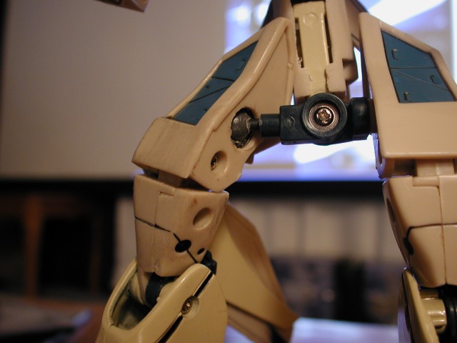

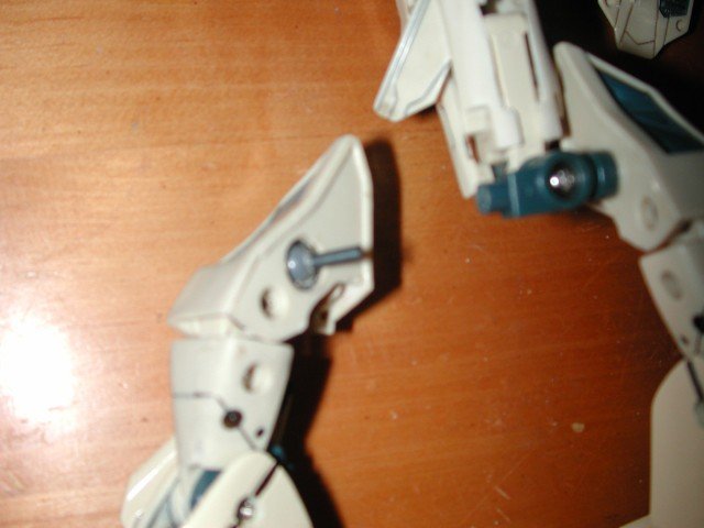

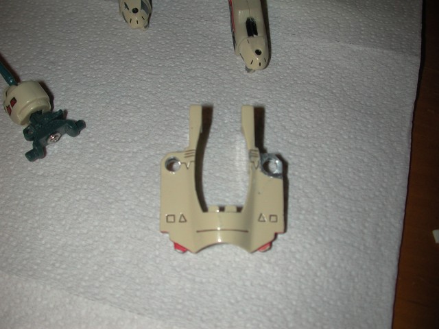

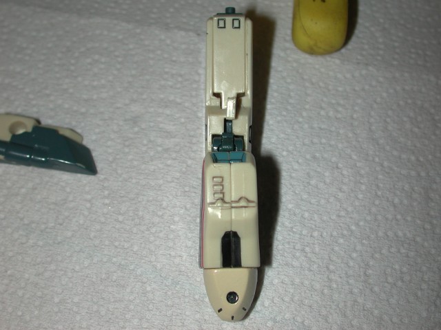

I was going to wait until I had the other one done (I had to order new parts because I broke one of the ball sockets). But, I can post the one I have done. I'm going to try and change this setup to get rid of the long post, so all of the parts between the hips will likely change before I'm done.
This is before cleanup mind you...
Edited by Pat S

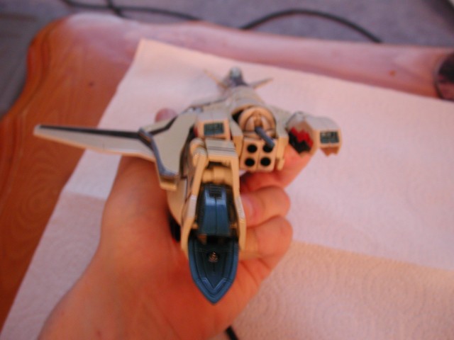

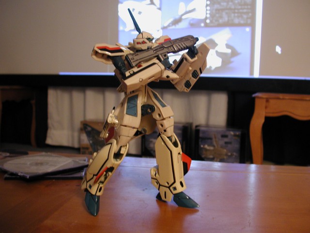

Another pose shot, looks funny without the cod piece. The feet need more poseability to keep up with the hips now...
Edited by Pat S

I use two compound epoxy. The one you buy in a hobby store or a hardware store. It's very workable (although the one I use hardens like metal but I still manage to sand it pretty well).
Thanks, that's what I used to seal the joint in. I filled the hollow hip section with Tamiya putty behind the joint, so it can't back out.

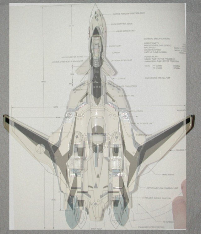

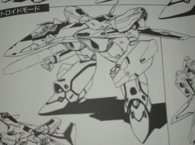

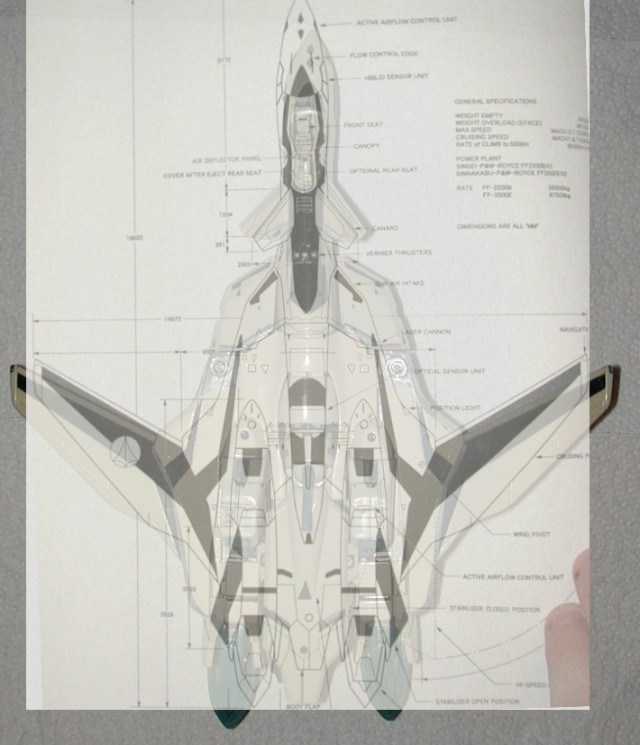

I played around with paint shop and overlayed the lineart ontop of a pic. Yamato did a decent job with the proportions, though it is a little fat. I don't think I can fix everything :blink:
The wings should bend foward a little bit more to match the art.

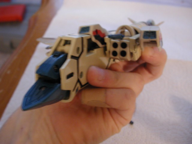

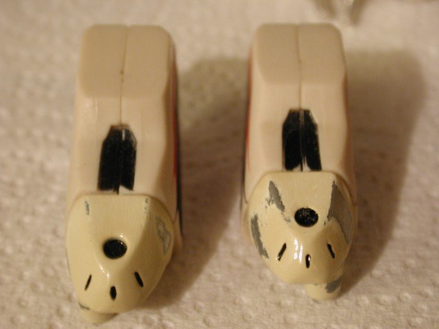

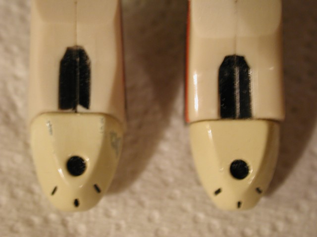

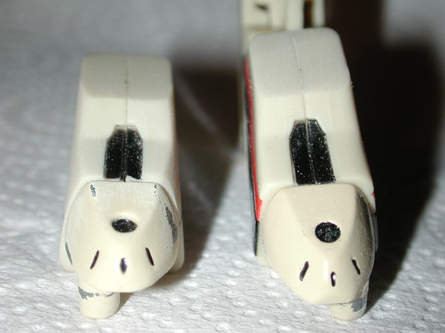

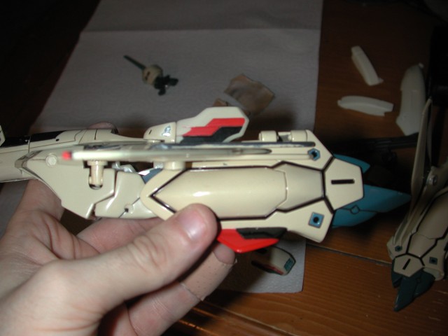

Notice the tops of the shoulders, the raised black areas... It's in some of the line art, but the way it came out on the toy doesn't look good to me, so...
Also, from the front view, after the sort of triangle shoulder part that connects the arm to the body of the plane, the connected part is square in shape, not rounded like the triangle part. I hope that made sense, anyways, in this pic (and the one above), I've sanded down the one on the left to match the triangular part.
Edited by Pat S

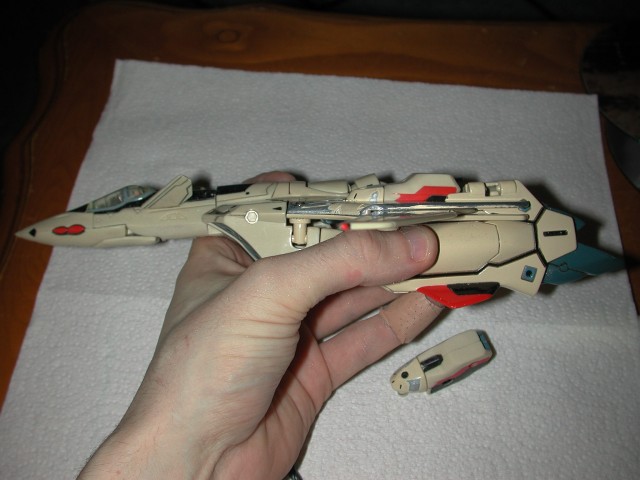

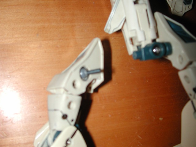

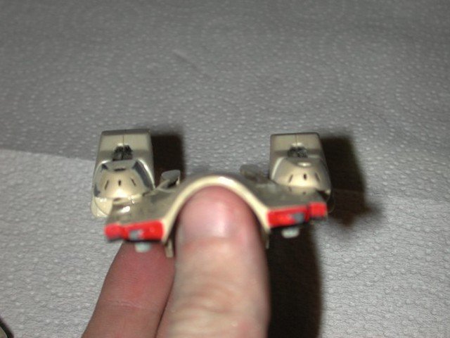

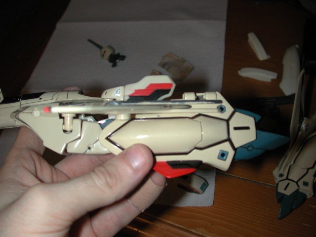

The height of the shoulder makes this section from the rear really stand out. I want to close up this gap, and add some putty to the rear of the leg. Then, I may add some club-m fastpacks :)
So, what I did, was sand down the part below the shoulder with a dremel and many different attatchments. The one on the left is original height, the one on the right is the modified height.
A little bit of the leg will have to be sanded down as well.
See where it is touching the shoulder, raising it up on one side.

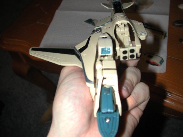

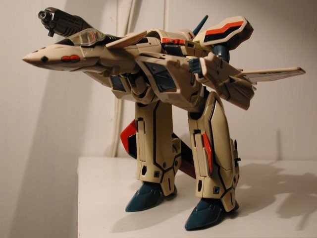

As much as I love how this looks as far as the fighter mode goes (great job btw), doesnt this cause problems for gerwalk mode? :blink: I dont know other people, but I already have enough trouble tucking the wings under the shoulder as it is in gerwalk mode and if the shoulders are lowered, i would think it would make things worse. :ph34r:
With a longer screw than the one Yamato used to hold the shoulder down, and a spring added, the shoulder raises up to the normal spot in gerwalk and battloid. The spring keeps the shoulder lowered in fighter, and provides tension so the arms aren't flopping around in the other modes. I need to find a place with small screws and springs though. I'll guess I'll try home depot.
Edit: No need for a longer screw for this mod to work like stock, but the spring is necessary, but I want the longer screw so that in gerwalk mode, the arms can raise up higher than normal, this will allow gerwalk to keep a sleek look without raising the whole body up.
Here's what I mean, the body is above the wings in gerwalk otherwise the arms can't rotate forward.
Edited by Pat S
The line art shows the body stays connected at the front, but raises in the rear. I can't see an easy way to do that, so I hope that by raising the arms only with a longer screw I get most of the effect, and keep a sleek look.
