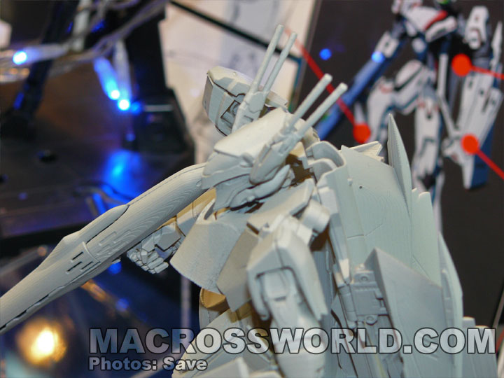

Yep, and before he got started on the tool there would have been pattern makers who had to scratch build the original pattern. Before SLA/SLS technology was developed the skills that some of the folks here on the boards have was highly sought after, and remunerated. Things sure have changed since the eighties. Nowadays 3-D printing tech. is starting to make it into homes. -

I used t work in rapid prototyping (SLA & SLS,) When the patterns came out od the SLA machine we would sand down all those ridges you see on these to a smooth finish and then make silicone moulds and cast them off in polyurethane resin. That way we could get top notch looking prototypes off to the client in less than a week. When they got a prototype that their engineers were happy with, often we would go through two of three modifications in resin, then they would order up some aluminum tools made up. Those cost usually between $30,000 - $50,000 (CAN). A steel 'production' tool started at about $200,000.00 (CAN)
