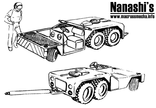

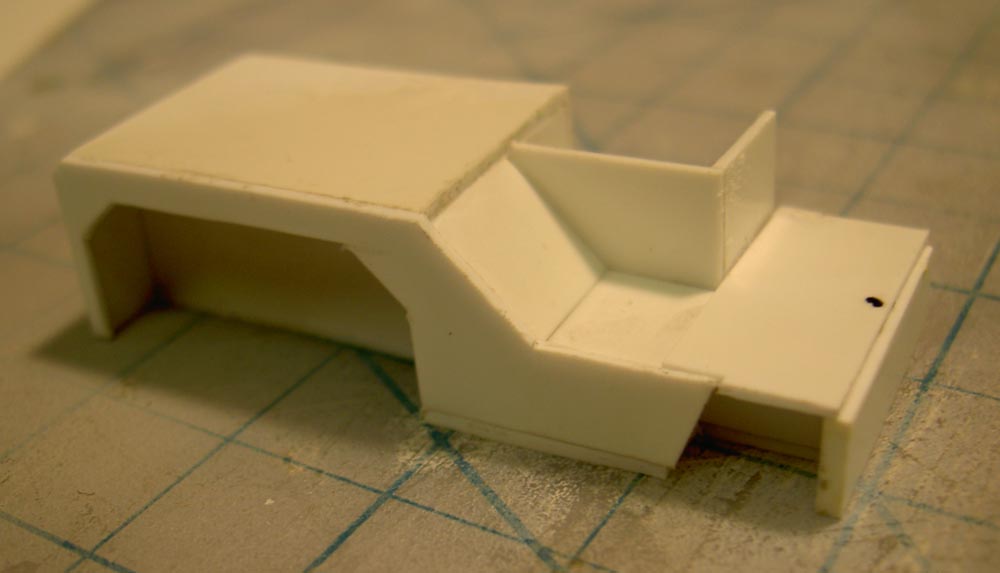

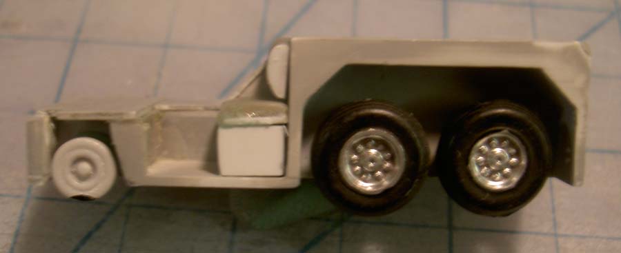

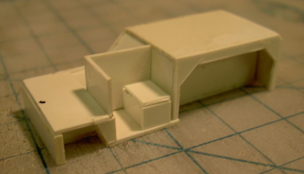

Valkyrie Posted June 17, 2006 Posted June 17, 2006 So as to not further hijack Honneamise's Ghost thread, here's one for Macross vehicle models. To kick it off, here's my progress on my model of the day. I started over again on my 1/72 tow tractor scratchbuild. The first attempt I gave up on because stuff wasn't coming out straight. The second was looking a lot better, but when I pulled it out today, I found that a several areas were severely warped due to shrinkage of the polyester putty that I used. So it was back to square one. So once again, working off my CAD drawings, I cut out the shapes on styrene and started gluing and filling (with Apoxie Sculpt this time around). I worked on it on and off for about 7 hours tonight, and this is as far as I've gotten. All the basic shapes are in place at this point. It just needs some fine-tuning and a lot of detail work. It still needs lights, streering wheel, pedals, seat cushion, etc, etc. And I'm still not quite sure what I'm going to do for the wheels. Scratch building them is probably out of the question, so I've gotta dig through my parts box and see if I have anything close. But anyway, I don't want this thread to just be about my project. So post all your wants and ideas here. And if anyone else is inspired to take up a vehicle scratchbuild, then by all means, post pics here!

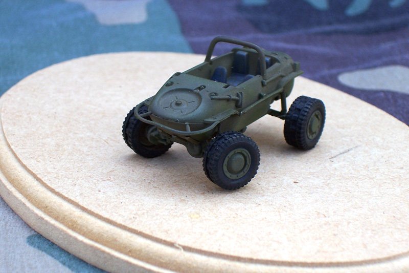

Berttt Posted June 18, 2006 Posted June 18, 2006 (edited) As for wheels you might be able to use some a WWII 3/4 ton truck and shim them. Putty up and scribe some detail. I didin't do that here, instead I got a 2mm strip o ribbed steyrene and added it in there as I was feeling lazy. The front wheel look kinda small so you might want to use one off say a Hasegawa GSE cart or maybe a tank return roller puttied and the tread pattern scribed in. Cheers, Berttt Edited June 18, 2006 by Berttt

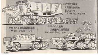

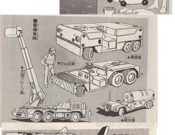

honneamise Posted June 19, 2006 Posted June 19, 2006 (edited) I´d really like to make these: - the big one is cool, but this will be a very big kit! - all of these with the exception of the airfield truck of course. The smaller ones would make a great set I think. The cilvilian cars are also cool, maybe for a second set.... and of course I will build a Cola vending machine no matter what! Edited June 19, 2006 by honneamise

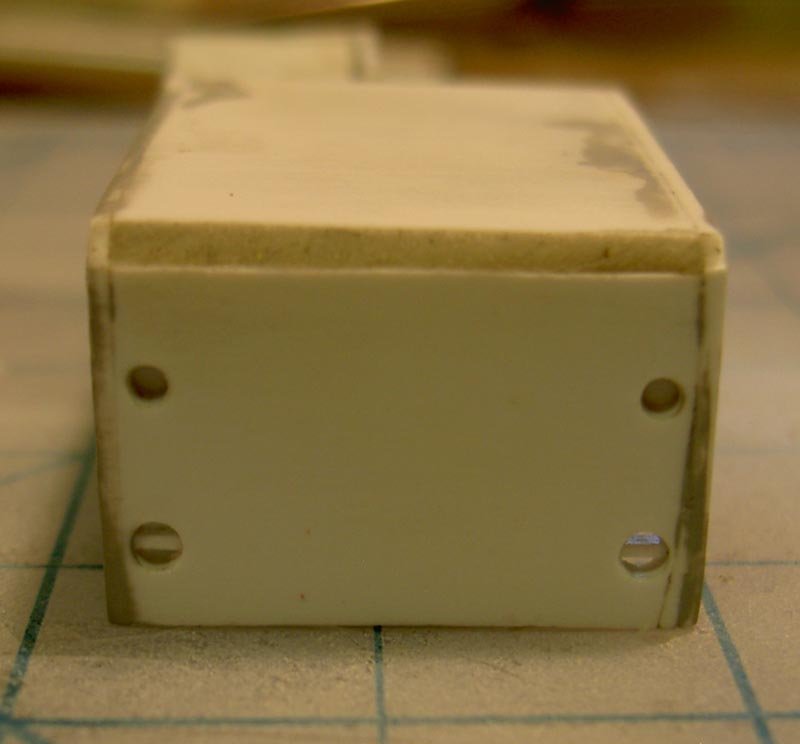

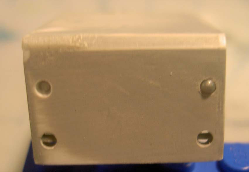

Valkyrie Posted June 23, 2006 Author Posted June 23, 2006 Quick update. I've been trying to do both detailing, and fine-tuning the overall shape at the same time. And I'm realising that it's not a great way to go about doing things. But it's working so far. I think. I finished the circle-bar tie-downs in the rear bumper today, and drilled out the holes for the headlights and tail lights. I still need to either find or fabricate lenses for them though. I started doing the diamond plate surfaces too. I think the photo-etch I've got for it is just about right. I cut it roughly to shape for the two smaller surfaces, but I've still gotta build a frame around it. And I've only got a place holder for the 'hood' so far. It's definitely proving to be an interesting project. Especially considering that I have to plan for casting every step of the way. I have to make sure I'll be able to make an effective, durable mold of the final piece.
honneamise Posted June 23, 2006 Posted June 23, 2006 Looking great so far, very fine detail considering the tiny size! As you say, a lot of thought will have to be put into casting with these all-around-detailed parts, especially on the thinner areas. I´m looking forward to see more of this!
MechTech Posted June 23, 2006 Posted June 23, 2006 Looks great so far. You gonna include ground crew figures? One idea for lenses I've used is to get a punch (hollow die or paper punch) the size you want and make punch outs of clear plastic. Then get a drill of the same diameter or that's a tight fit and snap the lense in place. I'f your building it as a solid unit for molding, still punch out a piece of styrene the size you want and sand over it with a sponge sanding block. That should bevel out the edges nicely. I've got a collection of various sized hole punches and hollow stamp dies just for that reason. Hope that helps. - MT

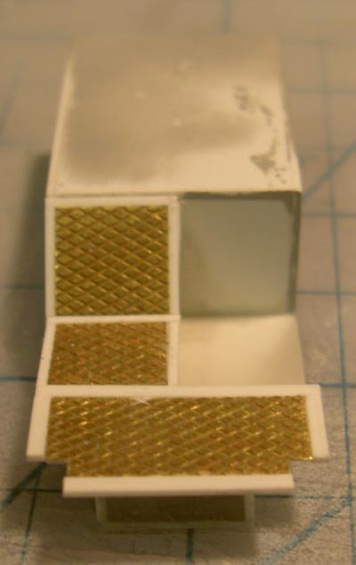

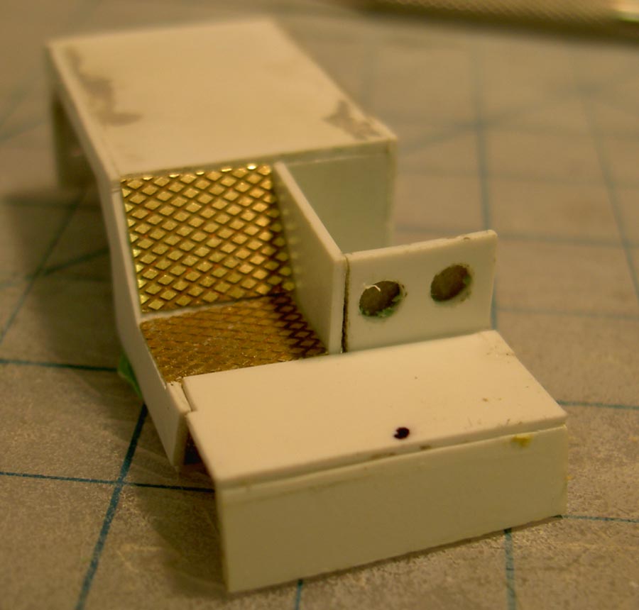

Valkyrie Posted June 27, 2006 Author Posted June 27, 2006 One more quick update. I've been working on the diamond plate the past couple days. And after a bit of trial and error, I think I've about got it. My knurling tool should arive tomorrow, so once this and the front bumper are done, I'll be starting on the wheels.

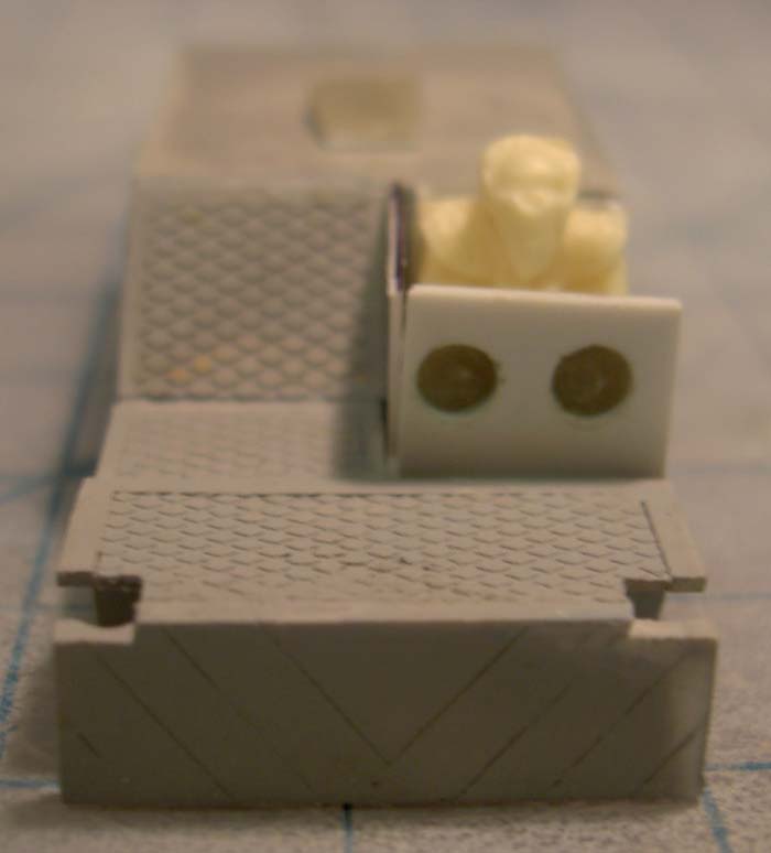

Valkyrie Posted July 10, 2006 Author Posted July 10, 2006 It's coming along quite well. I'd put the total progress at about 80% right now. No new pics at the moment. It'd look damn close to the last ones anyway. Except now the bumper is in place (with the diagonal lines scribed in) I've still got a bit more detailing to do. And I've still gotta build the '5th wheel' for the top. And the tow bar for the back. And devise a way for it to link to the VF-1's landing gear. And (the part that worries me the most) modify a driver figure into something that looks like it MIGHT have come out of Macross I think I finally found a set of front wheels that'll work well. They're from an Arii/Bandai 1/100 variable VF-1 kit. But the ones I have aren't in that great of shape. Anyone got a set of them they could send my way? Oh, and I found the perfect clear headlights for it too, in one of Wave's 'H-Eyes' sets. The final kit will include solid cast ones, but you can replace them with the Wave ones for that extra bit of detail. I've been working on designing my GU-11 gunpod loading cart a bit too. And one of the first things I noticed was that the stock VF-11 kit sits far too low for a cart w/ gunpod to fit under it. So it looks like I'll be modifying the stock landing gear so its cylinders are extended further, raising it up. And if all goes well, I'll be able to cast them in metal when the time comes The original plan was to sell the tow tractor and gunpod cart as a set... But it's looking like I'll have one done long before the other, so I may just scrap that plan and sell them seperately.

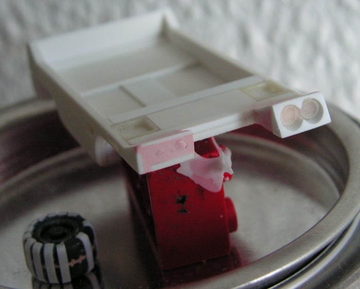

honneamise Posted July 10, 2006 Posted July 10, 2006 That towing vehicle is looking great so far Valkyrie! I want at least one! I´ve just come back from holiday and now I´m starting with the 6-wheel crew vehicle. I have the IMAI 1/100 kit in front of me but, looking at the lineart, it appears way off, the upper body is too high and the wheels are too small. I´ve made a scale drawing and it appears that I can use the wheels of the "cherry picker truck" from the IMAI set - they even have the right tread pattern, but I need to scratchbuild the hubs. I hope to have something to show in a couple of days.

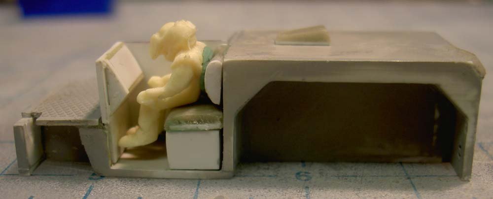

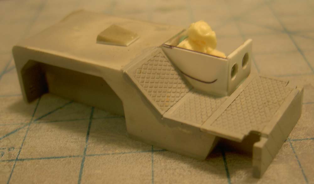

Valkyrie Posted July 12, 2006 Author Posted July 12, 2006 Alright, took a few pics of the truck mocked up a bit. The metal plates and bumper are glued down now, but the entire driver's compartment is temporarily held in place with clay. The figure I've got in there is temorary, obviously. And the seat and cushions need more work. I may end up shortening the seat too, if the legs on the final figure are too short, like Hikaru's. I found lenses for the rear brake lights too. They're some of Wave's rivets. These will probably be made seperate pieces to make painting easier. And they'll be plastic Wave parts, not resin casts. In the pic with the wheels, the front wheel is the one I plan on using. The rear ones are just mock-ups. They're the closest I could find in terms of size, but still a bit too small. Next up, I get to work on the tie-downs on the hood. I'm still not sure if they'll be seperate parts, or part of the main cast. But we'll see. And I really should get started on the driver figure... I have a feeling it'll be the last thing done, no matter when I start it...

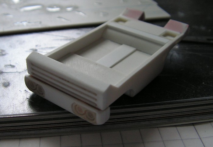

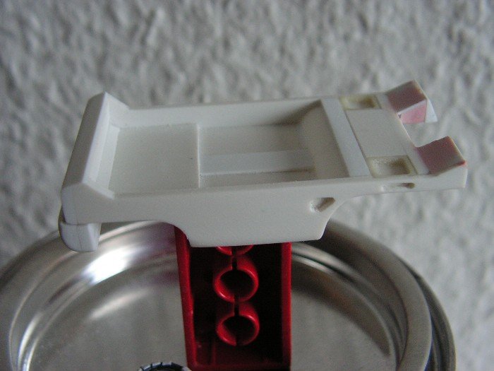

honneamise Posted July 12, 2006 Posted July 12, 2006 That is a beautiful little vehicle! The size of the rear wheels looks quite OK to me, besides, would bigger ones still fit? I have started with my crew vehicle, thought there´d be no problems with the plans but guess what, there is anime magic even here! Now I know why IMAI chose to make the body too high and the wheels so small - the driver needs to sit ABOVE the front wheel, there is not enough space for the passenger compartment to fit between the wheels cause they are so wide... The car body, according to the lineart, is so shallow in height that there is hardly any space for the driver to sit IN the car, he´s more like sitting ON the car! Still, I decided to make it look like the lineart, I really hope that I can fit a driver figure into this.
Valkyrie Posted July 13, 2006 Author Posted July 13, 2006 Very cool, Honneamise! You sure work fast But where are all the replies at? Does no one care about these anymore?
