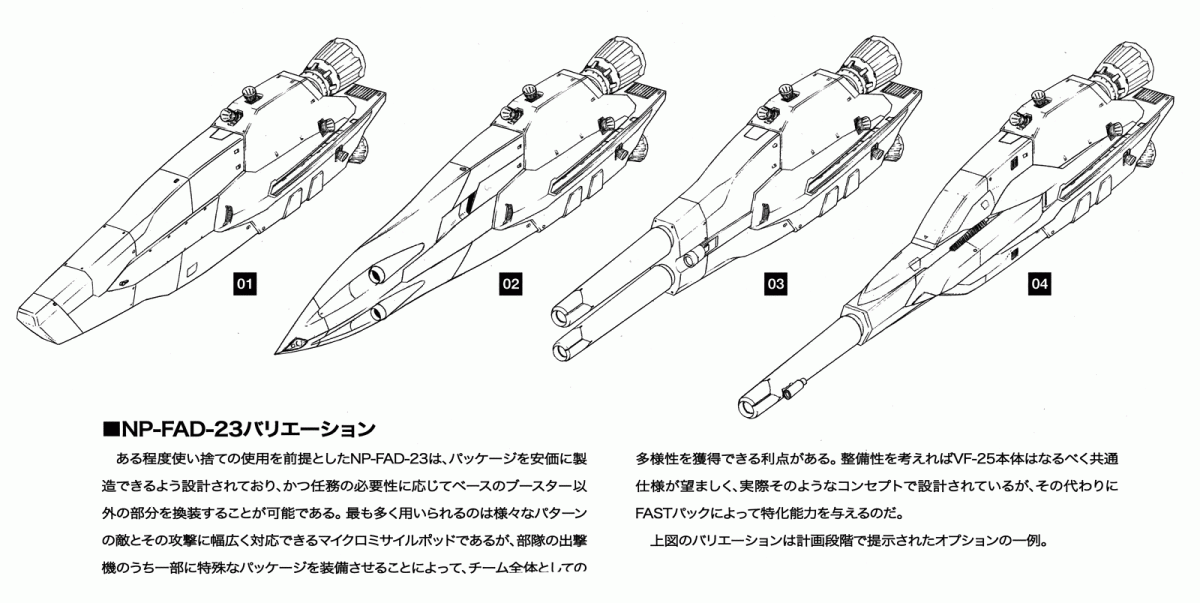

Seto Kaiba Posted August 10, 2015 Posted August 10, 2015 (edited) I'd be interested in seeing what a strike version of the Frontier boosters look like. If you have a copy, there's some line art for the Strike and extended-range packs on page 77 of Variable Fighter Master File: VF-25 Messiah. Three different trial variations of the NP-FAD-23's beam cannon option packs... one originally intended for atmospheric use. (The majority unfortunately only exist in text descriptions, same as the VF-1's.) Edited August 10, 2015 by Seto Kaiba
Mr March Posted August 10, 2015 Posted August 10, 2015 I'd be interested in seeing what a strike version of the Frontier boosters look like. Would ya, now?
Valkyrie Driver Posted August 10, 2015 Author Posted August 10, 2015 Would ya, now? You, sir are amazing!

Mr March Posted August 10, 2015 Posted August 10, 2015 You, sir are amazing! You're most welcome. When writing the mecha profiles, I do often think about missile counts in Macross. I wonder though, are the increase in missile counts from old valkyries to the latest valkyries entirely an in-universe development? For sure, advancement of technology and a general increase in the size of the variable fighter (and perhaps decrease in missile size) means more missiles can be loaded per valkyrie. But I think outside the Macross universe - on the production side of the Macross animated films and series - the introduction of computer modelling may have had an impact upon missile counts. Rather than "guessing" how many missiles might fit into a particular hold, CG models of the various mecha in Macross would allow for exact volume allowance because of the exact physical dimensions of each model. Of course, they could still cheat if they wanted, but the option to attain a more precise volume measurement would naturally allow for optimization.
Mommar Posted August 10, 2015 Posted August 10, 2015 Would ya, now? I can't read any of it but 1, 3 and 4 are fairly obvious. But what is 2? is that an atmospheric version or something?
