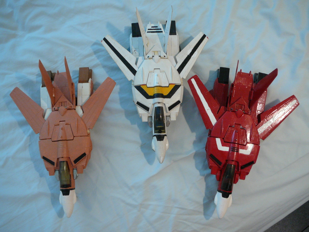

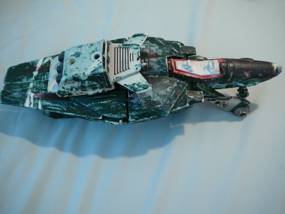

optimator88 Posted August 29, 2008 Posted August 29, 2008 (edited) With my first custom finished it's time to move on to another. I need some paint stripping advice, and this seems to be the place to ask. I've read threads recommending soaking parts in Joy for a week and also about oven cleaner, but everyone seemed to be stripping the original paint. I've acquired a couple of already repainted Jetfires, and the paint is thick and applied with a brush. They look ok, but I would love to be able to strip them down and redo them. If you can see on the red one the, it's so thick that it covers up the panel lines. Has anyone tried stripping thick coats of already applied paint from their valks? Any tips would be welcome. I'm trying to avoid killing any more toys. My girlfriend confidently said she could remove the paint. Trusting her I gave her a jetfire and she left it sealed in a bag of paint thinner over night. The next day it was melted into an ugly green rock Edited August 29, 2008 by optimator88
