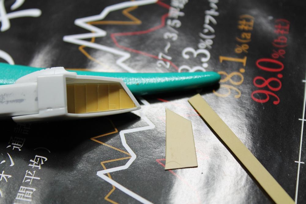

Oh my, I'm scratch-building now! Yeah, it's not much, but it's the first time I've ever tried anything like this. Kind of fun!
