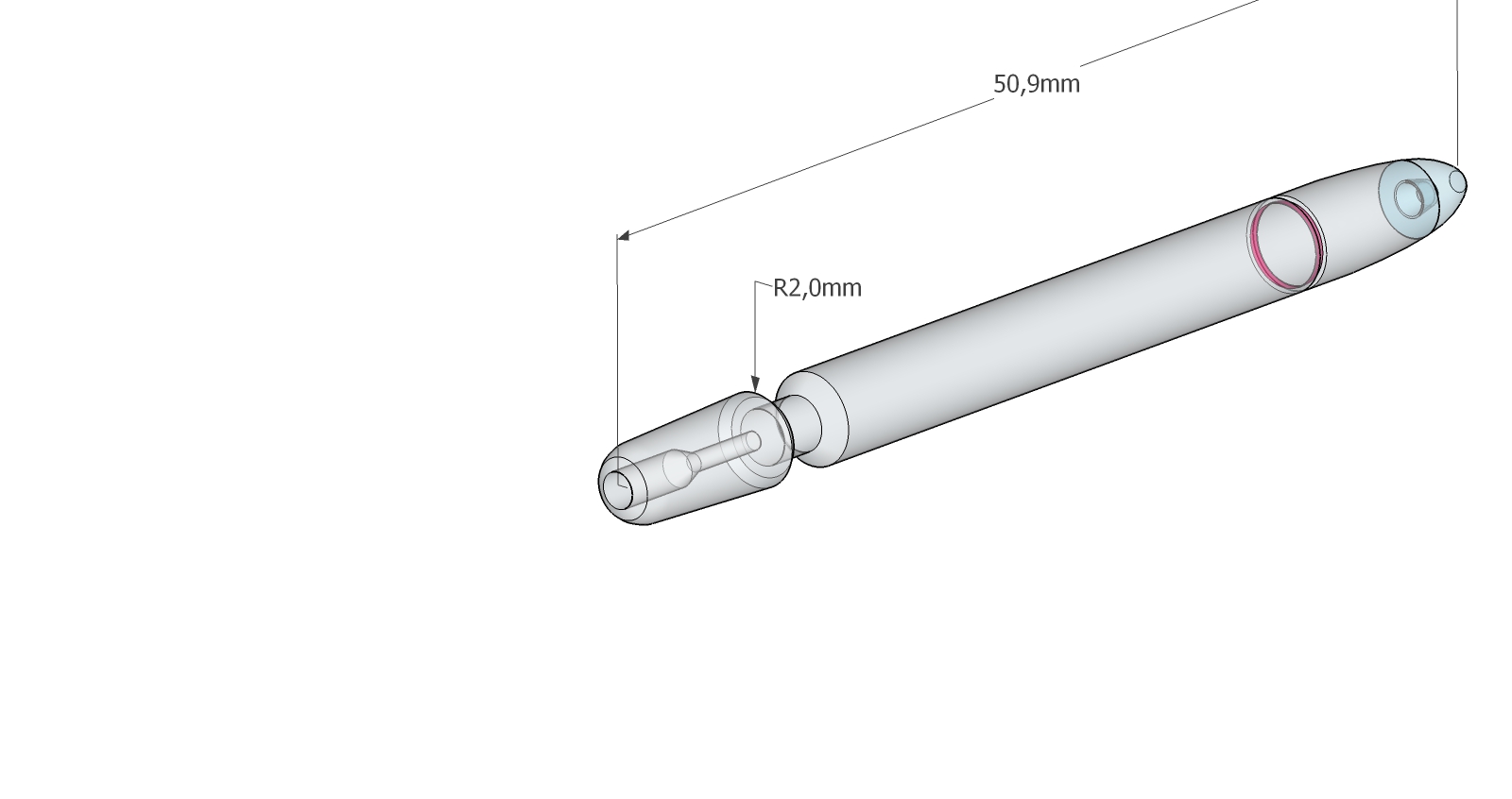

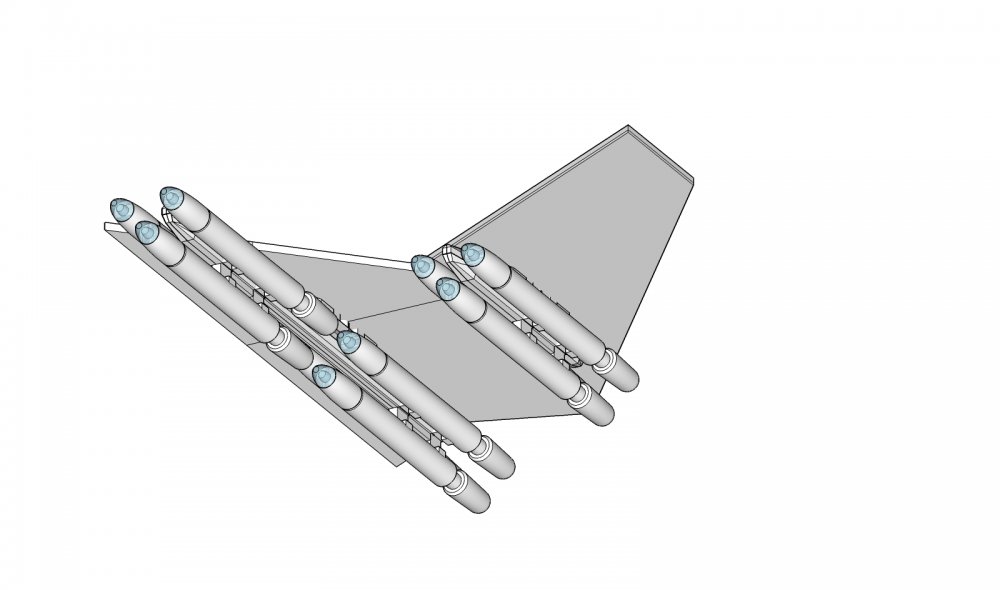

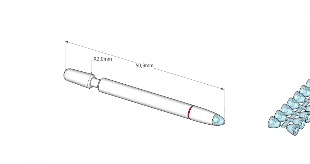

Xigfrid Posted April 6, 2017 Posted April 6, 2017 We can discuss about size, but I think thanks to the VF-25 Master File we already have a precise idea of the missiles sizes. Concerning the AMM-101, they are supposed to be a little longer than 3 meters, in 1:60 scale this is a little longer than 5 cm. Which translate into a 4mm diameter for the AMM-101. This is really the smallest if you want some strength and room to make attachments. 1) When discussing with chyll2, we decided to go with the cheapest way, but still having the option to have the camera and clear tip in the design. The pack of 18 missiles would be around 20 USD when printed in WSF and FUD for the clear tips. 2) I also included at the rear of the missile inside the thrust a 0.7mm x 4mm hole so you can insret a steel wire to make a flying missile for a dioramas.

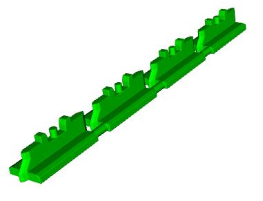

Xigfrid Posted April 8, 2017 Posted April 8, 2017 (edited) I found a good idea to make the station#4 pylons without ruining the DX paint. But because it needs 1,5 to 2mm thickness to hold tight, I don't think this solution is suitable for the wings. Also the rotating wings on the 25s is troublesome. I guess this is the main reason why the 171 had the attachments but not the 25. BTW, the PACSWS-1G are still hot on tracks! Edited April 8, 2017 by Xigfrid

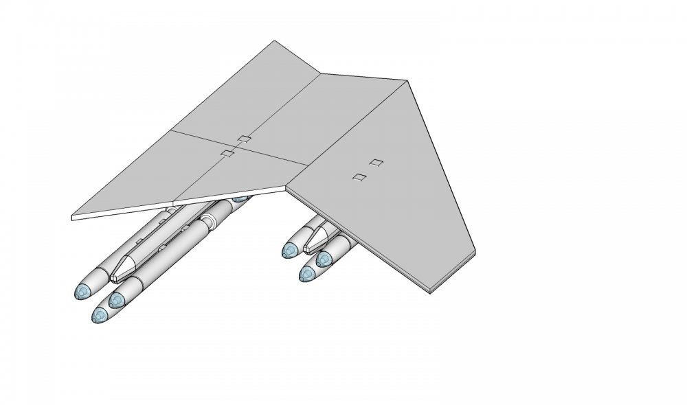

Xigfrid Posted April 10, 2017 Posted April 10, 2017 AMM 101 ready to be 3D print, I will try fit a pylon and a missile before putting it online.
Xigfrid Posted April 10, 2017 Posted April 10, 2017 12 minutes ago, chyll2 said: Thanks Xigrid. Looking really good. I thought of a special set of 4x DX attachments, with a flat 9mm x 19mm plate so you can glue anything on it. Like a pair of 1:72 / 1:48 plastic model missiles.

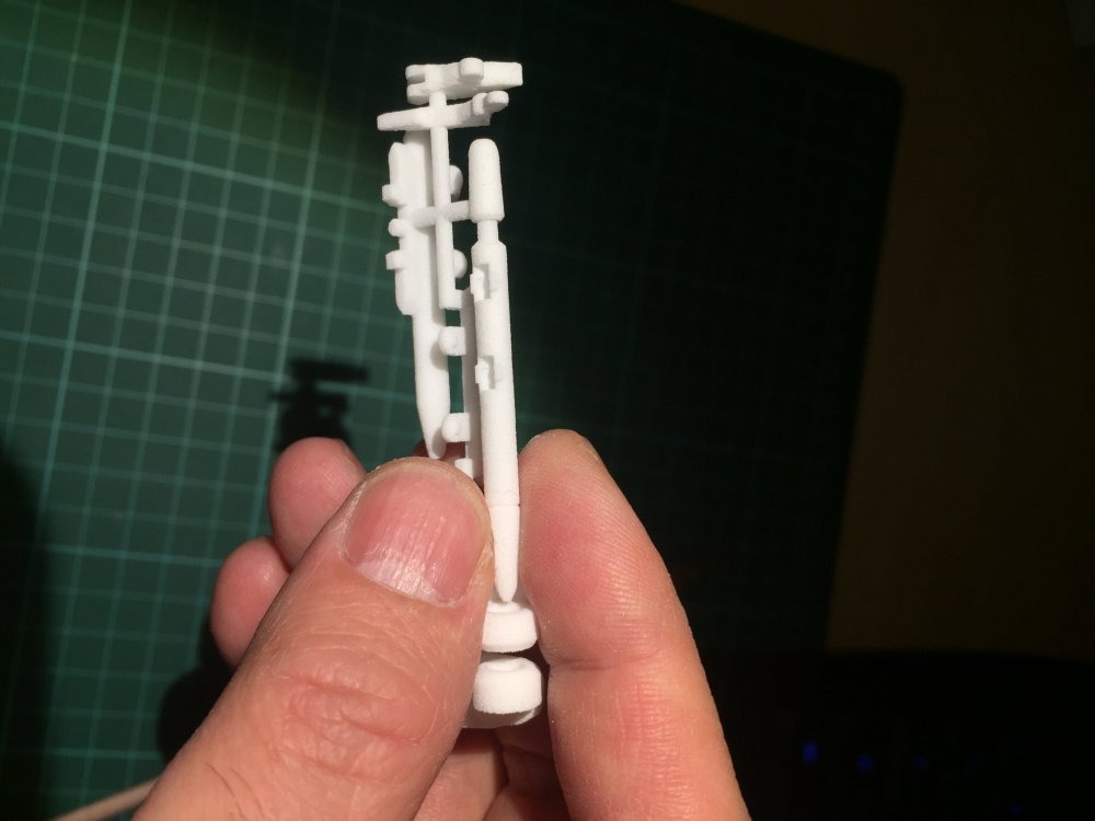

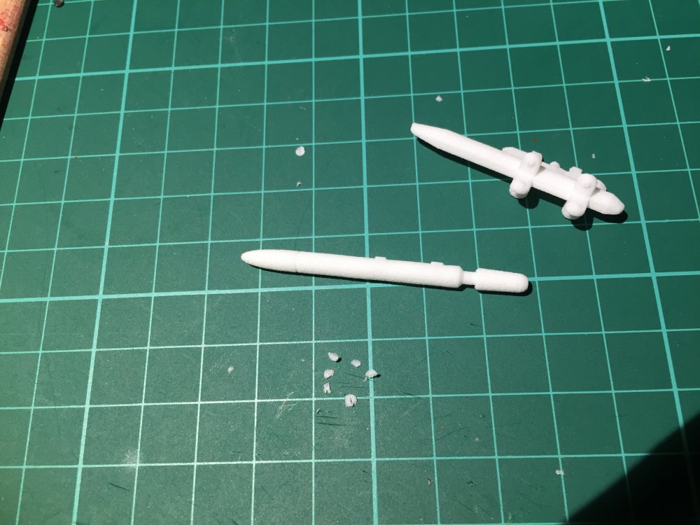

Xigfrid Posted April 21, 2017 Posted April 21, 2017 Just received the pylon for 3x AMM 101 and one AMM 101, everything is good to go! A few pictures below
Xigfrid Posted April 21, 2017 Posted April 21, 2017 Missile and pylon freshly printed. Rough but detailled. It should be good with 1 or 2 coats of floor polish.

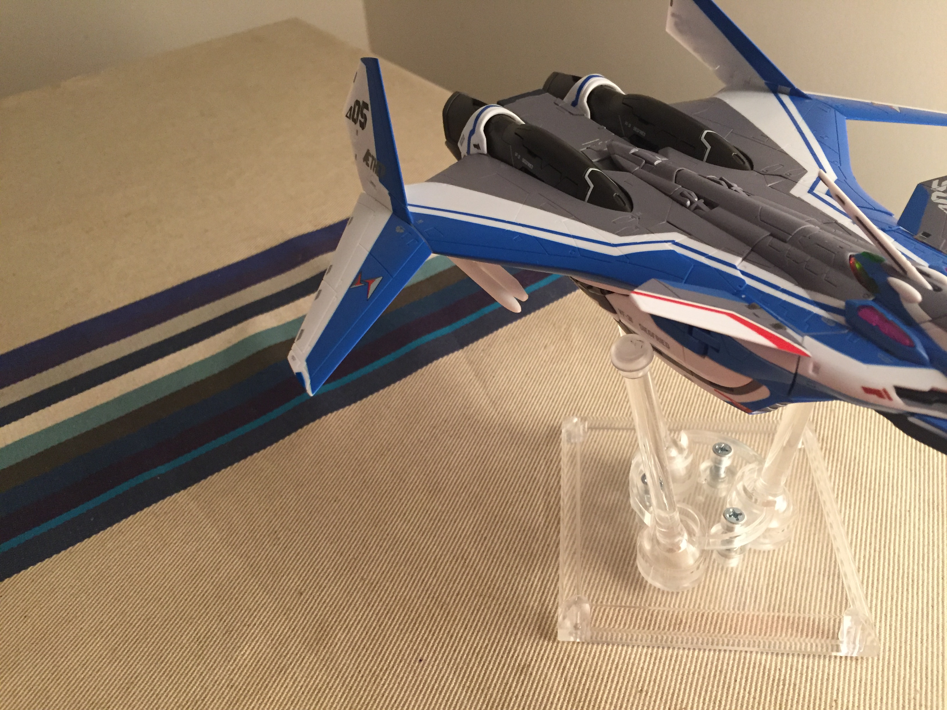

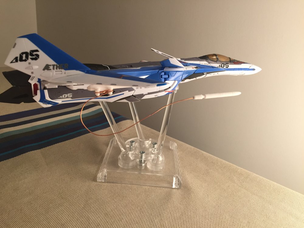

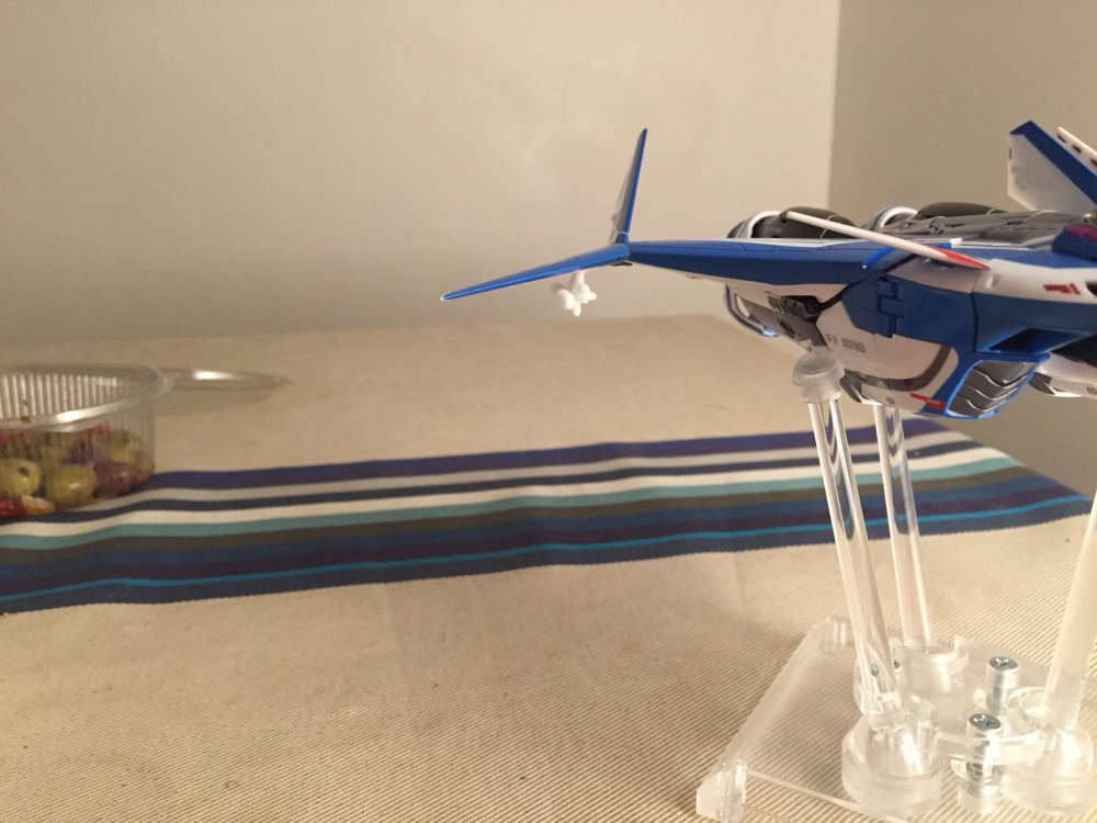

Xigfrid Posted April 21, 2017 Posted April 21, 2017 (edited) Here is some hope for the VF-25, pylon attachment Station 4 on the VF-25. Once assembled, the pylon can holds the VF-25 weight! The pylon can be removed and there would be 2x 1mm diameter holes, nearly invisible. Edited April 21, 2017 by Xigfrid
