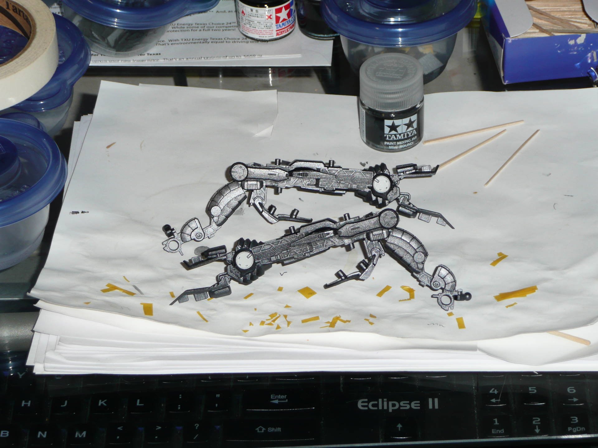

For all the internal skeleton parts (insides of the legs, upper arms, hands, etc) I used gunmetal to give a metallic appearance, and then did a wash to give it a grittier, dirty look and to make the details stand out more. This is actually my first time doing a real wash. For this wash I dissolved some grey and black Tamiya in rubbing alcohol, after applying a gloss coat over the paint job. I've since switch to oil wash, but haven't really tested it out yet. The off-white ankle discs were masked and sprayed as well.

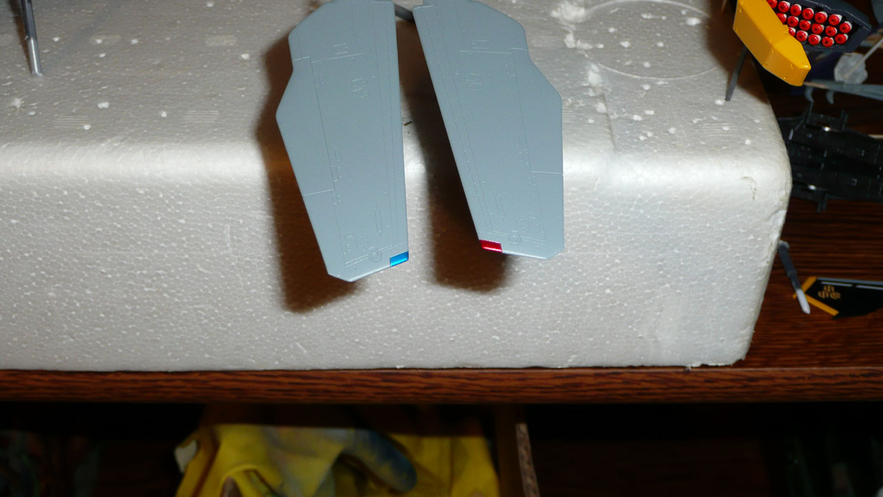

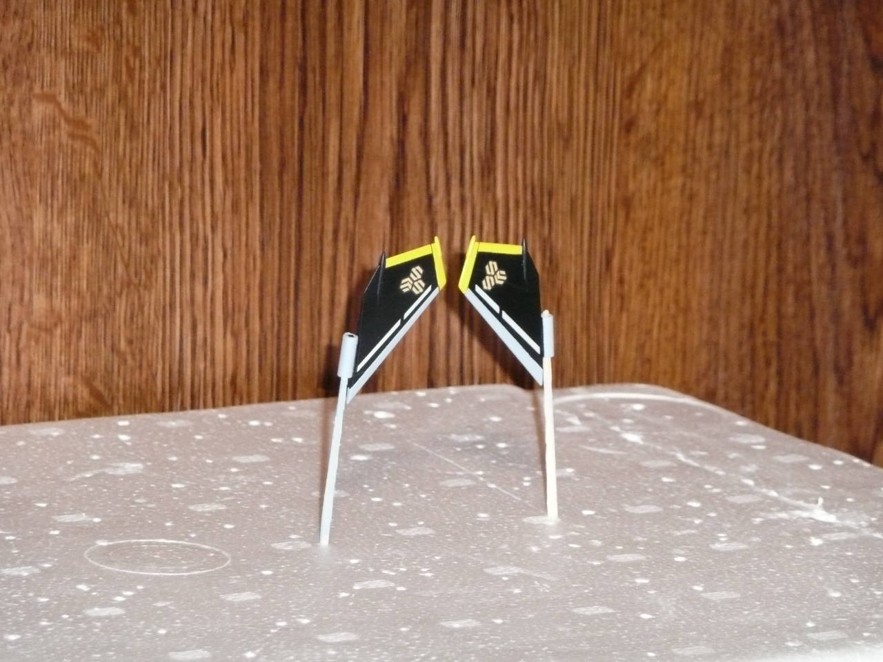

As always, I threw away the crappy tailfin decals and just painted everything in (except the SMS insignia). Nothing special; just a lot of careful masking.

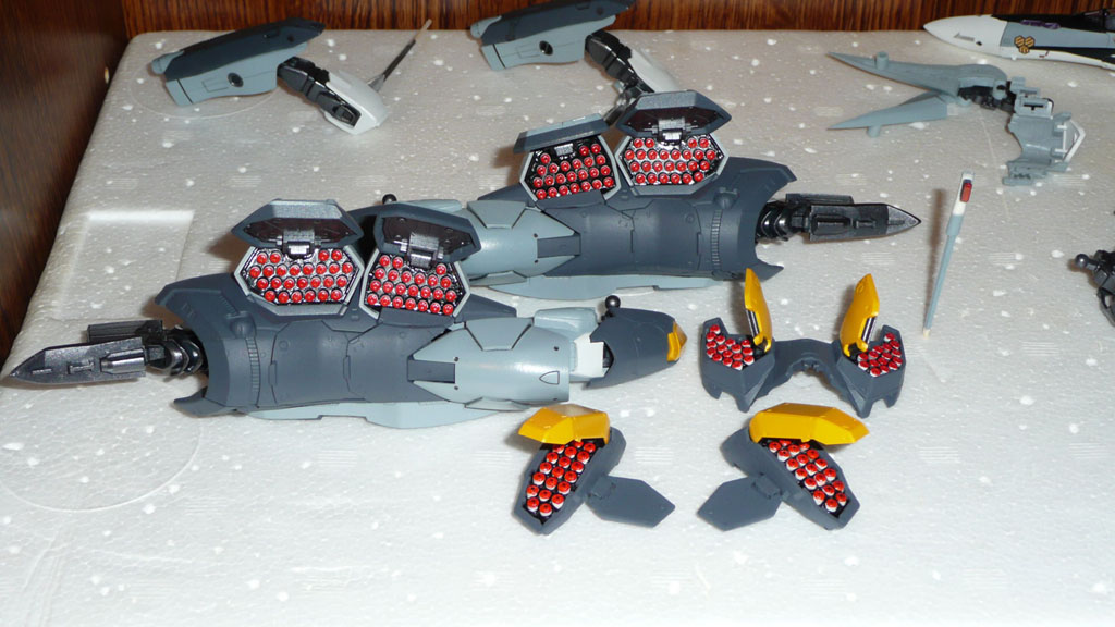

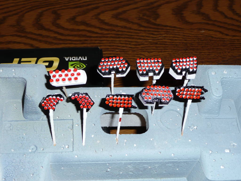

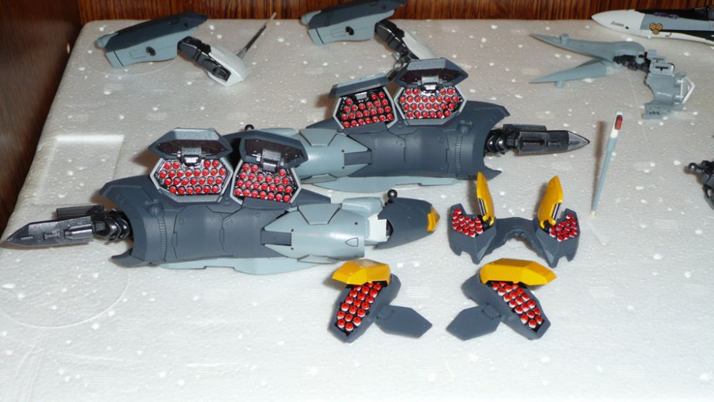

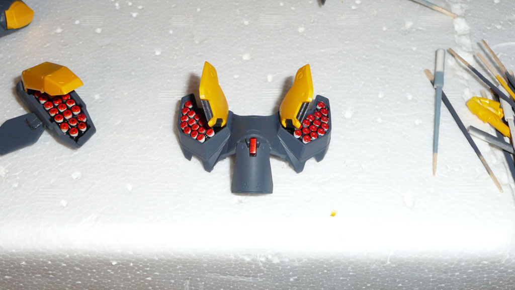

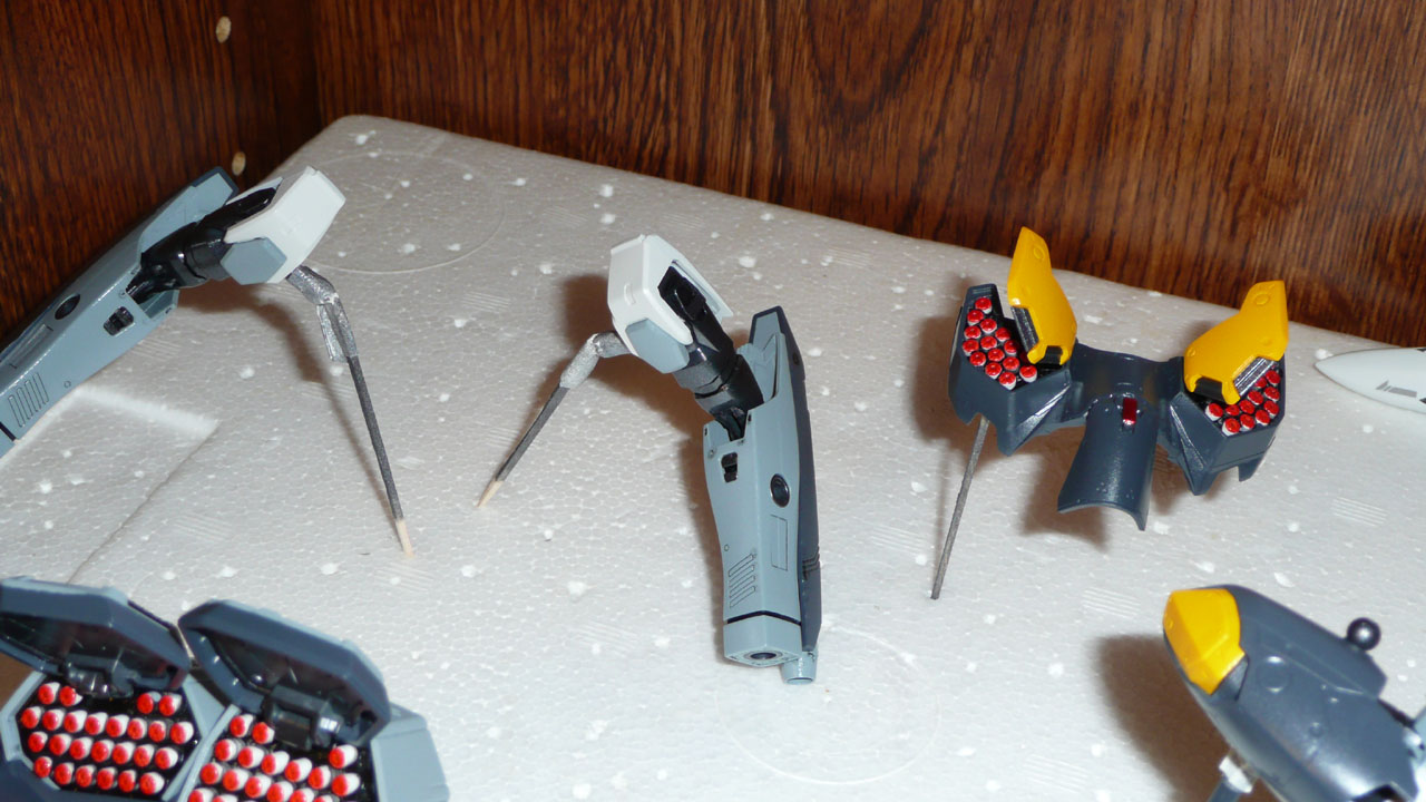

And now, the parts that have terrorized me for weeks: the micro missiles! As is well known, all the missiles are molded as a single solid red block. The thought of having to paint the red tips of each missile often left me curled up in a fetal ball crying myself to sleep at night. Anyway, I painted the missiles the same light grey/off-white as Ozma's fuselage, then used diluted black paint to color the base of the missiles black (kind of like a wash), and then sat there painting each of the tips with a red Gundam marker.
The use of a Gundam marker proved problematic because, for some reason, Gundam marker somehow managed to seep through two layers of gloss clear coat. I don't know how this could happen, but if I pressed my finger to the red tips, my finger would have red smudges on it. This made using an oil wash very difficult as the seeping red paint messed up the wash color, turning it from dark grey to brown most of the time.
The leg missile pod hatches come with a sticker for the grey border, but no decal. WTF Bandai? No way I'm using a sticker, so I had to carefully mask and spray the border. But I made the mistake of looking at the picture in the manuel rather then the CG model, so the dark grey border is incorrect on mine. Looks alright, but not 100% accurate. Oh well, live and learn. At least it's not a sticker. <_<

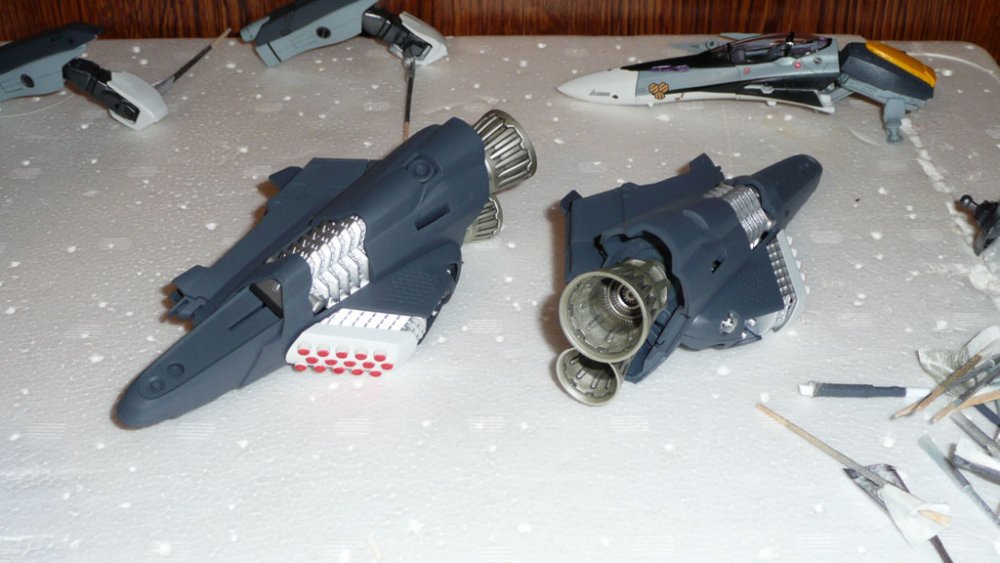

Once I had the micro missiles and hatches finally painted, I was finally able to start assembling the piles of painted parts (alliteration!) that I had lying around. The joint for the chest flap was filled in using a metallic red Gundam marker.
post-5703-1250536870_thumb.jpg post-5703-1250536952_thumb.jpgpost-5703-1250536960_thumb.jpg
Anyway, that's it for now. Anyone with questions, comments, suggestions, or any input whatsoever, please chime in! B))

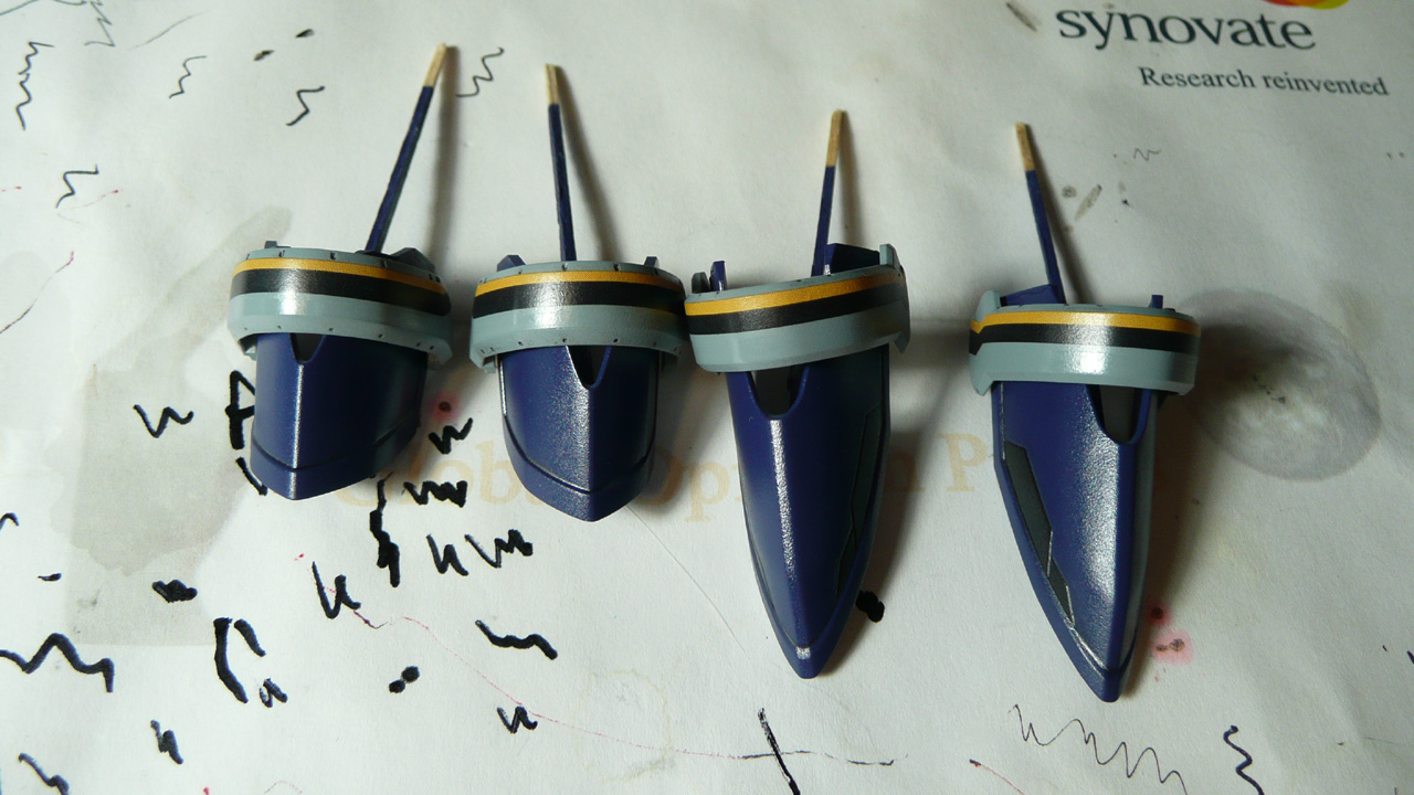

For the boosters I painted them using Tamiya champagne gold (which turned out to be more silver than gold, a good thing). The wash was Tamiya black and german grey diluted in alcohol. I only wanted to get rid of the plastic swirls, but it turned out better than expected. ^_^

Some quick pics. Tried to get a picture of the metal finish on the internals. Navigational lights were painted using clear red and clear blue over a silver base.

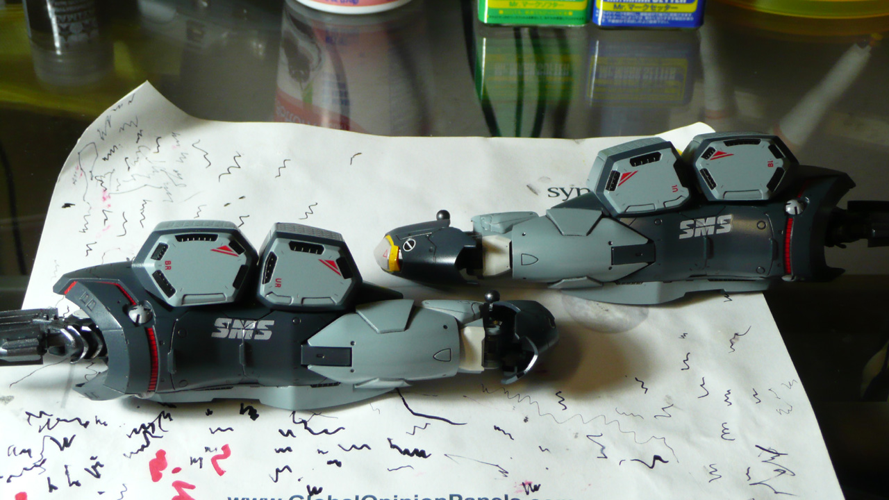

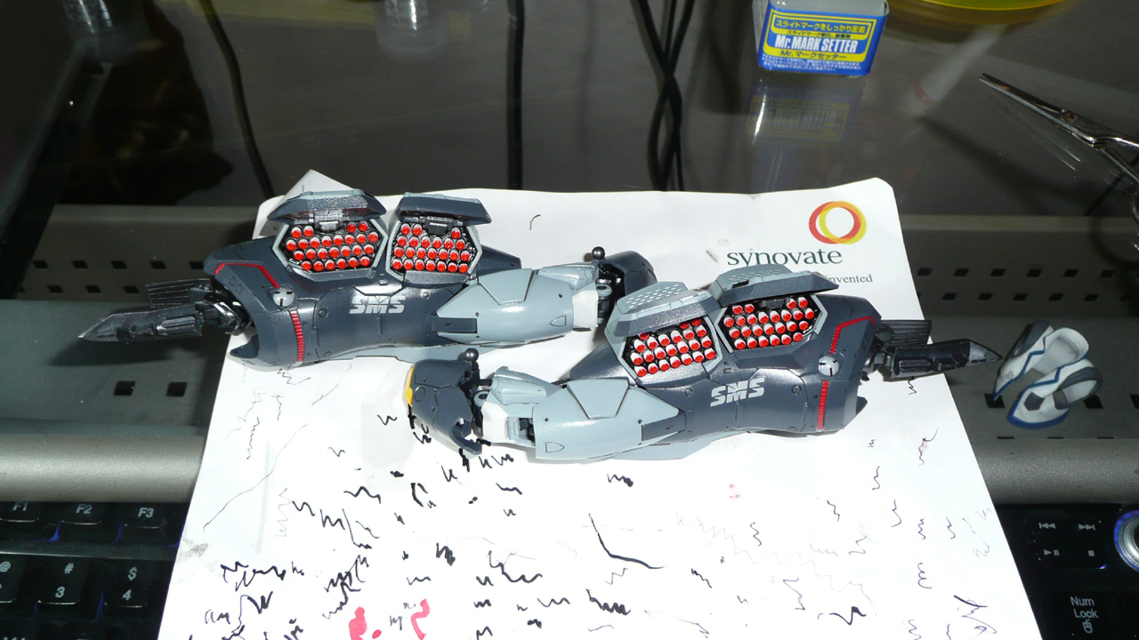

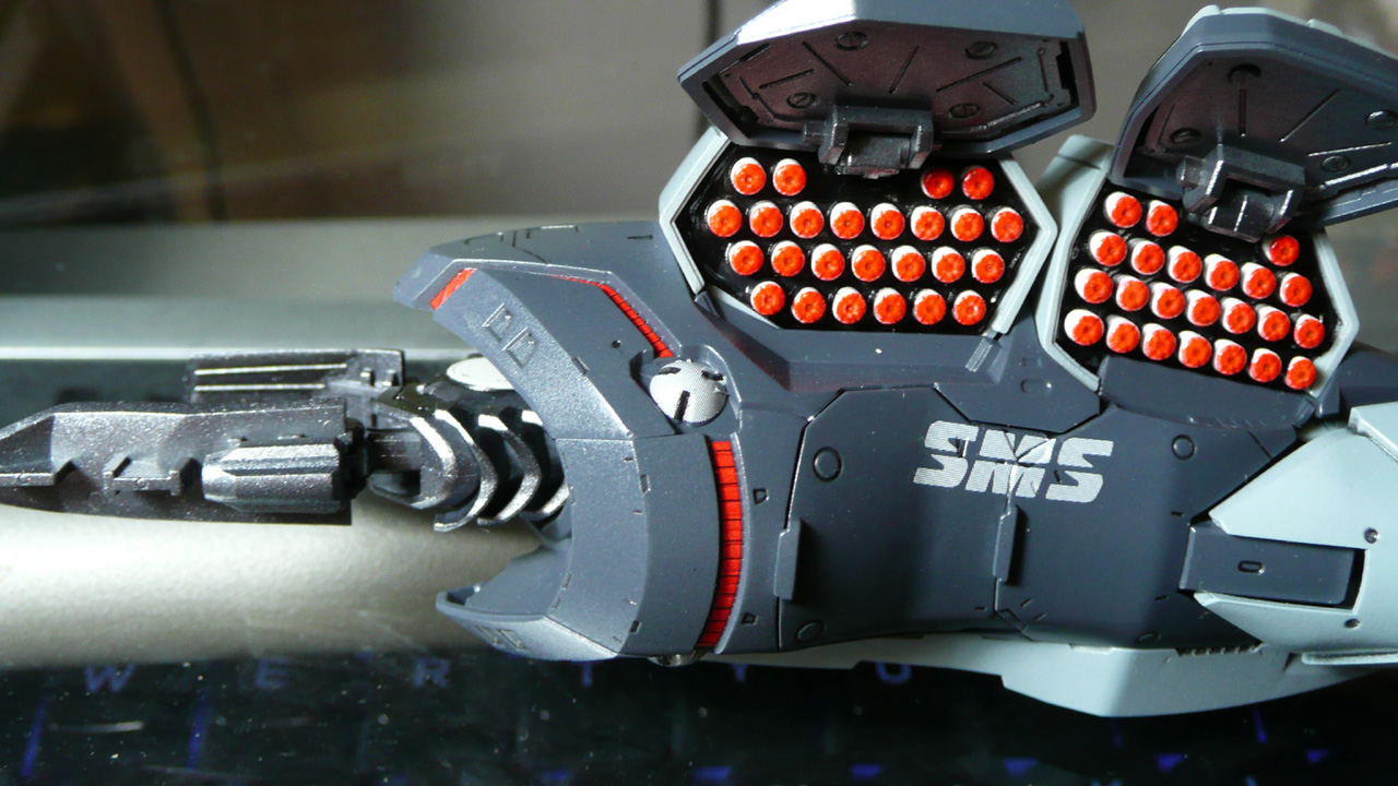

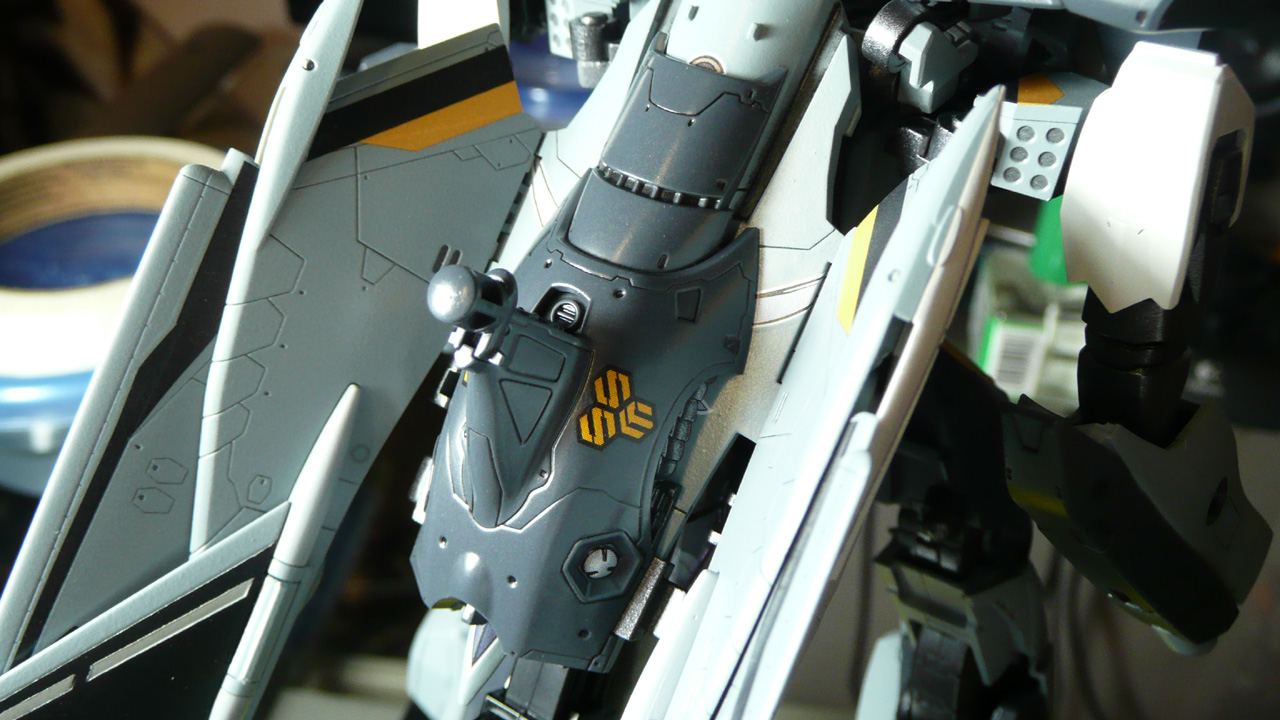

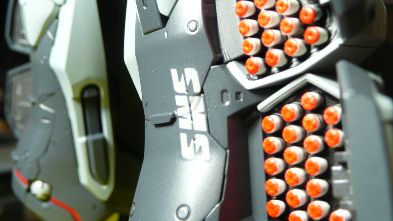

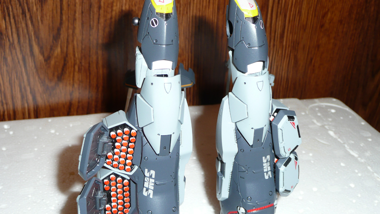

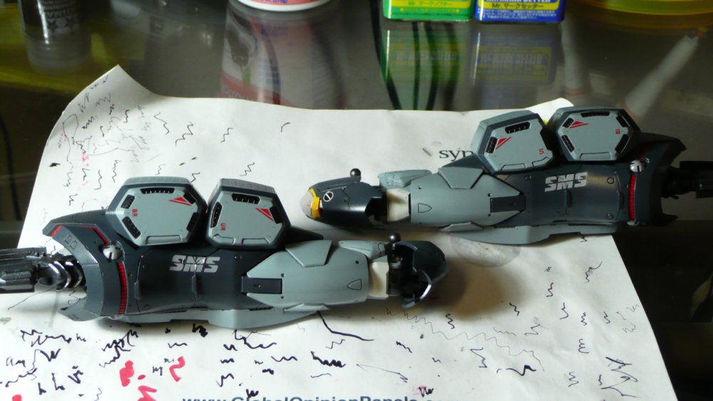

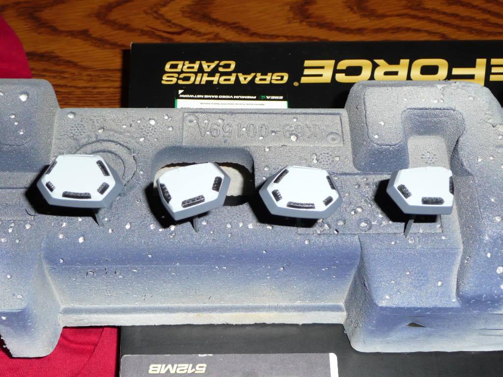

Brief update today. Haven't had time to make much progress, but I did get around to panel lining and getting a few decals applied to the legs. Just like with the plain VF-25, the Armored decals are the same thick, cheap decals with a noticeable dithering pattern from the silk screen or whatever it is Bandai uses to produce them. And of course the decals don't actually fit into the sections they're meant to cover! Familiar territory for anyone who's tried to decal any VF-25.
Armored decal 8: What the hell was I thinking trying to use this decal? Trying to fit a cheap Bandai decal over a semi-spherical surface? Wrinkles ahoy! A generous helping of Mr Mark Softer helped a little. I regret not going ahead and painting this part.
Armored decals 38, 39, 40, 41, 42: These decals are the red striped sections on the ankle sections. They're more or less the right shape, but they're too short to stretch across the length of the recess, and they're not wide enough either. But it's passable since it's not terribly noticeable unless you look really close. It might be harder to mask and paint because it's such a recessed area.
Armored decals 33, 34, 35, 36: These form the SMS lettering on the leg armor. You have to line up the decals over the curved gap in the armor plates. It's actually easier than it sounds. However, I noticed that the instructions have the numbering backwards. Decal 35 should be on top, and decal 36 on the bottom. Good job, Bandai!
Will update with close up pics when I get home.
EDIT: Added close up of the leg to show off the dithering on the decal, the wrinkling and improper size. :(
post-5703-1251222054_thumb.jpgpost-5703-1251260074_thumb.jpgpost-5703-1251271232_thumb.jpg

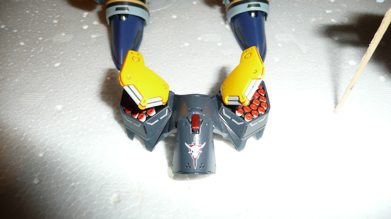

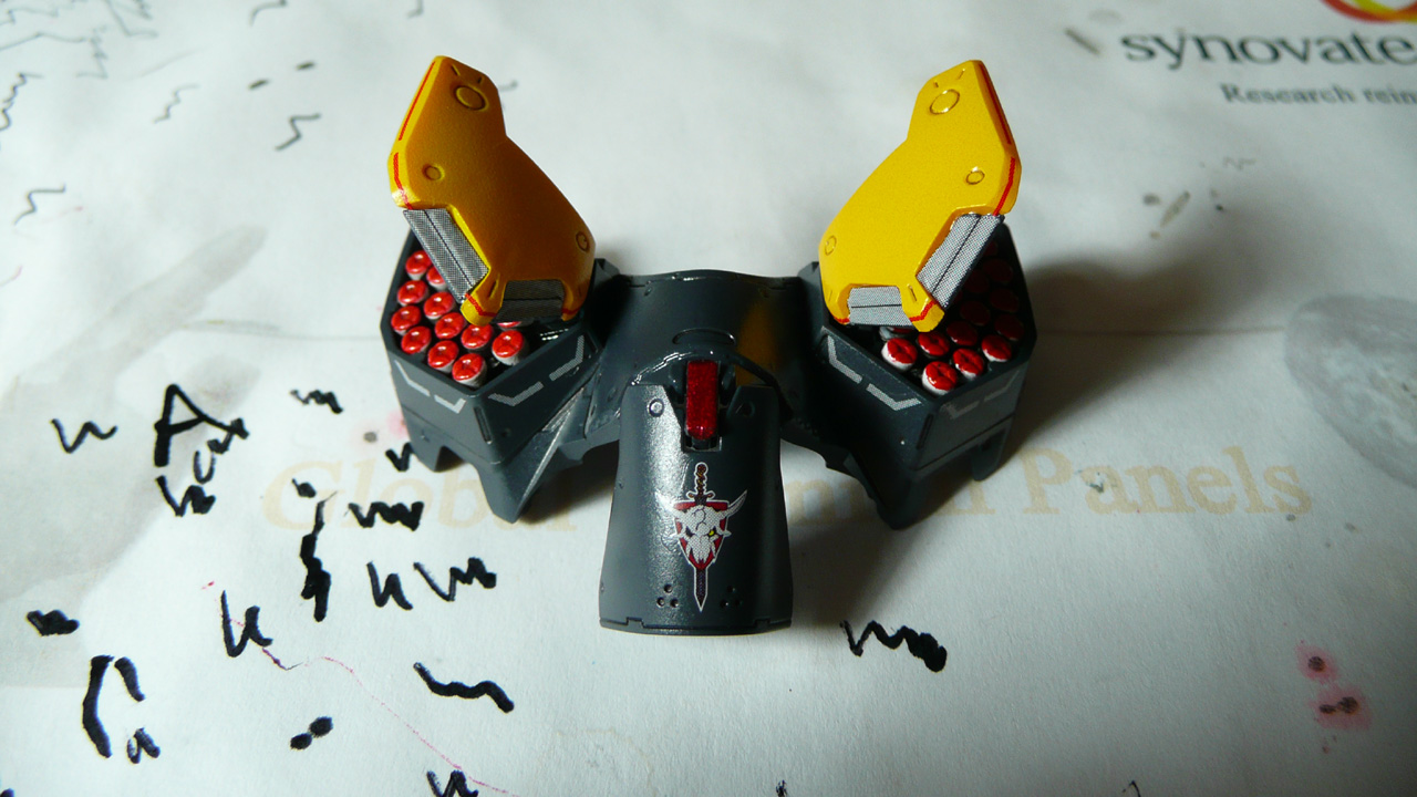

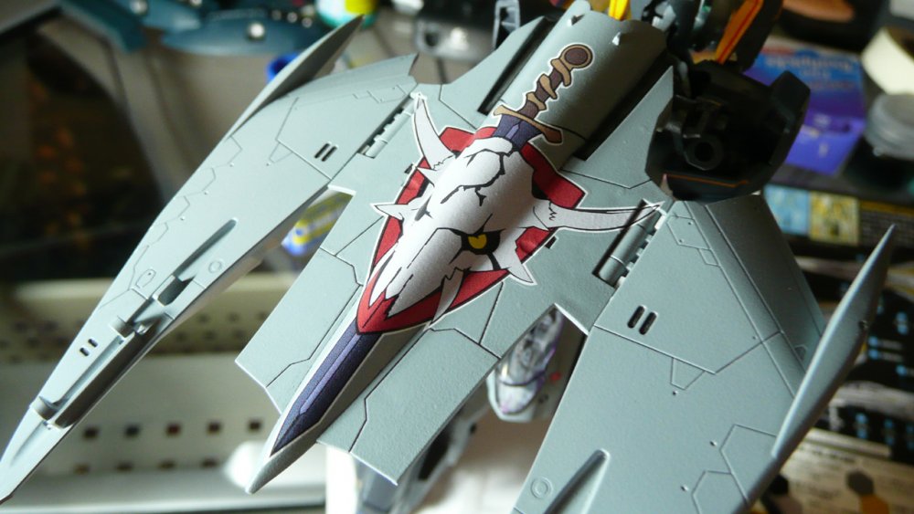

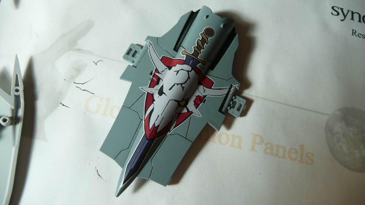

A note on the chest decals: for the love of all that is holy, I highly recommend trimming them into smaller sections!
The grey section of the chest missile covers and surrounding red trim are all one big C-shaped decal. Given my previous VF-25 decal experience, why I didn't think to cut this obviously pain-in-the-ass decal into smaller parts I can only attribute to a momentary lapse of insanity/cockiness. Trying to line everything up perfectly on such a f'd up shape was an exercise in futility.
It's going to take a lot of Mr Mark Softer to flatten this mess out. I avoid using this stuff as much as possible on these models because with Bandai's decals it takes forever for it to soak in; it'll quickly bead up on the surface long before it gets soaked into the decal, leaving an uneven mess. Basically, whenever I'm forced to use Mr Mark Softer, I have to sit there for awhile lightly brushing the decal with a small brush to keep the liquid from beading up until it finally soaks in and melts the decal.
All of this can be avoided by trimming the decal.
Incidentally, right after this, I started on the much-maligned ankle decals, well known for their tendency to wrinkle up and tear and being a royal pain, and was able to apply them flawlessly. :wacko:

Yeah using Mr Mark Softer is very unwieldy with these. If you gotta use it, use it, but be prepared to deal with the slow absorption and beading up of the liquid.
I'm probably going to trim the grey parts off and then just paint those sections. The dithering pattern on the decal is pretty clear and distracting in that photo, and it's still not perfectly lined up.

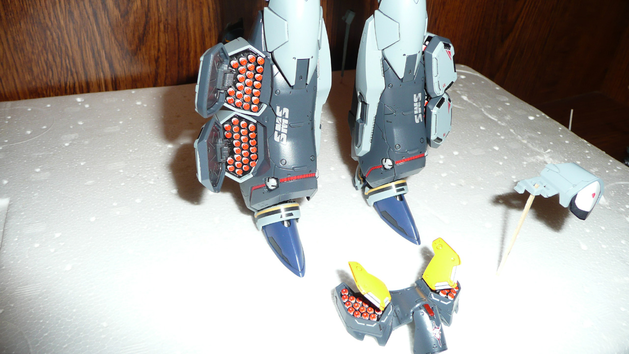

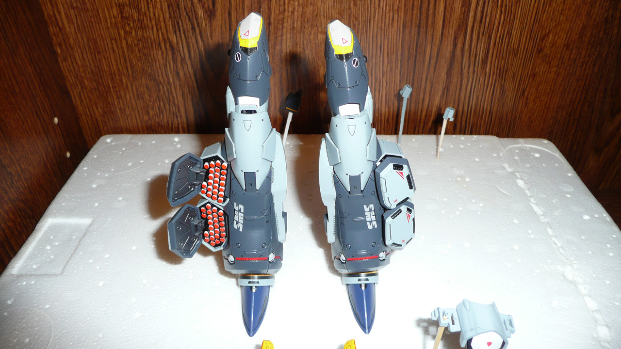

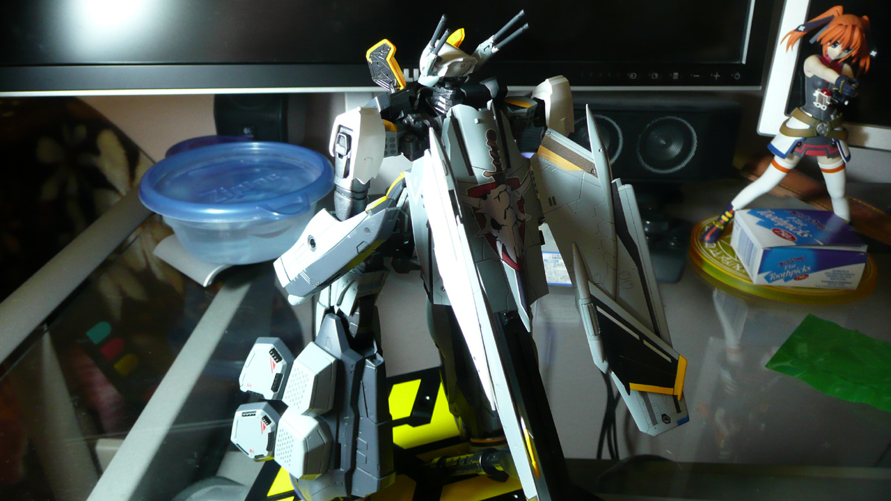

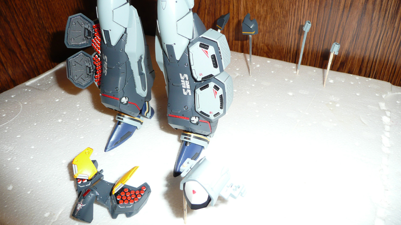

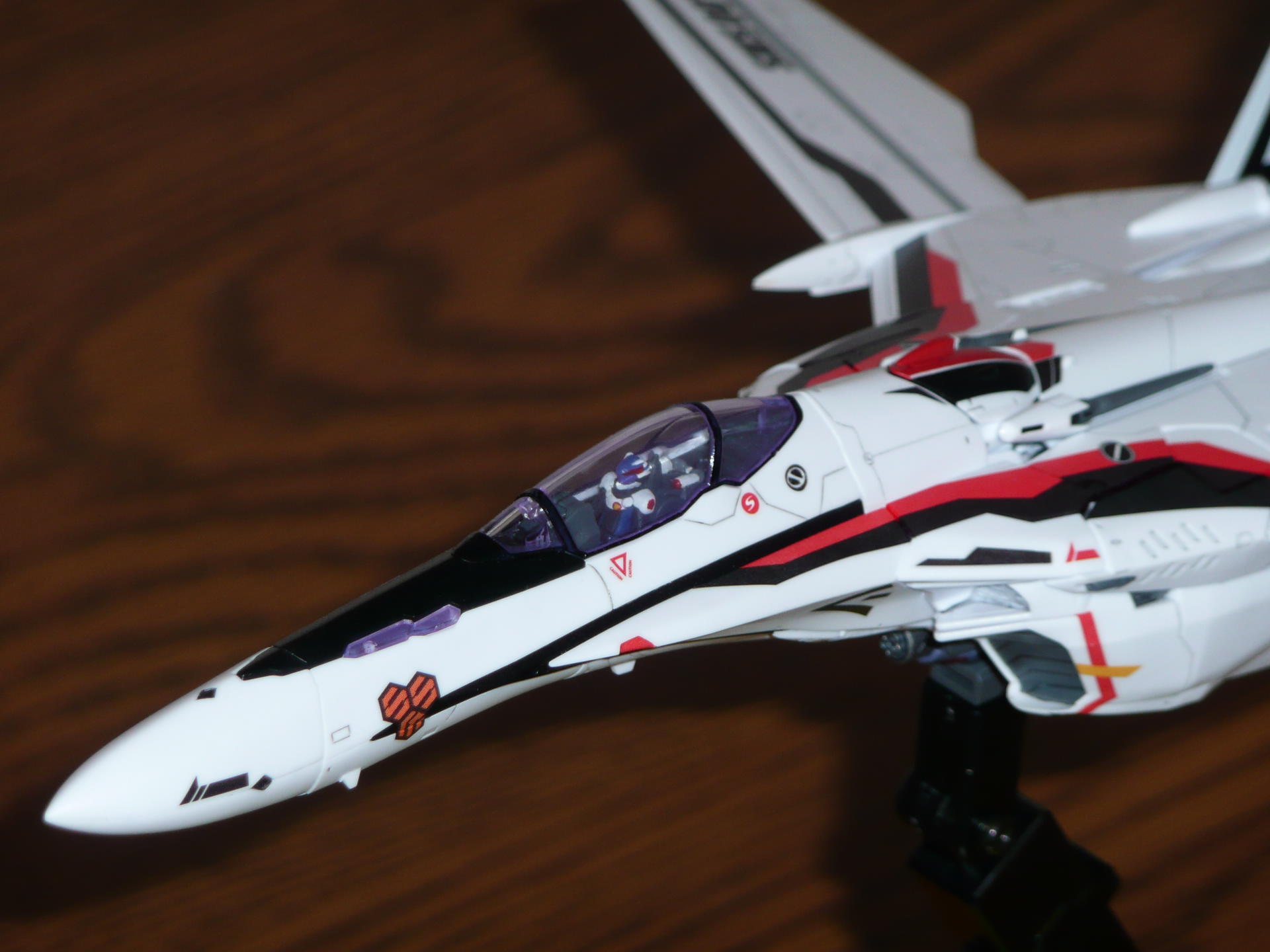

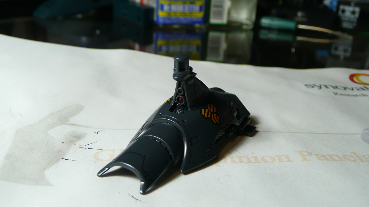

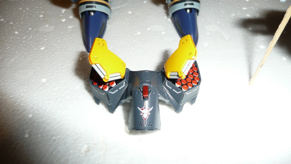

Managed to squeeze in a little progress today. Hopefully I'll get some more time with the long Labor Day weekend.

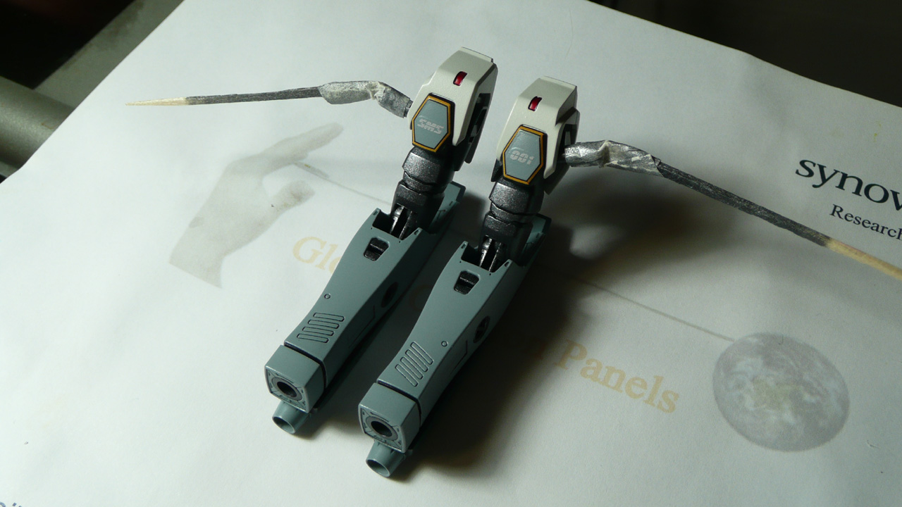

Finished the arms finally. They're not terribly complicated; I just felt reluctant getting to them after the ordeal of the shoulder hex decals on the VF-25F. Although I think I did a serviceable (though not great) job on Alto's, this time around, instead of trying to apply the entire decal at once, I cut it at the corners into four separate pieces. This didn't really make things any easier, as the decal is a poor fit to begin with, and trying to line up all four pieces was a vicarious experience. But it did allow me to avoid the wrinkling issues that have plagued many a VF-25 modeler.
Once I got the hex decals on, the rest was a breeze. Painted the edges of the hexagons black as it's supposed to appear; the pro modelers never bother for some reason. Just like the underside of the lerx. <_<
The shoulder sensors use another pair of ill-fitting decals. I just painted them in with silver and clear red.

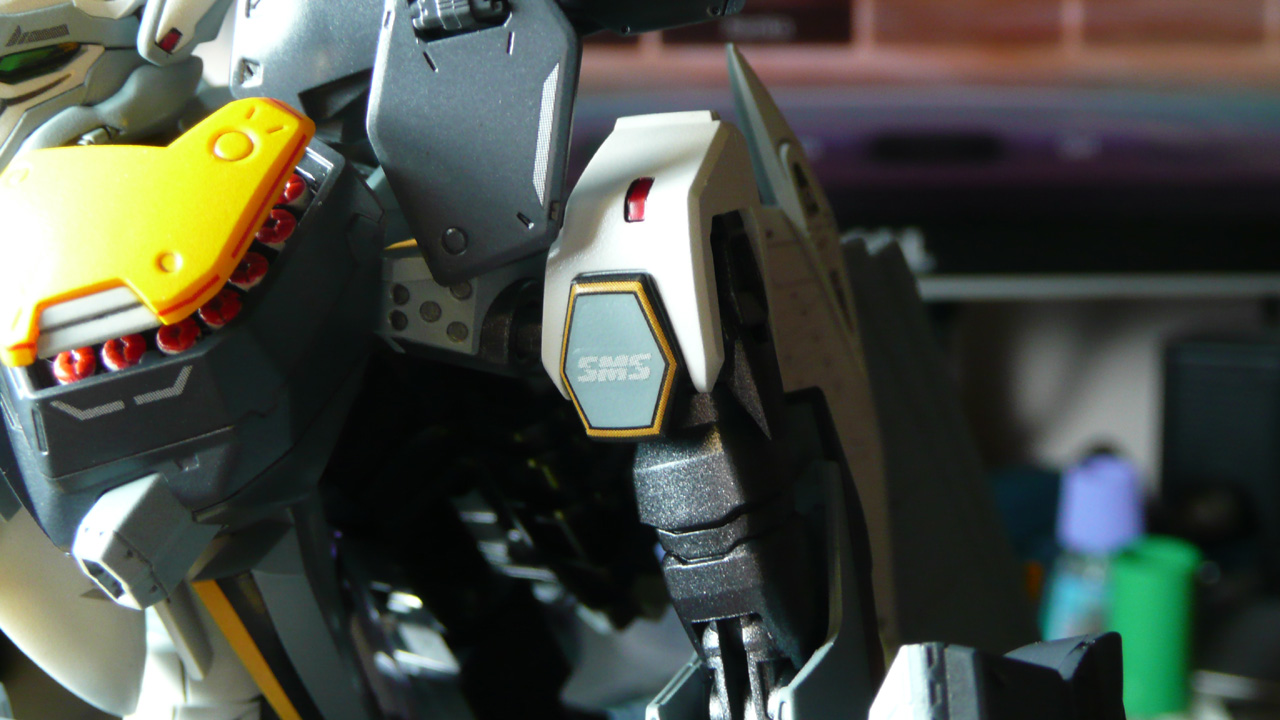

Been meaning to ask how you did the shoulder hexes. So you cut them into 4 pieces, not 6, right? Just wondering how you handle the overlap that I'm guessing occurs at the edges? Doesn't look noticeable so whatever you do is worth imitating! :)
Link to comment
Share on other sites
I trimmed them at the upper and lower corners, skipping the "middle" corners. Good grief it'd be too much of an ordeal trying to line up six decals into an even hexagon, considering it's a bit dodgy with four. :lol:

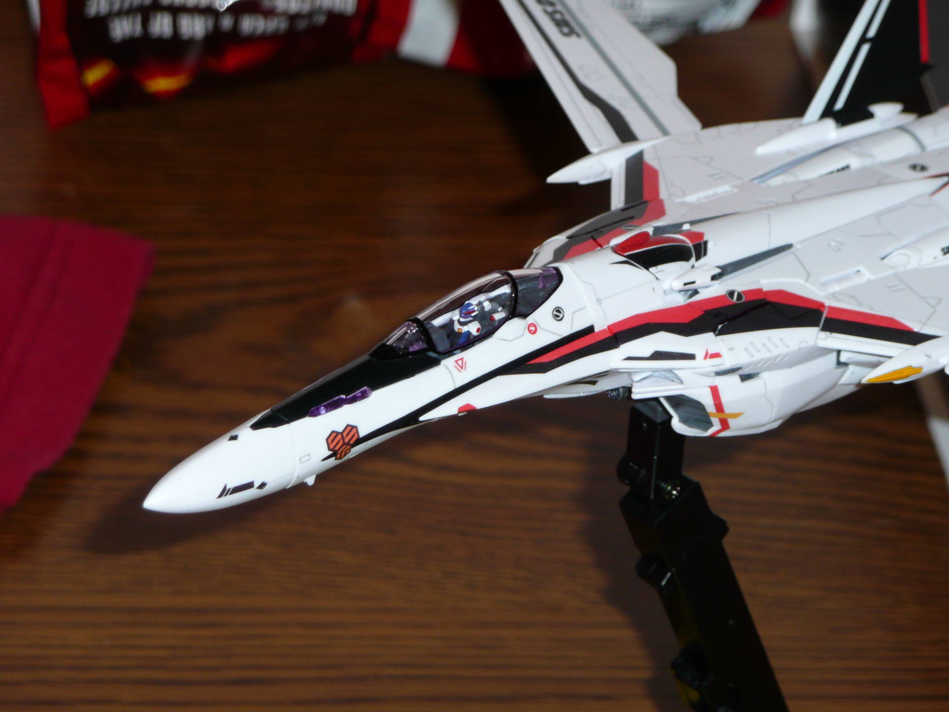

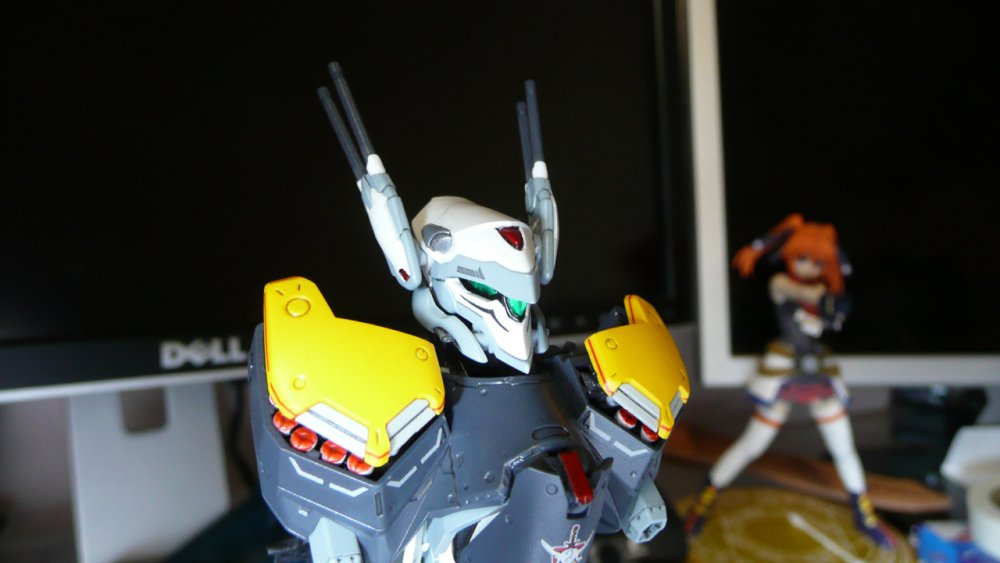

Despite the long three day weekend (for us in the States), I didn't get to spend much time working on it. <_< Most of the remaining parts are in that limbo state of being painted but still needing panel lines/decals/clearcoats/whatever. But I did manage to get enough done to start assembling some sections. It's starting to look like a VF-25 finally! :wacko:

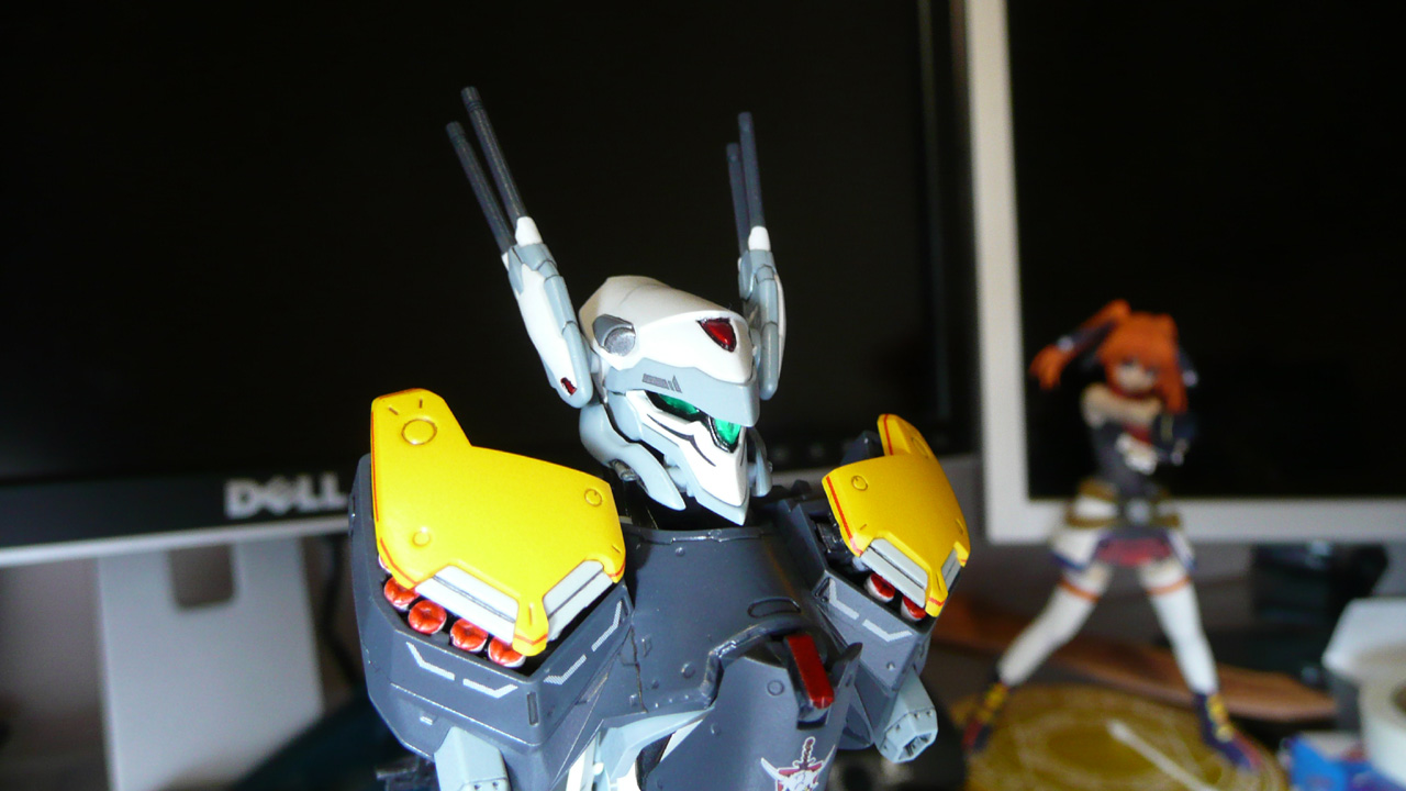

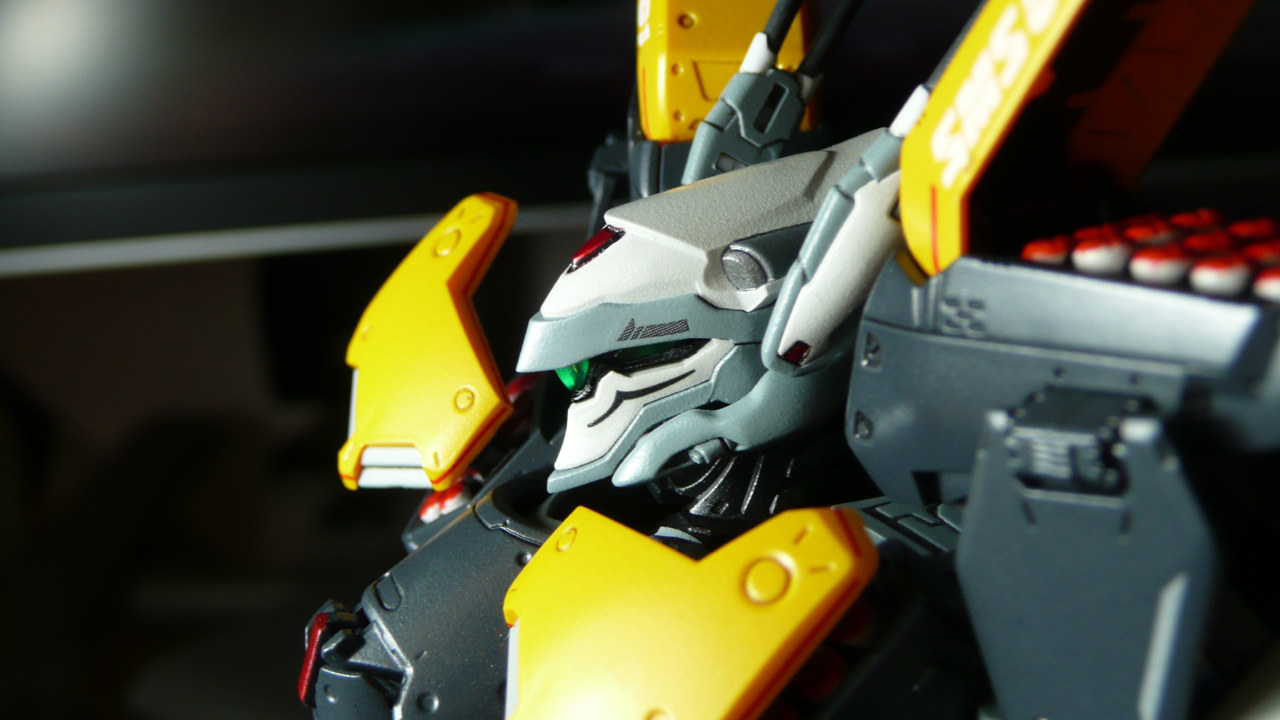

There sure are a lot of WIP VF-25G's in the wake of HLJ's clearance sale. :rolleyes:
Yay! Ozma's unit finally has a head!

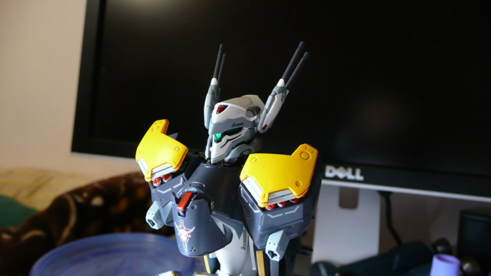

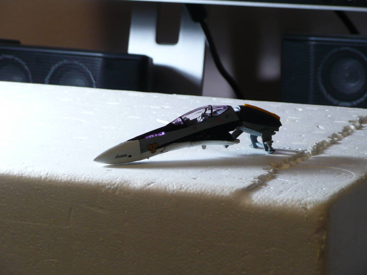

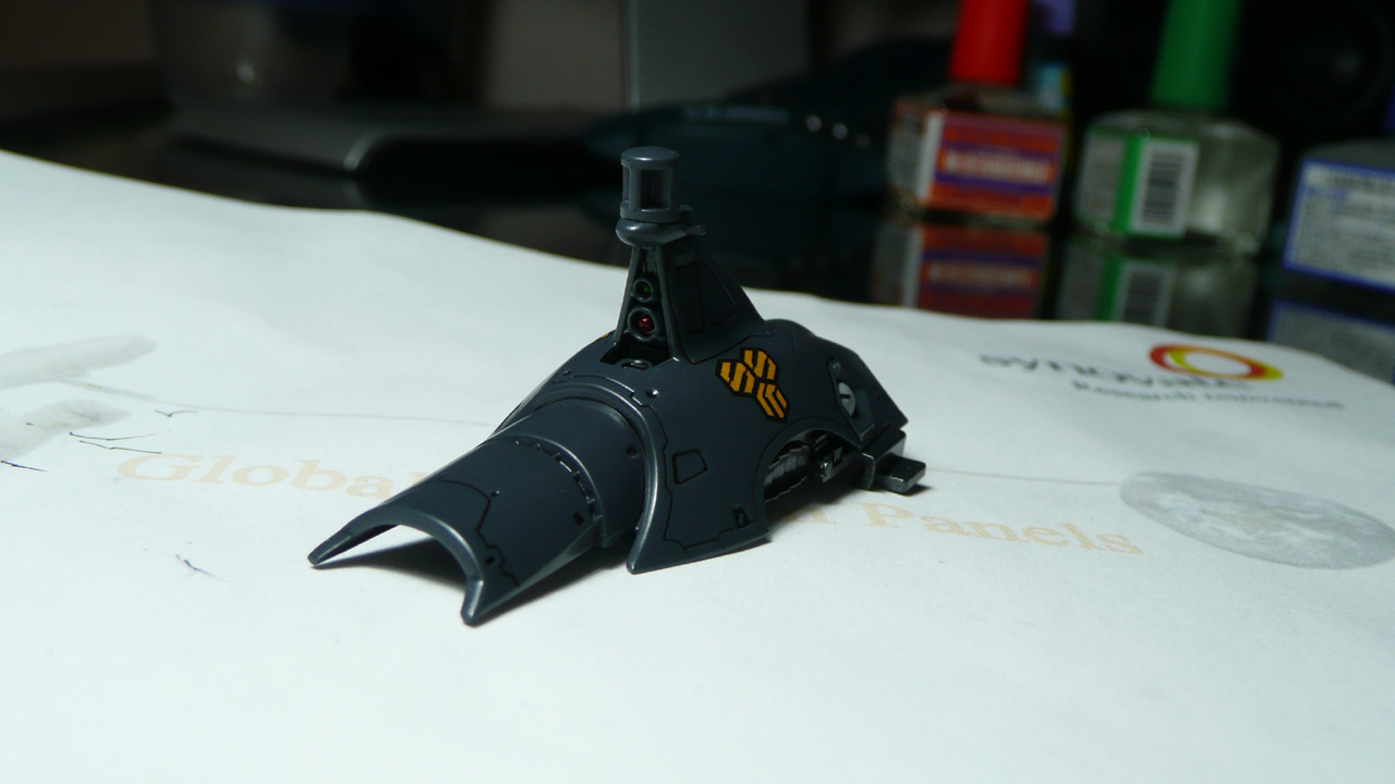

The 25S head has more moving parts than the 25F; the head collapses downward and the side vents swivel up and down, in addition to the head turrets. The head was somewhat difficult for me because it involved a fair amount of hand painting, which is probably my weakest skill. The black area around the "eyes", red sensors, base of the head turrets, and those grey thingamajiggers on the top of the head are hand painted.
The kit does not have decals for any of the sensors. You get one wonderful foil sticker for the big red sensor at the top of the head. And another for the eyes.
The single hardest part for me was just attaching the head to the neck because of the collapsible head. I accidentally chipped the chestplate while fidgeting with it. :angry:

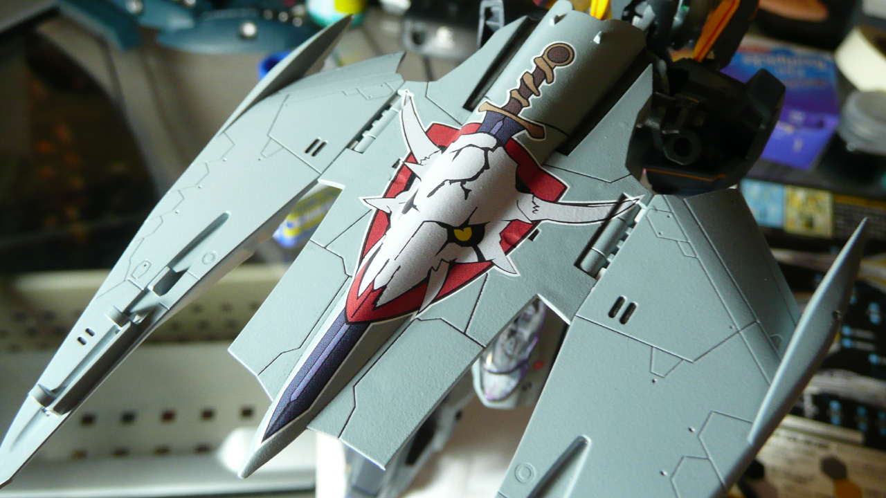

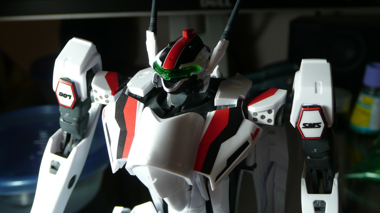

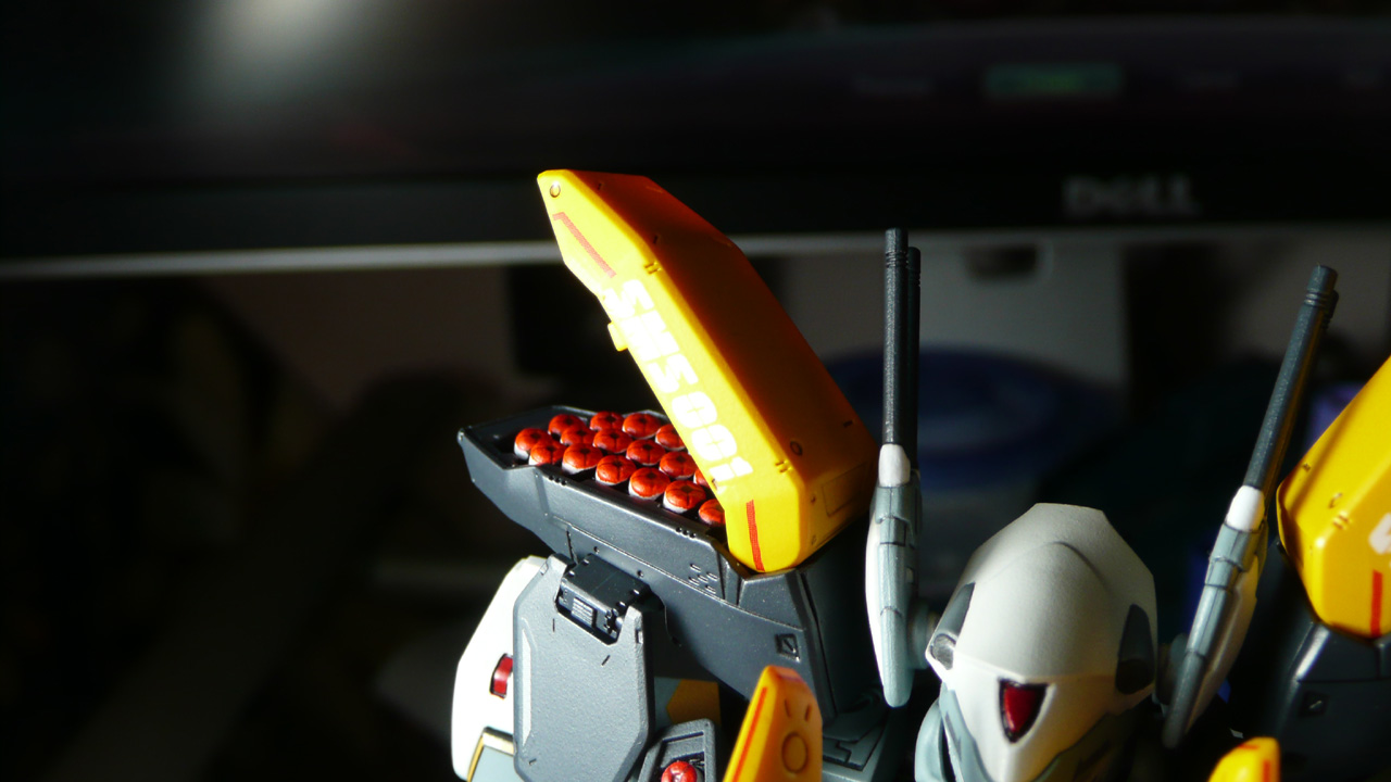

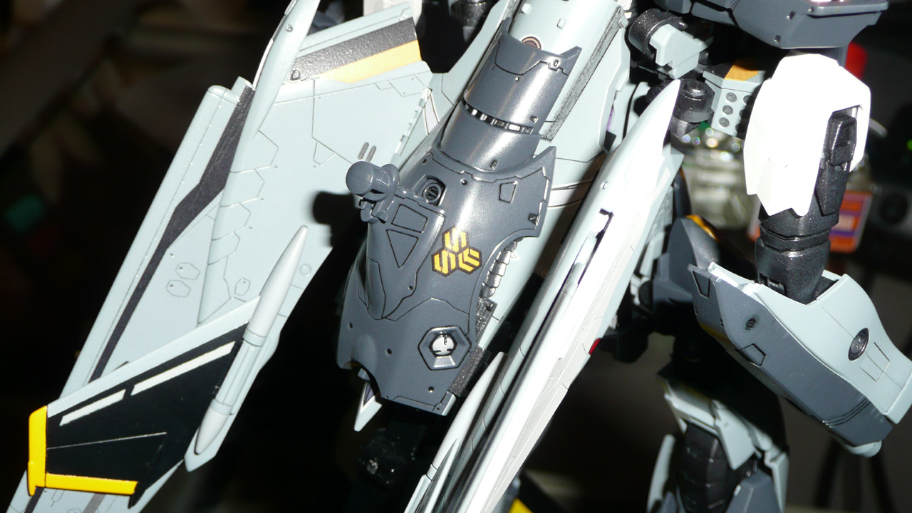

I take back everything I said about previous decals: the shoulder hexes, Alto's head stripes, everything. The worst decal I've dealt with is the giant skull emblem on Ozma's back.
I guess it's just because I don't have much experience with such large, irregularly shaped decals, but I had a hard time with this decal. As soon as I lifted it out of the water, it wrinkled up and folded up on itself worse than any decal thus far. Then I spent a few minutes with the decal underwater, trying to flatten it out so I could try to lift it onto the backplate. I've labeled the whole ordeal "amateur hour" because that's what it would've looked like to an outside observer. At one point I chucked my tweezers aside and just used my fingers to flatten it out.
Once I actually got it onto the backplate, the rest was fairly easy. The horns spread across onto the swivel joints for the wings. I pressed it as flat as I could and let it dry before carefuly slicing that section to allow movement without tearing the decal, since this is going to be in battroid mode.

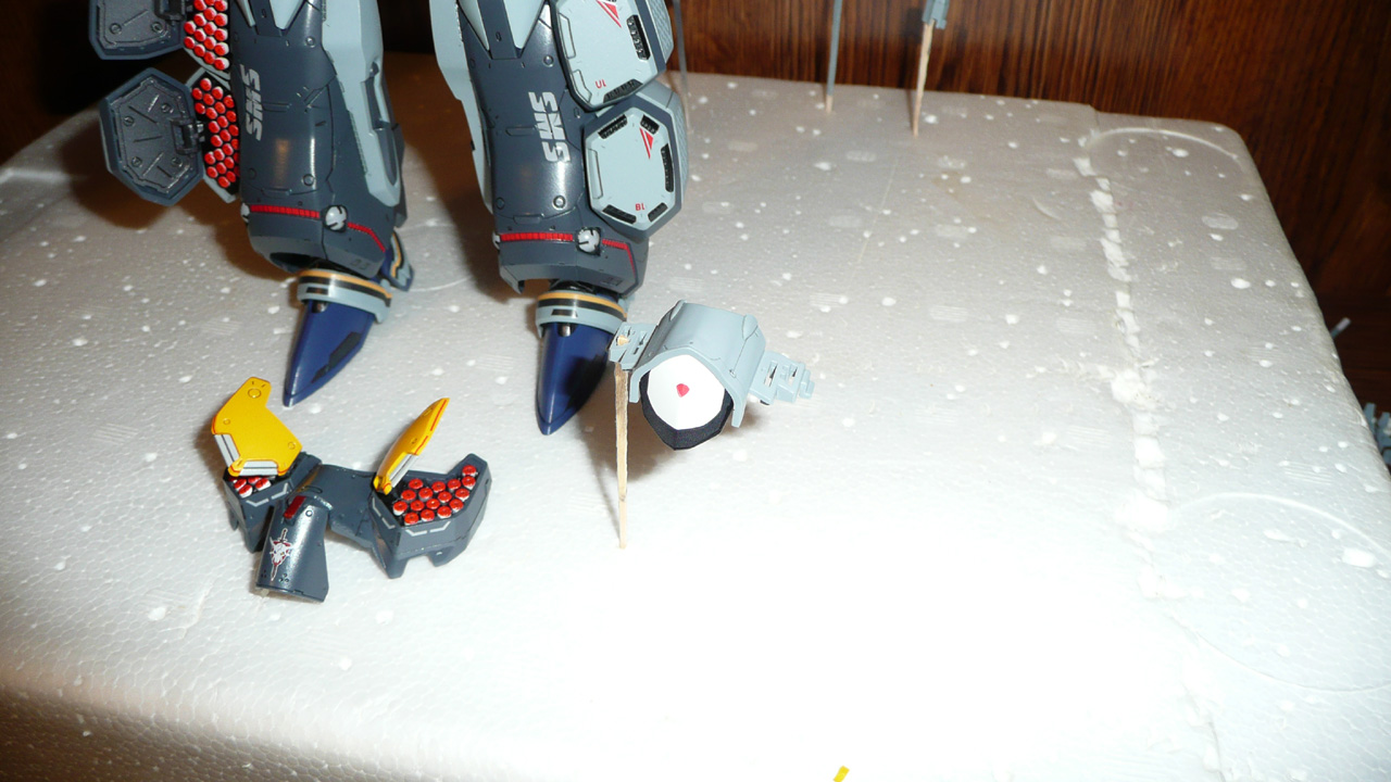

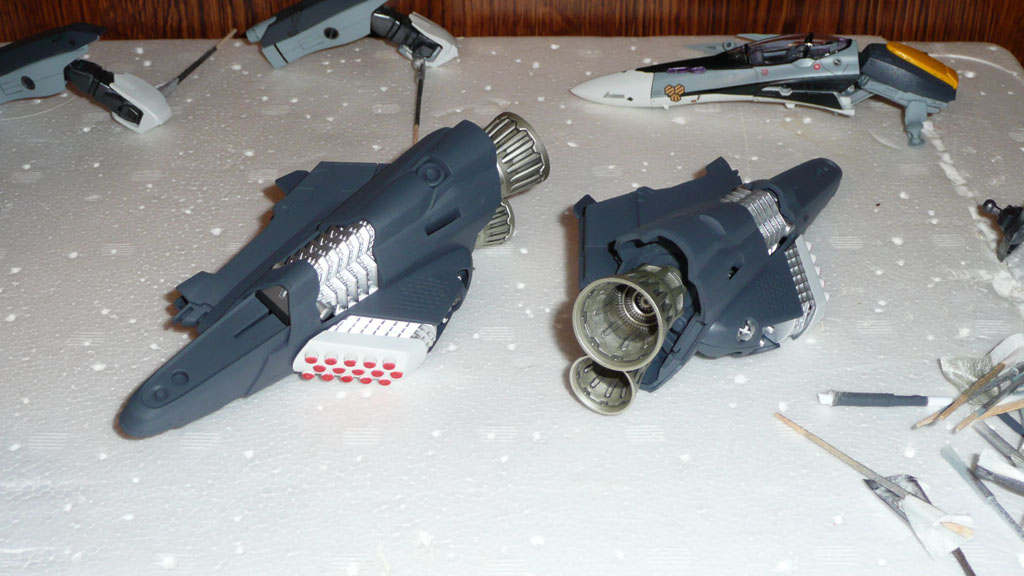

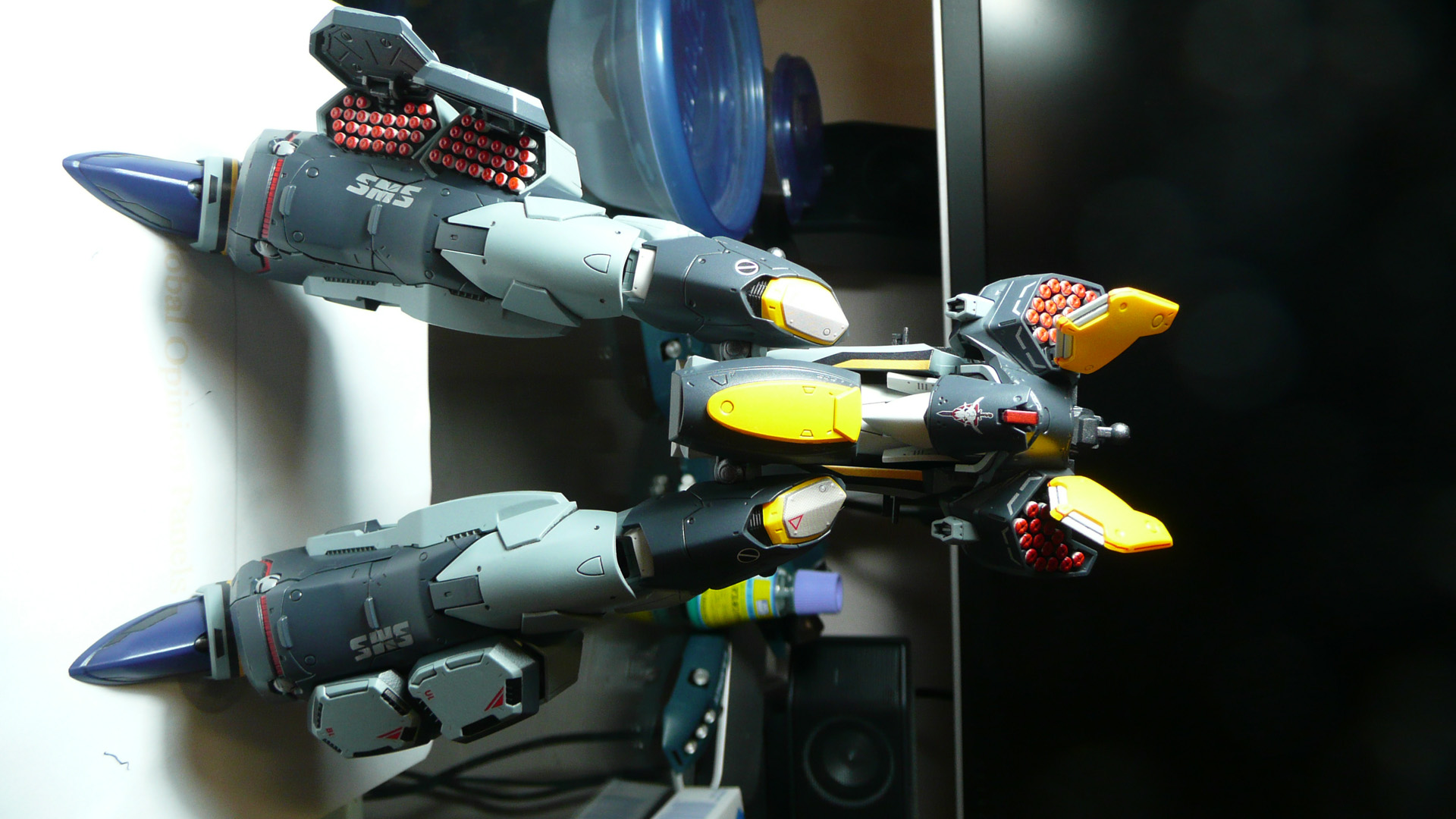

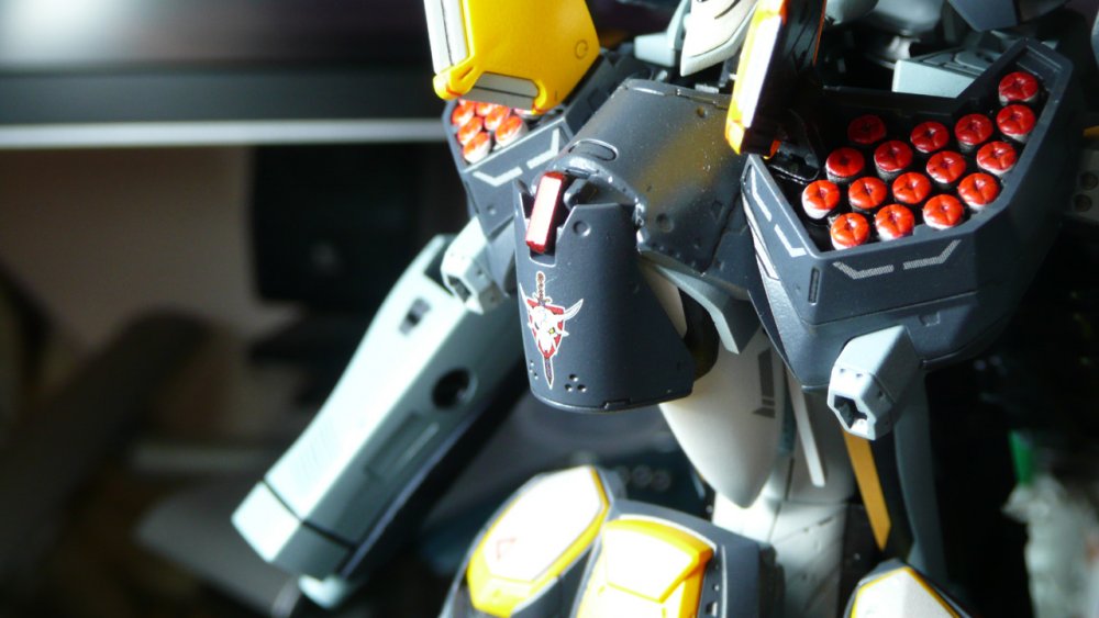

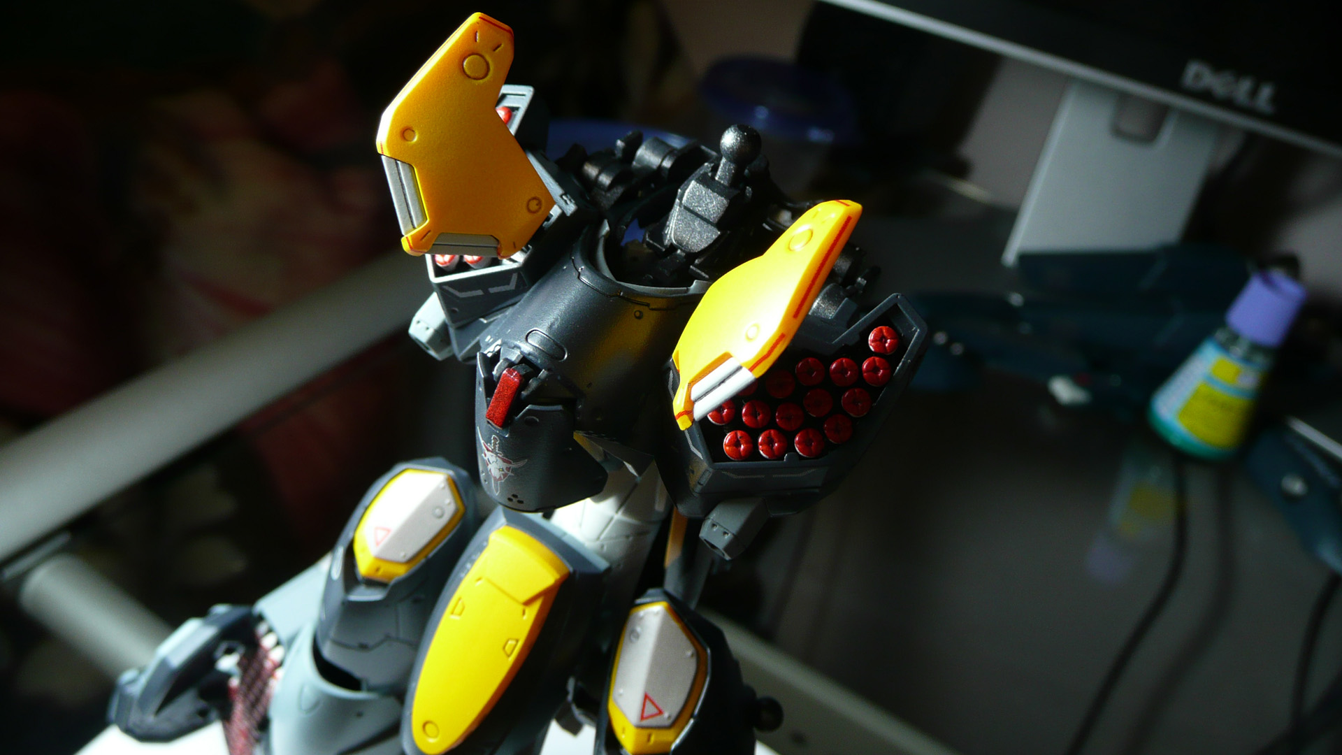

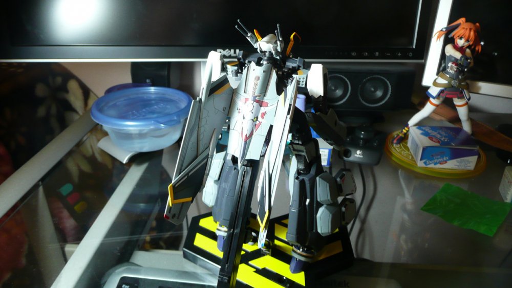

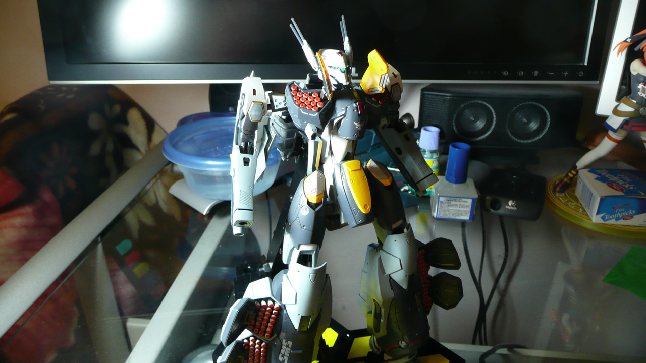

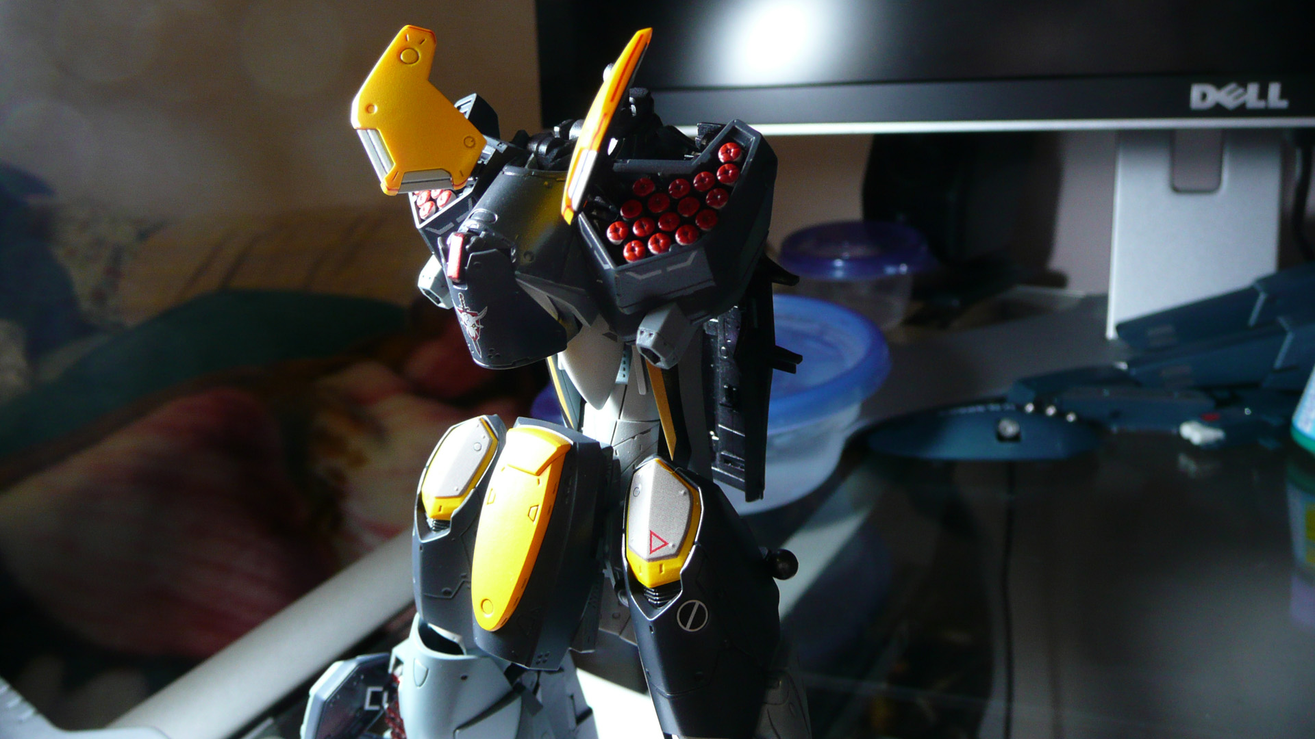

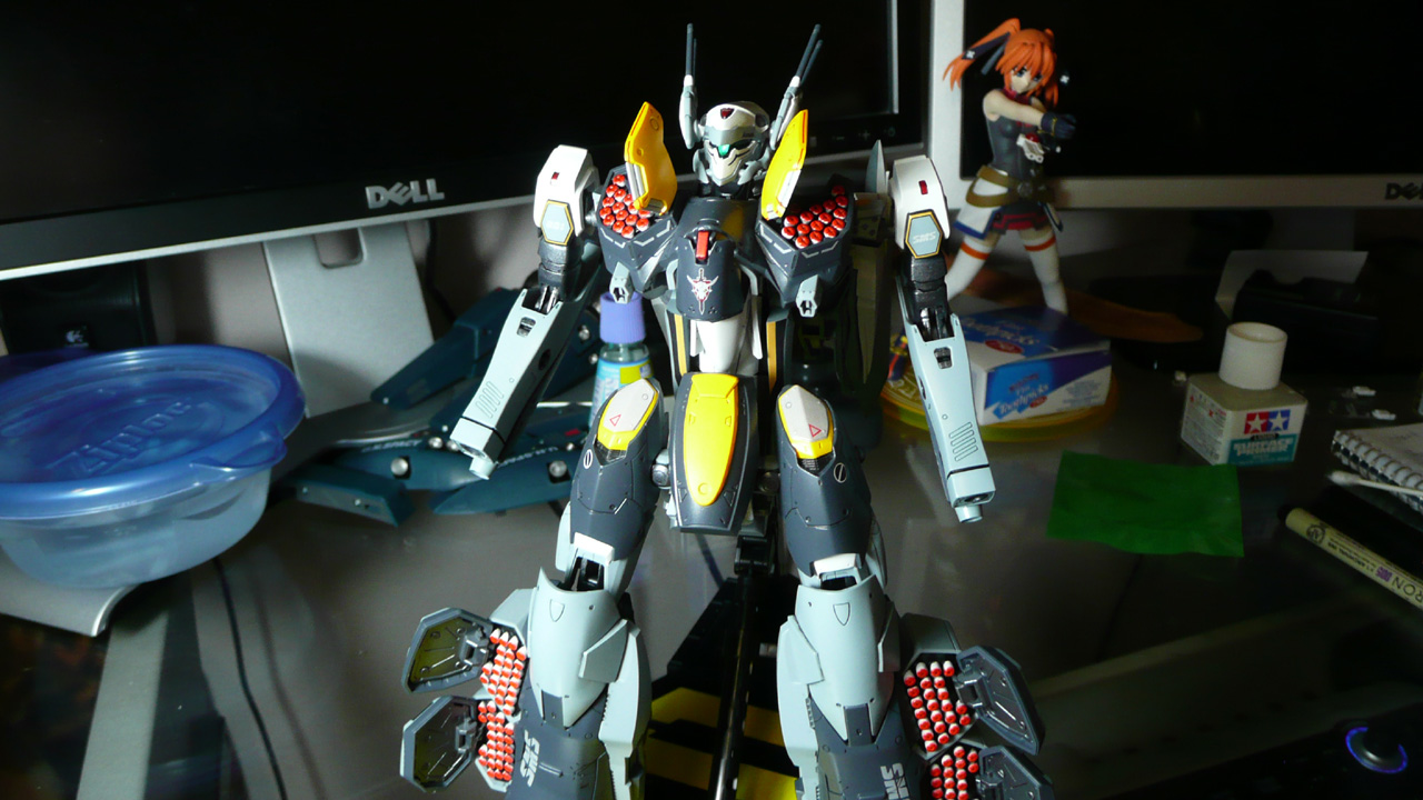

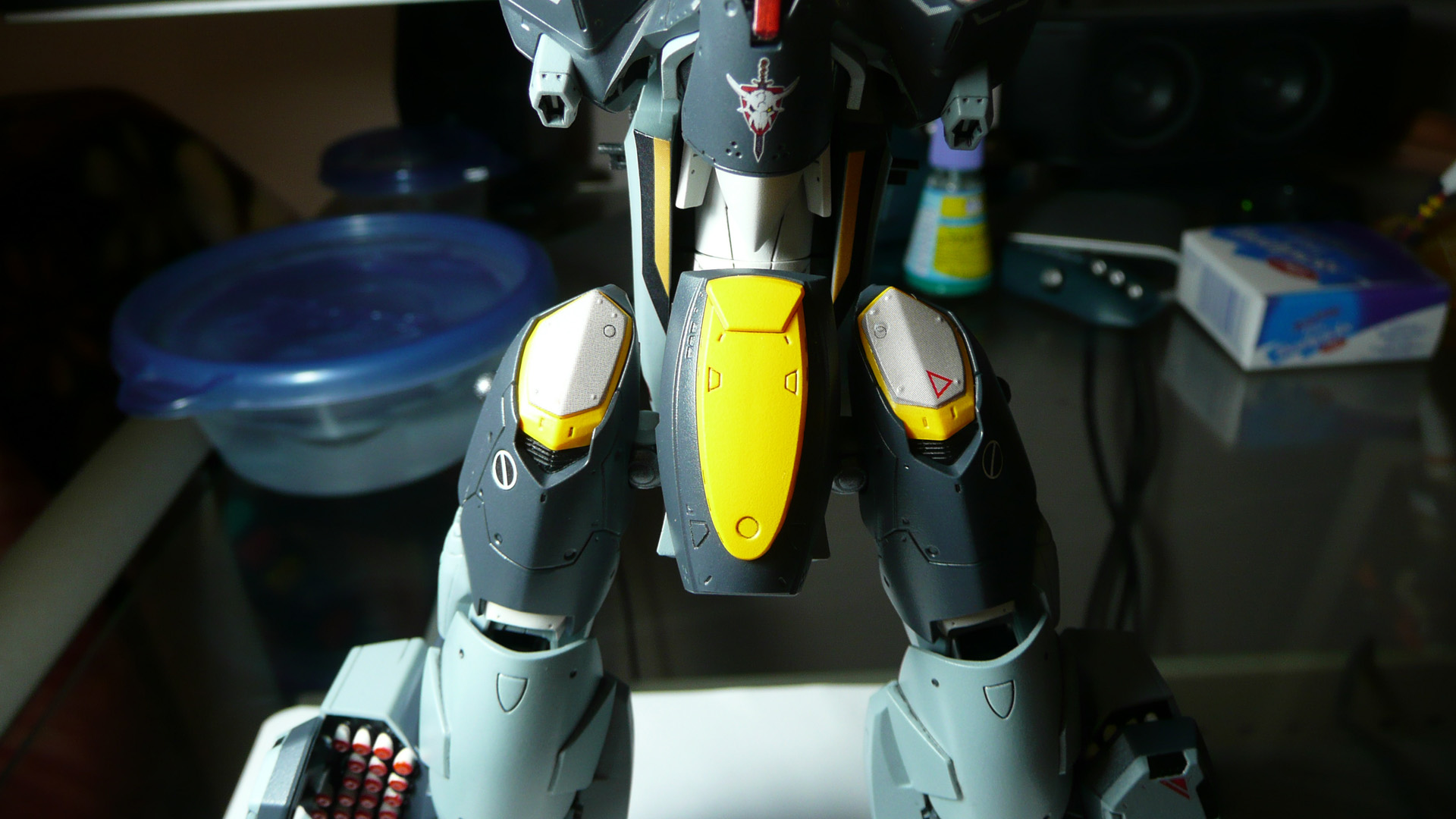

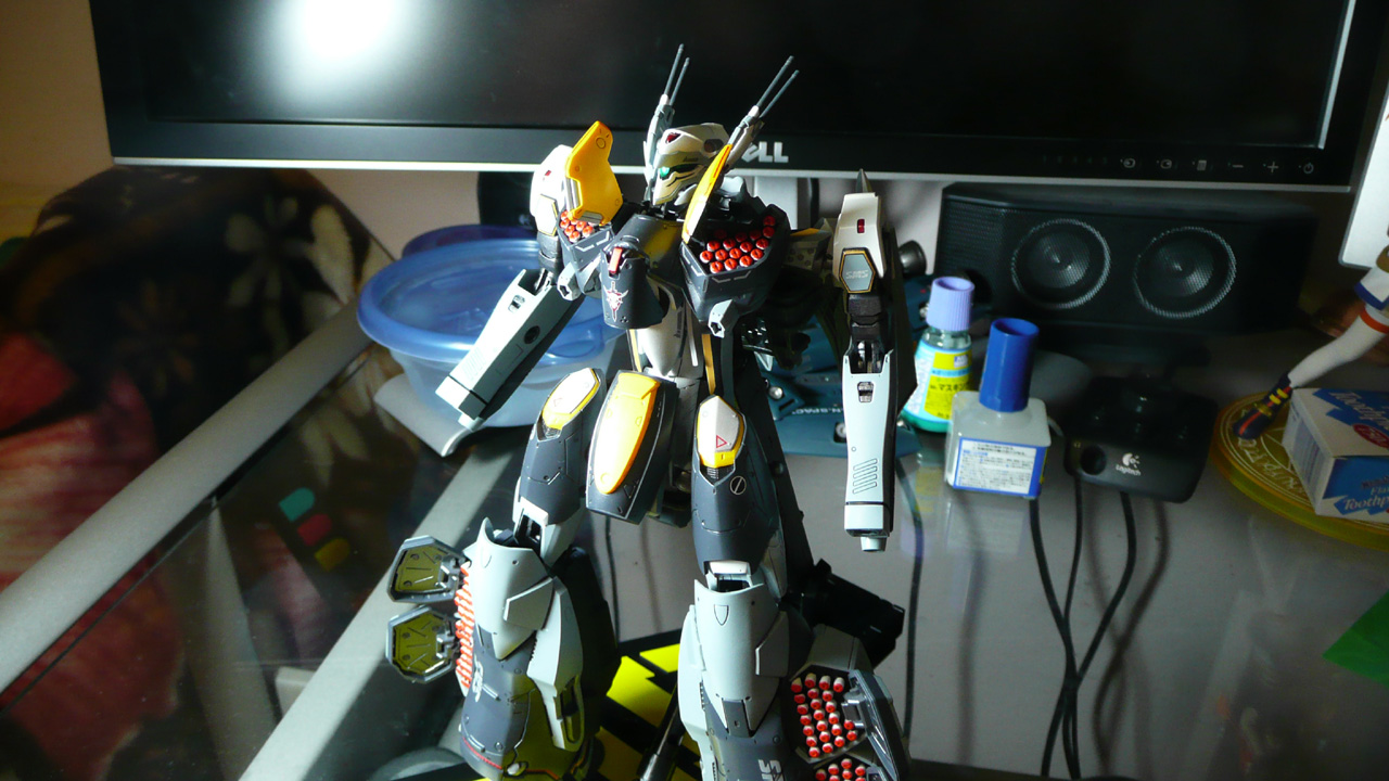

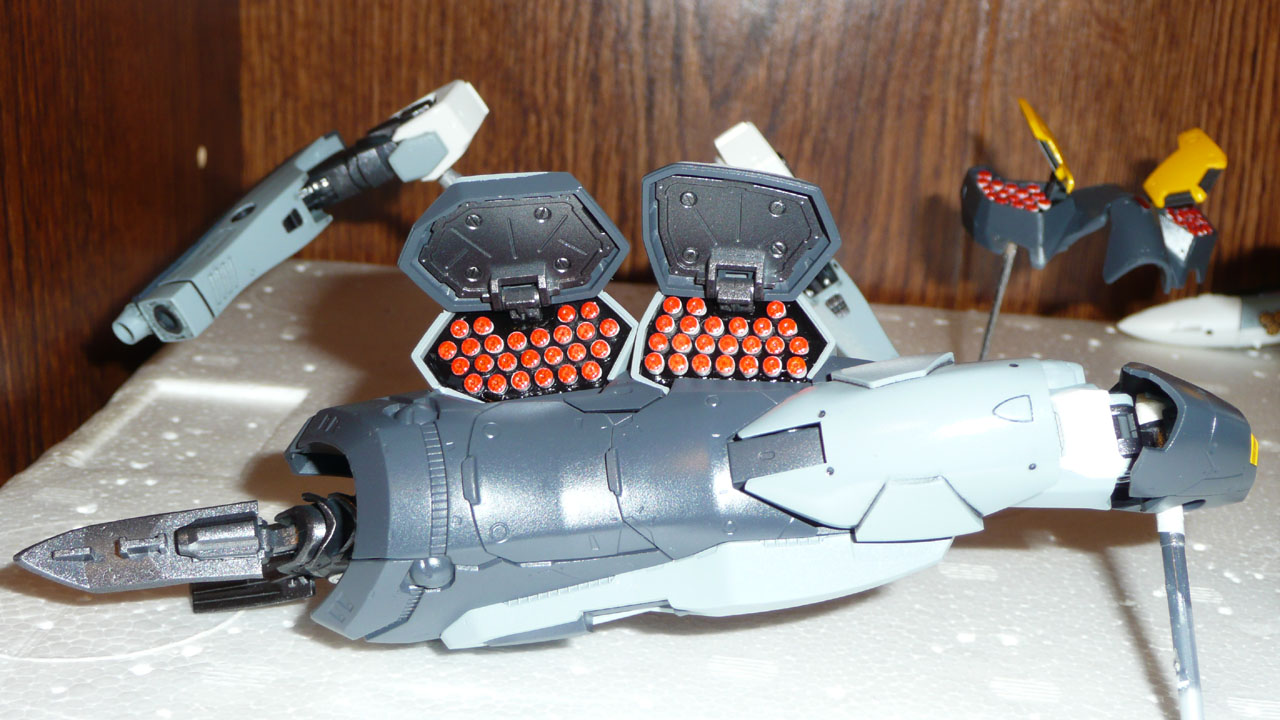

Started assembling more completed pieces together. Nothing much new to add, as most of the parts I've done as of late are the plain VF-25S parts. That'll change soon enough; next up are the armored wing boosters and antenna pack.
Some minor paint chipping occurred while assembling. Strange that a model, something not known for durability, has parts that require brute force to assemble. :angry:
Also noticed that the grey looks rather blue in all my pics. I used a slightly darker shade of grey than the grey plastic and it definitely does not look blue in person. Odd.

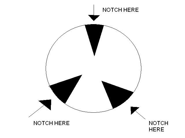

If you want to know, here's my clunky over-the-top amateur's guide to applying Bandai's Macross Frontier decals.
First, you want to make sure you're applying onto a fairly smooth surface; applying a coat of Future or other gloss coat is good for this.
I apply Mr Mark Setter to the area where I'm laying down the decal and then I use either a Q-tip or the tip of my tweezers to nudge them into position. Now if it starts to dry before I manage to get it perfectly positioned, I'll use my fingertip, dab it in some water, and touch one of the decal edges so the drop of water gets absorbed *under* the decal to moisten it and keep the decal from sticking to the part before I want it to.
Once the decal is perfectly lined up, I'll use a Q-tip or a cloth to touch one of the edges of the decal where there's liquid showing (being careful not to touch the decal itself) to soak up excess liquid. Then I'll touch the edge of the decal again with a little Mark Setter and then repeat soaking up the excess. Afterwards I'll let it start to dry into place for a few minutes; with Mr Mark Setter, if you've soaked up most of the excess, it should start drying and holding the decal in place. At this point i will take a Q-tip and gently dab the decal *straight downward* to squeeze out any remaining liquid, which is soaked up by the Q-tip, until the decal is flat against the part and all the liquid is squeezed out from under it.
If you happen to nudge the decal out of place doing this, as long as there's a little liquid left, you can gently nudge it back into place with the Q-tip. You may need to re-moisten it if it gets too dry and you've moved it out of place.
The ankle spheres are especially annoying and prone to wrinkling. Be sure you notch the three black sections with a knife before attempting to apply them. I've attached a crude MS Paint diagram. After applying them, since they're in a recessed section, I applied a generous helping of Mr Mark Softer and let it pool, so it gets all soaked up and will flatten out most or all the wrinkles.

plastic part > paint > gloss clearcoat* > panel lines/wash > decals > gloss clearcoat* > semi-gloss clearcoat* > semi-gloss topcoat (as the final layer to ensure a uniform finish)
*Add as many layers of clearcoat you feel is needed to protect your decals, paint, etc.
The second gloss clearcoat step I only added recently, when I accidentally picked up the wrong spray. But it turned out even better and made the finish smoother and more even, so I'm keeping that step.
Some pics of the backpack unit done using the above steps.
post-5703-1253441685_thumb.jpgpost-5703-1253441717_thumb.jpgpost-5703-1253441750_thumb.jpg
Link to comment
Wow! That looks amazingly good. So this is all from a rattle can? I'm just blown away (no pun intended). I can't tell from the angle/lighting of your pics, but do you trim the decal carrier film on those SMS markings or is the clearcoat just that good at making them a part of the paint job?
Keep it up man, loving your build(s)!
Link to comment
Thanks! ^_^ I tried to get the light to catch it at different angles. I rarely trim the clear excess from around decals; only if I absolutely have to to get a decal to fit properly.
For the back piece, the edges of the carrier film are almost completely in with the background. You can only just tell if the light is really bright and my camera is up super close. I wish I had done as well with the earlier decals; those you can see where the edges are if the light catches it just right.
Tried to get some close ups with the light glaring off.
post-5703-1253481709_thumb.jpg post-5703-1253481718_thumb.jpg post-5703-1253481726_thumb.jpg post-5703-1253481733_thumb.jpg post-5703-1253481741_thumb.jpg post-5703-1253481748_thumb.jpg
Link to comment
If I look real closely, I think I can imagine I'm seeing clear edges! Looks really good! My fear with clearcoating, and likely the reason I haven't experimented with it more, is time and concern that it might go on too thick and ruin my panel lines. I've had some issues with the oil wash not "sticking" to the lines very well, even when the underlying paint isn't glossy. I fear if I build up the layers of paint with clearcoat, it'll make those lines into soft "dents" instead of the cliff faces they should be. Having said that, I don't see that being an issue from your pics and you're using 2 more coats than what I'd planned. I think I just need to take the plunge!
Those last 6 photos, if they're your earlier work and the ones you were saying weren't as good as the back part, they're still amazing to look at! I forget how small all these parts are from the pics man, it looks huge!
