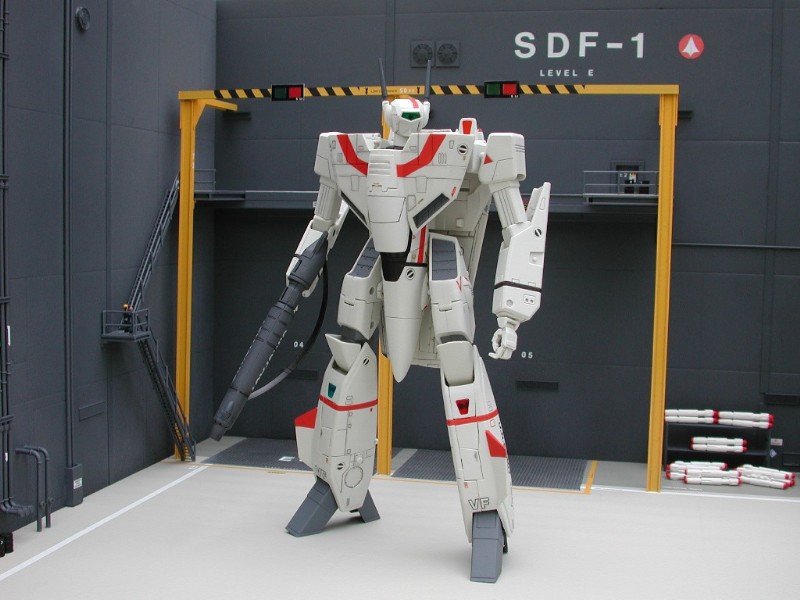

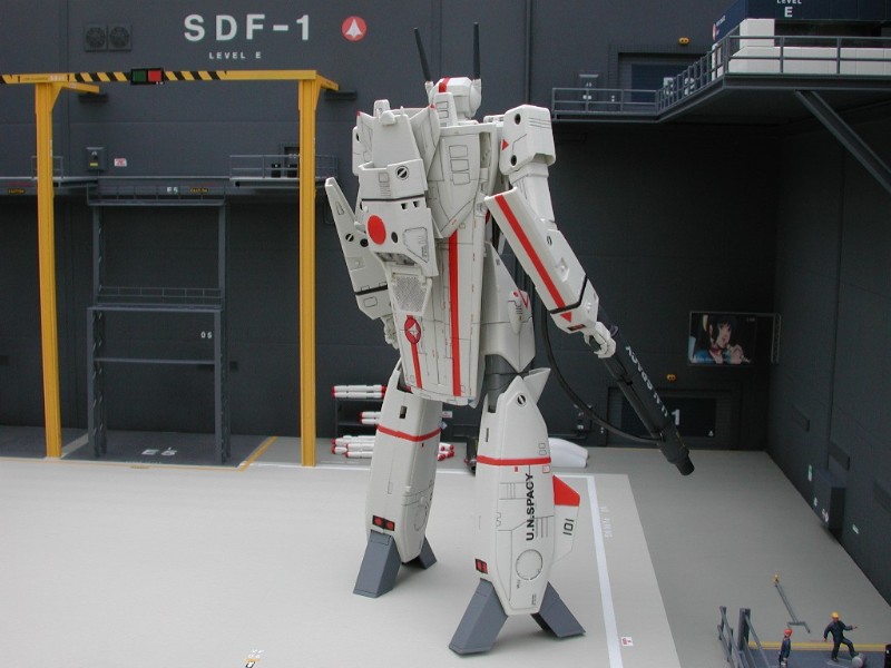

Here's what's lying on my workbench.
I just finished putting a very light weathering finsh on Hikaru's 1/48 VF-1J. All the decals are applied and trimmed to eliminate all the excess material. The feet and gunpod are repainted with a different shade of gray. Finally, a dull clearcoat was applied to seal in the decals and give it a more realistic finsh.
But I am not done with this valk yet. I am repainting the VF-1 armor set, to match the TV colors, that will be installed on this valk. The original plastic color is a bit too much on the blue side. And the red and white pieces looks translucent in their bare plastic state.
I will put some photos up soon of the armor set! :lol:

Wow!! Nice job, Ron!
Excellent touch, little screen with Minmae singing. ^_^

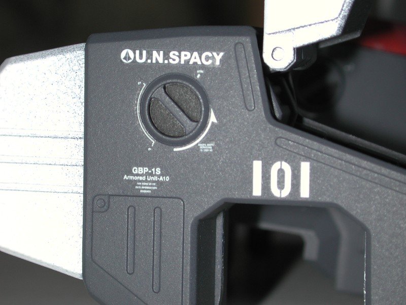

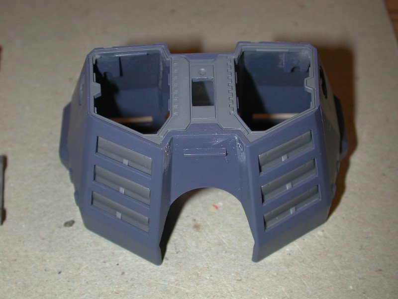

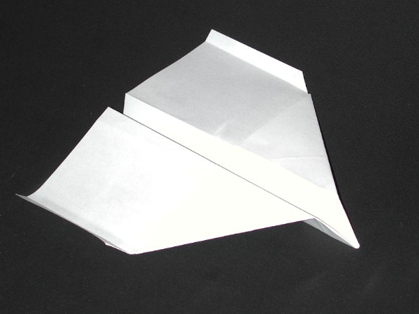

Ok! Seriously, here is what I have been working on besides Alto's paper plane. I am repainting the 1/48 GBP-1 armor for the Hikaru VF-1J. Here are a couple of photos of the chest piece right out of the box.

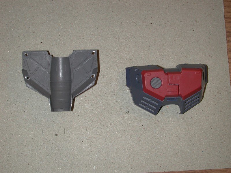

Now with a coat of dark gray and flat red with all the decals added. :lol:
The decals are a pain! :wacko: I cut around the decals after applying them on the surface and removed any excess material. That way, it looks cleaner. A final coat of flat clearcoat help keep the gloss to a minimum.

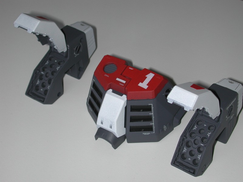

Wow, I finally got the armor set repainted and applied all the decals. Again, the color is painted to a more darker military gray with a deeper red too. Here are the photos of the results.

WOW!!! That's pretty much all I can say. Those colors look GREAT. You said that you cut the excess decal off after you applied them to the surface? Did you use an exacto or something sharper? I was thinking about doing that myself cause it is almost a pain to cut them while they are on the sheet.

Hey misterryno, I used an exacto knife for cutting around the blank areas of the decal. Then I used a flat over coat to seal it in. Use a new blade when doing this. The decals are tough and don't cut as easily as waterslide decals.
I used both Yamato's stickers and Anazasi's waterslide decals in various places. But the waterslide decals have a slight haze if not bonded down properly. So I switched to the stickers which blend to dark surfaces better.

Ahhh right on! THANKS! Can you inform me on waht type of over coat you used to seal them?

Testor's dull coat spray in a can. Their product number is #1260. This is available at most hobby supply store.
Don't forget to mask any glass (cockpit) and lights or else it will become hazy.
