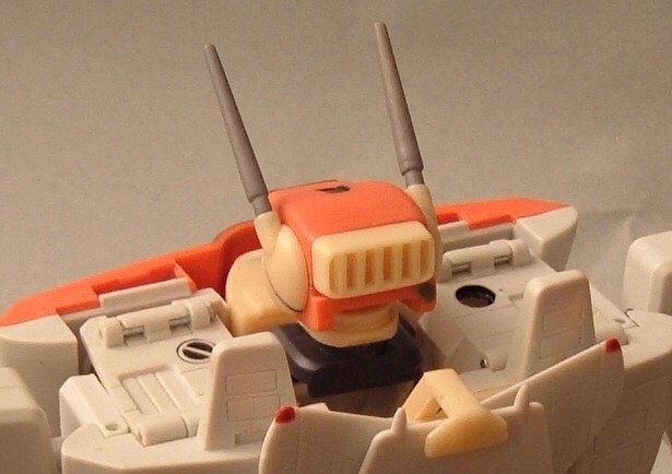

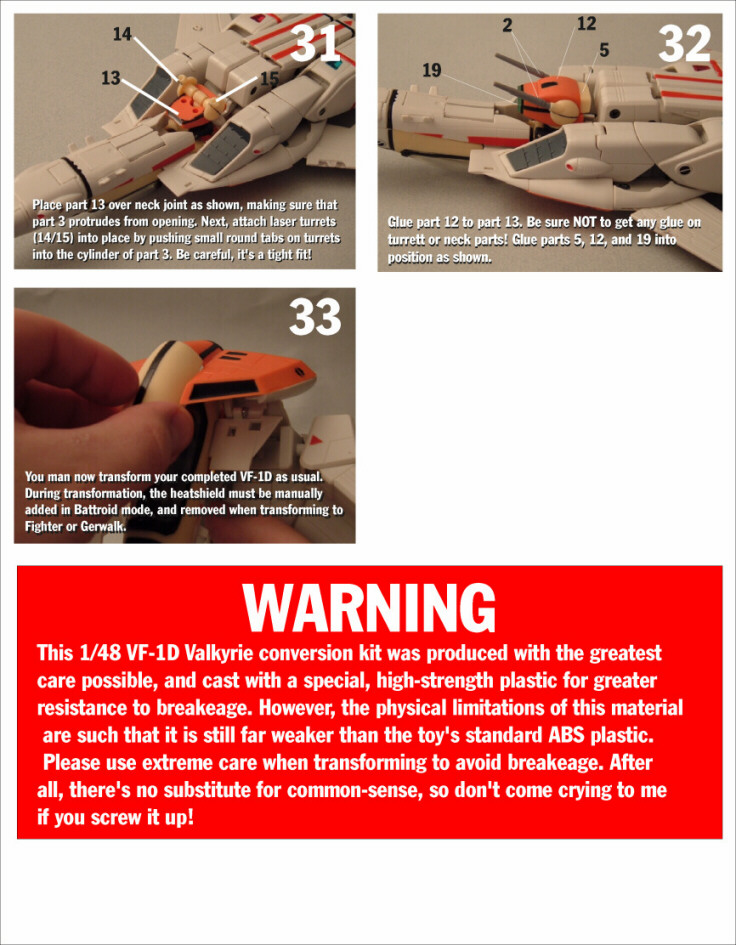

Mechamaniac Posted November 3, 2005 Posted November 3, 2005 (edited) Cap, can you give some battroid transformation instructions?. When I did my test fit (and also going by Haterist's post) it looks like the head mount plate doesn't have much to attach to in battroid. Also, what do you recommend to tighten up the head pivot (up and down) on the turret axels? Also, it may help in your instructions if you give some glue points for the fuselage halves. Did you glue along the length of the fuselage? And if so, how well does it hold up when you transform, or open the front landing gear? On the standard VF, the gap increases between the fuselage halves when you open the front gear, or when you transform. Edited November 3, 2005 by Mechamaniac

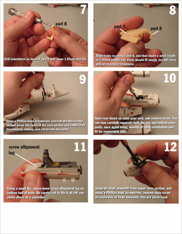

promethuem5 Posted November 3, 2005 Posted November 3, 2005 Crap....I need to find the right size drill bits and some of that plastic rod.... noone around me sells that stuff. Oh...and I need a valk.
captain america Posted November 3, 2005 Author Posted November 3, 2005 (edited) Cap, can you give some battroid transformation instructions?.Yamato already provided transformation instructions with the VF-1. The sequence is literally the same. I've tried it, and there are no transformation issues/problems When I did my test fit (and also going by Haterist's post) it looks like the head mount plate doesn't have much to attach to in battroid. I don't quite understand what you mean, can you elaborate please? Also, what do you recommend to tighten up the head pivot (up and down) on the turret axels? A dab or two of CA glue at the friction points. Let cure. This will increase tension and alleviate floppiness. Also, it may help in your instructions if you give some glue points for the fuselage halves. Did you glue along the length of the fuselage? Yes. And if so, how well does it hold up when you transform, or open the front landing gear? Quite well if handled gently. Please read disclaimer On the standard VF, the gap increases between the fuselage halves when you open the front gear, or when you transform. That's cos it hasn't been glued together properly. I barely tacked both halves of mine together, and they hold fine. 341755[/snapback] Edited November 3, 2005 by captain america
Mechamaniac Posted November 3, 2005 Posted November 3, 2005 I know the transformation sequence is the same, my question about Battroid was mainly regarding the head mount plate. On the standard VF-1, the head plate locks down in between the ends of the groove in the bottom of the fuselage (the head groove). This locks the head into place. With the D, since the upper half of the fuselage (part 10) is longer than the bottom half of the fuselage, the head mount cannot lock down between the ends of the groove in the bottom of the fuselage. So, the head sits on a side to side pivot caused by the rod portion of part 4 (see steps 20 and 21). Hope that helps. Thanks!
captain america Posted November 3, 2005 Author Posted November 3, 2005 (edited) True, the head has no locking mechanism in Fighter mode... Or Battroid, for that matter. The solution to this is actually rather simple, even if it's perhaps imperfect in the grand scheme of things: as mentioned in the instructions, you can (and should) use a small amount of CA glue on the neck joint parts: placing a dab on all the areas that have friction or rub against each other. When the CA glue dries, it is both hard, and slightly increases the volume of the contact area, thus increasing "tightness" and thus prevents the parts from flopping-around. As you can see in the pic below, the head litteraly "hangs" over nothingness. Without the tightness in the joints, the head would just flop backwards into the chasm below. Tightness is the key. Edited November 3, 2005 by captain america
Mechamaniac Posted November 3, 2005 Posted November 3, 2005 Cool, that about covers it. Thanks Cap! Note - If you use the bracket that comes with the Fast Pack set, the head mount will sit on that. It won't lock into place, but it will at least sit and not be suspended.

Majestic Posted November 6, 2005 Posted November 6, 2005 Is there an online source for metric drill bits this size? I look up "metric drillbits" but get only full sets that are upwards of $20.
Die, Alien Scum! Posted November 6, 2005 Posted November 6, 2005 Is there an online source for metric drill bits this size?I look up "metric drillbits" but get only full sets that are upwards of $20. 342608[/snapback] Just use English drill bits. You can get these any decent hardware store, like Ace. 2.7mm = 0.1063" = roughly #36 drill bit 1.93mm = 0.076" = roughly #48 drill bit You can get these individually for $3 to $4 each.
