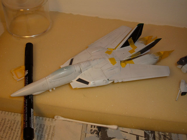

Ido Posted October 5, 2005 Author Posted October 5, 2005 Here what its missing, gunpod, head, arms, all glued and with putty applied. Meanwhile I painted some other little parts, like the laser cannon, head visor and arms sensors/lights (what the hell they are???) I tried your tip kazuki and washed the black part of the head with silver enamel mixed with flat base and it worked out, thanks. Today I received a package from hobbylinc, I ordered the tenax plastic construction kit, it cames with this little toy, it should be more pratical then touch and flow applicator. Too bad there isn't anything left to weld togheter with it.

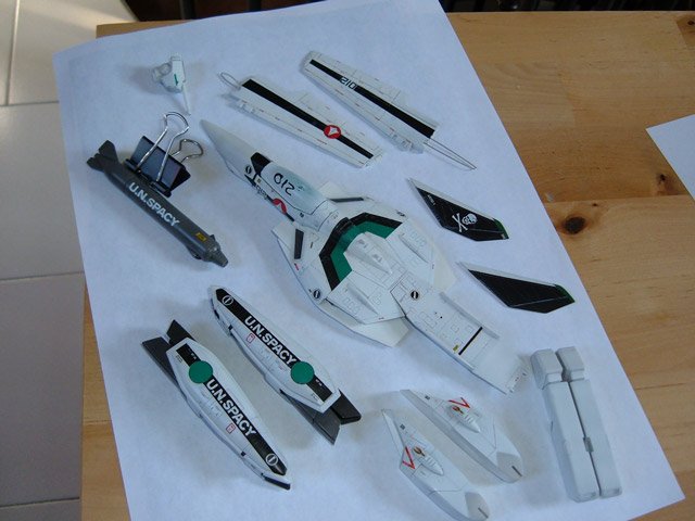

Ido Posted October 27, 2005 Author Posted October 27, 2005 UPDATE! I placed almost all the decals, after this I will protect them with a semi-gloss clear coat (after the decals a gloss coat its pointless...) then its time to assemble the landing gears and doors.
Ido Posted October 28, 2005 Author Posted October 28, 2005 Finally finished with applyng decals, I didn't apply the ones really close to the cockpit seal, I'll apply them later. Still have to apply microsol on what I have just placed and leave them be a night. The decal on the airbrake its a little ruined, I'll touch up it after the seal coat with a brush, its shouldn't stand out a lot in the end. About the annoyng NO STEPs, they are easy to apply but very boring: 1- they are all in row on the paper so with a ruler you can trim a lot of useless film in a moment. 2- Apply 2-3 of them at time, its not hard to do and You'll finish in less then a couple of hours without become crazy. Forgot to mention a thing: Tough this model kit includes both kakizaki and Max numbers and name decals it doesn't includes their colors guide and decals, I have taken them from my Super VF-1A kit.
Grayson72 Posted October 28, 2005 Posted October 28, 2005 Don't worry Ido, the brake decal always does that, there's no way around it, just make sure to put lots of solvent on it so it conforms to the part and then put some wash on it. Those recessed areas should be dark anyways.

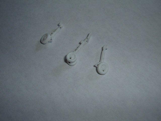

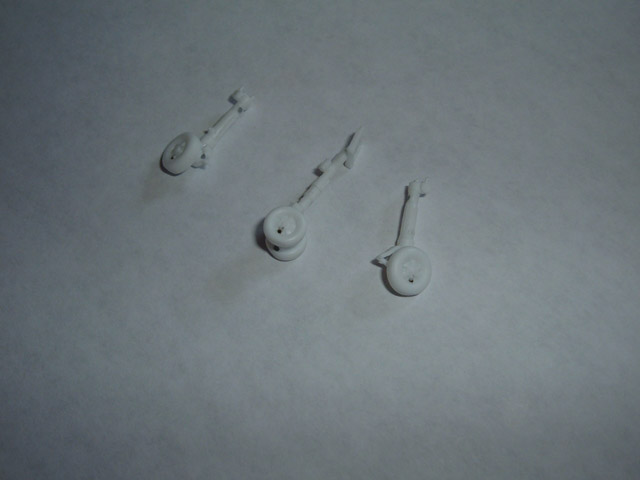

Ido Posted November 4, 2005 Author Posted November 4, 2005 With the winter its even tougher taking pictures, argh!! So instead of taking crappy pics I prefer don't waste time, as soon I get a sunny day I'll do some pictures. The valk itself its all decaled and washed, I also tinted the clear parts. After Open the cockpit I noticed the HUD black part come out crappy looking, luckly It will be covered by the canopy, must really take more care of the cockpit area. Currently I'm assembling the landing gears, the tires and doors have a lot of injection marks in weird places, how boring... Today I'll let the putty dry, must get some mori mori putty next time I shop from Raibow ten.

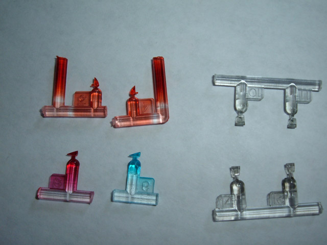

Ido Posted November 7, 2005 Author Posted November 7, 2005 Not yet weathered, semi-gloss valk Here the clear parts, classic red/blue for the light and a mix of red/orange for the sensors, I tinted the wing's root lights with smoke like in the boxart illustration. (see also tenjin book cover) What I'm doing right now.
