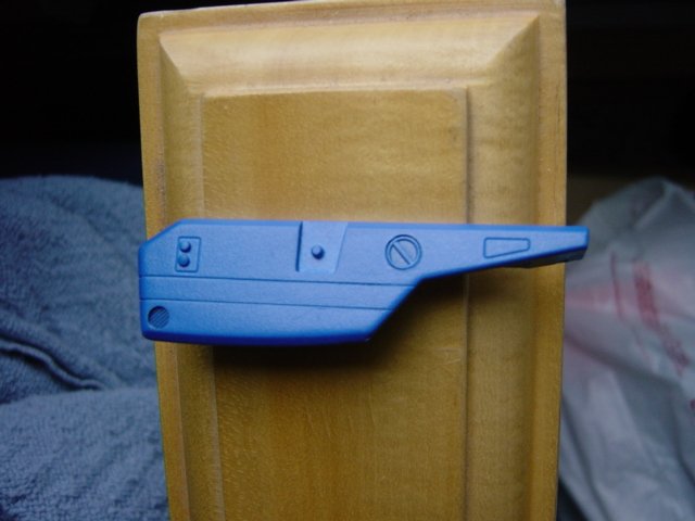

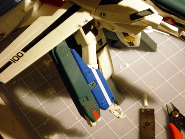

EXO Posted March 24, 2005 Posted March 24, 2005 OK, here's the piece I attached to my Focker 1S to test it for transformations. No scratches so far. The white stripe is tamiya paint. No scratches on that either. I applied it to a resin piece after washing it with dishwashing detergent and warm water. I went to show it off to a friend and forgot it at his place. He was pretty impressed about the application too.
Eternal_D Posted March 24, 2005 Posted March 24, 2005 damn that looks really good...gotta get me some of that when i get back.
Die, Alien Scum! Posted March 24, 2005 Posted March 24, 2005 Hey >EXO<, how many coats did you apply?
