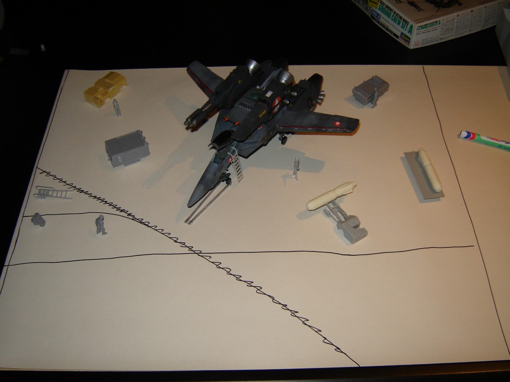

jadefalconguard Posted August 31, 2005 Author Posted August 31, 2005 (edited) Thanks for the feedback guys. Here's the first attempt at the diorama. Still very basic, some psoing around. The black line denotes where the 'prep' area begins. The main idea will be to build up a backpart also and maybe some lighting If someone got some good idea's, let'm come please edit : forgot the pic...again Edited August 31, 2005 by jadefalconguard
HWR MKII Posted August 31, 2005 Posted August 31, 2005 (edited) Be sure to cut notches in the side of the munitions trailer to allow for the jammer lift table to actually get under the munition. Have someone walking alongside the end of the bomb with their hand on it, No munition that size is transported alone on a jammer. Move the tow tractor closer to the nose area of the aircraft so it can be associated with its job. Also move the -60 cart from the tail to near the nose or make it look like its being pushed by 2 people minimum. Organize it like that and the scene will look a lot better, Its how its done in the real world . Also add a person working on the bomb rack your bomb will be going to. Edited August 31, 2005 by HWR MKII
jadefalconguard Posted August 31, 2005 Author Posted August 31, 2005 HWR, thanks for the tips, I'll be adding styrene "holders" for the missiles, so the lift can get under the missile. Didn't think about the holding guy on the missile The other parts give the problems as the scene will be to crowded on the nose Thanks for the feedback
HWR MKII Posted August 31, 2005 Posted August 31, 2005 Youd be suprised. The nose is usually where all the power hookups are and most of the electronics are too. Unless there is engine maintenance going on nothing happens around the tail. Your hydraulic cart is in a good place though. Another note ,while traveling the bomb wont be above shoulder height and will have a binding strap over it to assist in keeping it from falling off the table.

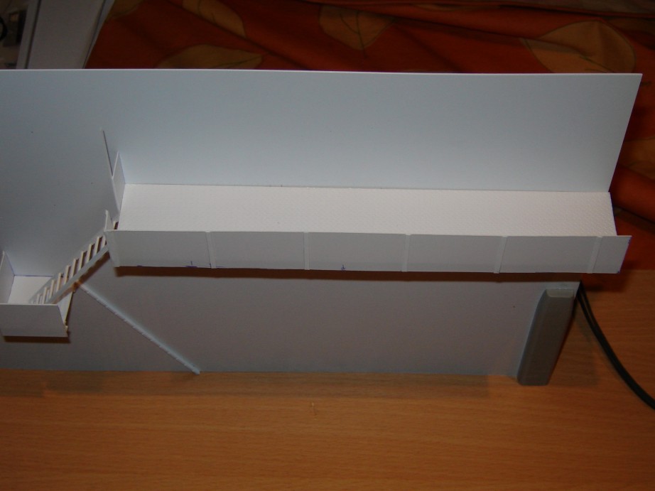

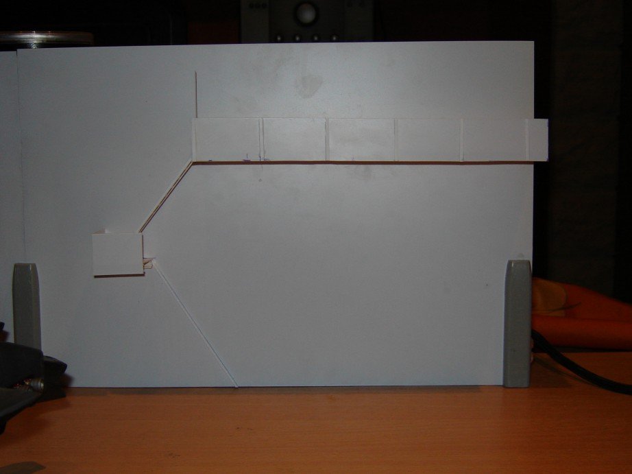

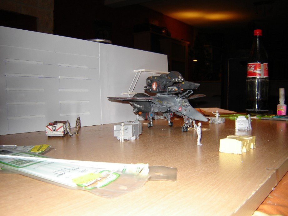

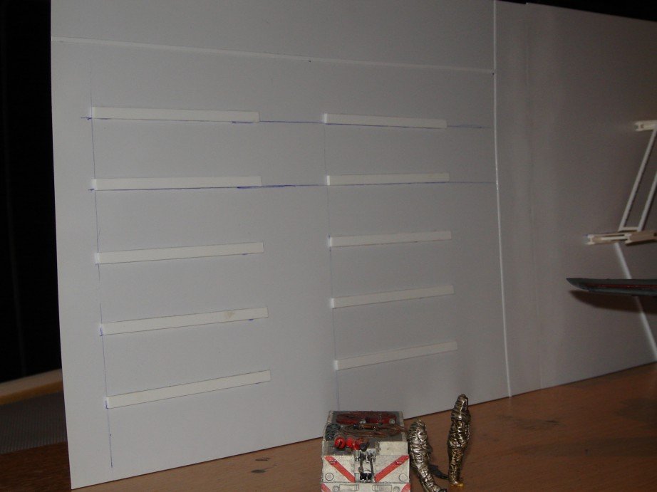

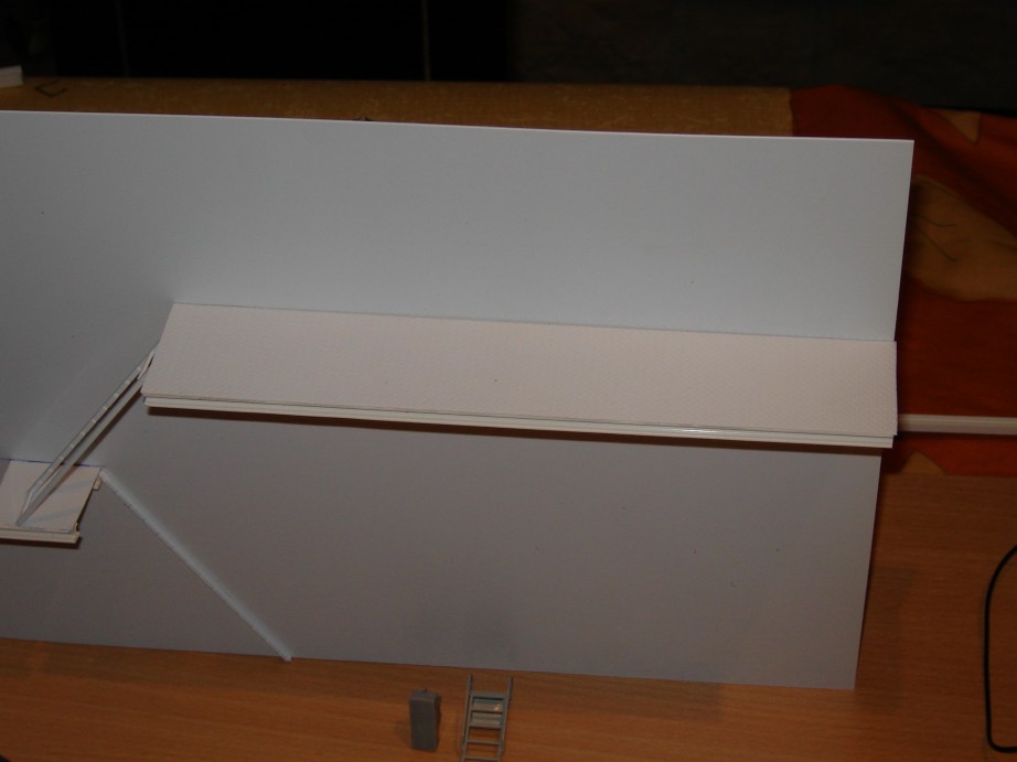

jadefalconguard Posted September 4, 2005 Author Posted September 4, 2005 Allright, work started on the backplate for the diorama. Got a wooden groundplate wich is good for the metal tie down points and large enough to fit the complete dio. Here's an overview shot wich shows the difference in the lay out : here are two detail shots on the still bare backplate. Just the large details. Some leftover pieces from the scrapbox will be used to fill it up :
HWR MKII Posted September 4, 2005 Posted September 4, 2005 Perfect setup on the equipment. Everything is exactly where it should be. Be sure that the -60 generator isnt connected while weapons loading is going on
jadefalconguard Posted September 5, 2005 Author Posted September 5, 2005 Why do you think the firetruck is there in the back

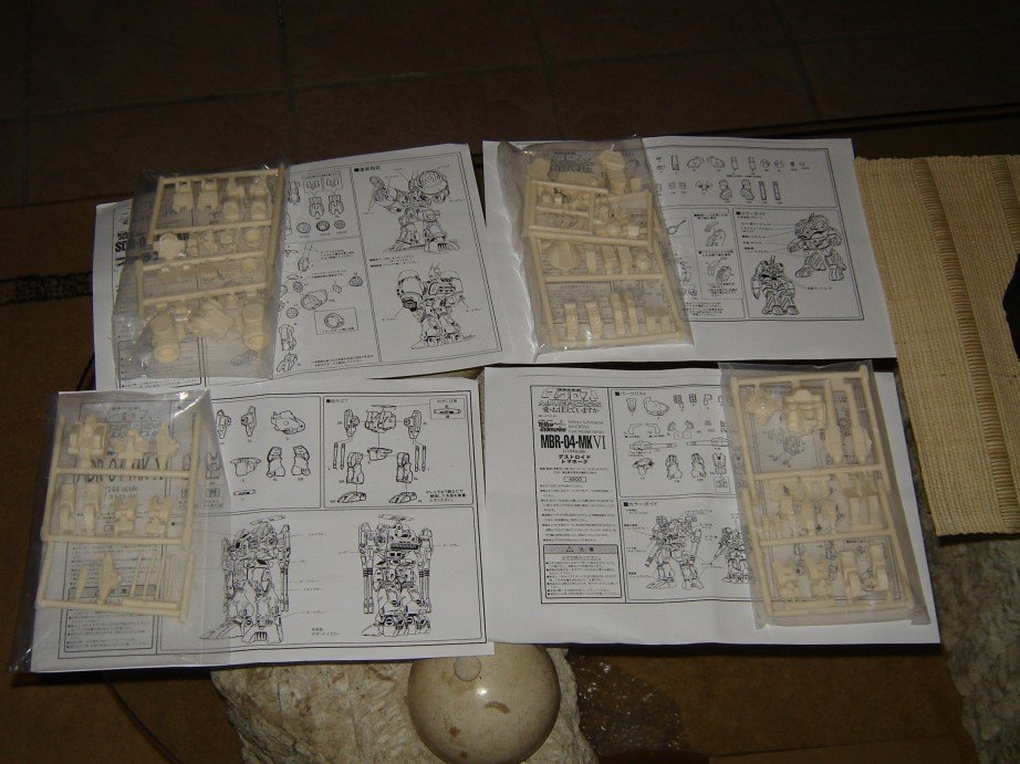

jadefalconguard Posted September 6, 2005 Author Posted September 6, 2005 Just got my new toys in the mail today : the 4 different 1/144 Destroid recasts(originally from Yellow Sub). Nice little kits although no decals Here's the link from Hobbyfan : Destroid kits

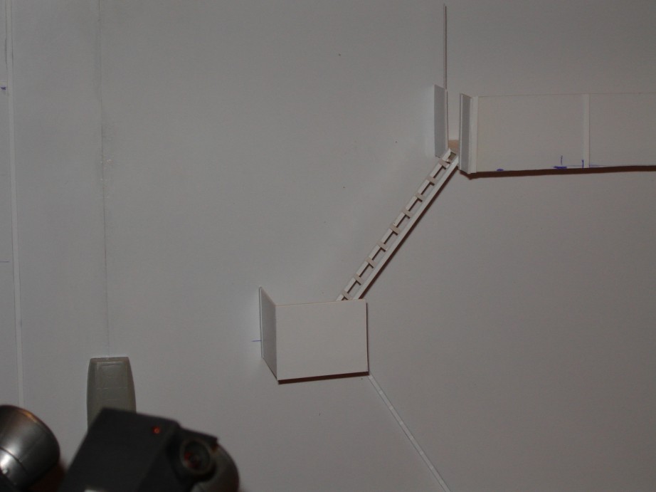

jadefalconguard Posted September 6, 2005 Author Posted September 6, 2005 But on Topic, I've been busy on the finishing of the staircase : Also added some pieces from a bomb dispenser of a 1/48th Tornado I still need to fill up most of the empty pieces and work will start on the sidewall
