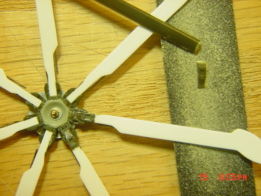

  22. honneamise, thanks for the clue. I think my local shop has that stuff. I have that same kit and it's awesome for it's size. I'm totally modifying it though. I'm making it into something more "Macrossy" to go on the Daedalus. These are BERP blades on the rotor head...
