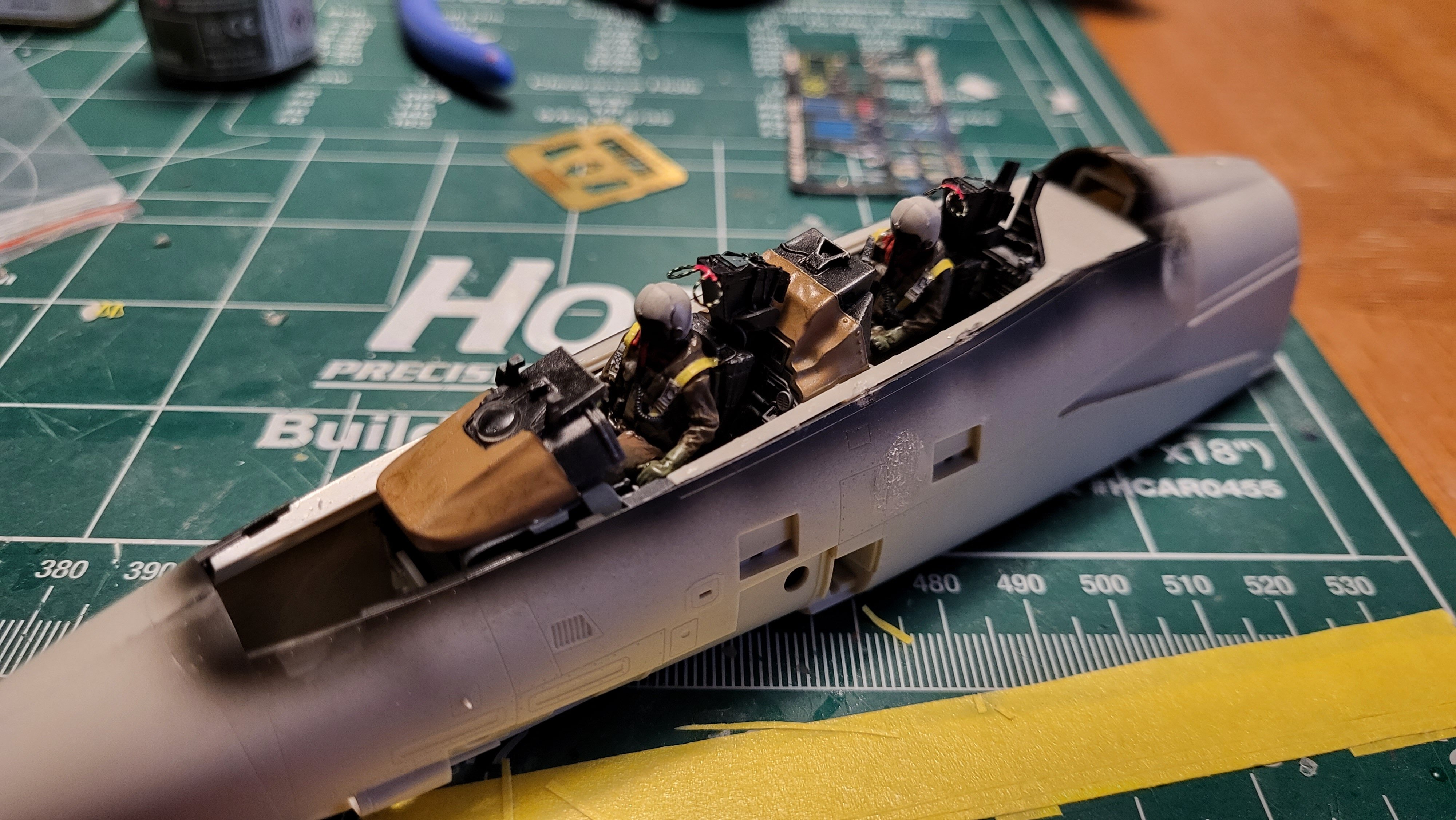

  5. DYRL VS TV. TV also has a 3-piece console screen and a physical HUD instead of everything being projected on the canopy/helmet directly. -- Let the game begin. I couldn't find many good references for the cockpit. In SDFM it varied greatly from scene to scene. I just cherry picked a few key details from the line art to give the eye something interesting. Leftover gunpla, kotobukiya bits, copper wire, and metal HiQ parts proved useful. I was really concerned about filling the dead space around the rear of the seat. The pilot got a little trimming to define the legs and upper arms a bit more, and a little Mr. Disolved Putty was brushed onto the joints to hide the seams. I've been relying on this product a bit more than Mr. Surfacer 500 brushed out of the bottle. For small pinpoint applications it goes down smoother and sands quicker. The shoulder seam received a little bit more of a liberal application because this pilot has been hitting the gym! Afterwards off to a coat of Mr. Surfacer 1500 and a quick check to make sure nothing would get in the way of the nose halves sealing. All good... though the panel lines on the 2 halves conveniently don't meet. For later. Now onto colors.l! I decided to go with the OOB pilot colors. I used Mr. Color 328 for the blue. This is the same blue that is to be used on the valkyrie's markings. For the pilot, I really like the color. I'm trying out a new (to me) product. Micromark's Micro Mask! I tend to use Mr. Masking Sol Neo but, have never been too fond of using it for small areas as it tends to have elasticity. That same latex-like elasticity fights you during toothpick and brush applications. Micro Mask is easier to apply with a thinner consistency closer to dish soap. Anyways, the top of the helmet was masked up and a quick spray of of Mr. Color's 311 white was applied. It's an off-white (yellow/tan + white) that is recommended to use on the body of the valkyrie too. This is my first time seeing the 2 colors together in person. The cockpit was painted with Mr. Color 13, letting some of the black primer show through for the shadows towards the bottom. I wanted to see if the decals were even worth attempting... even with Solveset, they were not. However, they did give me a taste of the direction I would end up heading. Having the bold colored decals on the gray really helped sell the direction I wanted to take with the cockpit's colors. A very early SDFM inspired scheme focusing on bold contrasting primary colors. A nice break from the metallic paints I've been using for everything lately. So, I grabbed the brush, toothpick, and began basing in my color selections. Some trained bridge bunnies may notice that some areas not fully painted in. This is because I am only concerned with getting the basic down before seeing what will end up hidden when I get around to panel lining and washes. I'm debating whether to try a blue or green filter over the aircraft gray to make it look more like the animation's coloring. Not sure if that will clash with what's to come. Top left!

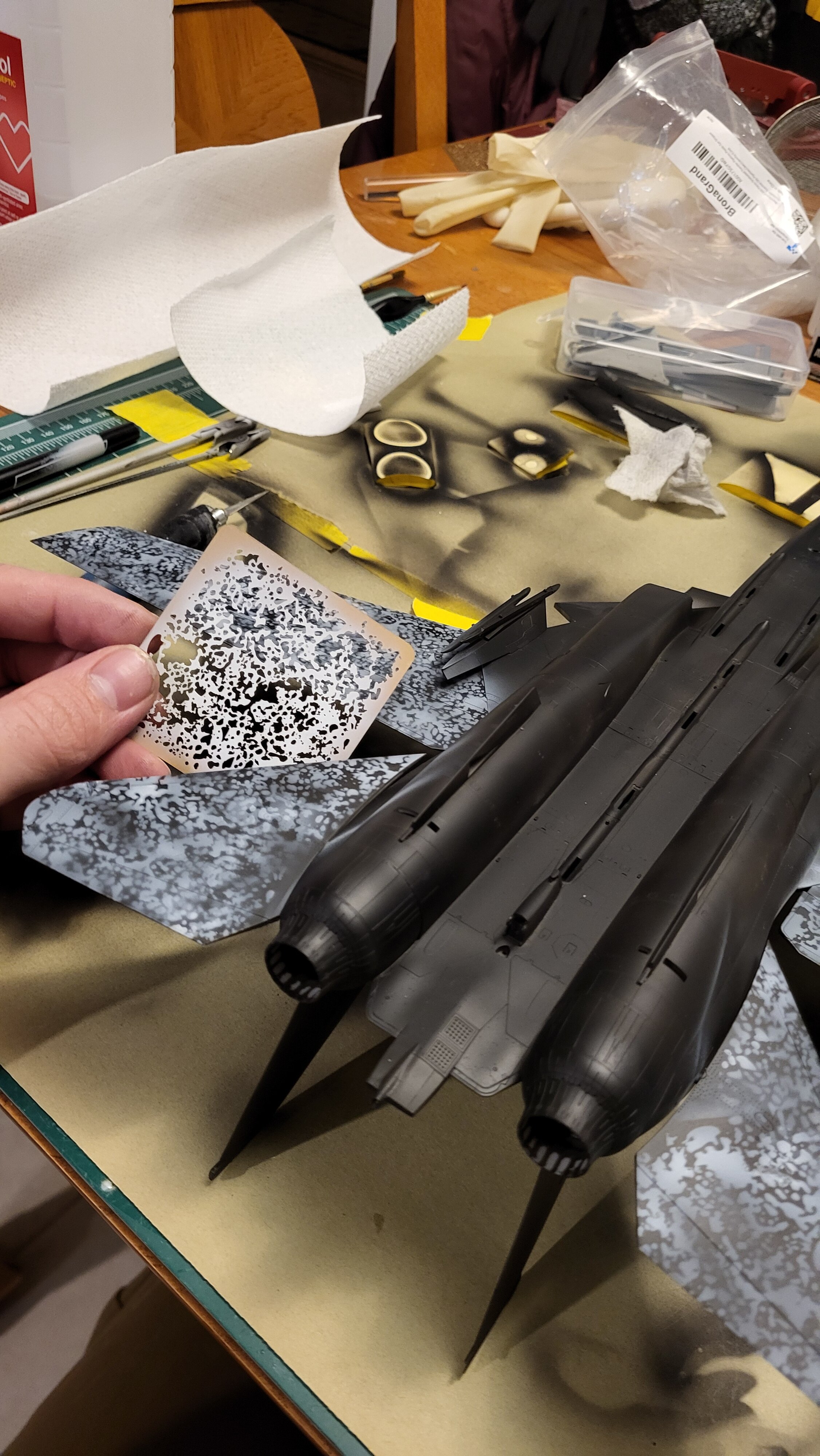

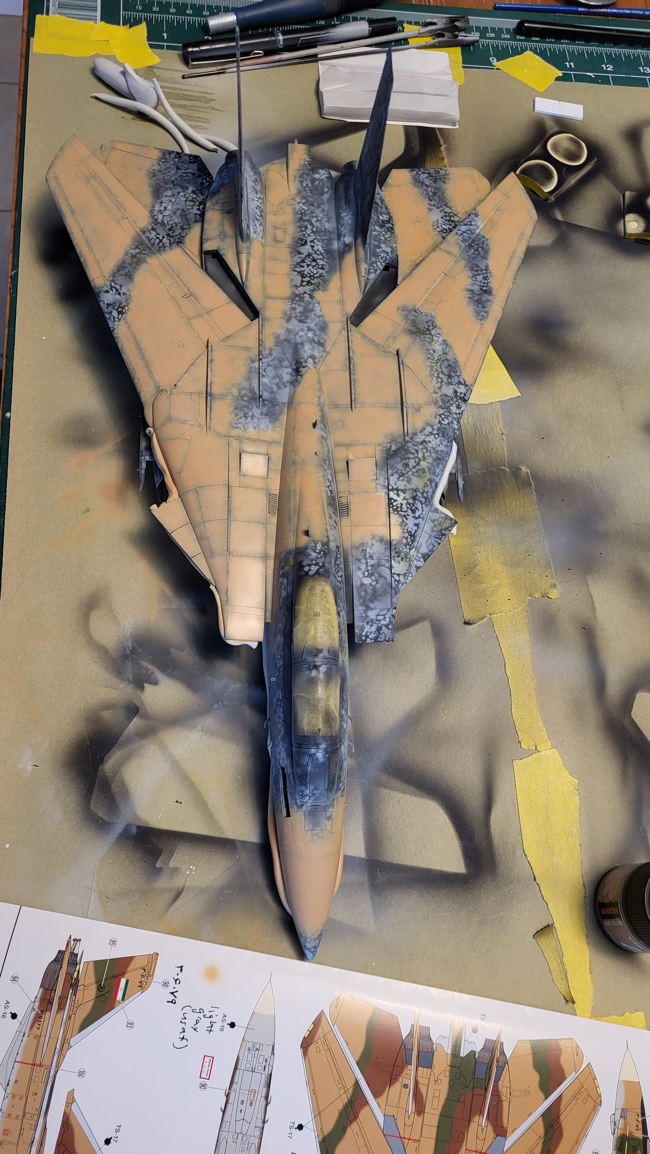

  16. -see below- Uschi van der Rosten's "Trinity Splatter 2" is by far the best set I've come across. Their site has plenty of companies to buy them from, or just go to good old eBay. A few others make and sell them as "weathering airbrush stencils." AK is popular alternative. I just really like the brass one for durability/reusability and since you have to soak them in thinner to clean (no scrubbing as they are essentially a big photo etch piece. https://www.uschivdr.com/shopping-categories/shop-photo-etch/
  17. If yours came with 3, cut one in half and on the other remove the thick border edge. Or just bend one into a 90° angle. That way you can get in closer. Remember you don't want perfect patterns. Imperfect is more natural as counter intuitive as that sounds. A bit of trial and error, keep going!

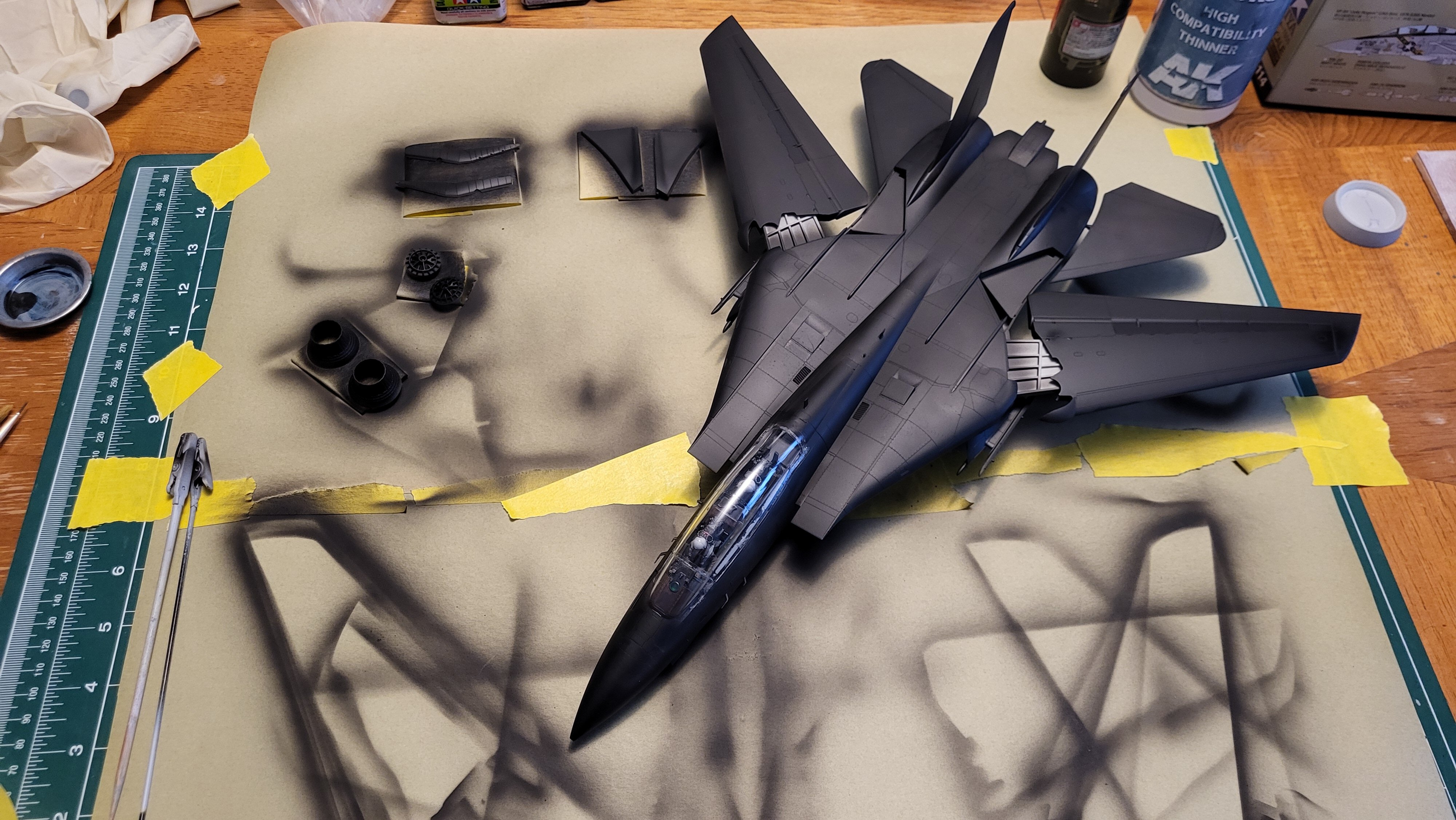

  21. Basic colors on the go fast bits. Stainless steel, pale burnt metal, hot carbon and burnt iron followed by a brown and black dirty wash. Easy on the painting as I want to revisit some other forms of weathering I hadn't really touched in 20+ years when I was fresh around the ears. Hope to get the engines wrapped up by tomorrow so I can focus on the experimental payload it was equipped with and finally clear the workbench!

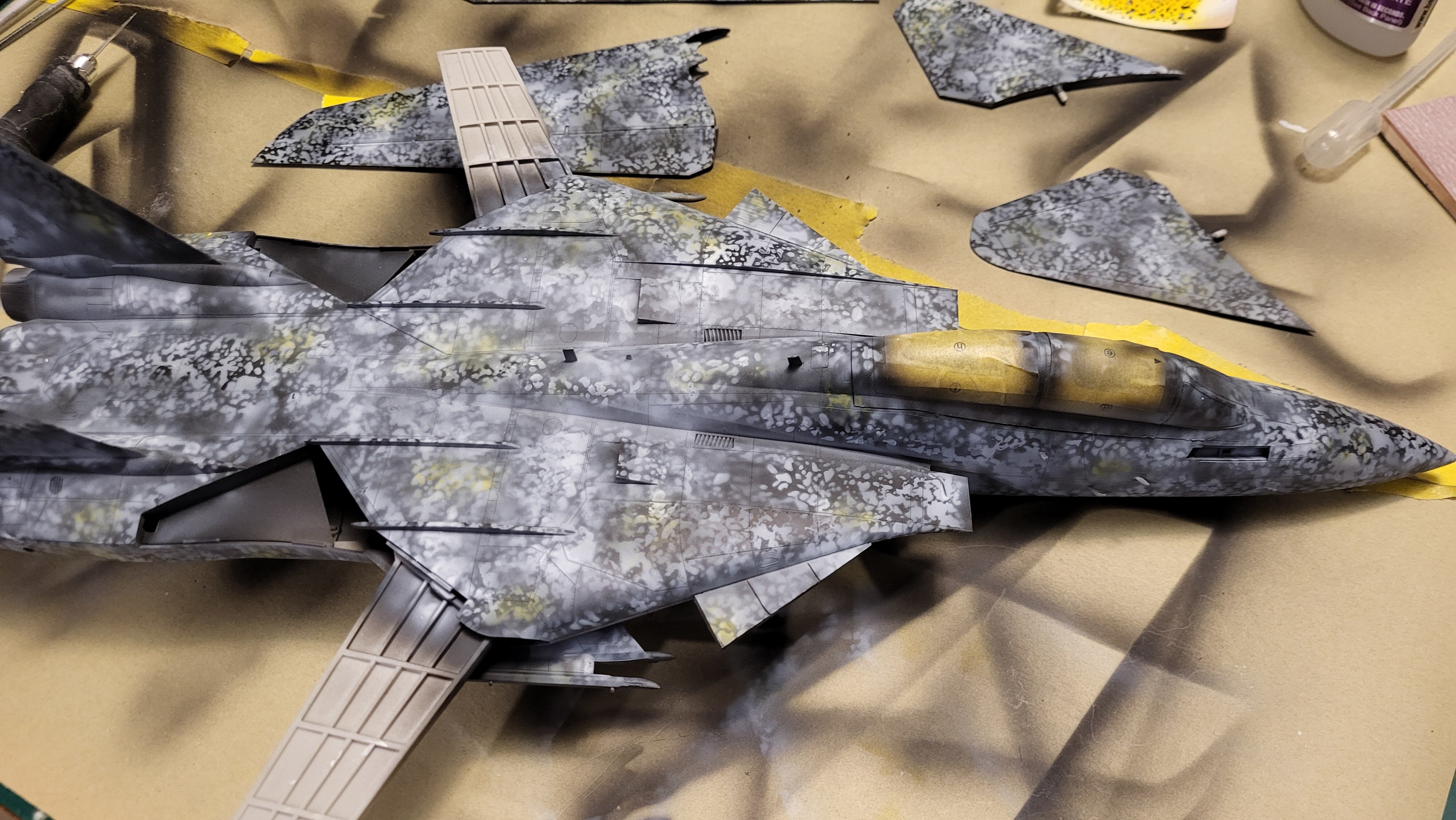

  22. I went light to dark as the darker colors covered the base layers faster with less paint. Even if my lighter color's coat had fuzzy edges, it was easily correctable with the darker colors without loosing the ground work. I had to come back in a few places with the tan to correct some of the camo patterns, somehow ot dodn't really take away from the soft edge/shading. It may be a scale thing though as IIRC you keep working on them tiny scales, lol. Marking correctsions, topcoat and then it's weathering time!
