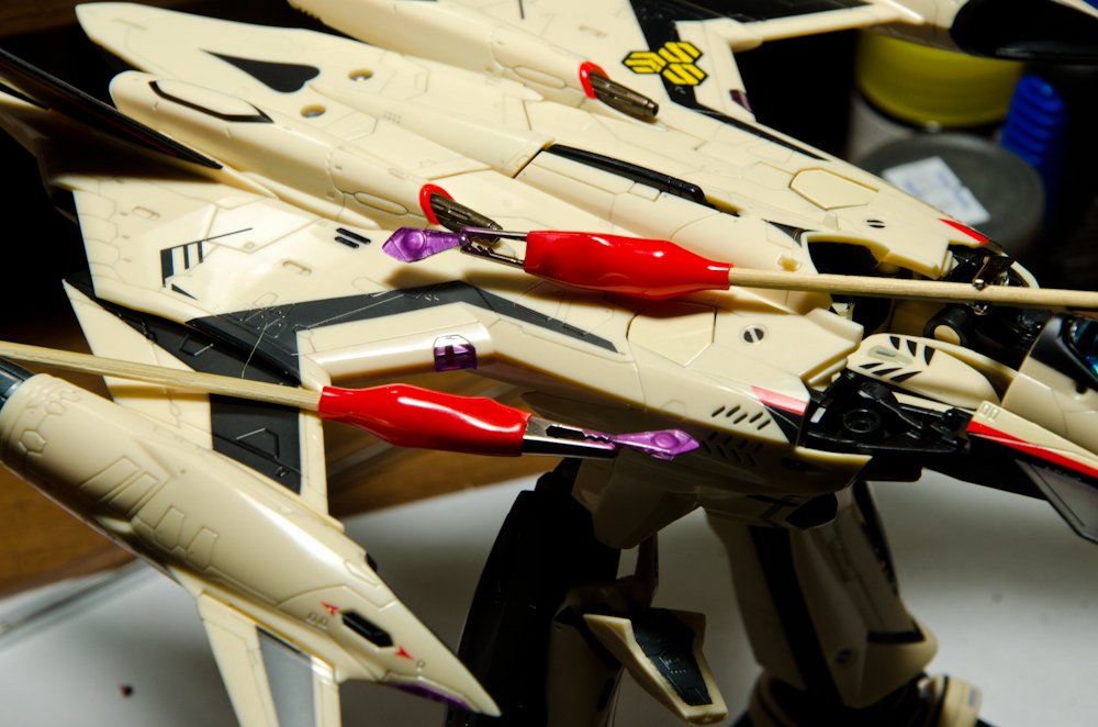

  1. My purple glass paint was delivered today so I tried it out when I got home. It's a thick paste when squeezed out of the tube so naturally I had to thin it down. Fortunately, it mixed pretty well with both Tamiya thinner and Future. I airbrushed it onto the fold quartz pieces and this is how it came out: It's not perfect, but it's pretty darn close and a whole lot better than the previous attempt as seen on the previous page. I think I'm satisfied with how it came out. I just need to spray it with Future after it dries for that extra glossy sheen.

  9. I don't suppose anyone knows of a good clear purple paint? Acrylic preferred. I'm not happy with the results I'm getting from mixing Tamiya's clear red and clear blue and they don't have a clear purple. I've spent several hours mixing and trying to get the right purple, but it just doesn't mix well and the shade never comes anywhere near what I want it to be. I want a bright amethyst colour and no ratio of blue and red clear gets me anywhere near that. If I could find a decent purple, it would be simple enough to change what I have right now. I considered purple food colouring, but I have doubts on the longevity of food dye. I figure it would break down and fade relatively quickly. I'm pretty happy with the canopy though. It's pretty much the same blue they used, only much lighter in saturation and looks a lot less cartoony now. Masked off the glass portions and spray painted the canopy frame black. I just need to do the weathering next and find a decent replacement purple.
  10. I thinned the clear blue with some future and then sprayed light coats on the inside of the canopy with an airbrush.
  11. I've disassembled mine to clean out the grease from the hinges and while I was at it, stripped the paint off the fold crystals and the canopy as well because it just looked too saturated for my tastes. I repainted the silver backing on the back side of the fold crystal piece and put a coat of clear purple on the front. I then did what I thought they should have done with the canopy and painted the blue on the inside instead of the outside. I gave it a much lighter blue tinting. I just have to re-paint the black canopy frame now.
