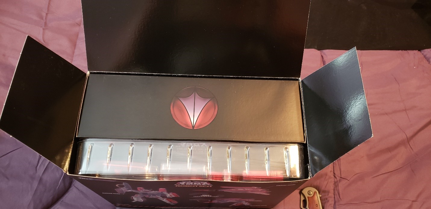

And it arrives. KC GOF Purple Variant. I actually like this Purple schema more then I do the Red. Basic box with trays mounted on this inside, did a quick once over and not seeing any "errors". I would say if mine arrived, others should be in short order.- 2740 replies
