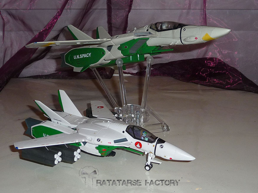

Part 3 of Alaska base WIP.
When reassembling the forearm, remove the paint from the little pegs or the forearm will not attach fully and you could break something by forcing it.
It's not necessary to glue this piece (unless you want to)
Now for the leg fins and tail stabilizers. First I remove the paint, if I can take the piece out I throw it in some brake fluid for a few hours. It's great to remove paint and safe for the plastic leaving the paint gummy like so you can scrape it off with your finger; but, the black tampo from the Yammies is extremely difficult to remove, so you will need some extra light sanding to remove it.
To remove the wing marking, I can't throw the wing into the break fluid cause I don't wan to loose the other tampo. So I just mask around the panel where the markings is and sand it off, I use 400 grit to remove it, clean it with some 600 and finish it with 1000 Grit to get an even finish as close as the surrounding panels.
Now for the hips, the extra coat of layer will rub when you move the hip forward. You can see its a rather tight fit.
So, just sand or cut off a few mm to give extra clearance.
Voila. Now you can pose and transform the legs without fear of this part chipping.
Looking good.
Time to remove the paint here too, I will also sand it out, same process as before. For the Alaska scheme this part is white and the rudder green.
And time to prep masking for painting.
Not bad
And the final markings to be painted, the tail lights, that intake sensor? and the red stripe on the legs. There's a sticker for the leg stripe but I prefer painting it.
That's more like it.
Now I have two, weeeeeeeeeeeeee...
Now to begin adding the decal markings. Little tip, pretty much a given but just in case, add the "no step" marking with the wings swept to match each side.
One more thing, the legs and intake tab that lock fighter mode, mask around and remove the paint here cause it will chip anyway.
Still a few decals left to place but its pretty much done and can now enjoy an Alaska base scheme VF-1 Yammie that can transform with little fear of ruining the paint, you will only need to be careful with the shoulders when transforming into fighter mode (will add pics of this later).
Total working build time 3 days.
Now to finish this other bird.
Thanks for looking.

seeing I already had a Yamato Cavaliers VF-1A, I had an Alaska Base greenie built from a assembly kit version and it looks fantastic! Sorry don't have photos on me but I definitely posted some of it in one of the threads in here..
