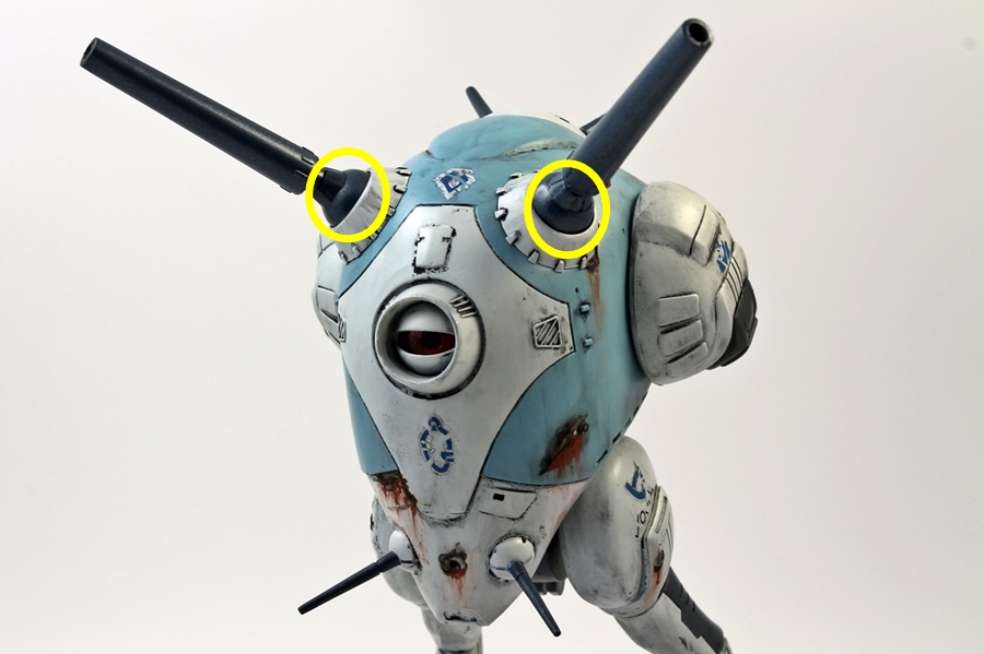

If you haven't noticed yet, you'll also have to fill in a big gap on the main guns ball joint area. I just cut a bit of styrene sheet, glued it in, and Tamiya puttied to fit. You lose a little bit of gun movement with that, so get it into the position you like before gap filling.

Thanks, yeah had used the apoxie sculpt to fill that in as well, again this will be fixed pose so if i need to adjust the ball at all i can still do it later on.
