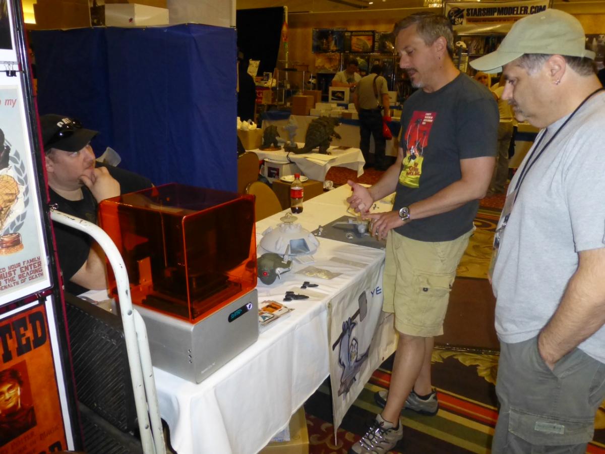

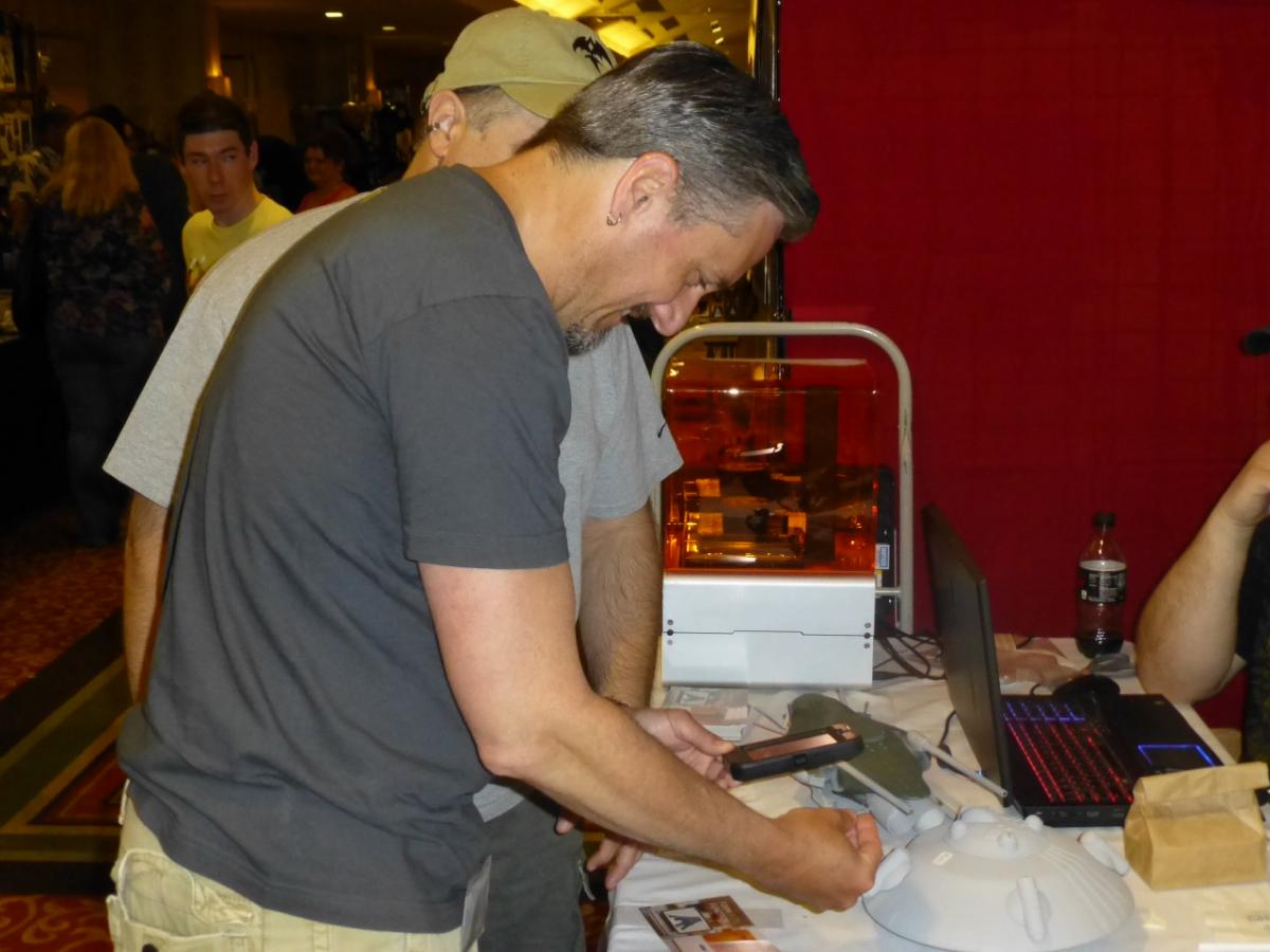

tundrayeti Posted June 7, 2014 Posted June 7, 2014 (edited) Hello all! As mosr of you know I attend Wonderfest in Louisviulle Kentucky every year as a kit designer and dealer. This year I had the pleasure of showing off the new Form ! 3d printer that is due to be released in July. The nice folks at Form 1 let me play with the machine early and I showed it off at wonderfest. I must say it was a big draw to my table and lots of folks seemed very interested in this machine. But the results spoke for themselves. I have been playing with 3d printing for over 6 years now and let me tell you it has come a very long way! This machine is incredible. A lot of you have been marveling over the detail that some of the kits myself, Exo and NeptuneSurvey have been producing and this little powerhouse has been one of the big reasons behind it. Of course the designers have a huge part in it but this machine makes those small, High detail parts a reality. As far as ease of use and reliability, this little machine really does it all! I will break down this review into pros and cons and then basically a final review. First the Pro's: This machine prints at 25 microns per layer. That allows for fine detail printing but unlike other machines, you have a lot of control in this area. You can also print at 50 and 100 micron layers as well. The software allows direct control over the density of the support material as well as touch point size. this means you can have tiny areas touching your model and they break off very easily. The software is pretty savvy when it comes to aligning your 3d models for maximum printing results. This machine was also quick to set up and use, I was printing 15 minutes after i opened the box! The forums on their website are full of tips and tricks so that you can use the machine to its full potential! The resin is very inexpensive and allows you to print small parts very cost effectively Now the Cons: The software gets very slow if you load a bunch of high detail models. Not a deal breaker but it does affect setup time. The build platform has an aluminum surface that the parts are built on. the drawback is that the edges of this are sharp and you have to be carefull when removing models. (I have lost some knuckle skin due to this) I have made Form 1 aware of this and they are looking into it. The resin tank wears over time, it is basically an acrylic tank with a soft gel in the bottom. After long use the gel can get pitting in it and the clear bottom becomes foggy. I had this happen early on and Form 1 thinks it may be a defective tank. They are sending me a replacement, but at $69 per tank it's not going to break the bank if you want an extra on hand. In fact they recommend having 1 tank for each color. Overall: The small drawbacks aside I love this machine! It really has made things easier and allows me to provide small detailed parts without the cost or time of producing a mold and casting copies. I can print several small parts at once, and this machine works while im asleep or at work. Really saves some time! The build area is 5 inches by 5 inches by 6 inches high. Not very big, but those of us with experience can divide a larger model up and combine the parts after. I'm sure a larger version of this machine will come out. I cant tell you how many folks came up to me at Wonderfest and said "Ive been looking at this machine, but I wasnt sure about it till i saw it in action and held the results in my hands." The price tag on this machine is $3299 but that price you get the form 1 printer, a cleaning kit that has gloves, a scraper, a pair of snips and some other tools, 2 tanks, and a basket that are used to wash your parts. The cleaning solution in your run-of-the-mill 90% isopropyl alchohol. Not expensive at all. I think this machine was worth every penny i paid for it and the folks at Form 1 have been more than helpful. They are a company that is starting out and they still have a few bugs to work out but keeping that in mind, everyone I have delt with at Form 1 has been very helpful. Okay well that's my 2 cents here are some pics of my table at Wonderfest showing off the Form 1. Please feel free to PM me with any questions. Edited June 7, 2014 by tundrayeti
