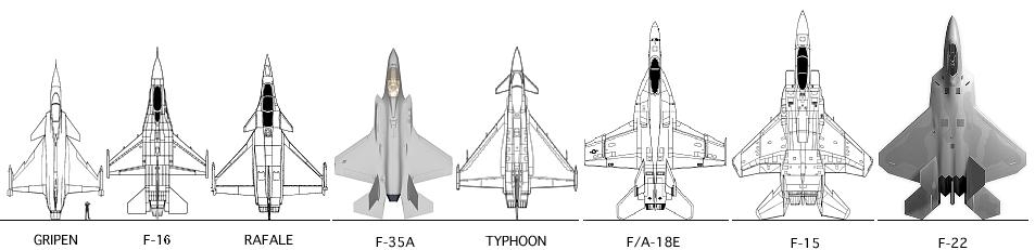

i work on Al Dhafra AB here in Abu Dhabi. I see Rafales a lot since the French Armee De'la Air have a unit stationed here. That plane is compact too and not much bigger than the F-16. It is loud as hell though when it takes off. Ironically I have seen all these types flying from this base except the Gripen and the F-35.
