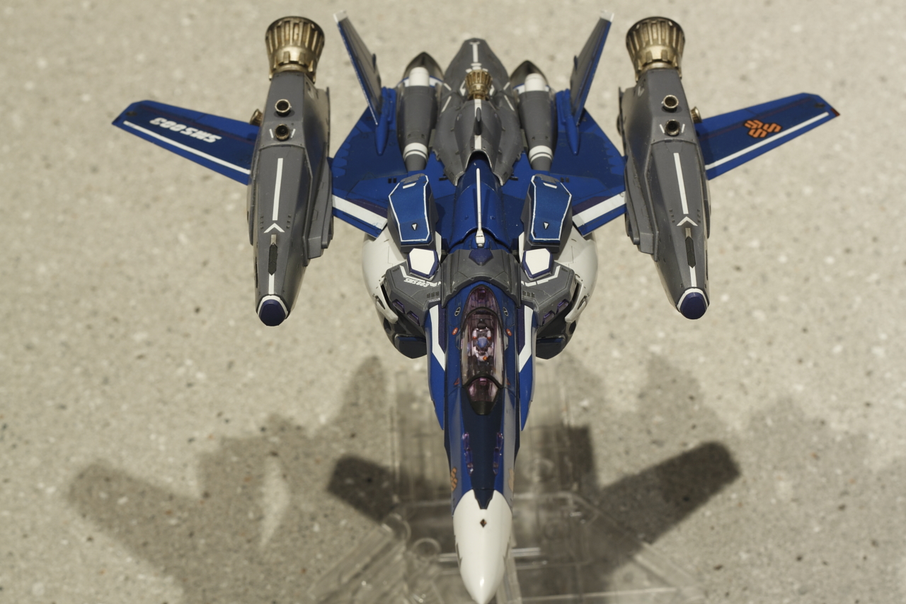

Flakpanzer Posted July 27, 2010 Posted July 27, 2010 I really liked your work, it is nice and clean. Good work. Regards, Flak
wm cheng Posted July 27, 2010 Posted July 27, 2010 Bravo! It looks fantastic. See, all that hard work did pay off... and given a few months later, you might even be able to look at it without seeing all the flaws first (not to say that there are any glaring flaws, but from following your thread - I guess you're a bit like me, I tend to see all the flaws of my work first when I look at my own models - just trying to say that given time and a little forgetfulness, it will dull the pain of the build a little ;-) Great job! Are you planning on a little light weathering?
mickyg Posted July 27, 2010 Author Posted July 27, 2010 (edited) Thanks for the feedback and kind words people! I am planning some light weathering but am holding off a bit for a few reasons. I'm a perfectionist and a natural procrastinator. In model building, that's a mixed blessing. It means I want the very best result but also means I'm easily discouraged and can put things off indefinitely because I'm afraid I won't get the result I want (or in some cases need). So on that note, any advice others can give on how to do said light weathering would be most appreciated. It will be my first attempt ever. I've got the airbrush but I've also got a Tamiya weathering kit. It looks like a makeup kit to me and has black, brown and white. I'm guessing I can mix the colours up a bit like I do with the oils but I'll have to experiment to see how it's all going to work. Anyway, things like where to apply weathering (corners, edges, burn marks, etc...) and technique to get the sort of result I want would be where I'm most lacking in knowledge. So any pointers would be greatly appreciated! Oh, and W M, no need to tip toe around my feelings! Speak your mind, my friend. Any time! I know exactly what you mean and trust me, there are glaring flaws! But yes, the time factor has definitely dulled the annoyance. I'm still trying to figure out the legs but for now, they're staying up and I'm not too concerned about them. Edited July 27, 2010 by mickyg
GU-11 Posted July 28, 2010 Posted July 28, 2010 Wow, impressive! Not that I'm a modeling expert or anything, but if there's a flaw in this kit, I haven't found it. Great work, MickyG!
mickyg Posted July 28, 2010 Author Posted July 28, 2010 Thanks! Trust me, there are plenty! It's all trick photography.

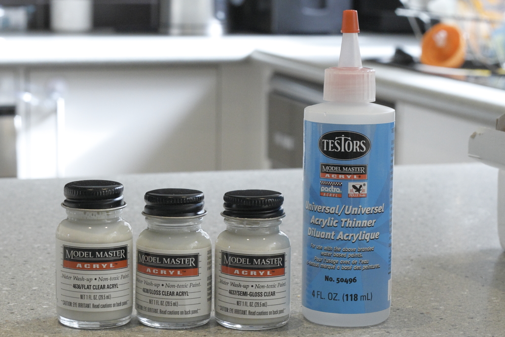

wm cheng Posted August 24, 2010 Posted August 24, 2010 I paint with Tamiya Acrylic, but clear coat with ModelMaster Acryl - the ModelMaster has a different solvent base than the Tamiya (don't know what it is), but when I use Windex (deadly solvent for Tamiya Acrylics) to wipe off the undesired weathering post shading on top of the clear coat in Tamiya, the Tamiya weathering wipes off just fine leaving the ModelMaster Acryl clear-coat to protect the underlying Tamiya Acrylic basecoats.
mickyg Posted August 24, 2010 Author Posted August 24, 2010 Yep, I know your technique well! And I'd use it to the letter except that I can't find model master acrylics here in Australia. They really sound like the ultimate paints for this purpose alone - to be able to seal your hard work in with a layer that won't react to the one it coats, and also be able to use a solvent that would normally disolve that sort of paint, on top of it, that would be fantastic! Maybe I should get some of my relatives in the States to send me a bottle of clear and flat. Does it thin with windex when it's still a liquid or do you use the Testors thinner on it?

mickyg Posted August 26, 2010 Author Posted August 26, 2010 I think I'll try to source some. There has to be somewhere that will sell and ship it internationally. It sounds like the best possible barrier to use for this sort of thing. One last question, is it as soft or fingerprint prone as the Tamiya clearcoats? I haven't had any issues with the flat coat but the gloss is incredibly soft in my experience.
wm cheng Posted August 26, 2010 Posted August 26, 2010 I think I'll try to source some. There has to be somewhere that will sell and ship it internationally. It sounds like the best possible barrier to use for this sort of thing. One last question, is it as soft or fingerprint prone as the Tamiya clearcoats? I haven't had any issues with the flat coat but the gloss is incredibly soft in my experience. I don't ever use the straight gloss, it's always semi-gloss or I use the straight gloss to tone up the semi-gloss or mix it with the flat/matte - but I would imagine the straight gloss to be "soft" and prone to fingerprints the same as everything else including Future. I think it has something to do with the fact that to get the glossy surface, you have to have an ultra-smooth (microscopically so) surface, and your finger oils contribute to making the surface bumpy and thus seeing the imprint even more so. I haven't had the need since I don't model cars (yet, although Tamiya has a Aston Martin DBS which might be my first foray if I ever get the time!) so I never need that really glossy sheen - it makes the models "toylike" IMHO.

mickyg Posted August 30, 2010 Author Posted August 30, 2010 So I found a LHS that can get the Testors MM Acryl range in for me! Only it sounds like they'll be close to $10 per bottle! Ouch!!! I'll likely pay it with a smile on my face though, knowing that at least this will do what I want it to. And it's $30 as a one off. Most of what I've purchased has been expensive but not terribly frequent so this is not going to kill me. It'll be a few days before it's in stock. I also got a chance to get some experience with the Tamiya weathering kit. I was actually quite surprised by how it went. The material is quite hard and I wasn't able to get it to stick to the "brush" side of the applicator. The sponge side though, was great! It went on very lightly and I was able to have a few passes to get it as dark (or light) as I wanted it. My experience and "feel" for where shading needs to be is definitely needing some work though. There are pics but they're all pretty lousy so it might be a few days before there's any progress posted.

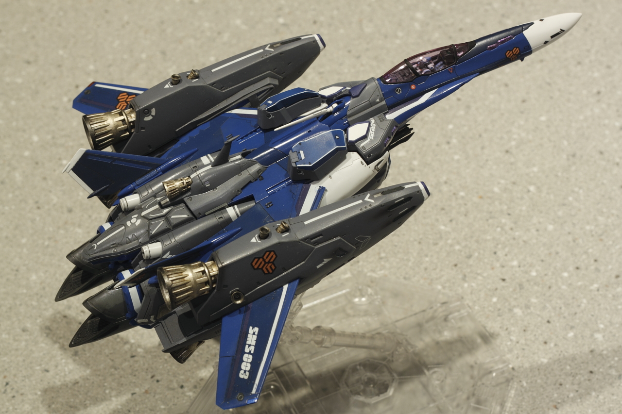

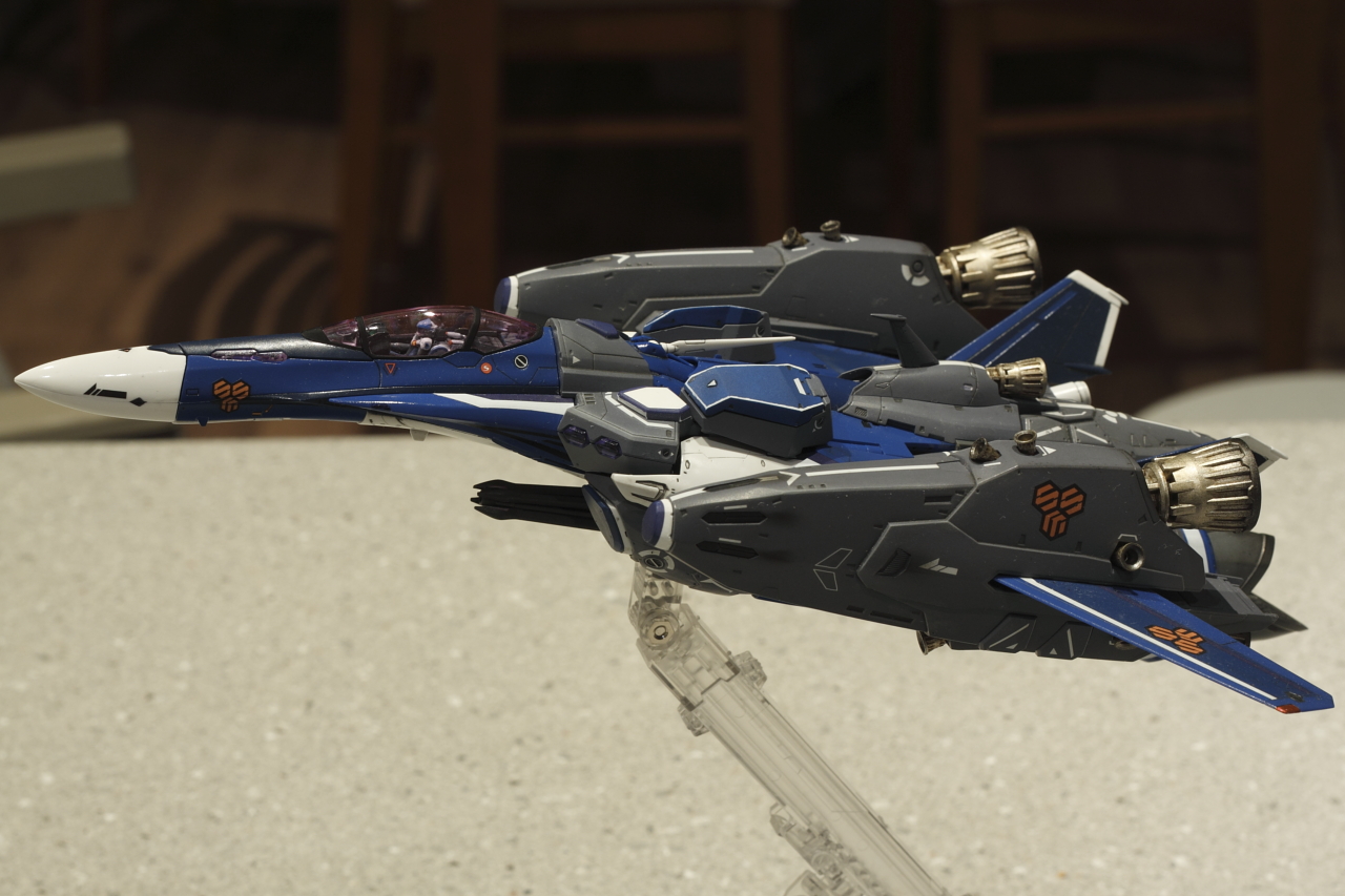

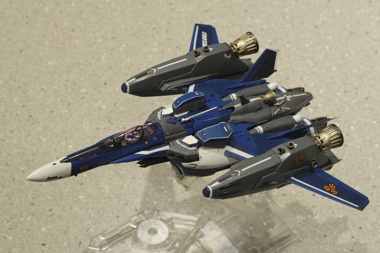

mickyg Posted September 2, 2010 Author Posted September 2, 2010 (edited) Took some better pics tonight. I'll explain what I've been trying to accomplish with all the different cameras and focal lengths and distances, blah, blah, blah... I wanted to try to approximate what something real of this size would look like if I were there, in scale, taking a picture. The little point and shoot I recently acquired is super old (2003, perhaps?) and it's pretty noisy. But it does have full manual controls, and a real aperture, with real depth of field adjustments. And I can get really close with it. It also shoots in raw format, so I can apply noise reduction and do lens distortion correction in post production, to clean things up. My second camera is another point and shoot, has no aperture control, no depth of field settings and no real control over quality other than jpeg compression. But it does focus close and it's newer than the first camera and also tends to have less noisy images. Both point and shoots are 5 megapixel, which is fine for post on the web. And my "good" camera is a DSLR - quality is really good, it works well in low light, it's got the flexibility of multiple lenses and full control over just about everything. The downside is that no lens I have will allow me to get "close" to the model. If I were a scale person, I'd be reasonably close to the "life-size" aircraft I was photographing. Probably the equivalent of a 6 inches or so? My lenses won't get that close. So there lies the dilemna - to approximate the correct perspective, I have to use a camera that doesn't produce the best quality. If I want to use a good camera, I have to lose the whole feel of this being an accurate portrayal of scale. So these were taken with the good camera with a 50mm lens, which approximates what your eye sees in terms of perspective. Good for viewing a model, not so good for making it look "real" in a photo. This ends our photography lesson for the day... So here's what I ended up with (link to the gallery with some more pics - HERE): Edited September 2, 2010 by mickyg
Weasel Posted September 6, 2010 Posted September 6, 2010 That really is a lovely looking build, great work!
mickyg Posted September 7, 2010 Author Posted September 7, 2010 Thanks Weasel! It's a real shame there aren't any static 1/72 models for Frontier stuff yet. I'd get the whole squadron if that were ever to be released!
Weasel Posted September 7, 2010 Posted September 7, 2010 I would kill for the standard Spacy fighter in 1:72 from Frontier, I know how you feel!
nickster Posted September 7, 2010 Posted September 7, 2010 Great build! I like the blue tone on your model. Congratulations!!!!!
mickyg Posted September 8, 2010 Author Posted September 8, 2010 Thanks very much! Haven't seen you around for a while Nickster. Been busy?
Weasel Posted September 12, 2010 Posted September 12, 2010 That is a truly awesome build. Really inspiring paint job and construction. Can't wait to see the next one
