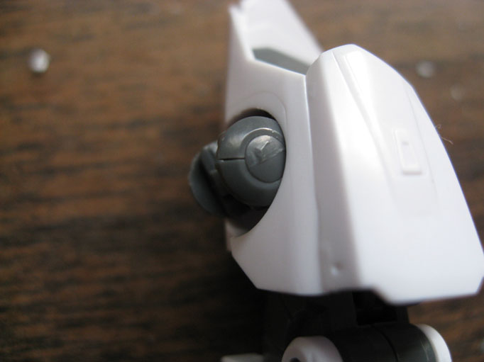

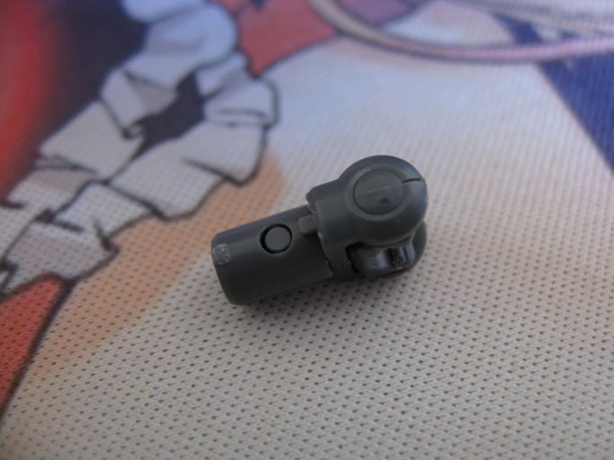

shiroikaze Posted April 4, 2009 Author Posted April 4, 2009 (edited) So, uhh--eheh... hey guys... and yikes. I broke this hip piece of my VF-25F kit while trying to pull a leg out since it wasn't lining up properly for some reason (it lines up now for some odd reason). I guess I know how to fix this, but my actual question is: How do I reinforce it once I do fix it? Also separate question, did Tamiya ever release that white putty? Edited April 5, 2009 by shiroikaze
MechTech Posted April 5, 2009 Posted April 5, 2009 Ouch! Take it apart and glue it back to shape. You can do one of two things next, make a "washer" out of styrene that fits around it and glue it over it. The other is to glue fiberglass or carbon threads around the socket. Hope it come out out alright! - MT
shiroikaze Posted April 5, 2009 Author Posted April 5, 2009 (edited) Ouch! Take it apart and glue it back to shape. You can do one of two things next, make a "washer" out of styrene that fits around it and glue it over it. The other is to glue fiberglass or carbon threads around the socket. Hope it come out out alright! - MT Thanks, it doesn't seem easy but I'll look into these options and give 'em a try! Edited April 6, 2009 by shiroikaze
