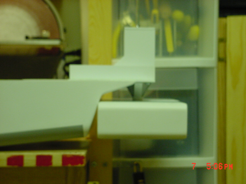

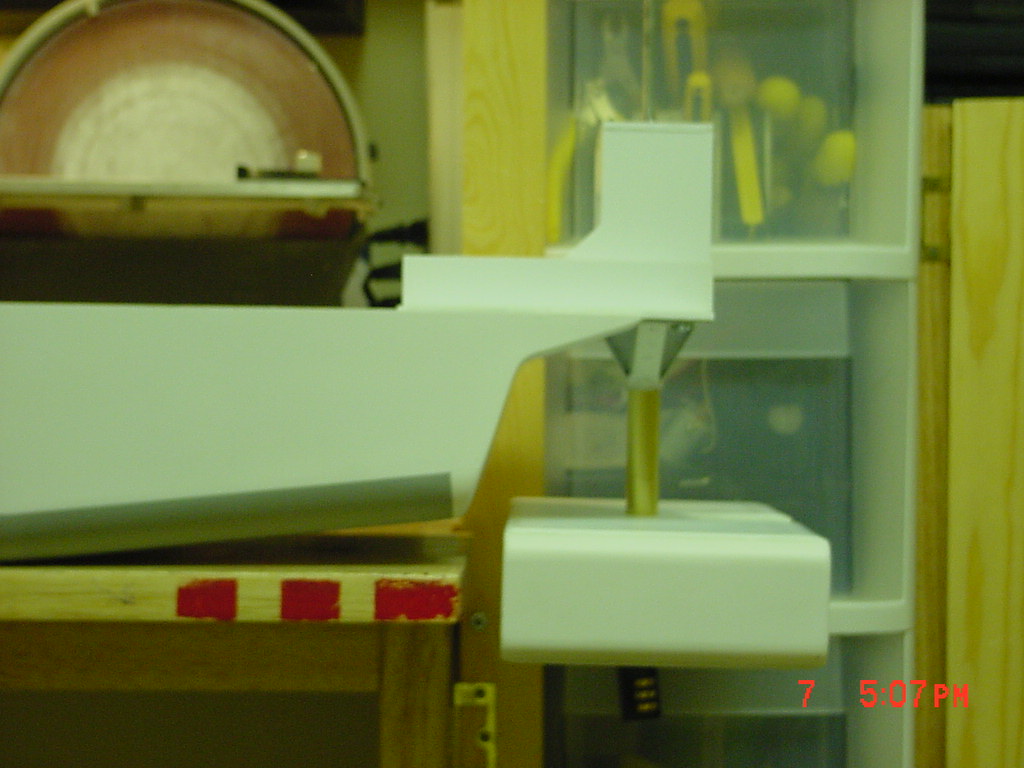

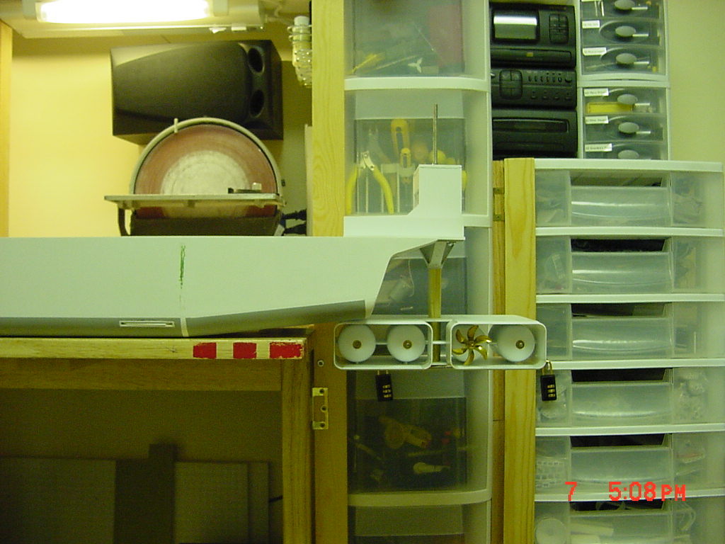

  8. UPDATE 15 NOV 06 Thank you to everyone for your comments. It helps keep me motivated for what is dragging on longer than expected, but worth it! FINALLY finished the gearcase to raise and lower the pod assembly. It takes two minutes and is terribly slow to watch (turn on, go to the bathroom, come back and it's almost done). I used a small gearcase and motor to keep weight down since it sits high and I've gotta keep the center of gravity as low as possible. The video would put you to sleep if I took some . [attachmentid=38183] Here's the gearcase from the side, it came from an old toy tank (don't tell HWR). It sits in rails (under the black screws) and slides a litlle to engage or dis-engage from the main gear/thrust bearing assembly. There is a spring on either side (under the left hand screw) that keeps it pushed up into the gears normally. When the pod is either fully up or fully down this gives it a safety ratchet so it won't strip any gears. [attachmentid=38184] From the stern you can see drive gear better. The threaded rod goes through a nut and bushing in the center of the gear. The gear sits on a thrust bearing that makes gear rotation and steering smoother. The funny looking part on the left side of the box engages or dis-engages the gearcase. The gearcase is dis-engaged to make steering smoother after lowering. [attachmentid=38185] How heavy is the motor assembly? Yeah, a picture's worth a thousand words! It only takes one of the 6 volt gell cells to counter balance it though. On to hooking up the motors and steering... - MT

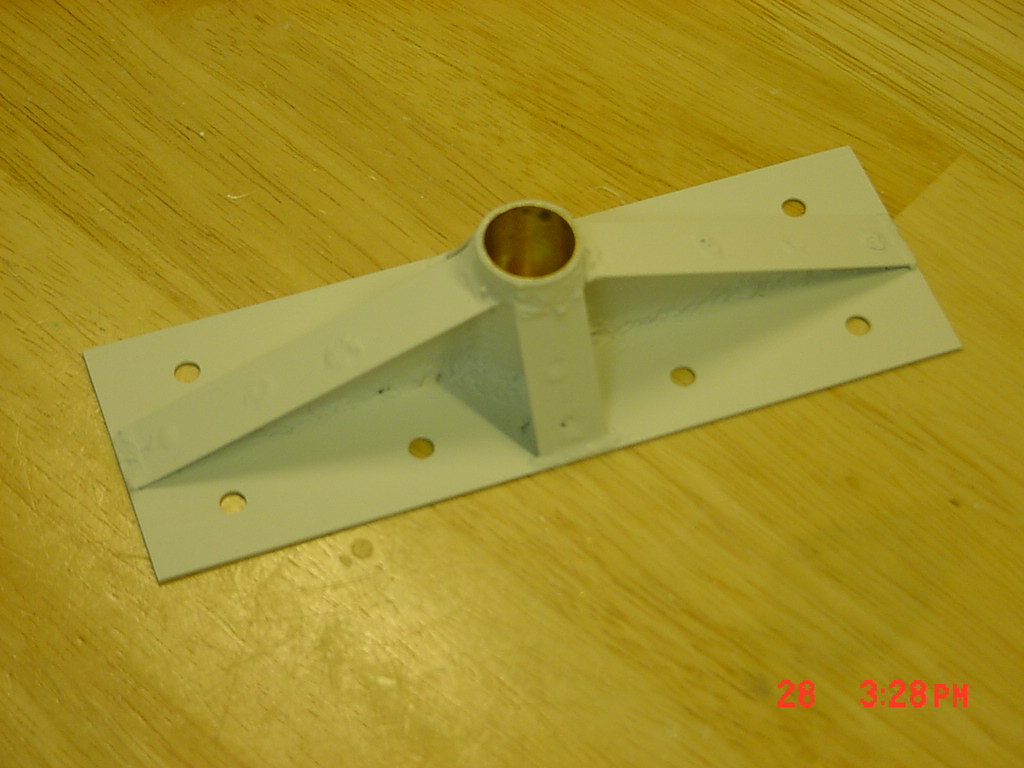

  20. Thanks guys. The upper part won't be for at least another month or two. I HAVE to keep my workbench clean or my two little ones will destroy or misuse what;s on top! The mounting point is made of HEAVY DUTY brass parts soldered together (earlier posts show some of it) with eight bolts holding it in place. All of the plastic around it is 3mm thick styrene and some carefull engineering to increase it's strength and placement efficientcy. In this case, more is better! The motors are so heavy, it does a "wheelie." I photographed this with one of three batteries in the hull. So far, so good... - -MT

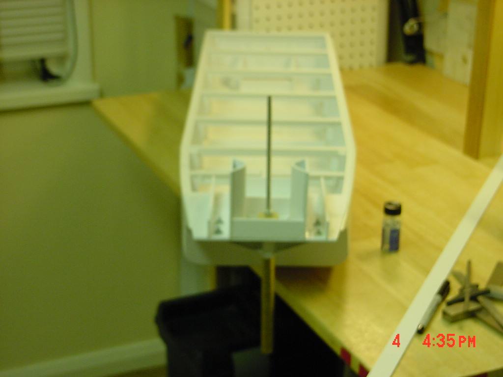

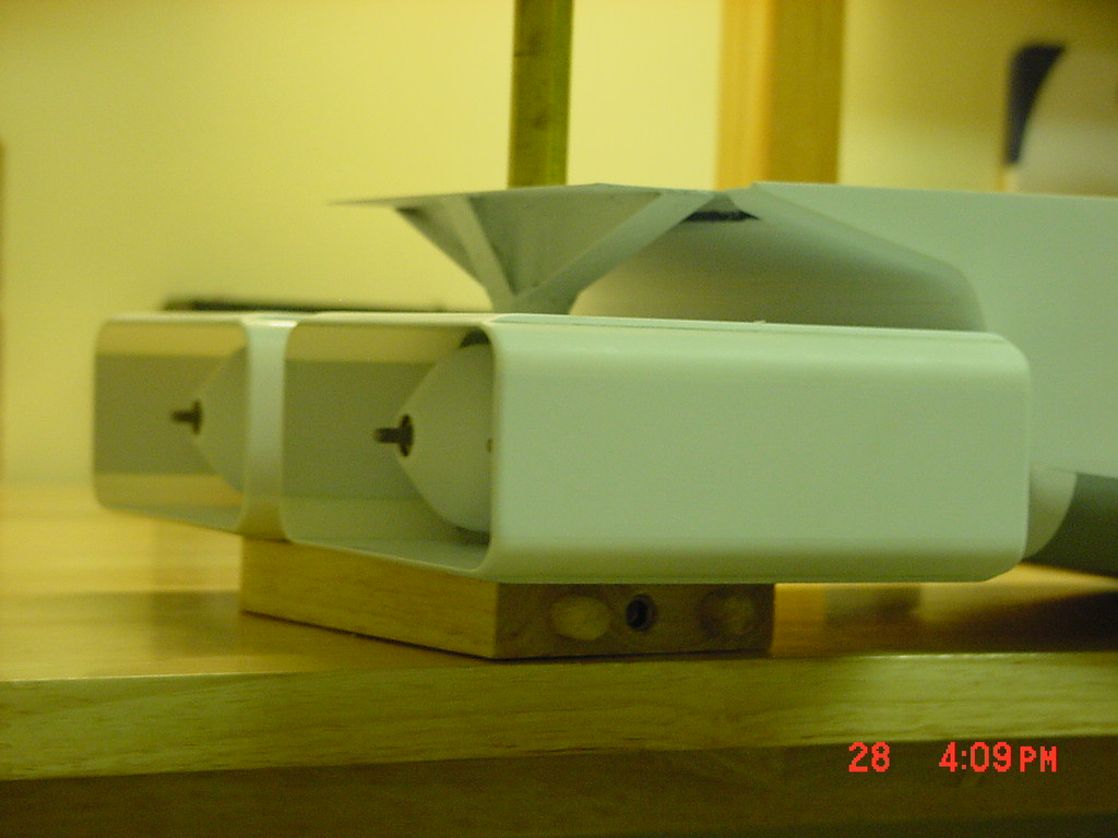

  22. UPDATE 8 Nov 06 These are some ROUGH pictures showing the parts assembled but still not completed yet. I figured out my battery needed charging so the focus was off in the first two . [attachmentid=37871] Motors UP. [attachmentid=37872] Motors Down. [attachmentid=37873] Motors turned 90 degrees for parallel parking (hopefully it won't capsize lilke this either ). I still have a lot to do on these parts, but here they are test fitted. - MT
