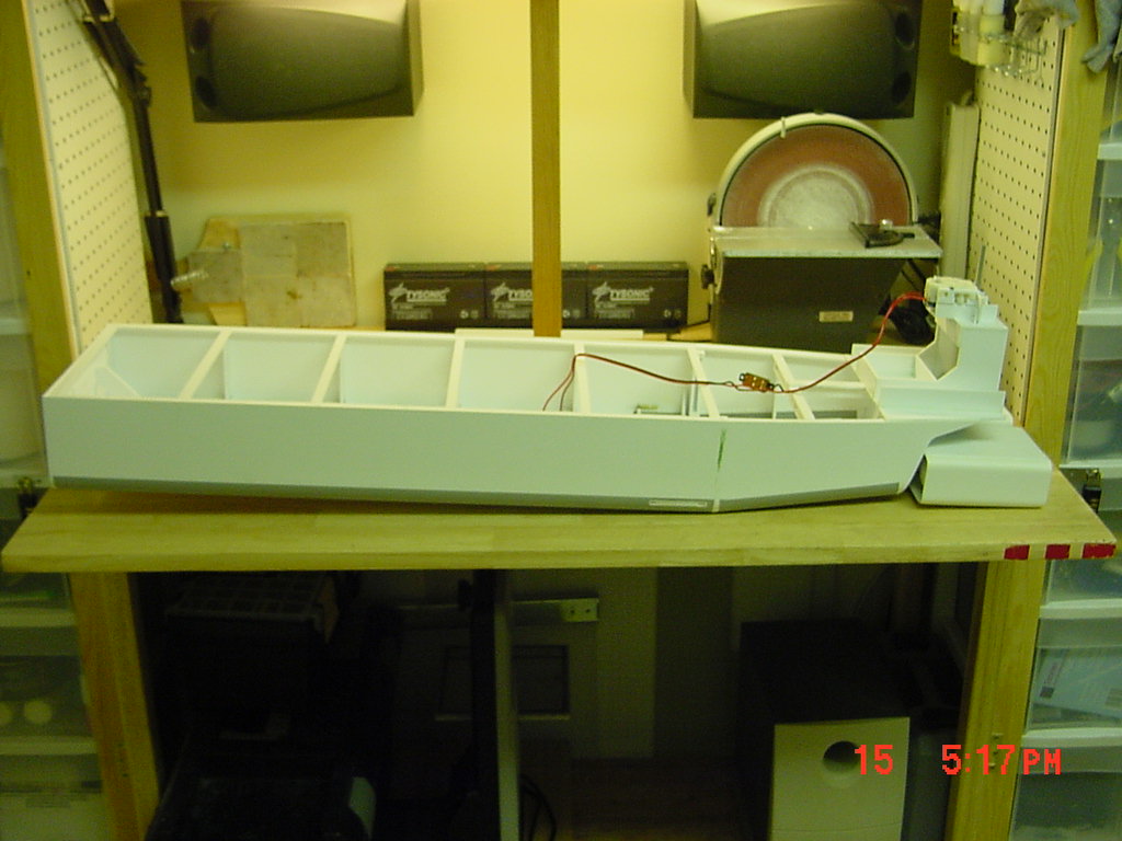

  5. UPDATE 4 DEC 06 FLOAT TEST! YEA IT WORKS! NO PROBLEMS! [attachmentid=38635] Here's the front. It's so stable, you can rock it with the 4.5lb battery on top! [attachmentid=38636] Here's the back with all three batteries (13.5lbs). Plenty of buoncy to spare! I think I'll have to add some weight to the hull (still have more goodies to put on anyhow). When the winds and rain let up, I'm going to the reservoir! - MT

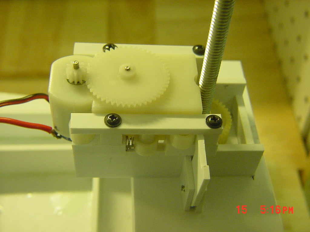

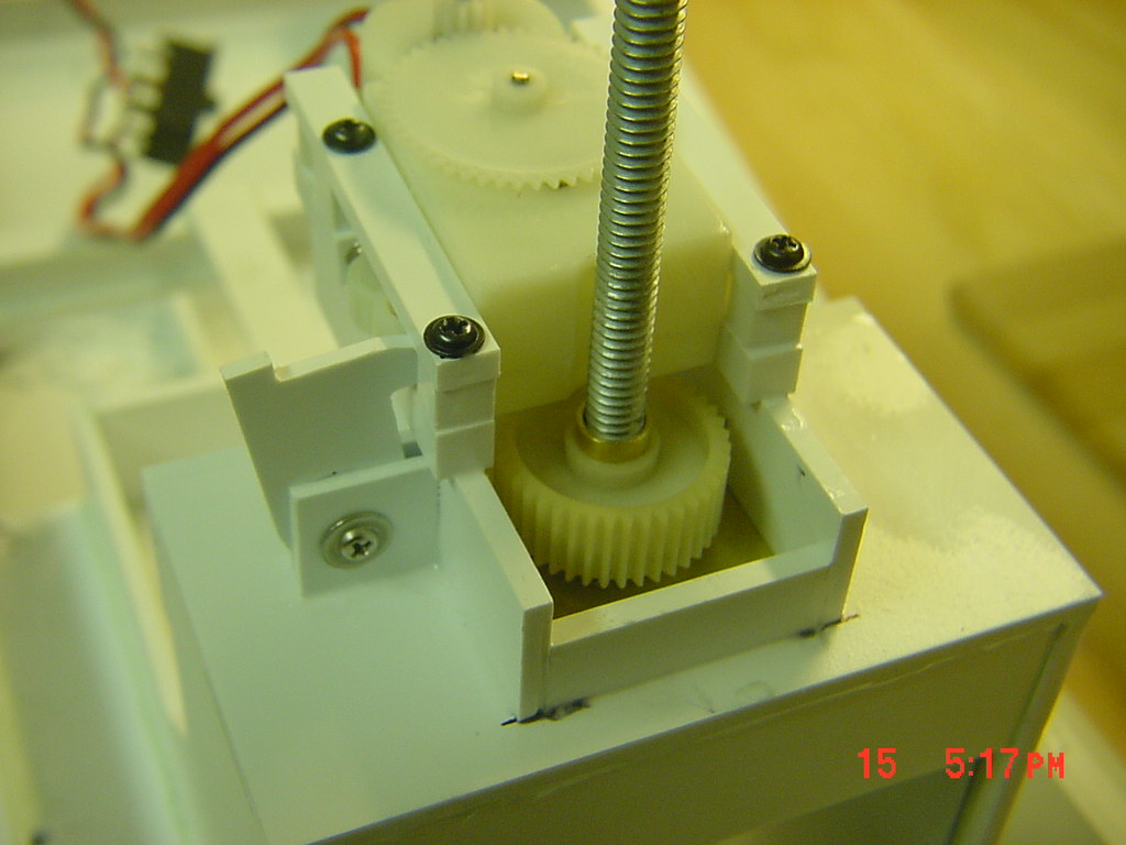

  11. UPDATE 28 Nov 06 Thank you honneamise for the humbling words. I've been wanting to build something like this for about a decade now. It's all those years of collecting parts and models to build this thing that help keep me going. Not to mention tonight's test! Your work is awesome too by the way. I always wanted to build models professionally, but it's not my calling. Thanks isamu too! I'll let you know when it's ready to go! It might be spring time by then!? Yeah! We got steering now! If the MPEG's work, you can see for yourselves... [attachmentid=38553] This is a Futaba 3802 sail servo (brass gears and bearings) heavily modified. The stop pin on the inside is removed to allow 360 degree constant rotation and the potentiometer has been moved out to the external gear (you can just see it under the acrylic box). What used to drive a giant sail arm, now spins a pinion gear. That turns the spur gear giving me more power and a slower steering rate. The giant nut on the spur gear is part of a stop mechanism (underneath) to keep the gear from ripping the potentiometer apart should a bad radio glitch occur. [attachmentid=38554] Steering in action (MPEG). [attachmentid=38555] Steering in action showing the gears working (MPEG). This is only a test and all of the mountings and hardware still need cleaning up and lubricating. But all work and no play... I borrowed the receiver setup from my other 1/200 ship for now. I can't seem to get the MPEG's to work. Anybody got some ideas? - MT Steering_Side.MPG Steering_Below.MPG

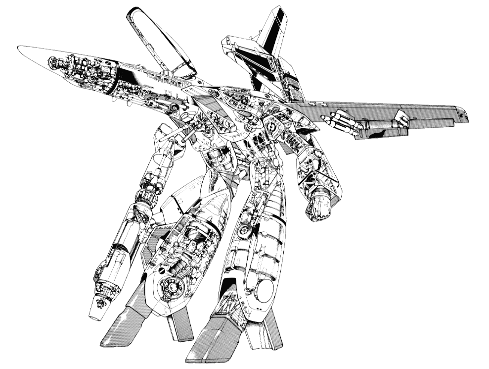

  20. Do these help? [attachmentid=38315] [attachmentid=38316] Hopefully these official drawings will clarify things. - MT
