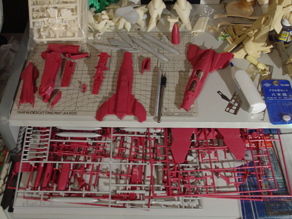

Jinnai Posted April 6, 2004 Posted April 6, 2004 I aquired this kit today as a commission for a friend of mine, combine that with my new digital camera (Sony Cybershot: 5.0mp w/ 4x Optical Zoom) I decided to share my work in progress with Hasegawa's newest offering: Nora's SV-51. Most of this is OOB, however my friend wanted some little extras done, such as raising the landing gear. So I started work on what I could to begin with, keeping everything in front of me.

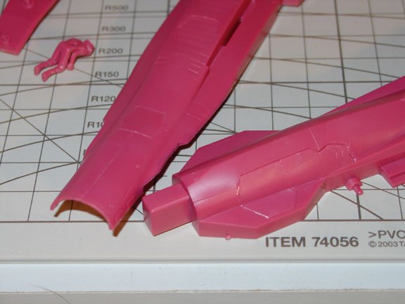

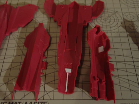

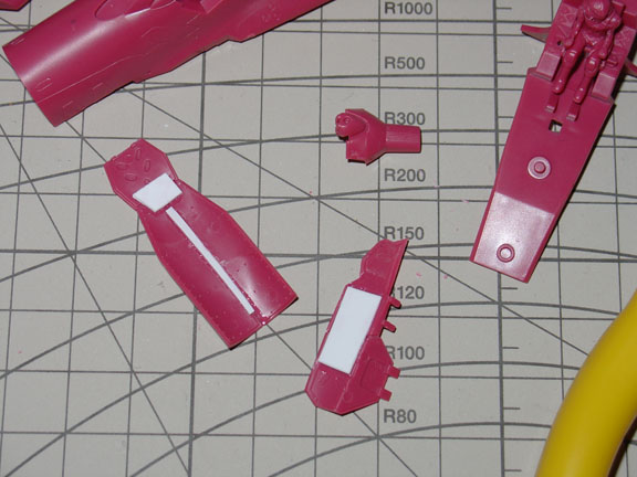

Jinnai Posted April 6, 2004 Author Posted April 6, 2004 To start off with, I cut the front and rear landing gear covers out of the sprue. I then cut pieces of 0.4mm sheet styrene, and afixed it to the back of the gear covers for support. Then I trimmed the connection points that attach the original open covers to the fuselage.

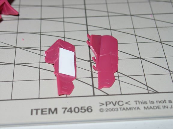

Jinnai Posted April 6, 2004 Author Posted April 6, 2004 Here are the rear landing gear covers. It's really important to keep them flush while drying, using extra glue gives it a little bit more playing time to get that final finish perfect. Also, the SV-51 has panel lines going across the covers, so they need to be kept in line also. Don't worry if any glue seeps out through the gaps, as these will be rescribed later when the glue dries.
Jinnai Posted April 6, 2004 Author Posted April 6, 2004 Shown here is where I've glued the now closed covers to the landing gear bays. The actual bays themselves will still be glued to the inside of the kit of added stability. This part is actually slightly difficult, as you're trying to keep the covers flush with the kit. If they sink in too much, you'll need to cut it out and reglue it in. If they sit raised slightly, then you can just sand it back. I've fiddled with raising the landing gear on all of my Hasegawa Macross kits, and by far, this is the 2nd easiest kit to raise the gear on. The easiest being the YF-21. Sofar the YF-19 was the one I've had the most trouble with, as the nose gear has the molded on gear bay with the kit. Still working to get that one right... one day.
Jinnai Posted April 6, 2004 Author Posted April 6, 2004 Here's another shot of the closed doors glued to the kit. Later on, I'll put some Mr. Surfacer around the edges of the doors, then sand back and rescribe to make it perfect. There's a bit of a gap on the doors on the legs of the kit, but it's nothing too major. With the nose, I test fitted the piece constantly with the assembled nosecone to make sure it all fit flush while it was drying. Had I not done that, it'd be rather annoying when I go around to fixing the nosecone to the fuselage.

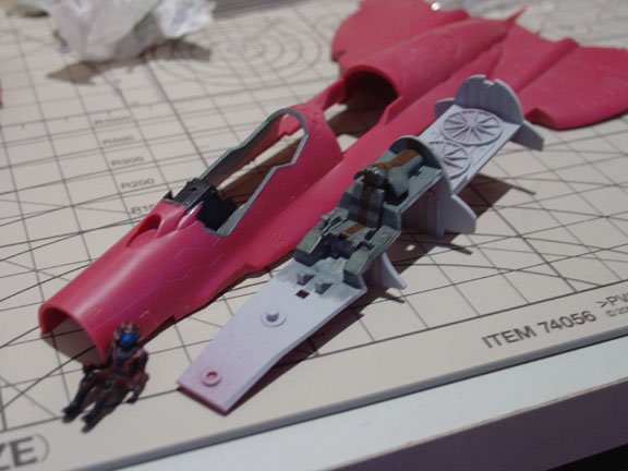

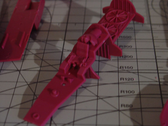

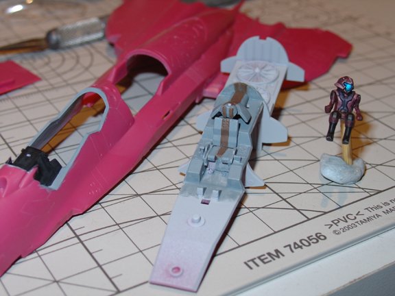

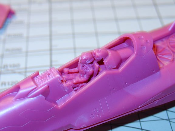

Jinnai Posted April 6, 2004 Author Posted April 6, 2004 I've got the completed cockpit shown here, minus the ejection seat handles, as they interfere with Nora's head. If I were to glue them now, I wouldn't be able to glue Nora to the seat. So, prepainting first, the assembly. Something I.. don't particually enjoy. The control stick was quite annoying to fit in, plus.. I don't think it's long enough. You can barely see it between her legs when Nora sits in.

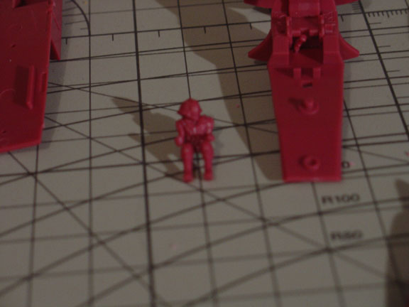

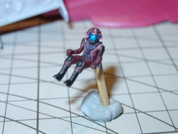

Jinnai Posted April 6, 2004 Author Posted April 6, 2004 And athough you can't see her very well, here's Nora. Since my friend wants to put his SV-51 with (come on..we all know it's coming) Hasegawa's VF-0D to recreate the scene from OVA 3, I thought I'd position Nora looking to the left like she does in the same scene. More to come.

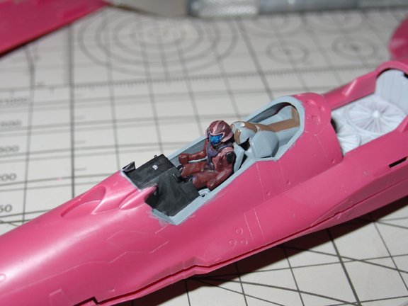

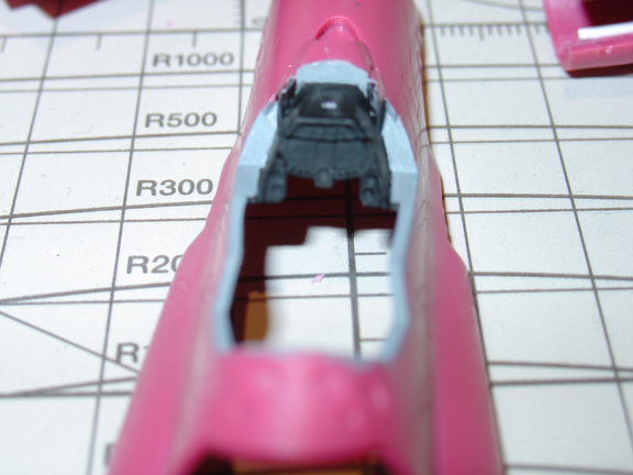

Jinnai Posted April 10, 2004 Author Posted April 10, 2004 Time for an update. Shown here are the main cockpit pieces and Nora, with base coats down. I'm getting myself prepared to flood the cockpit with a black oil wash (I need to retrive my oil paints from a mate), then I'll decal the instrument panel and seal her up. After washing I'll drybrush a slightly lighter grey over the top of bring out definition, and do some minor fixups that my camera just made apparant.

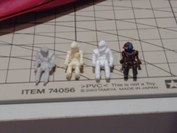

Jinnai Posted April 10, 2004 Author Posted April 10, 2004 Nora was.. interesting to paint. Instead of using Tamiya, I sat back and made some small custom mixes from my Citadel paints, because I'm more used to using them for fine detail. (I've been painting miniatures for 13 years now). The flightsuit was followed from the same paint ratios called out on the instructions, while the trims around the helmet and the straps I added a bit more colour too. The boots, shoulder pads and knee pads called for a black/grey, but from watching the anime I decided just to stick to using a pure black, as grey seemed to not have that much of an effect on a primarily reddish suit. Also, the instructions said to paint the bottom of the feet pink, but.. you can't see them when she's sitting in the cockpit, so why bother? The visor was Tamiya Chrome Silver, covered with Clear Blue.
Jinnai Posted April 10, 2004 Author Posted April 10, 2004 (edited) Please forgive the blurriness of these next two images.. I'm still playing with my camera. Shown here is a beauty shot straight down the nose, showing the instrument panel of the cockpit. Awaiting the inevitable oil wash, and decaling. Hasegawa created 4 decals for the panel alone, plus two smaller ones for the mirrors on the side. If only they did a HUD decal like on the VF-0S. Stamen: STFU. Edited April 10, 2004 by Jinnai

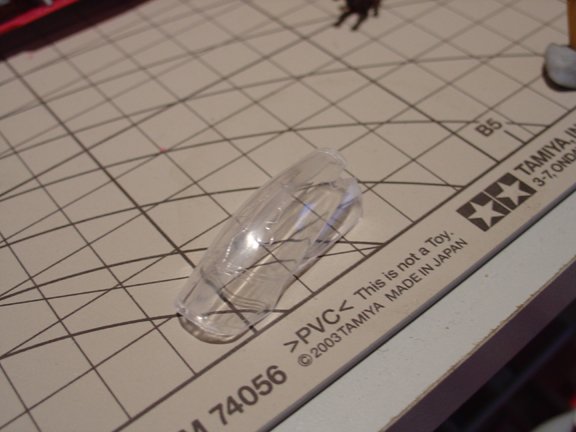

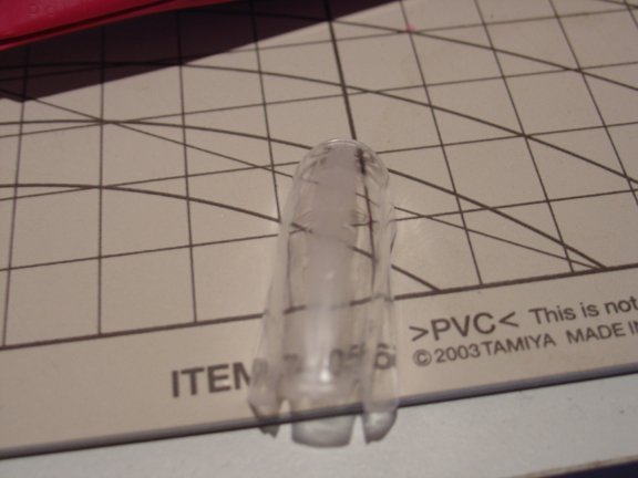

Jinnai Posted April 10, 2004 Author Posted April 10, 2004 So as I wait for my mate to finish work so I can get my oil paints back, I thought I'd continue working on the cockpit by sanding the seam line down on the middle of the canopy. I was stoked when the YF-19 and YF-21 came out, eliminating that seam line down the middle of the clear canopies. When the VF-0S came out, and the seam was reinserted, I was saddened. Hoping that they'd make a difference for the SV-51 considering there is that watermark-like design on the canopy, I was saddened again when the seam was there. This was wetsanded back, starting from 600 grit, through to 1000, 1200, 1500 and finished with 2000. If I had finer grades, I'd keep going all the way through, but unfortunately I don't have access to such products. Although I'd get them in a heart beat if I could. Next step from here is polishing, then the future dip.
Jinnai Posted April 10, 2004 Author Posted April 10, 2004 One polished canopy, awaiting the future dip. I need to give it a quick clean beforehand, so I remove any fingerprints and left over polishing compound before the future seals up the canopy.

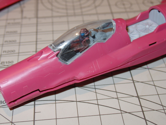

Jinnai Posted April 10, 2004 Author Posted April 10, 2004 Canopy added. It's a shame that most of the cockpit is obscured when the canopy is attached. Especially with some of the hard work put into painting it. But.. I'm proud because I know it's there. It's a detail I couldn't overlook.

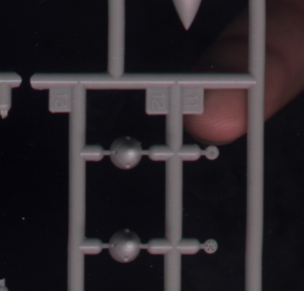

Jinnai Posted April 10, 2004 Author Posted April 10, 2004 While still waiting, I thought I'd work on some other little parts for extra detail and such. I took my microdrill bit which is about a 0.3mm bit, and drilled out the holes on the machine guns. The kit part has detail, but they're very shallow and small barrels, I thought the hole on the barrel could be enlarged, just to make it look a bit more realistic. Unfortunately my camera was having a hard time focusing on the part (I still haven't figured out how to disable my auto-focus and create new manual focus settings.. my camera has that option, but I haven't had time to play around that much) so I threw the sprue on the scanner. And that still didn't work well, but you CAN see it... even if just barely. My index finger is there for size comparison.
Jinnai Posted April 10, 2004 Author Posted April 10, 2004 (edited) One last little picture before I call it quits for the night: From left to right: DYRL Weapons Set, YF-19, VF-0S and Nora. Missing: Guld (as I've seemed to misplace him and I have no idea where he is.. probably in one of my 8 drawers full of bits, sprues and parts), Max/Miria (VF-22S, kit is still in bags.. ain't touching it for a while) Edited April 10, 2004 by Jinnai
