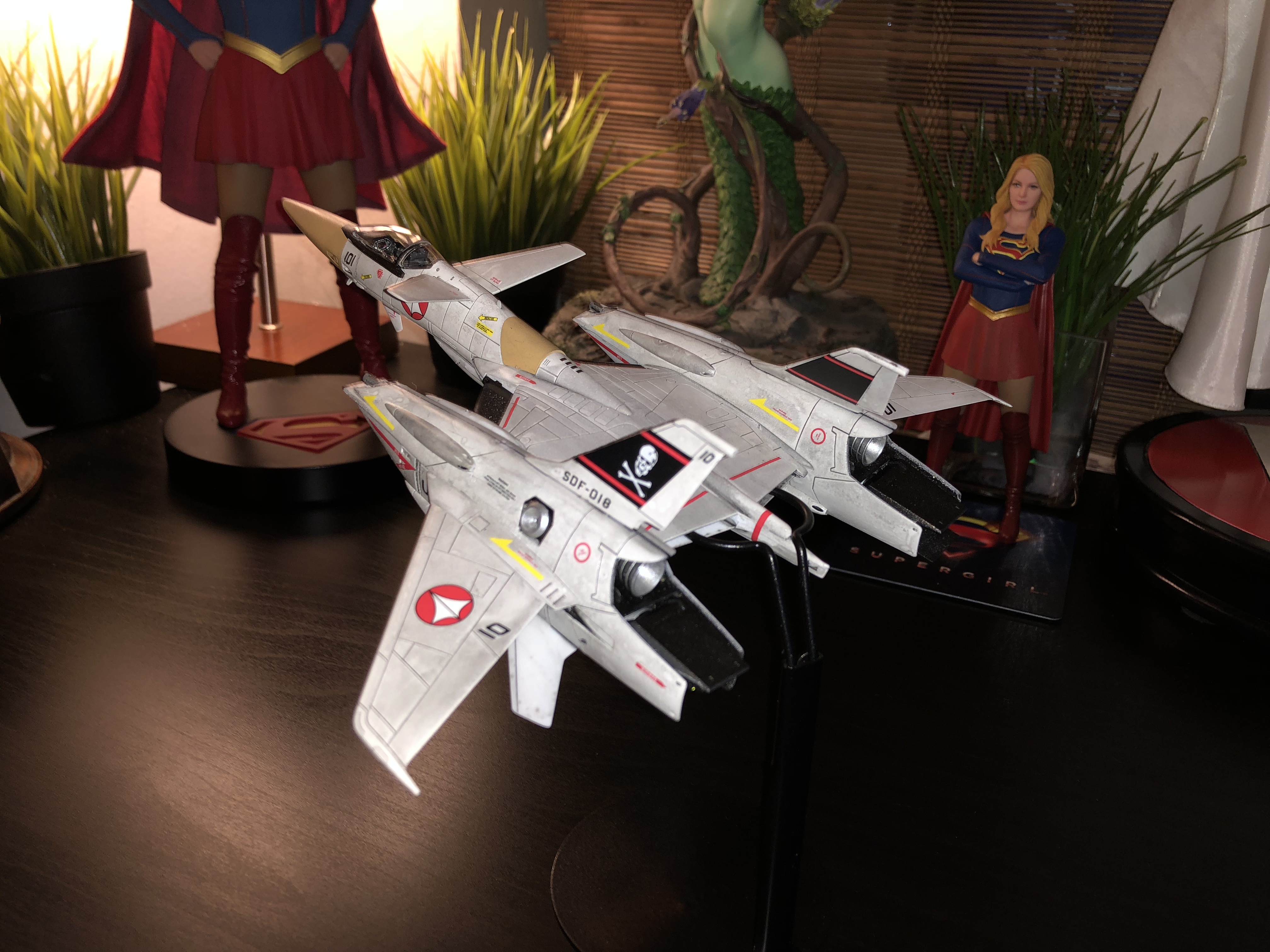

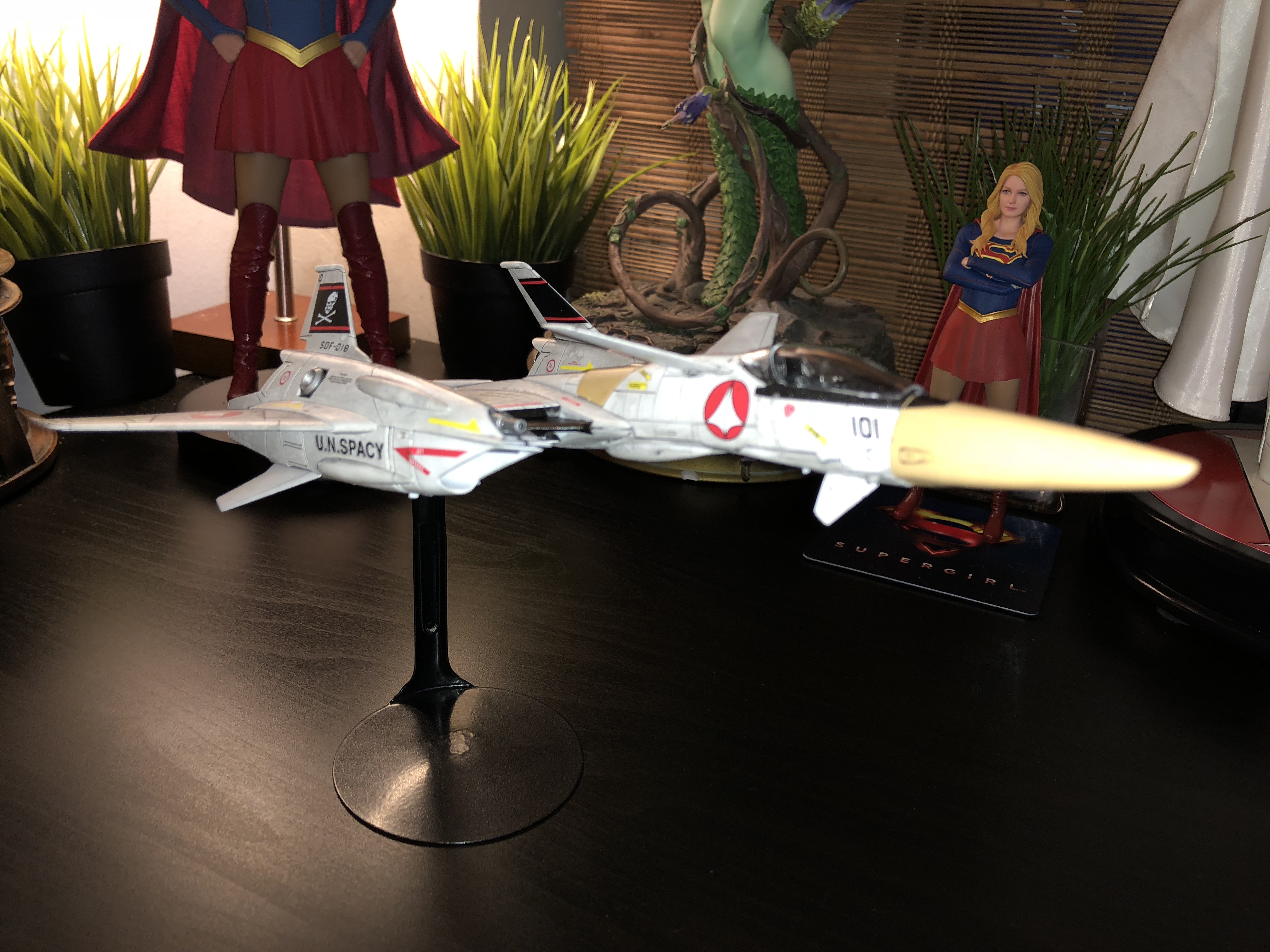

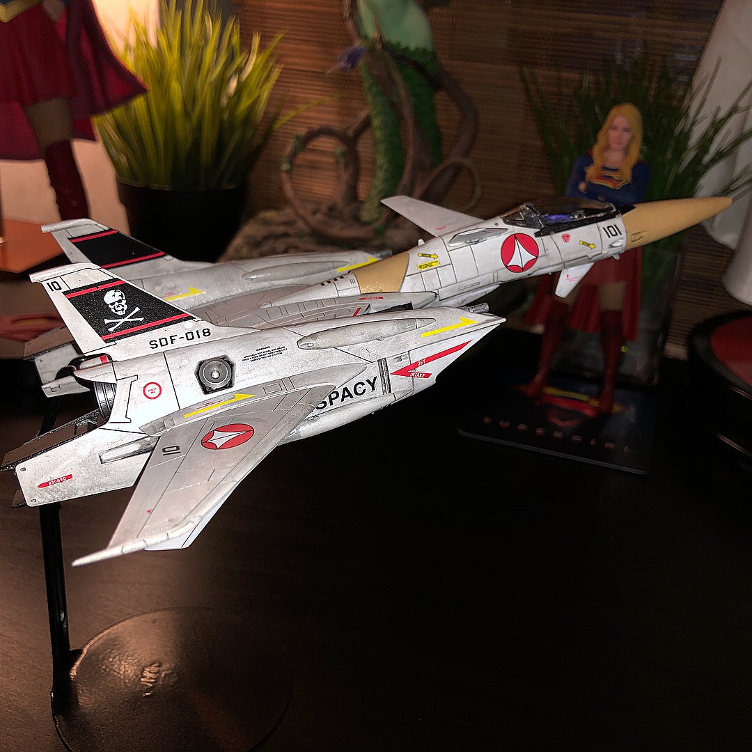

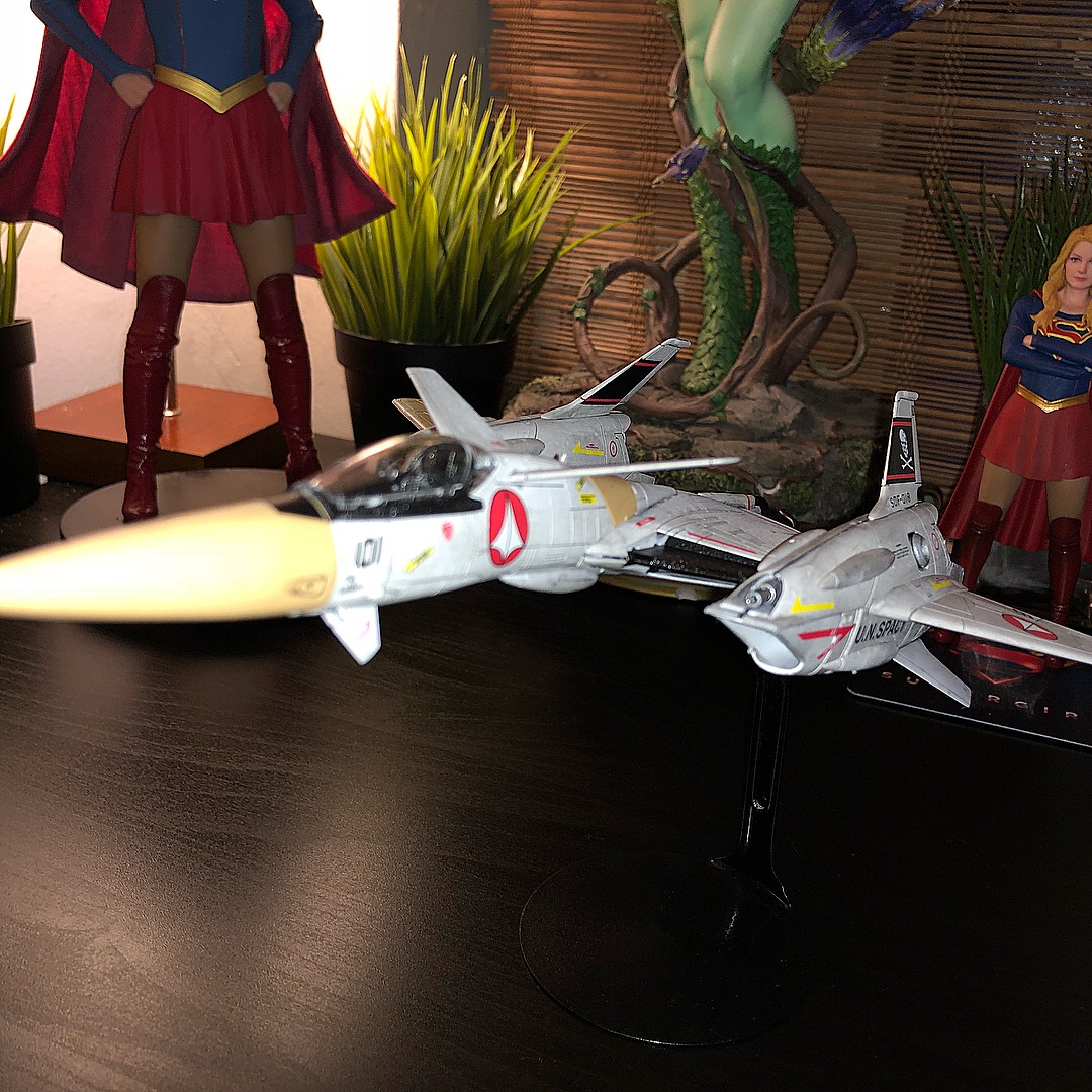

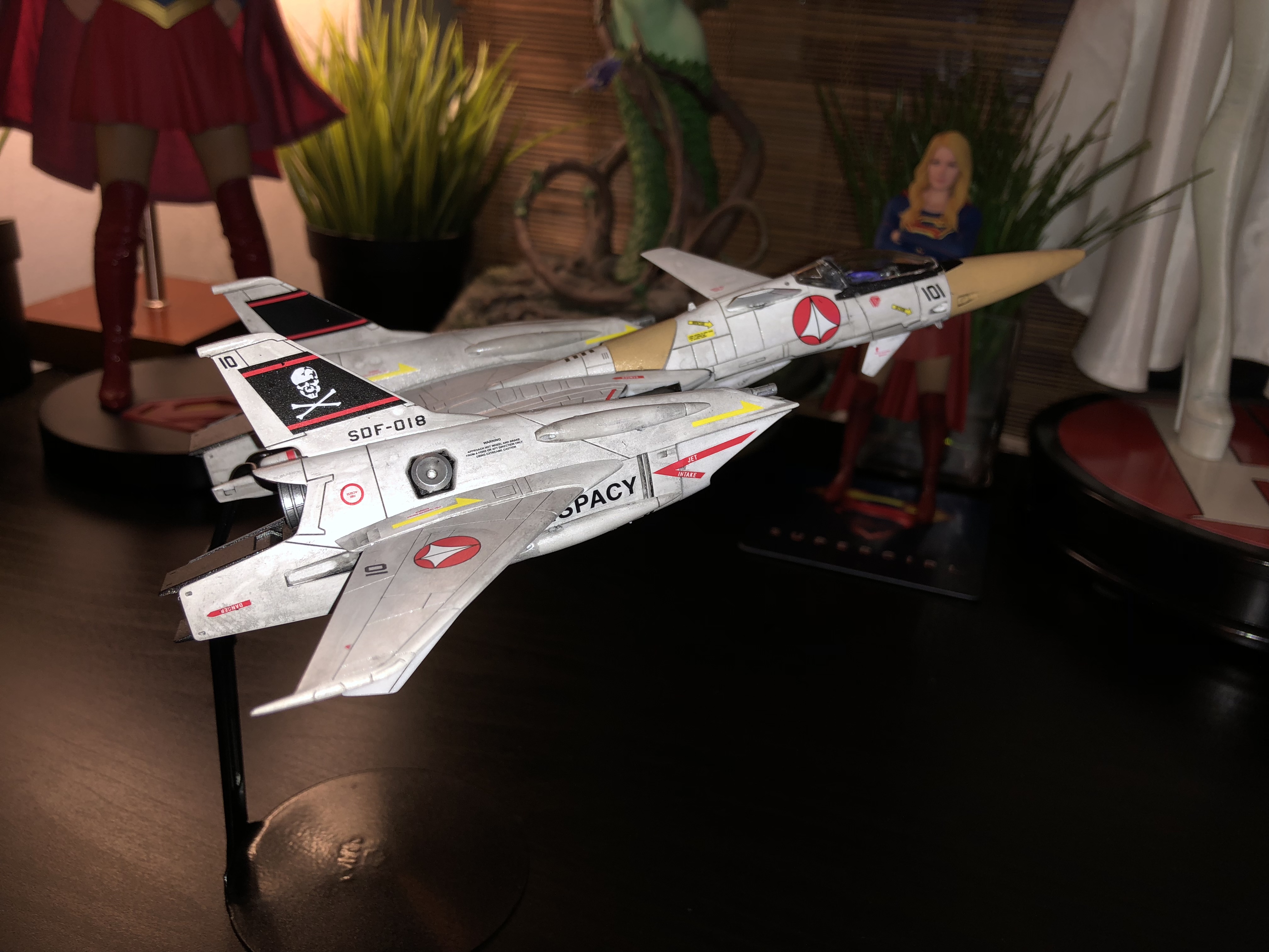

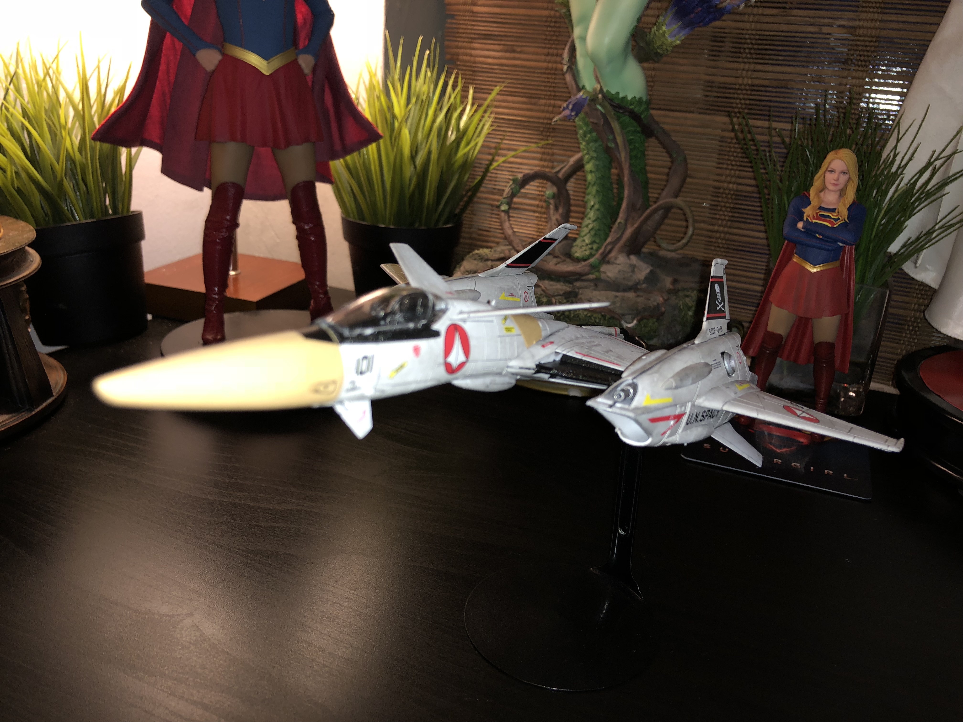

mustang1 Posted April 27, 2018 Posted April 27, 2018 AGR’s pop culture reviews: Hey guys I just got this 1/72 scale kit of the VF -4 lightning III. Not bad for a snap together kit . Thought you’d might like to see the finished product in case you’re interested.
no3Ljm Posted April 27, 2018 Posted April 27, 2018 2 hours ago, mustang1 said: Love this shot. 2 hours ago, mustang1 said: Quick question though. On the lower right side of the pic. The cannon area. Is that a gap on the parts or just panel line?
mustang1 Posted April 27, 2018 Author Posted April 27, 2018 (edited) Glad you noticed, unfortunately the engine the cell doesn’t fit too well. There’s a natural gap for some reason and I’m not that great with putty. so it created an uneven surface but it had an unexpected result that I thought looked really cool so I just left a semi gap and then painted a gun metal stripe running up the engine. Actually kind of prefer it that way . Of course that meant I had to do the same thing to the other side for uniformity. But I like the end result looks like the Canon has a groove. Edited April 27, 2018 by mustang1
NZEOD Posted April 27, 2018 Posted April 27, 2018 you need to glue and clamp that part, then the gap disappears

mustang1 Posted April 27, 2018 Author Posted April 27, 2018 7 hours ago, NZEOD said: you need to glue and clamp that part, then the gap disappears I usually do, but this is a snap together kits and the lines get a bit difficult.
mustang1 Posted April 27, 2018 Author Posted April 27, 2018 5 hours ago, Big s said: I like waves variety, but they definitely are not bandai in terms of fit. Yeah nice variety , but Bandai is superior in my opinion. But not bad over all, you just need to be a little creative with some of the seem lines.
NZEOD Posted April 27, 2018 Posted April 27, 2018 (edited) 5 hours ago, mustang1 said: I usually do, but this is a snap together kits and the lines get a bit difficult. I'e built one and working on 2 more, that section goes together fine with a small line of tamiya limonene extra thin and some clamping while it sets. ONLY PUT THE GLUE ON THAT FRONT SECTION OF THE NACELLE THOUGH AND NOT INTO THE SNAP FIT HOLLOW RODS... I've discovered the plastic deforms in the snap fit rod from the cement and can show a dimple on the nacelle surface. That join then needs I tiny bit of putty on the tip under the gun only. As it's a flat bit it's super easy to do and sand smooth. To get the decals in the correct place just follow the page from the Master File - which I will scan and post into the other vf4 thread already going here - as Wave doesn't show much at all for placement. Some decals are also optional like the two versions of the beam gun warning arrows Edited April 27, 2018 by NZEOD
mustang1 Posted April 28, 2018 Author Posted April 28, 2018 7 hours ago, NZEOD said: I'e built one and working on 2 more, that section goes together fine with a small line of tamiya limonene extra thin and some clamping while it sets. ONLY PUT THE GLUE ON THAT FRONT SECTION OF THE NACELLE THOUGH AND NOT INTO THE SNAP FIT HOLLOW RODS... I've discovered the plastic deforms in the snap fit rod from the cement and can show a dimple on the nacelle surface. That join then needs I tiny bit of putty on the tip under the gun only. As it's a flat bit it's super easy to do and sand smooth. To get the decals in the correct place just follow the page from the Master File - which I will scan and post into the other vf4 thread already going here - as Wave doesn't show much at all for placement. Some decals are also optional like the two versions of the beam gun warning arrows Awesome! Thanks for the tip! May build another and try your method. Any pics?
