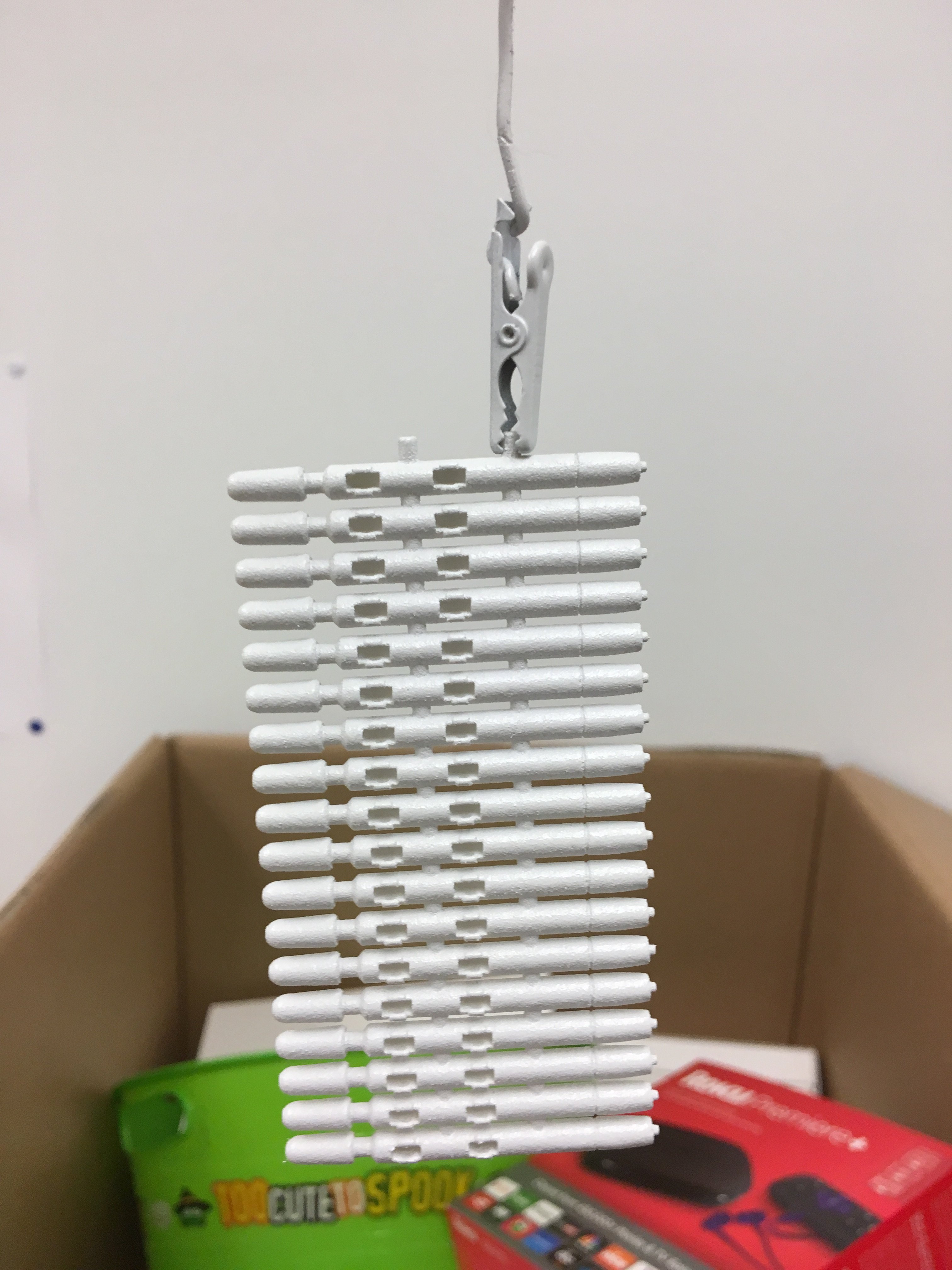

Sildani Posted September 8, 2017 Posted September 8, 2017 Thanks for all the help Xigfrid! I'll just order the 101 missiles myself in WSF polished, the clear tips, and the pylons for them, and the flat pylons - I have a Japanese weapons set I'll try out. By the way, what do you use to hold all these missiles in place while the Future dries?

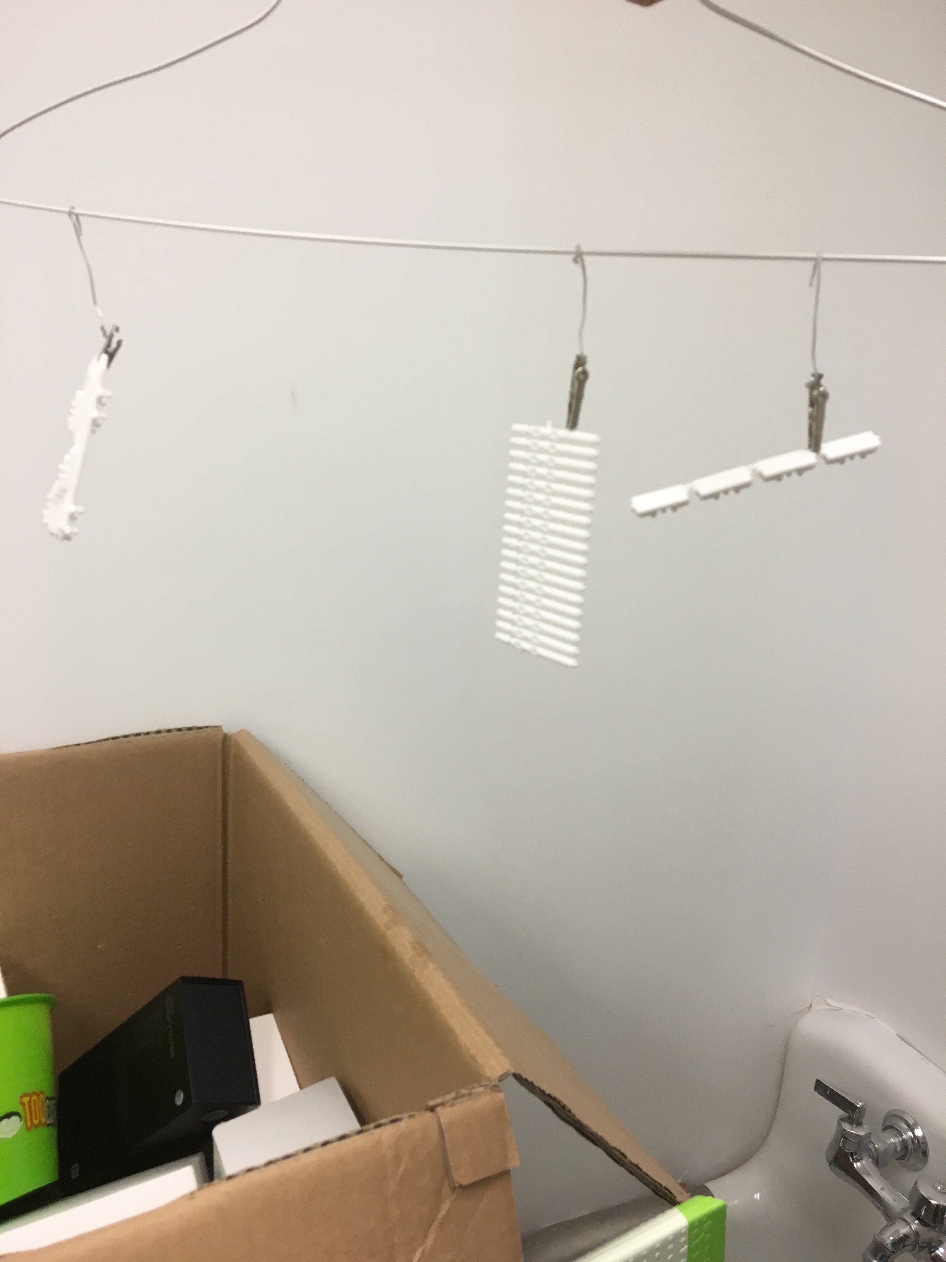

Xigfrid Posted September 8, 2017 Posted September 8, 2017 You are welcome and share with us your results This is what I usually do: attach a copper wire on one sprue, dip the whole model into future, hang the model using the copper wire as a hook to let it dry somewhere that is warm and dry, over a recipient / carton to collect the dripping future.

Sildani Posted September 19, 2017 Posted September 19, 2017 The first dip in Future. Hopefully this works!
Xigfrid Posted September 20, 2017 Posted September 20, 2017 Nice! Just be careful to remove the excess of future inside the mounting holes of the missiles body. With a small bit of paper or cotton bud

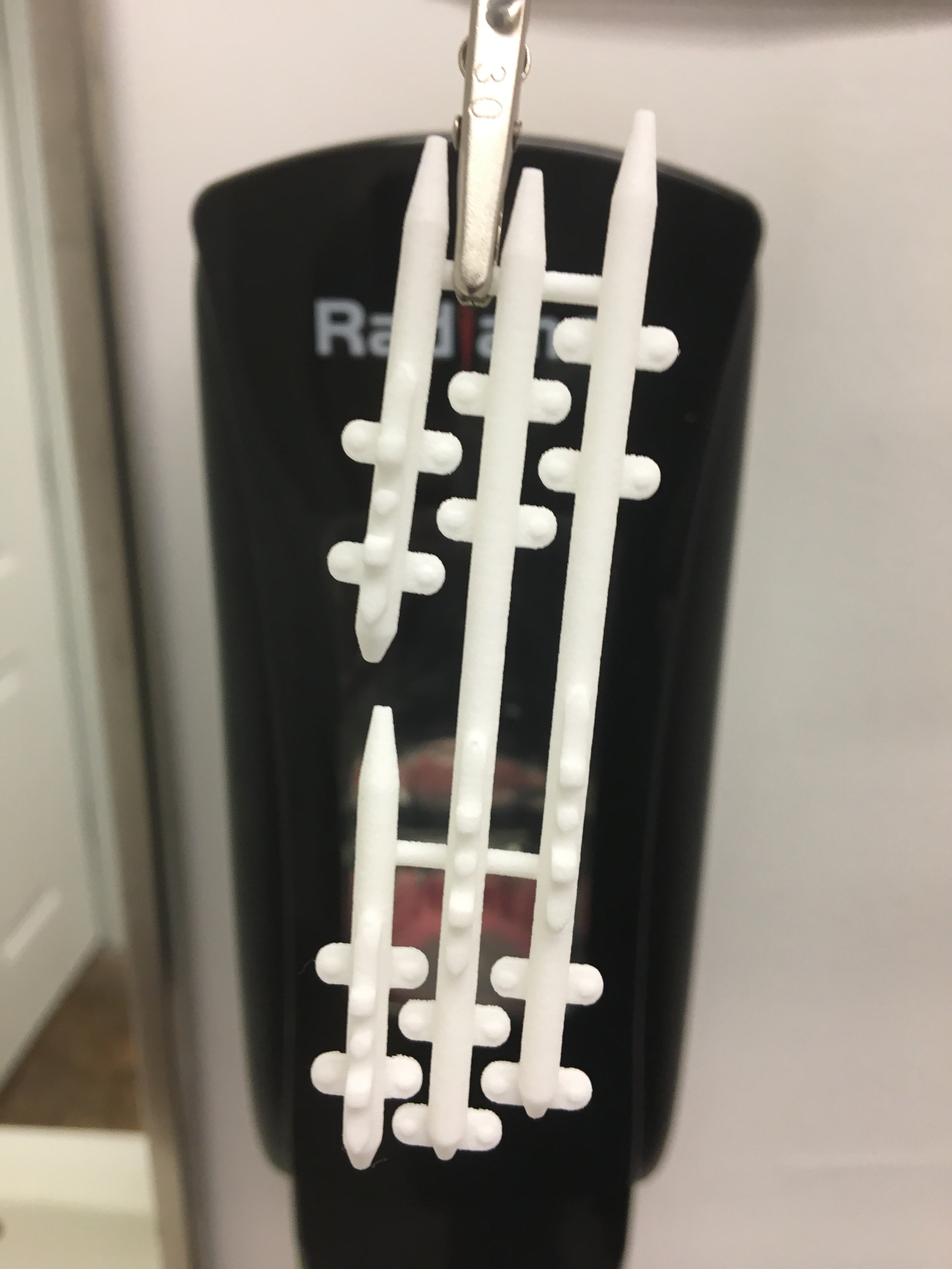

Sildani Posted September 20, 2017 Posted September 20, 2017 Well, everything still looks grainy. The missiles have an acrylic drop on the bottom which is still soft to the touch. The missile pylons also warped slightly. Thoughts?
Mommar Posted September 20, 2017 Posted September 20, 2017 (edited) Why did you dunk them in Future? I still need to order my arsenal. Edited September 20, 2017 by Mommar
Xigfrid Posted September 20, 2017 Posted September 20, 2017 3 hours ago, Sildani said: Well, everything still looks grainy. The missiles have an acrylic drop on the bottom which is still soft to the touch. The missile pylons also warped slightly. Thoughts? You should clean the drop once dry, spray with grey primer then sand the primer. Normally you should be good with a smooth surface. About the warping, that's really weird: WSF is really strong material and heat resistant up to 90° or so: even under high temperature it should not warp. Can you take closer pictures of the warping? Was it arrived like this or did they warp during the drying period ?

Xigfrid Posted September 21, 2017 Posted September 21, 2017 That's a slight warpping, you should fix it with a gentle massage by bending slightly the opposite way
Sildani Posted September 21, 2017 Posted September 21, 2017 Ok good enough. I will massage then paint and report back. Thanks for the help Xigfrid!
Xigfrid Posted September 23, 2017 Posted September 23, 2017 Looking already nice! Considering the small size of these parts, the grainy paint would be almost invisible
