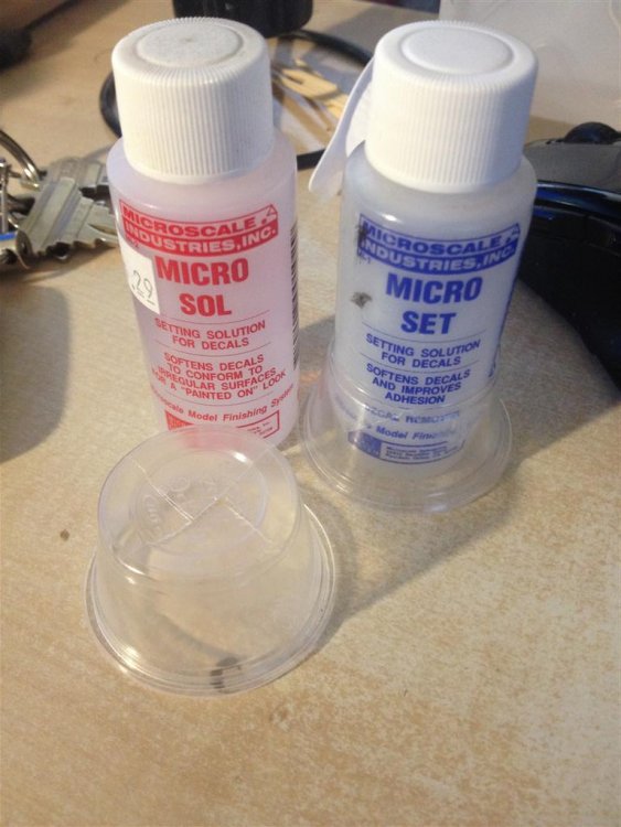

Noyhauser Posted May 19, 2015 Posted May 19, 2015 No more spills! IMG_5242 (Medium).JPG HAH! that's awesome. I've gone through so many SOL bottles due to tippage, its not funny. I've actually supplemented the Micro line with Mr Mark Settler and Softener. For a lot of decals (particularly hasegawa) it is much better at getting decals down and getting a real painted-on look.
EXO Posted May 19, 2015 Posted May 19, 2015 I gotta try those out. Anything to make decalling easier.
derex3592 Posted May 20, 2015 Posted May 20, 2015 That's a great idea EXO! I hate those damn bottles!
Galaxy_Stranger Posted May 21, 2015 Posted May 21, 2015 I would be EXTREMELY interested in the results of Mr. Setter and Softer. I've been using Microsol and Microset for 25 years. I don't really have any complaints with the micro products, but I'm interested in alternatives that give an even BETTER result!

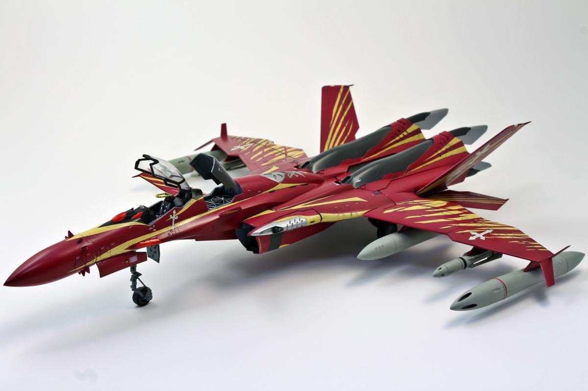

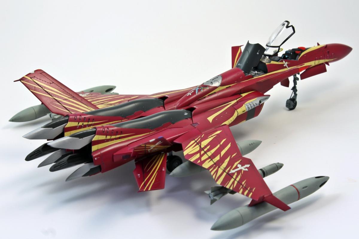

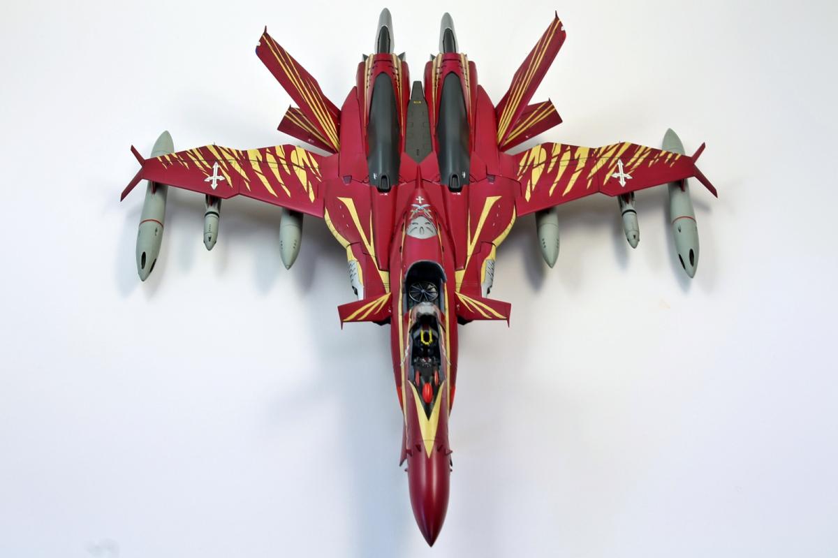

Jefuemon Posted May 22, 2015 Posted May 22, 2015 I would be EXTREMELY interested in the results of Mr. Setter and Softer. I've been using Microsol and Microset for 25 years. I don't really have any complaints with the micro products, but I'm interested in alternatives that give an even BETTER result! I love them. Guess the best testimony I could give for Mr's Softer and Setter is my Nora SV-51 kit. Had no troubles at all with the decalling on that kit.
Galaxy_Stranger Posted May 31, 2015 Posted May 31, 2015 Speaking of which - it looks like you added a black wash to that?
Jefuemon Posted June 1, 2015 Posted June 1, 2015 Speaking of which - it looks like you added a black wash to that? Yes. Promodelers Black.
