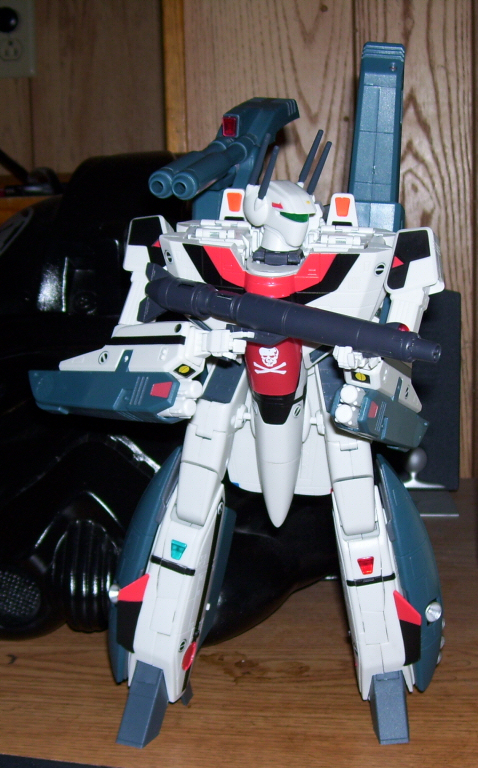

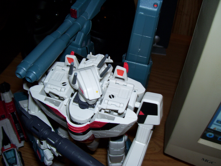

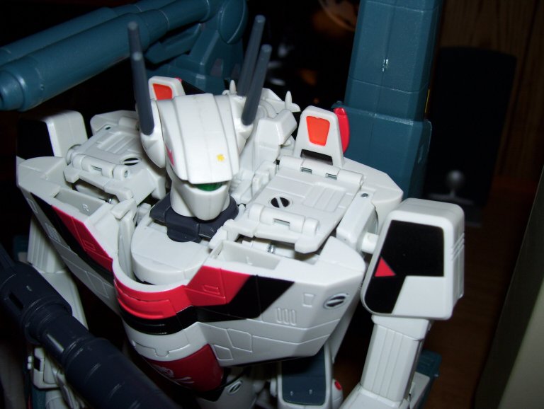

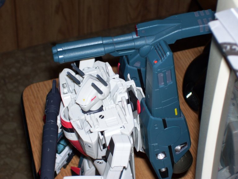

D15C0RD Posted July 27, 2008 Author Posted July 27, 2008 It's funny. I was fiddling with my VF-1S Hikaru and once I got the the chair/backpack support set right it became very secure. I tipped it backwards and the fast packs stayed in place. I didn't even have to glue anything. This is what it should look like when you have the neck piece/back pack support set right.
