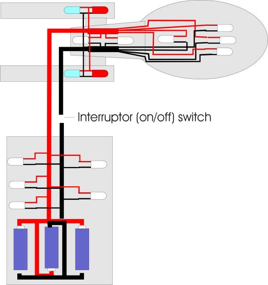

captain america Posted August 28, 2004 Author Posted August 28, 2004 (edited) Aight... Read the article on LEDs for dummies. Flawed article, because I'm more confused now than before I read it... Us simple-minded folk prefer diagrams; makes learning easier, so I included one of the wiring on my model. The only thing that's wrong in the diagram is the position of the on/off switch; it should clearly be between ALL the LEDs and the battery contacts. Hopefully, this will provide a clearer indication of what I've done, and if it can be converted to a wall-outlet. Edited August 28, 2004 by captain america

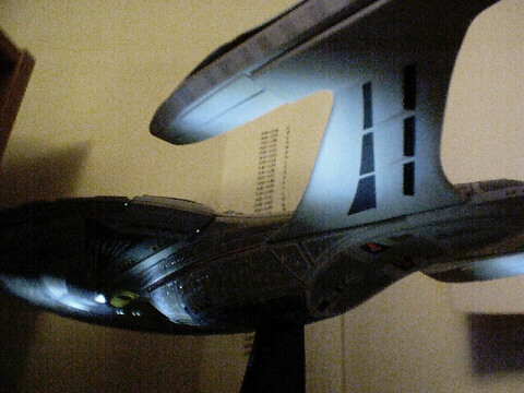

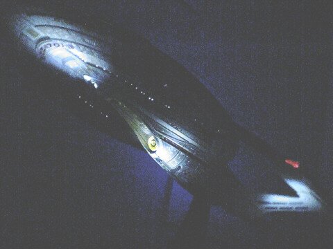

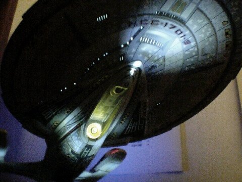

captain america Posted August 28, 2004 Author Posted August 28, 2004 ..And a few more awful pics of the finished model, which I can proudly say I assembled with NO painting whatsoever. I swear, these Bandai shake-n-bake models are like scaled-up versions of those little Kinder Egg toys... Makes me think it might not be such a bad idea to market them encased in a chocolate egg

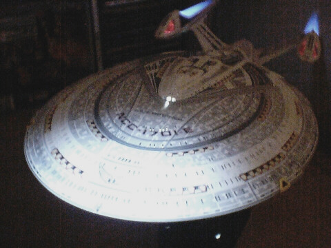

captain america Posted August 28, 2004 Author Posted August 28, 2004 Top of the saucer. The light projection onto the hull is courtesy of an LED which I held dangling over the model as I snapped the pic. Though there's a light shining from out of the base of the bridge decks, it barely projects onto the hull at all; the LED being too large to aim downward from inside the crowded confines of the kit's interior.

Stamen0083 Posted August 28, 2004 Posted August 28, 2004 Am I screwed? Not necessarily. Let me do some thinking. Is that diagram you have entirely accurate? It looks to me that if things were wired the way it's presented there, if you turn the switch to off, the LED's in the base that light the modelwould stay on. Check out my previous recommendations, and see what you think. I'll make another post (or, if no one's posted between now and then, I'll edit this post) if I figure out something useful.

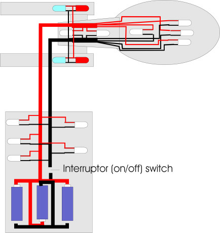

captain america Posted August 28, 2004 Author Posted August 28, 2004 (edited) Hi Stamen. Yes, you're right, my diagram above was flawed. This one is accurate to the actual model, with the power switch clearly between all the LEDs and the power source. I'll re-read the above comments again... Hopefully to understand them this time. I really appreciate all the help offered thus far Edited August 28, 2004 by captain america

Stamen0083 Posted August 28, 2004 Posted August 28, 2004 Resistors shouldn't be necissary with an adapter, that's the whole point of using one. Right. Use an adapter that puts out 800mA to pump juice through a device that cannot handle more than 10mA. You still need a resistor to limit the current through an LED so that it doesn't burn out.
Opus Posted August 28, 2004 Posted August 28, 2004 Resistors shouldn't be necissary with an adapter, that's the whole point of using one. Right. Use an adapter that puts out 800mA to pump juice through a device that cannot handle more than 10mA. You still need a resistor to limit the current through an LED so that it doesn't burn out. From his diagram it looks like the whole thing is wired in paralell. According to the page I linked his 15 10mA LEDs would need a 150mA adapter. A 6v 300mA adapter would do the job just fine.
Stamen0083 Posted August 28, 2004 Posted August 28, 2004 From his diagram it looks like the whole thing is wired in paralell. According to the page I linked his 15 10mA LEDs would need a 150mA adapter. A 6v 300mA adapter would do the job just fine. I know that. But wouldn't that mean a 150mA current source at most should be used?
Opus Posted August 28, 2004 Posted August 28, 2004 I think it can be a bit over. You just can't put more LEDs than the adapter is rated for. There are probably lower rated adapters out there as well. I'm no expert, I just picked an easy to find adapter. Personally I would experiment with a mock up first. Radio Shack sells a sack of 20 LEDs for about $3. Having things blow up in your face is half of the fun of figuing out something new.
