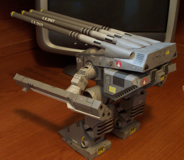

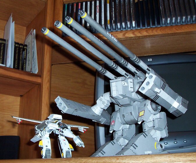

Pat S Posted February 29, 2004 Posted February 29, 2004 I sent my cousin a link to the files, and he created a MONSTER!

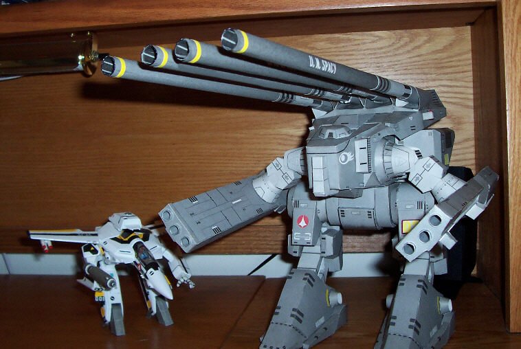

Pat S Posted February 29, 2004 Posted February 29, 2004 Last two. Pivot note: Note the position of the legs in relation to the body in 'MAC-3'. This is with my custom Pivot installed. This is the maximum degree of pivot. 35 degrees either way is the maximum swivel allowed without removing parts from the build. There are 2 small boxes (parts P-2) (see Manual 3) attached to the rear underside which hit on the top of the legs during pivot. By omitting these boxes from a build you could actually get full 360 degrees swivel. I didn't want to omit anything so I settled for 35 degrees, which is still, fairly dramatic looking. Also, in order to get any pivot at all, you must shorten part 'D-1' (see Manual 3) 1/4", and move it forward 1/4". Weight problem: Installing a Pivot also weakens the center of the model because the two halves are not glued together. The MAC is obviously front heavy with 12" worth of cannon protruding forward of it's center of gravity. All this weight tilted the upper body forward and opened a small gap in the mid section at my Pivot. To correct this, you may need to add weight in the rear to balance the upper body. Not much. I used 6, Sixteen Penny, nails inserted into the back of compartment Q-1(see manual 4) Add your weight before you seal the back of the compartment with part Q-4. This seemed to balance everything perfectly and corrected the original forward 'tipsiness' of the MAC. Barrels: Don't even bother trying to use the barrel prints on sheets 'S' & 'T'. I spent four hours trying to get decent looking barrels out of them and finally designed my own from scratch using 'Picture Publisher.' I mentioned my 2 part design with 'skin'. Try it this way and you'll get some great looking barrels with little or no visible seam. The main gun barrels are, by far, the hardest part of this model to "get right."

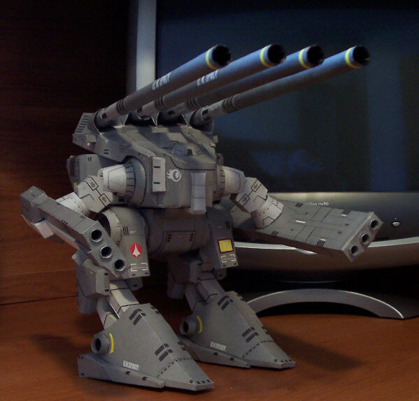

Southcross Posted March 6, 2004 Author Posted March 6, 2004 (edited) Day 5 Got quite a bit more work done on my v.2.0 I've been over working myself over the last two weeks. So I decided that I need to spend some quality time with my little friend. Problem is, I have a really bad cold that's just plain old whipping my ass. But I'm going to do as much work as I can. Summary: days 1-4 (legs and frame of torso completed) I completed building of the torso. Found several areas that needed "modification". what was originally a very small "gap" of unsupported material. I created "shims" (left) to fill and support this gap. I also figured out that v.2.0's center of gravity was behind the centerline of the legs, so I created a cardboard "insert" (right) to weigh down the front of the torso. (see image below) I also started to assemble one of the barrels, completed the first barrel insert, and installed it... it looks kewl! get more information and see more images at: Southcross Model Monstrosities: Monster V.2.0 Day 5 Edited March 7, 2004 by Southcross
Grayson72 Posted March 6, 2004 Posted March 6, 2004 great progress, I like the insert idea but I think it's too thick.
Southcross Posted March 7, 2004 Author Posted March 7, 2004 great progress, I like the insert idea but I think it's too thick. do you mean my cardboard "weight" for the nose? Its only about an 1" tall, whereas the nose of the Monster is about 2 1/4". I also made it small enought to be inserted into the nose after the torso has been completed, but before the legs are attached. I figure it should add about 6-8oz to help rebalance the bad boy.
Southcross Posted March 7, 2004 Author Posted March 7, 2004 No I meant the insert for the barrels. well I think part of the problem is that the barrel should actually be tapered, but for the purpose of making a paper barrel.. I think the designer made it straight for simplicity. What I did for my barrel insert design was I took the overall Paper Monster dimensions, took the overall length of the real Mark II figured out the scale to be between 1:50 to 1:60 for ver 3.0 (or between 1:72 and 1:60 for ver 2.0). I created the inital design based upon a 1:50 scale (better to be wrong on the high side in my opinion). 16" at 1:50 is .32", then I rescaled my ver 3.0 insert back to the ver 2.0 size. and wha-la that is the insert I put in. and it does "appear" very close to correct. According to the dimensions of a US Battleship's 16" gun barrel: the bore is 16", but the outer diameter of the barel is between 32" and 36" (about double the bore size). I'll see what the overall "look" looks like once I have my ver 2.0 completed and see if I need to "tweak" it for my ver 3.0.
