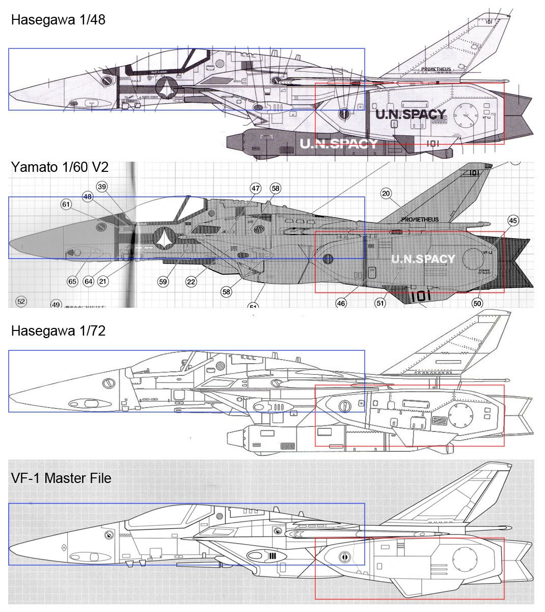

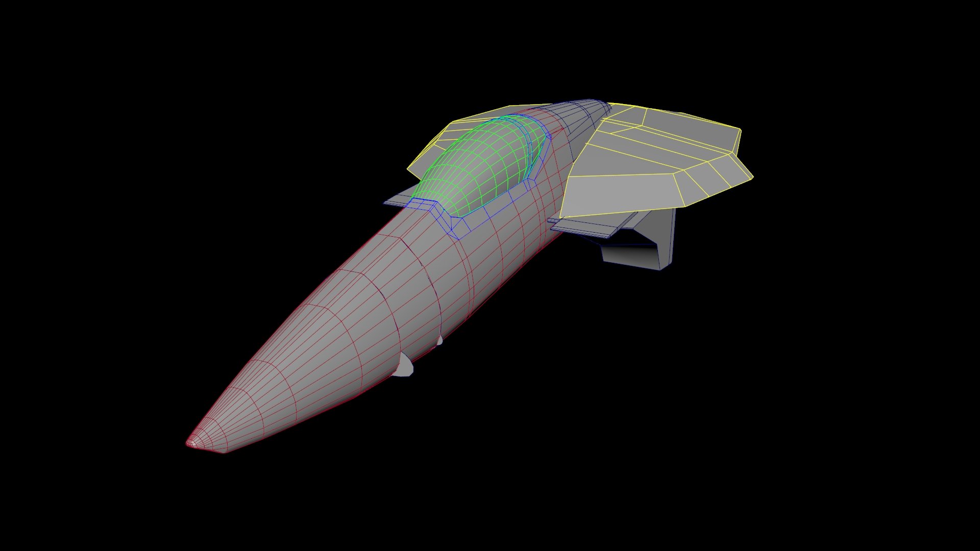

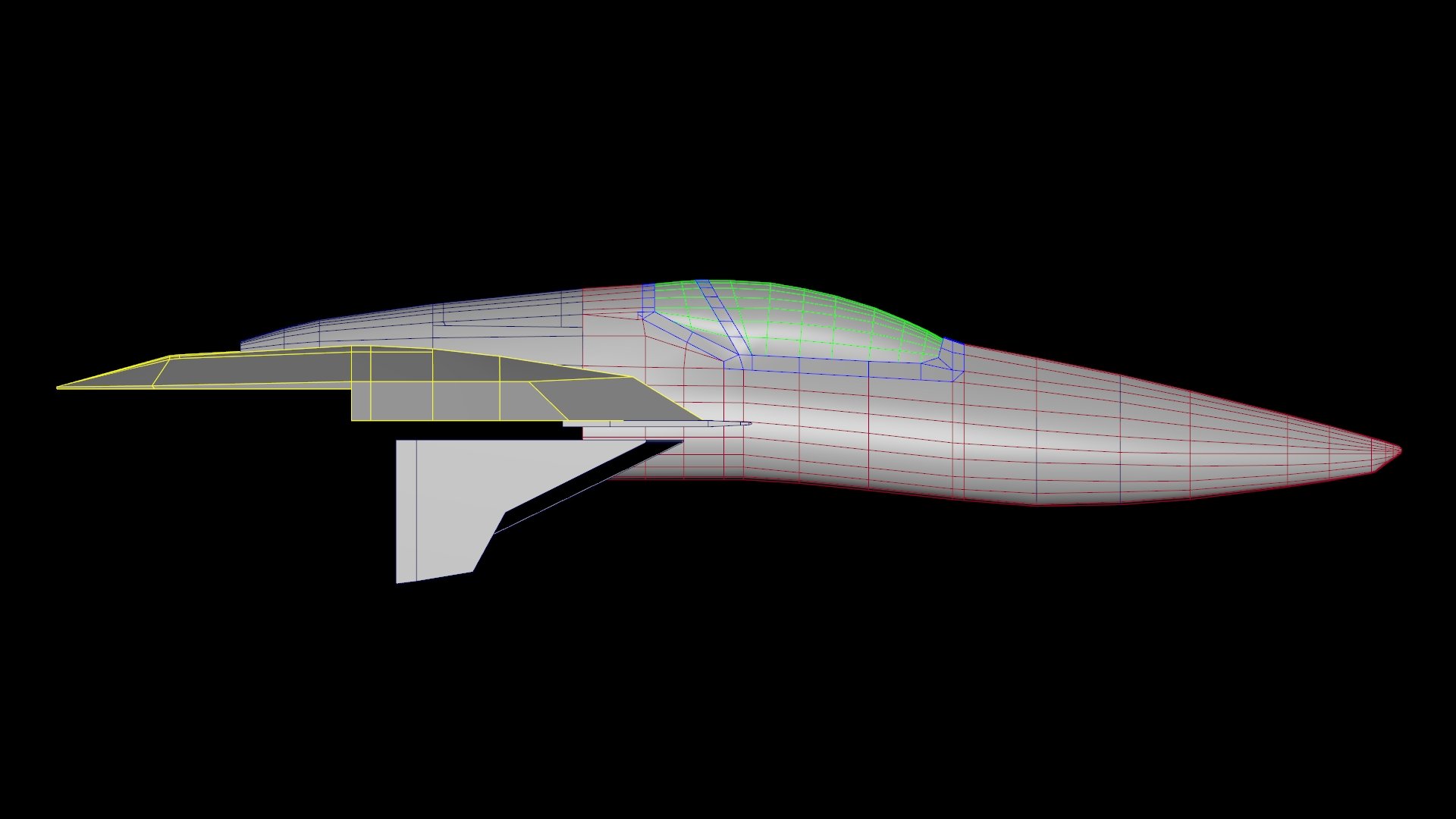

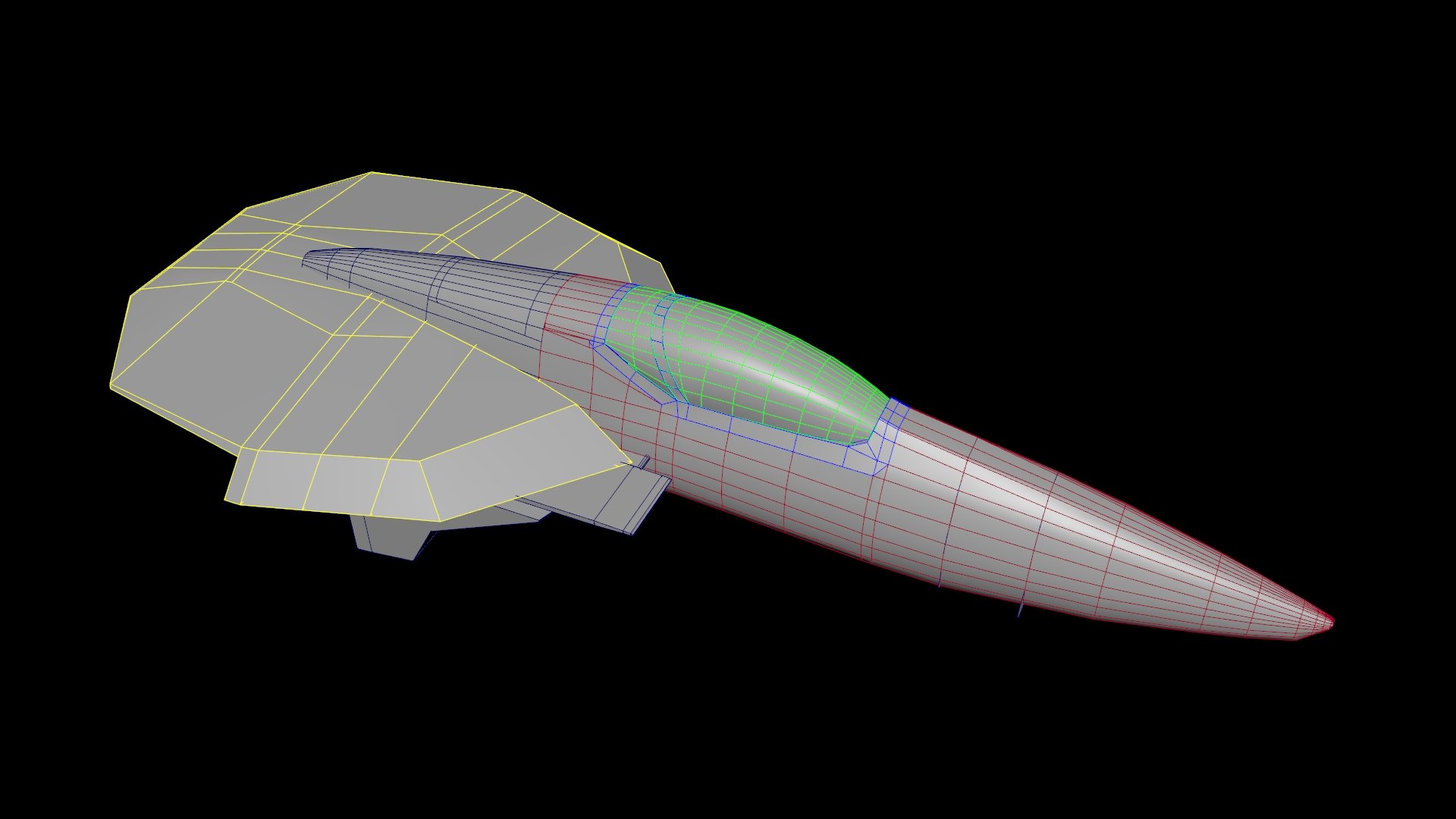

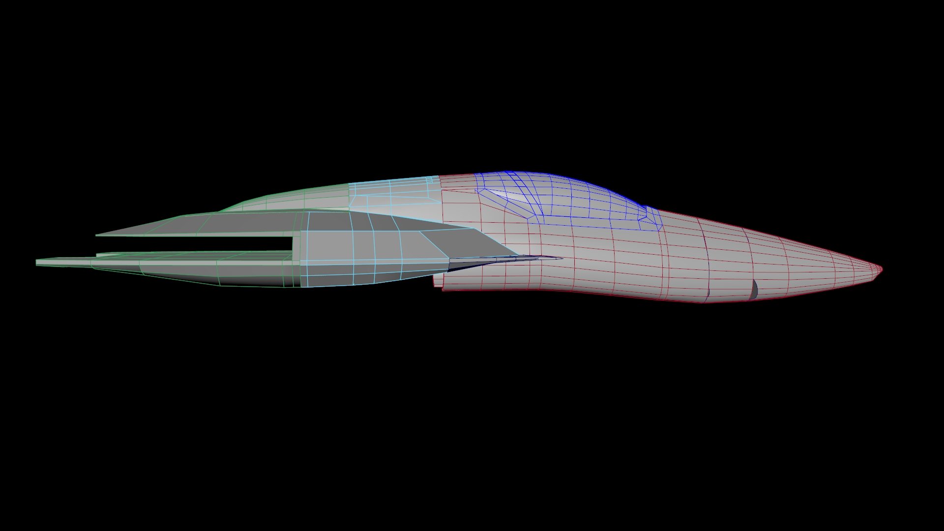

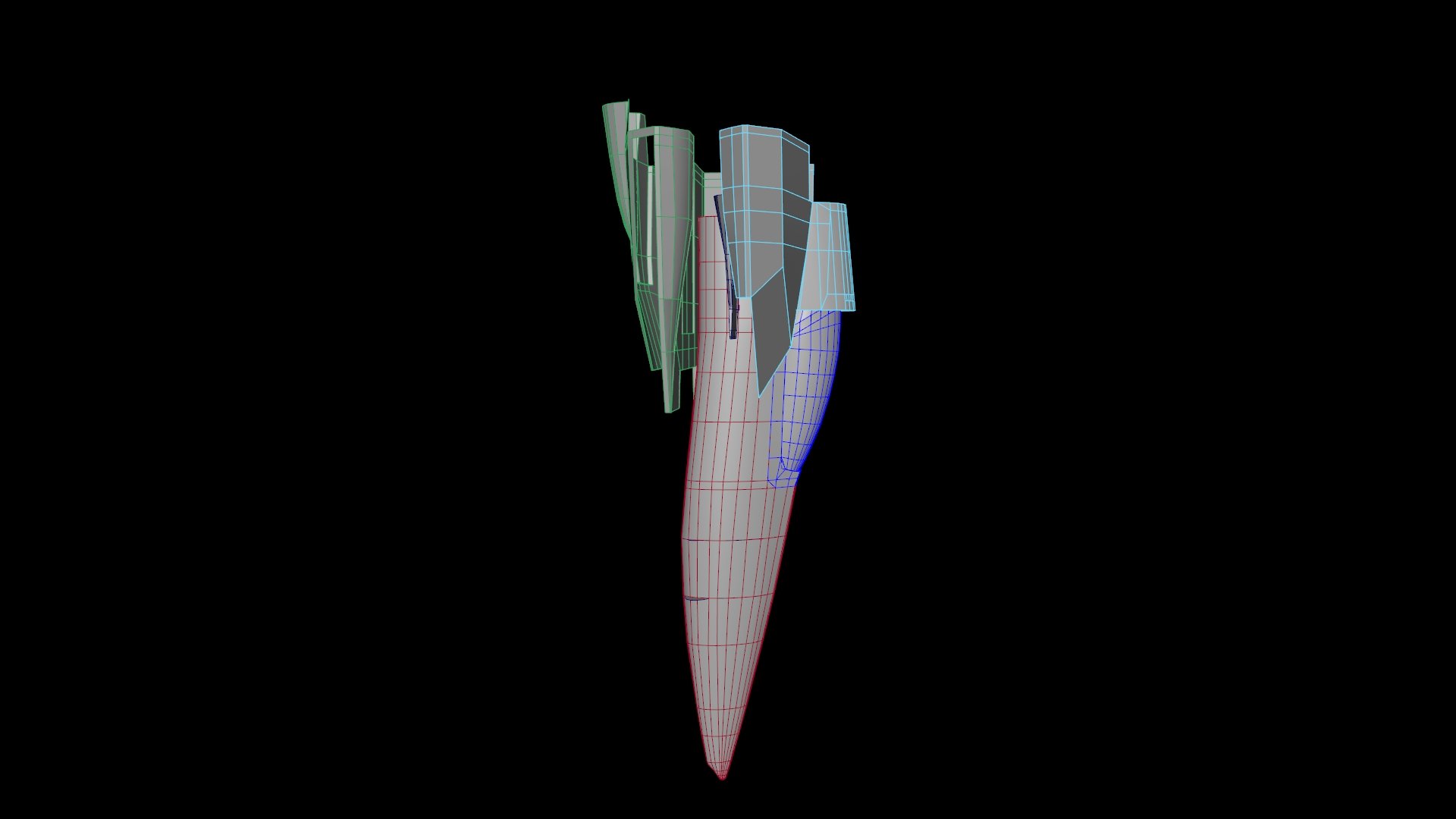

TadCooper Posted May 25, 2019 Author Posted May 25, 2019 (edited) Small update. I ran into the first engineering snag of the project. I was modeling off of the Hasegawa 1/48 design, where I found that the underside of the body was too thick. The 1/48 model has the intakes dropped a bit lower and the curved fuselage further down to match. The problem with it is when in Battloid mode, the two halfs cut into each-other with no room for the shoulder joints to lock in. So I ended up going with the 1/72 design, at least in that area. I'm still going to try for the lower intakes, but will have to see how that pans out. Also had to bump up the thickness of the hull. Originally I was looking at a 3 cm at 1/1 scale, but at 1/50 that transfers to .6 mm. It's doable with 3D printing, but I'd prefer a bit more stability, so I decided to bump up to 5 cm. That give's me a solid 1 mm thickness at printing. So a good amount of space for engraved panel details and inlets. Edited May 25, 2019 by TadCooper
