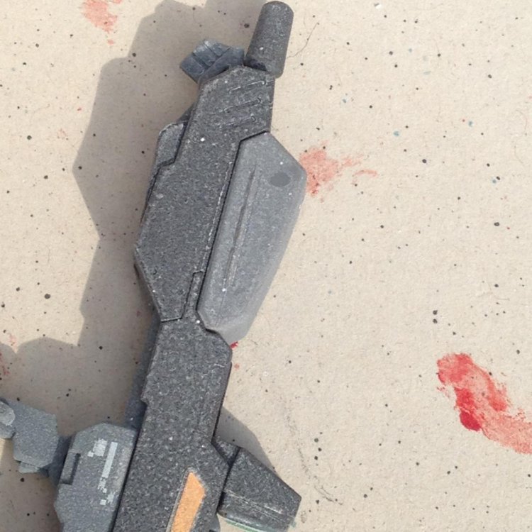

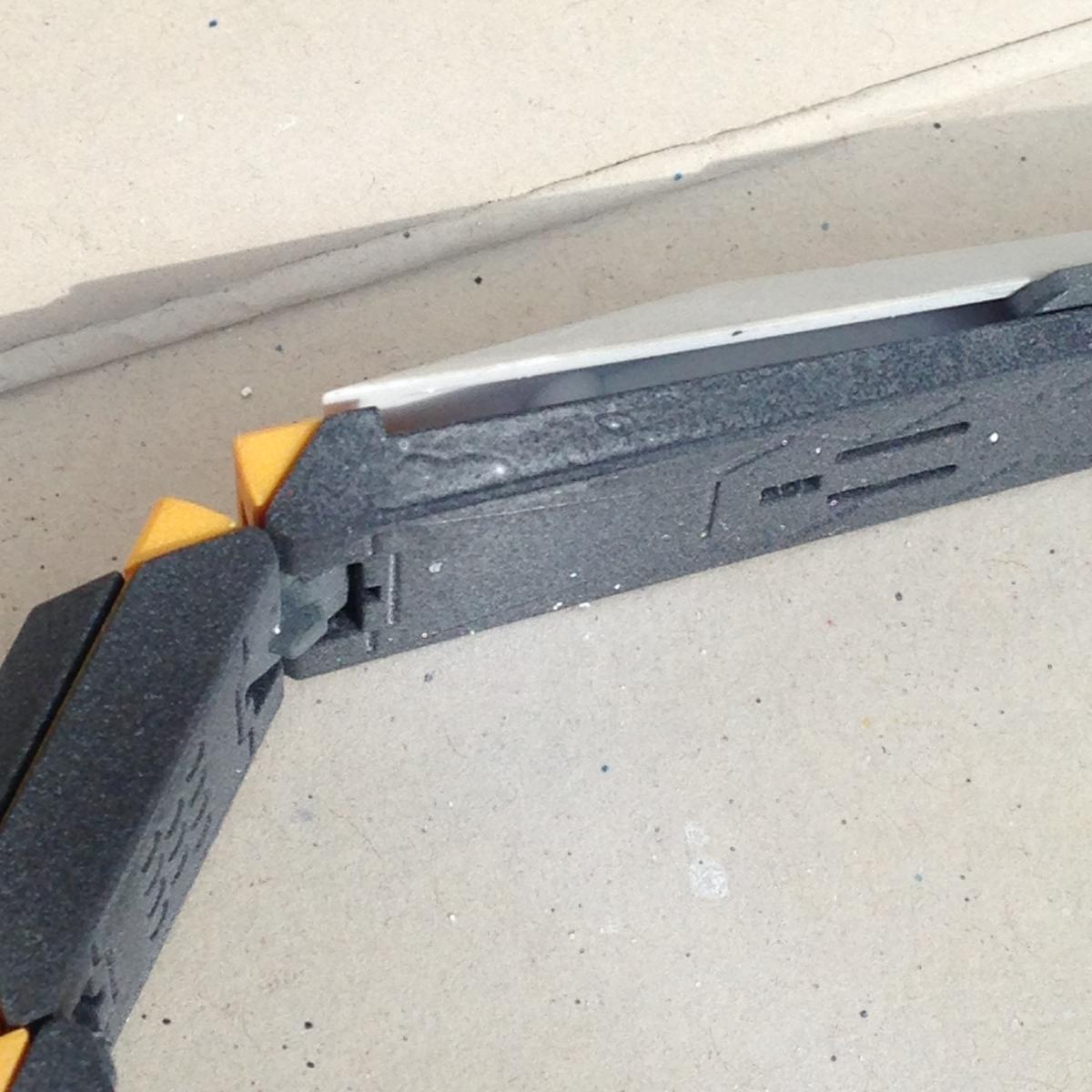

ce25254 Posted September 4, 2015 Posted September 4, 2015 I don't mean to divert this thread but have a topcoat issue, specifically with Future. I added Tamiya Flat Base X-21 to the Future in my airbrush cup, mixed with a toothpick, and got this result today. Is this just a matter of too much flat base? What should I do to remove these spots? Some parts have been painted, some have not been painted.
chyll2 Posted September 5, 2015 Posted September 5, 2015 it is a matter of too much flat base. Alcohol or anything that strips acrylic can remove, though if your painted parts are acrylics, those will be removed as well.
