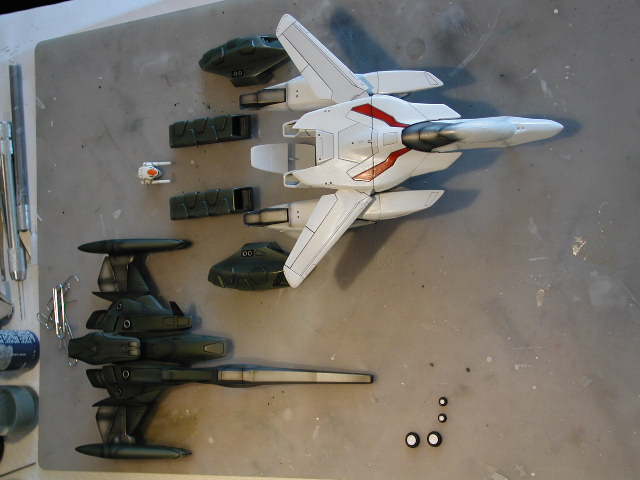

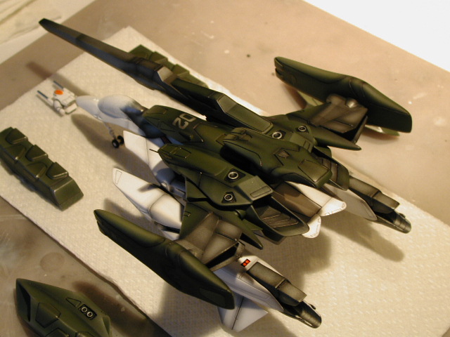

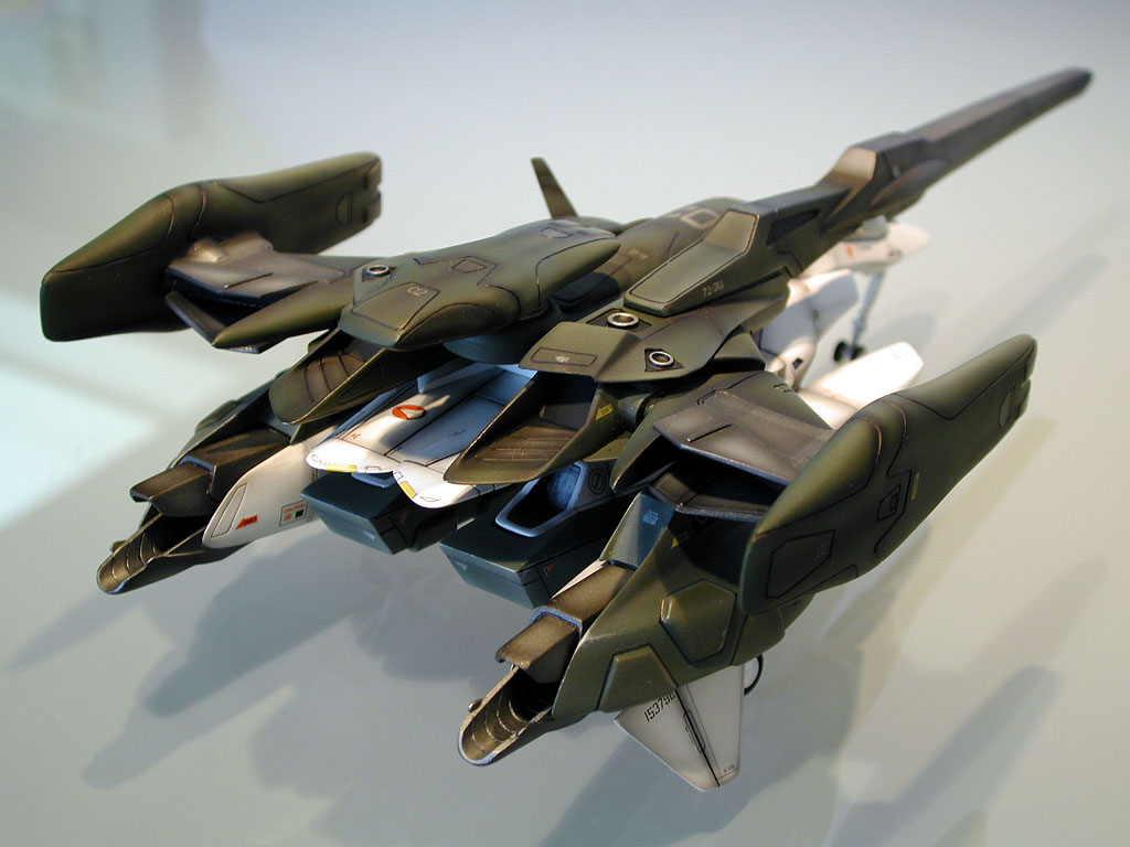

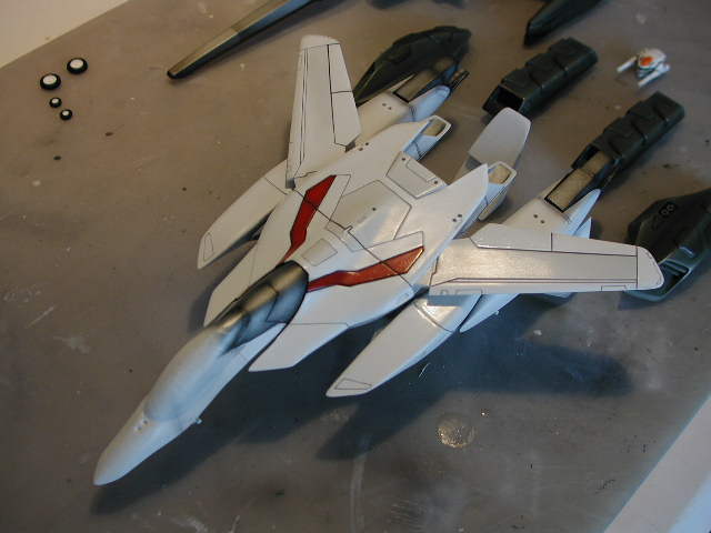

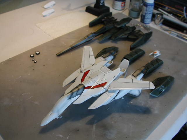

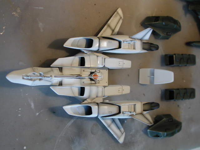

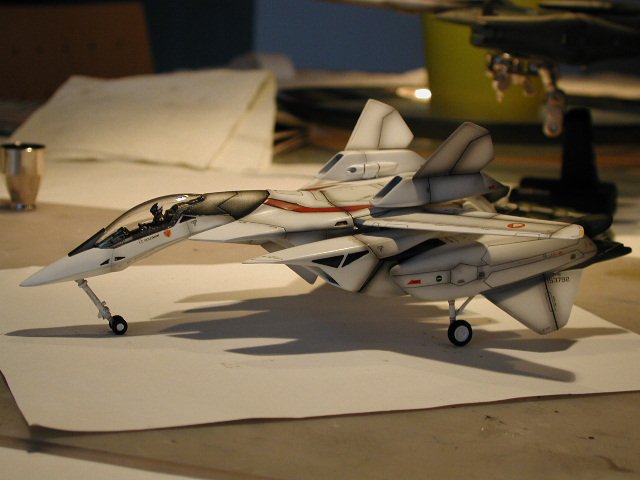

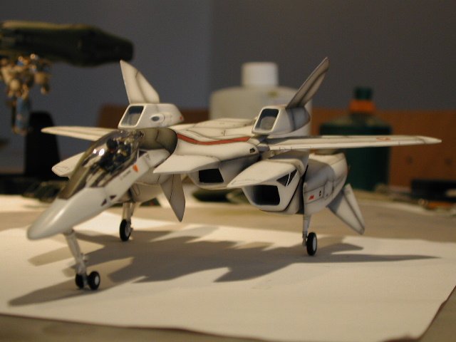

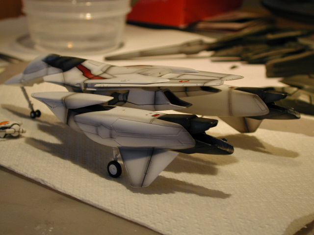

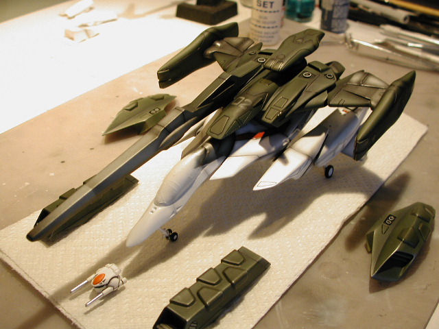

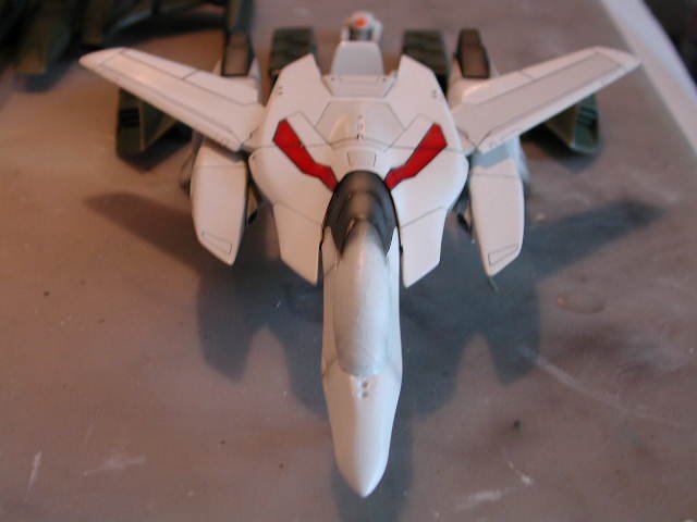

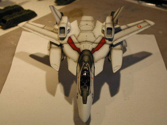

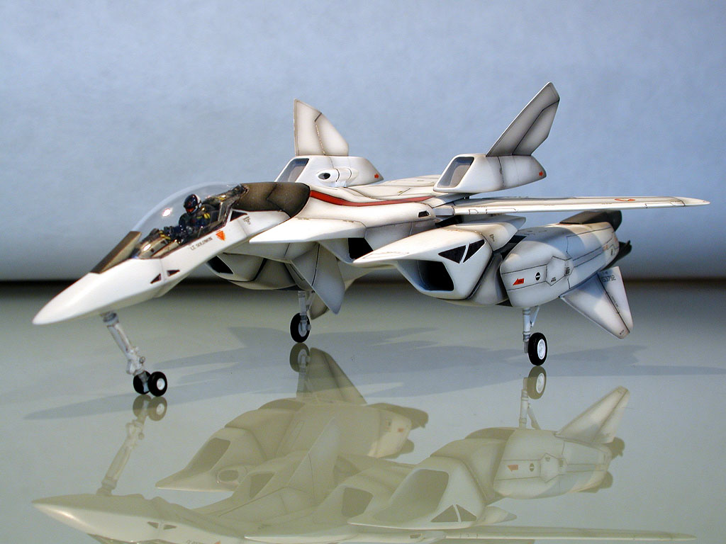

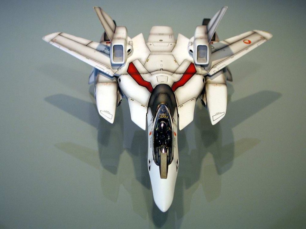

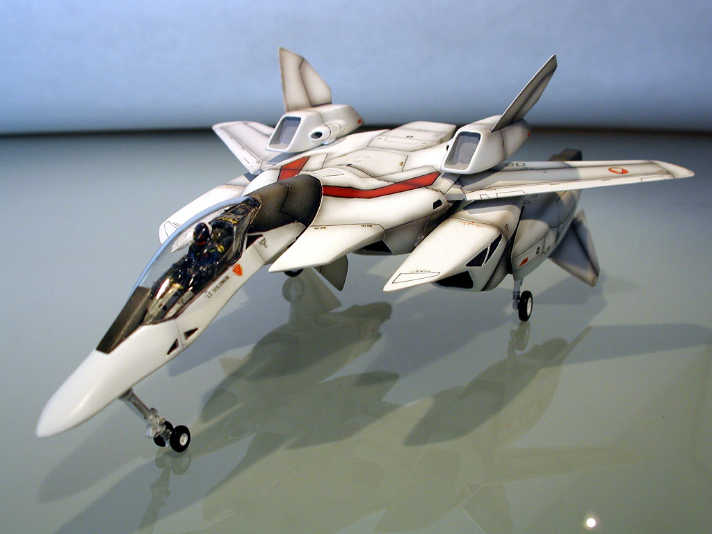

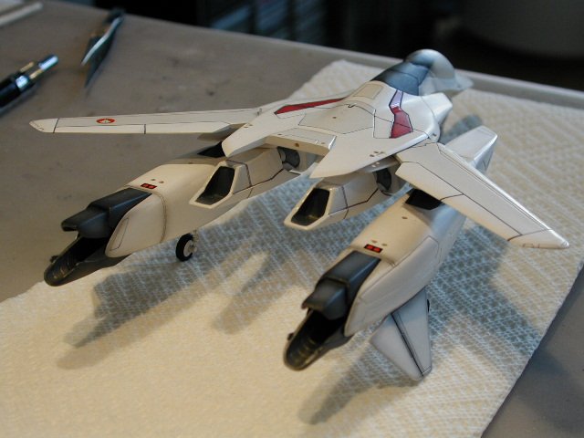

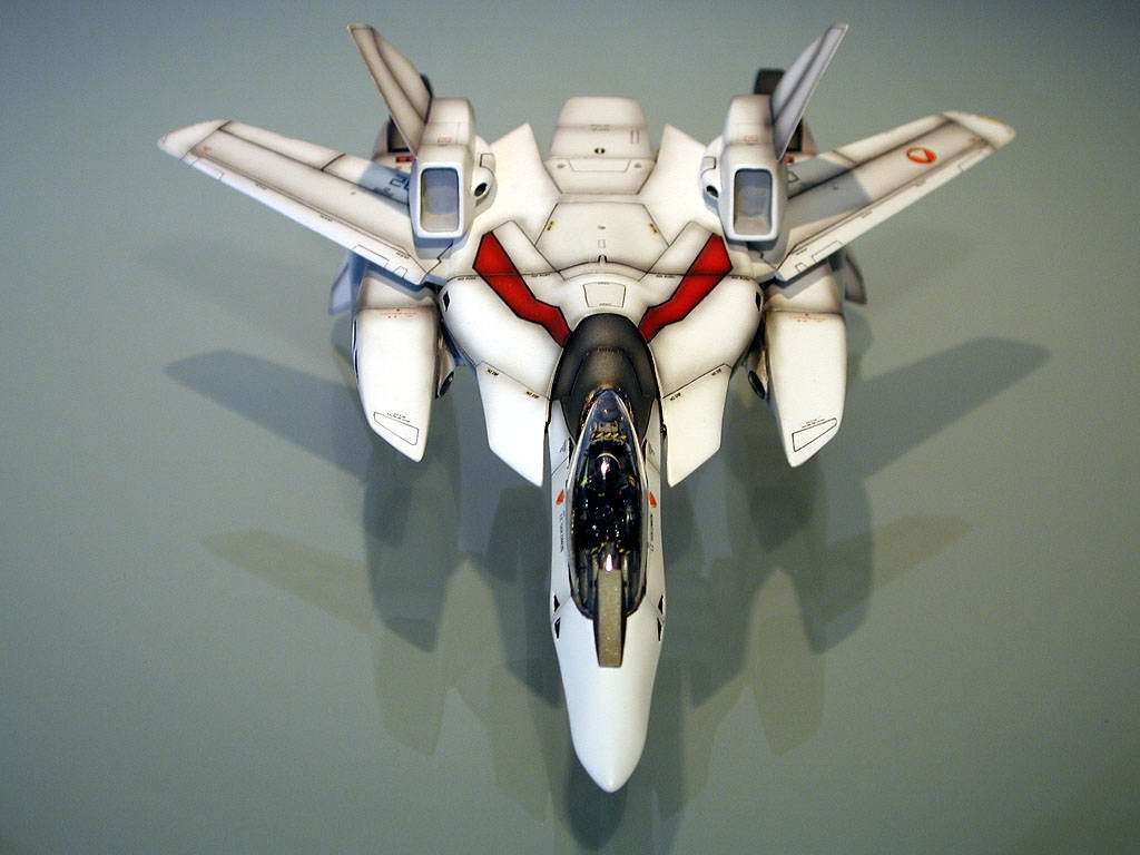

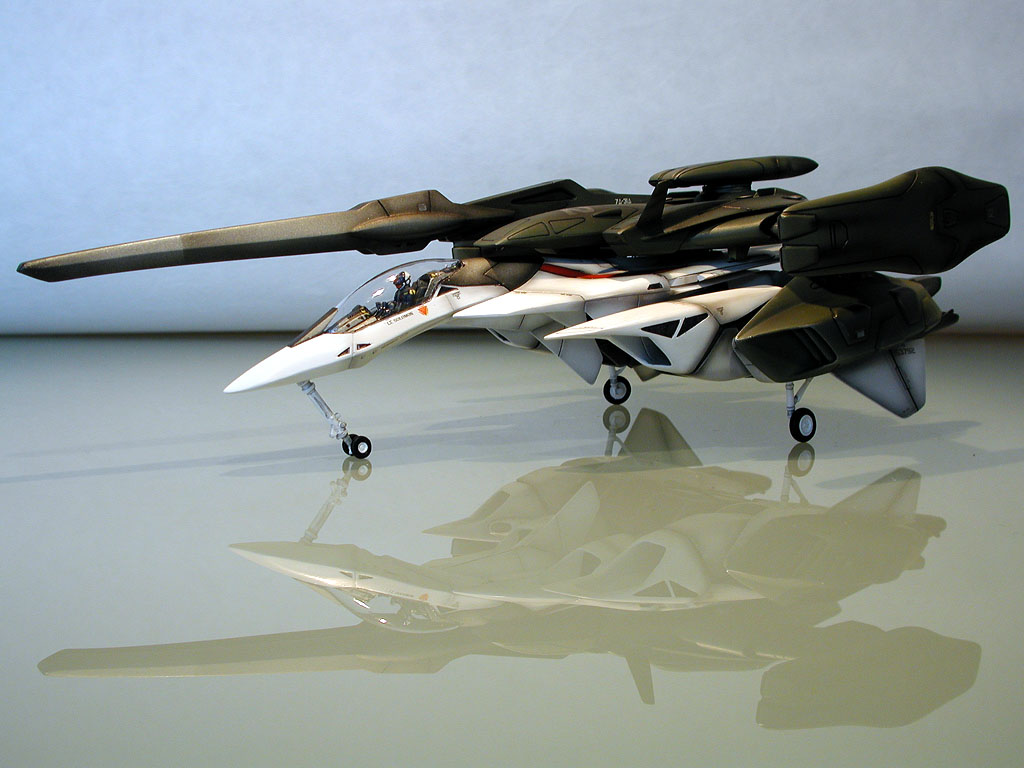

wm cheng Posted September 18, 2006 Posted September 18, 2006 What an awesome wife!! Yep, mine was from Hobbyfan way back when and I got a useless foggy translucent canopy which I had vacformed. The kit is excellent though, very crisp line and great shape. It takes a little work to get the fast packs removeable - but its definitely worth the effort (I just used paperclip pins) Here are some shots of mine built 5 or 6 years ago - please excuse the way too heavy panel lining and post shading - but this is the model that got me back into Macross building!!
HWR MKII Posted September 18, 2006 Author Posted September 18, 2006 (edited) Thanks WM i was searching for the pics of yours but couldnt find them. Mind if i copy them for use as a reference? I think the heavy panel lines and shading actually work for this subject. Do you have any in progress shots or shots of the pin setup to make the backpacks removeable? Edited September 18, 2006 by HWR MKII

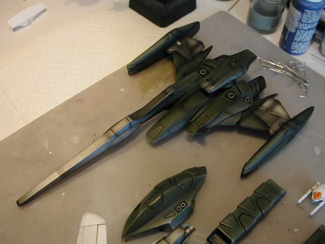

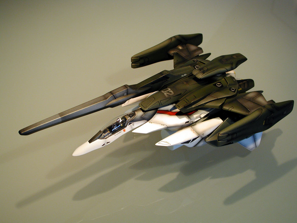

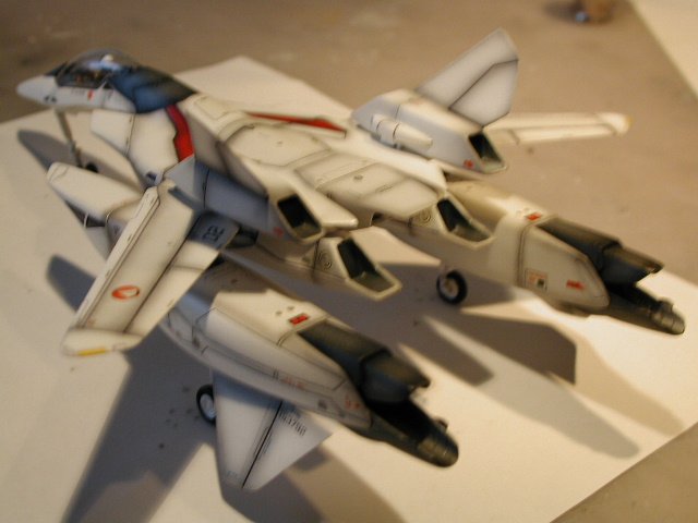

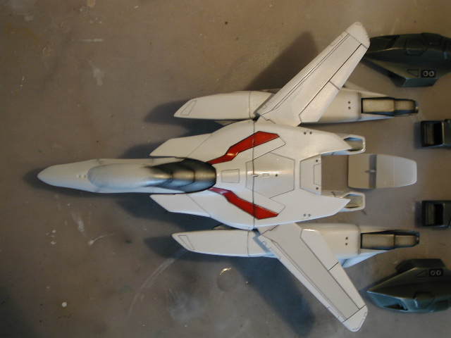

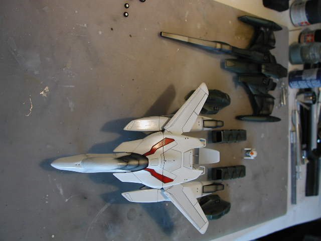

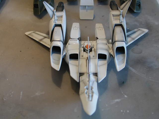

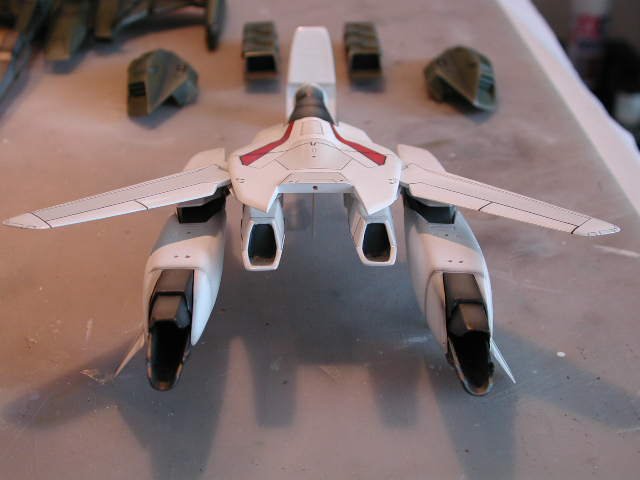

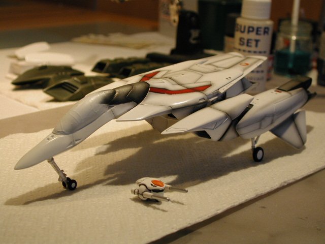

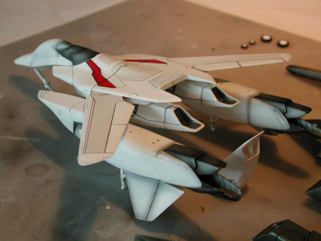

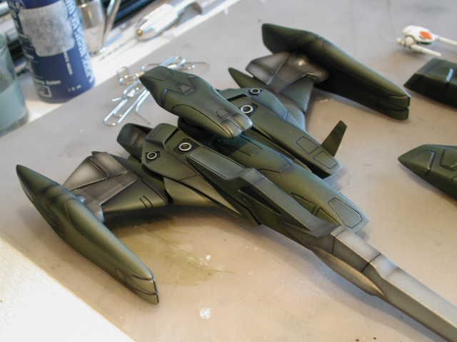

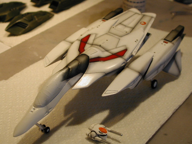

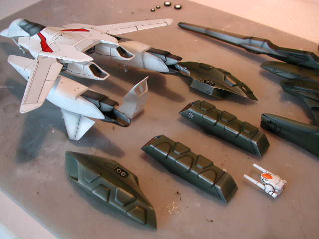

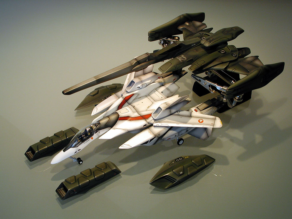

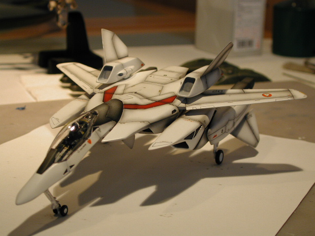

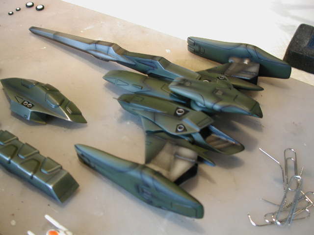

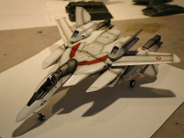

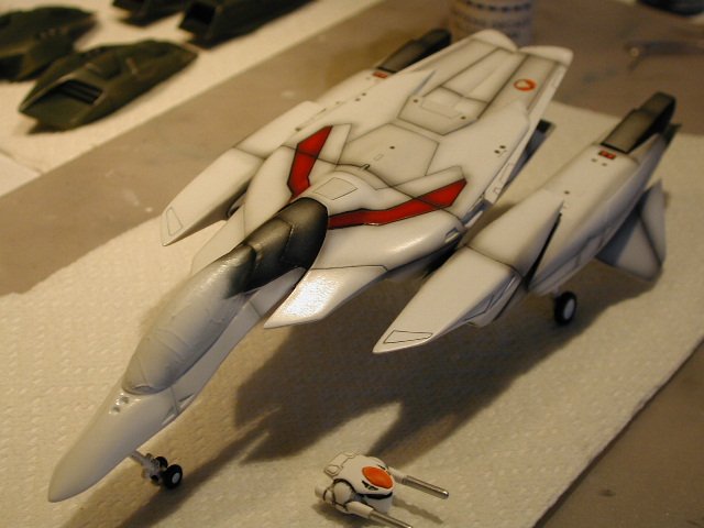

wm cheng Posted September 18, 2006 Posted September 18, 2006 Unfortunately I no longer have the write-up (it was lost with the old boards) but I do have a few of the in-progress pictures... Unfortunately none of the beginning stages of the build. Pretty boring though, just a lot of sanding, priming, epoxing pins (paperclips) to re-inforce some of the smaller contact points. I basically used a pin vise to drill a small hole for the paperclip pins, then applied some market to the ends and touched them to the other half to be joined - then the mark created I drilled out for the pin to seat into. I epoxy one end to the part and leave the other end a hole.

HWR MKII Posted September 19, 2006 Author Posted September 19, 2006 (edited) Unfortunately I no longer have the write-up (it was lost with the old boards) but I do have a few of the in-progress pictures... Unfortunately none of the beginning stages of the build. Pretty boring though, just a lot of sanding, priming, epoxing pins (paperclips) to re-inforce some of the smaller contact points. I basically used a pin vise to drill a small hole for the paperclip pins, then applied some market to the ends and touched them to the other half to be joined - then the mark created I drilled out for the pin to seat into. I epoxy one end to the part and leave the other end a hole. Where on the model did ypu place the pin holes? They look like regular details in the pics so its impossible to tell. Also does pin friction alone hold on the arm armor on? Edited September 19, 2006 by HWR MKII
Mechleader Posted September 19, 2006 Posted September 19, 2006 Hey can anyone make me a vac formed canopy. I'll pay. Thanks.
wm cheng Posted September 19, 2006 Posted September 19, 2006 Yep, pin friction alone holds them in - but always have two (or more) pins to hold something in, its the "inaccuracies" in trying to get both pins to line up exactly that creates the friction for the piece to stay on (if you can get my poor discription of the process). The farther the pins are apart, the better the hold. Yes, I try to locate the pin holes so that they appear as detail instead of being too distracting. When you get your kit, you can compare and locate where my pin holes are. I had my friend vac-form the canopy for me (he used to own a plastics shop) but no longer has that ability. Try some local hobby shops or contact your local chapter of IMPS - they will know who can do this for ya. Good luck.
