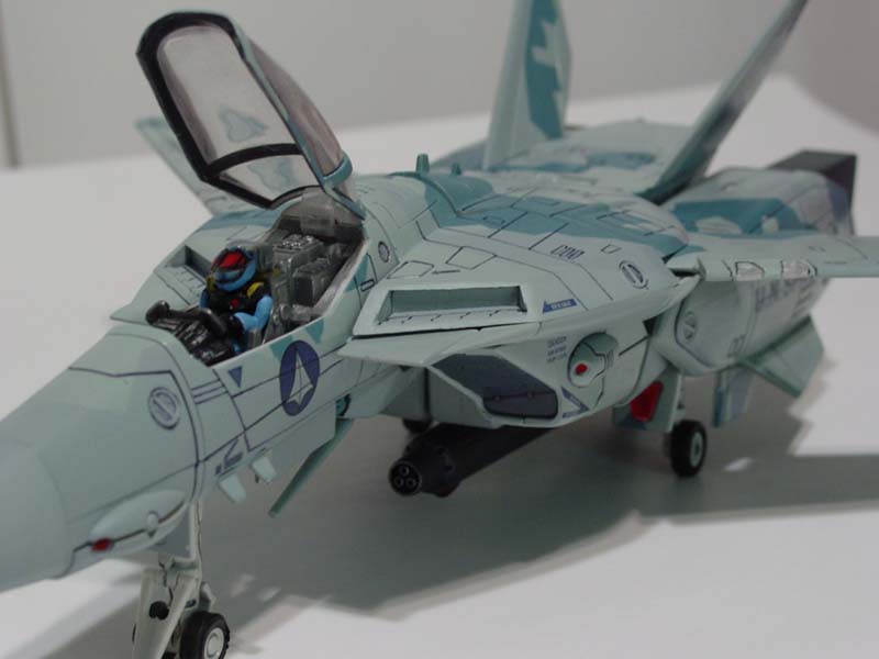

Wicked Ace Posted November 24, 2005 Posted November 24, 2005 (edited) I'm definitely going to be playing with mine so that is a consideration (if I wasn't I might just apply Anasazi's decals directly, put a wash on and be done with it.)Â I'd love to hear from some people who've clear coated theirs on what kind of durability they got (and whether they used lacquer or an acrylic). 347070[/snapback] I've used Anasazi's waterslide decals on a 1/48 custom with great results. You can spray or brush on a coat of Future (floor "wax"), which is an acrylic. Next, place the decals, and let them dry. Then, apply another coat of Future over the decals, followed by spraying on a flat coat of your choice. If you're going to be handling the Valkyrie extensively, then be liberal with the Future. Mine's held up great after rough handling. I used Anasazi's low-vis decals for this one. Edited November 24, 2005 by Wicked Ace
Nied Posted November 24, 2005 Author Posted November 24, 2005 (edited) I've used Anasazi's waterslide decals on a 1/48 custom with great results. You can spray or brush on a coat of Future (floor "wax"), which is an acrylic. Next, place the decals, and let them dry. Then, apply another coat of Future over the decals, followed by spraying on a flat coat of your choice.If you're going to be handling the Valkyrie extensively, then be liberal with the Future. Mine's held up great after rough handling. I used Anasazi's low-vis decals for this one. 347094[/snapback] That looks awfully good there Wicked Ace Did you put down a flat coat over the whole Valkyrie after you applied the future and decals? and if so see my question up at the top of the thread. I've used future in the past, but I've only ever dipped parts into it (and I've also used it on my floor). Would you recommend thinning it to paint or spray it on? Edited November 24, 2005 by Nied

Wicked Ace Posted November 24, 2005 Posted November 24, 2005 That looks awfully good there Wicked Ace Did you put down a flat coat over the whole Valkyrie after you applied the future and decals? and if so see my question up at the top of the thread. I've used future in the past, but I've only ever dipped parts into it (and I've also used it on my floor). Would you recommend thinning it to paint or spray it on? 347113[/snapback] Yes, I applied a flat coat over the whole Valkyrie, as Future gives it a bright, shiny look (just as advertised for your floor). There's no need to thin the Future; if you'r nervous about applying Future, brush some on some spare parts, and you'll see that it's self-correcting. Oh yeah, David Hingten gave you an awesome link. Thanks David!
