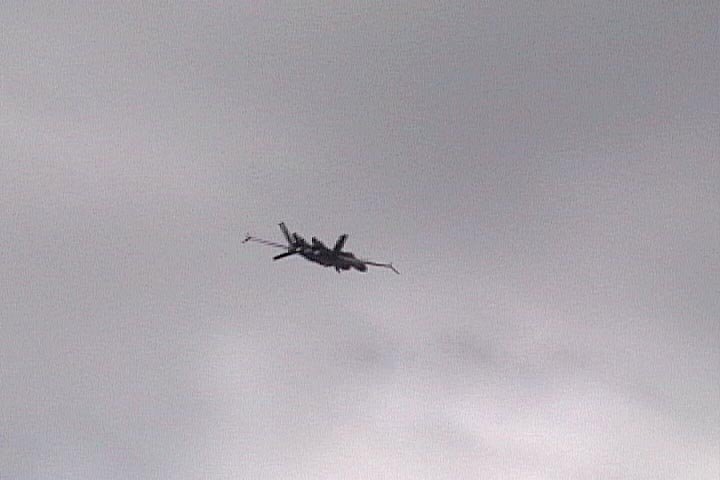

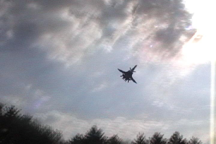

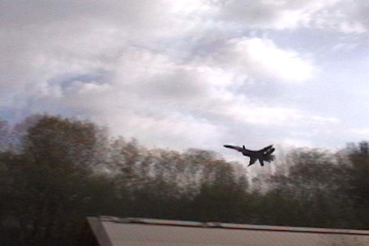

IAD Posted May 6, 2006 Posted May 6, 2006 The SV committed aviation today...(!!!) (WOOHOO!) Flew very well, somewhat underpowered, but excellent control, which proves I've nailed all the problems the last one had. Got to use the thrust-vector, to get out of a stall... Knocked one of the downward swept tipfins off on landing, but otherwise, zero damage. (Quite different from the balsa proto, eh? ) Video will be forthcoming. Sean, I'll be switching over to a more powerful set of motors and batteries, so everything's on-track, dev. wise... I'll commence work on your ship again, now that I know the aerodynamic configuration is A-OK. Just wait 'til the 'it won't fly' fellow sees this. ~Luke
IAD Posted May 6, 2006 Posted May 6, 2006 Gerwalk I can see, full Battroid? I don't know. Of course, anybody willing to get me a couple Wren turbines, and a few thousand dollars worth of stability augmentation systems, and I'll give it a go. ~Luke
IAD Posted May 6, 2006 Posted May 6, 2006 (edited) Videos! WMV (Lowish res, 8.6 MB) Right-click and Save As DiVX (Highish res, 22 MB) Right-click and Save As The high-res file may require you download the DiVX codec. http://www.divx.com/divx/play/download/ ~Luke Edited May 6, 2006 by IAD
HWR MKII Posted May 6, 2006 Posted May 6, 2006 (edited) FRACK ME WITH A FORK! Luke i cannot wait to take delivery of mine. My wife saw the vid and she was impressed. That is WAY more manuverable than the first. I also noticed a few times that it turned inside its length on a few banks. This will impress. Also its actually an easy airframe to keep track of direction since it has such an unusual fuselage. The brick has been shat ill tell you that much. BTW: The triumphant music in the video really gives a feeling of accomplishment about the project. Edited May 6, 2006 by HWR MKII
IAD Posted May 6, 2006 Posted May 6, 2006 Yes, I was quite pleased. It's a easy thing to fly, though a bit more power would make it a whole lot easier. (Particularly at launch and landing.) Very well behaved overall, though. And no mistaking it for anything but an SV-51! ~Luke

IAD Posted May 6, 2006 Posted May 6, 2006 Glad you guys like it! I do believe I've got a solution for the underpowered issue: I'm looking at a battery that's 0.33 oz. lighter, yet has better output, and motors that should give an extra oz. of thrust, plus 5-10 MPH more airspeed, for the same weight. Current draw will go up, improving the power loading as well. Then maybe Sean can get a full loadout under the wings. "F-14, discover the power of 24 micro-missiles!" ~Luke

chrono Posted May 7, 2006 Posted May 7, 2006 (edited) Ye Gods! That video is great, the audio was pompus but who cares! Shes got some sweet manuverability and I totally thought you were gonna crash & burn when you scrubbed to much speed on that one turn! The ending really is telling on just how much vectoring power you have. Man if they were engines & battery's of higher power to weight ratios you could pull off a VTOL! Does it have the power to tailstand hover? Also have you done the calculations on the scale speed? Edited May 7, 2006 by chrono

IAD Posted May 7, 2006 Posted May 7, 2006 Yes, that turn spooked me. I pulled just a bit much elevator, after banking. All the same, it shows that with a bit more power, I should be able to do some really tight maneuvers. VTOL/tailstands aren't going to possible, even with the more powerful systems. I'm hoping for 7-8 oz. of thrust, at 12.5 oz., AUW. Hey, waddyatalkinabout, what's wrong with the soundtrack?! :D I was originally going to pull some audio from Mac. Zero, but I couldn't find a sufficiently fast torrent. (Couldn't find a soundtrack snip, either.) ~Luke

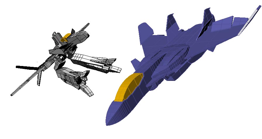

IAD Posted May 9, 2006 Posted May 9, 2006 HEHE. The SV just looked too neat in gerwalk. However, I ran some really quick thrust vector figures, and from a flying standpoint, it looks bad... The legs are always swept forwards in gerwalk mode, which means that the plane would tend to fly backwards. (Of course, if I drop the legs straight down, it doesn't have 'the look'... Pretty much counter-productive, since this is all about looks.) The VF-0D is a good candidate for the ducted fan/thrust-vector treatment. The other variants unfortunately are rather short on wing, meaning that they would probably have to be pusher-prop designs. (No thrust vector.) Of course, the other option is to scale them up. They're only short on wing if they're the same scale as the SV. Anyway, that's all in the future, sometime, if ever. ~Luke
