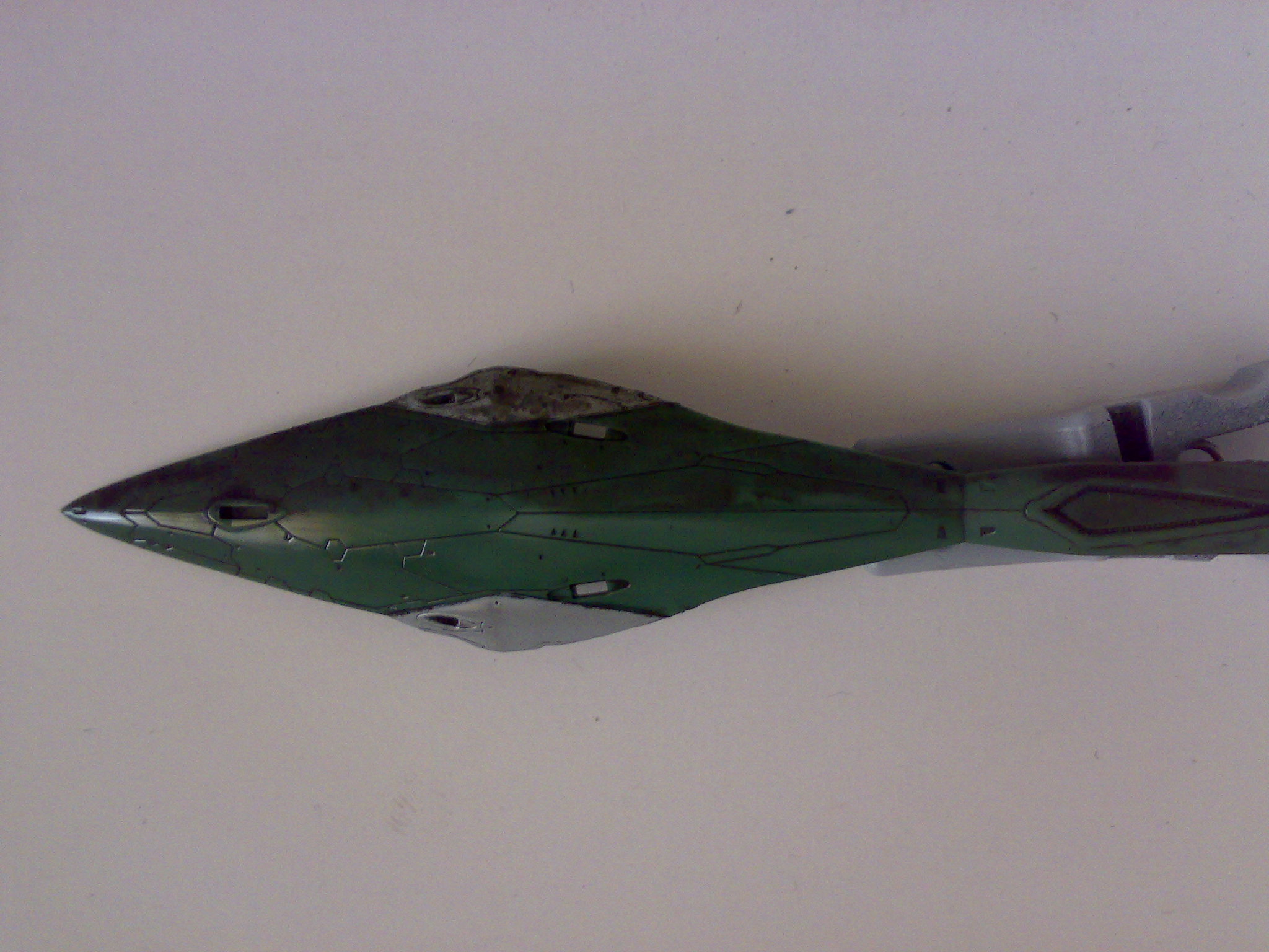

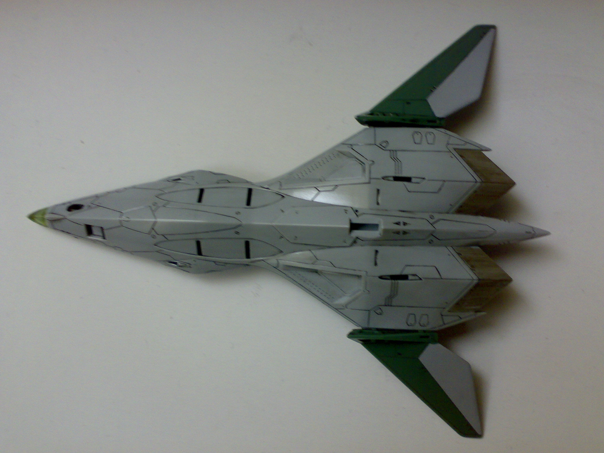

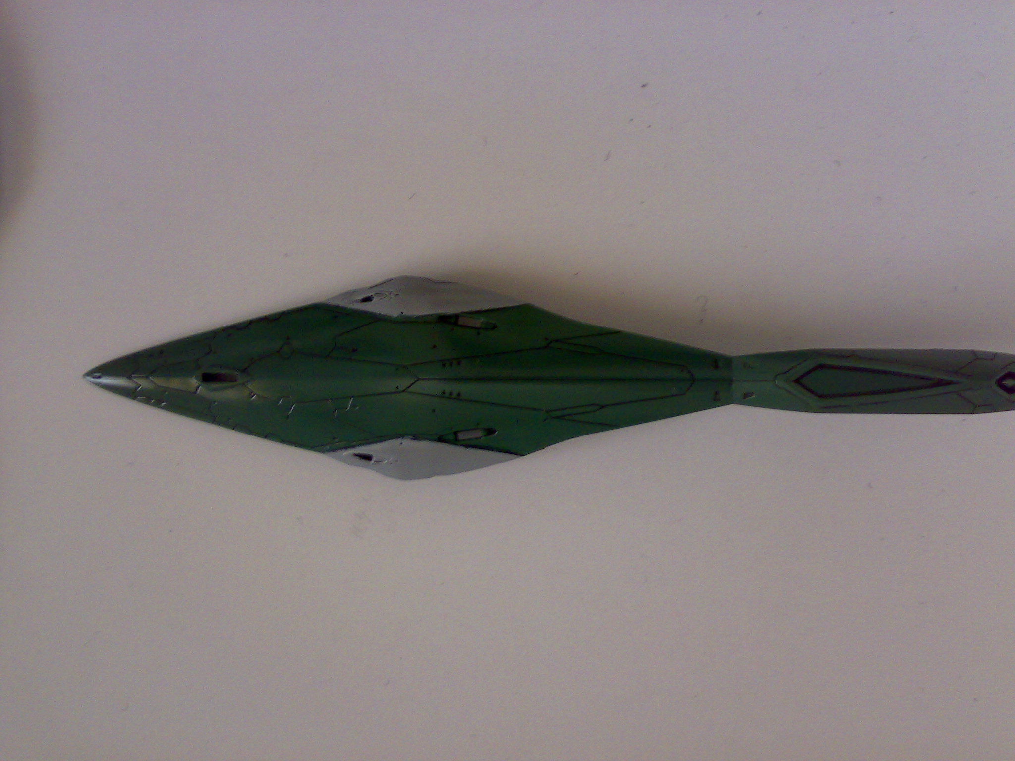

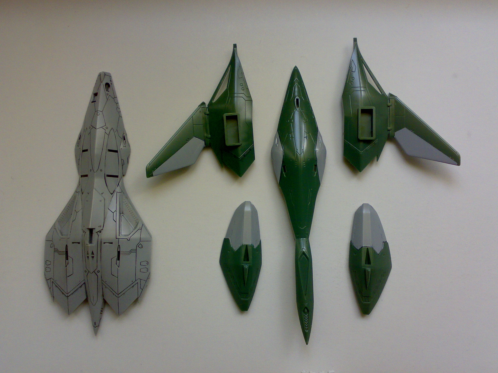

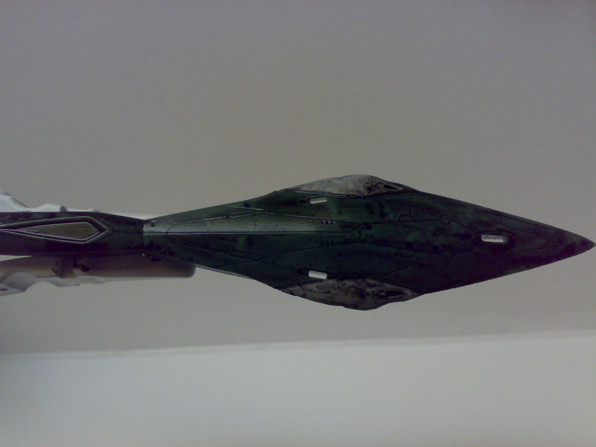

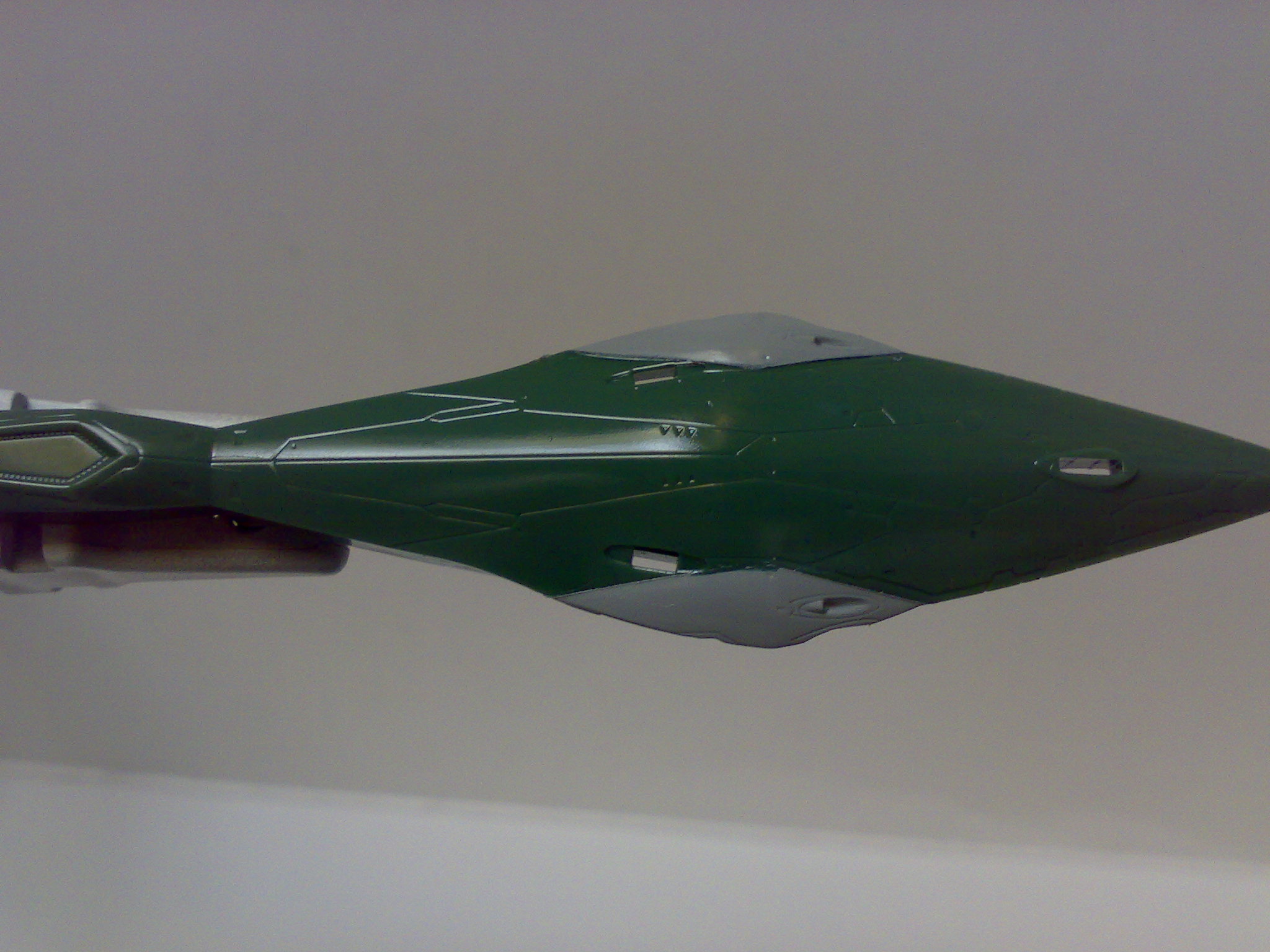

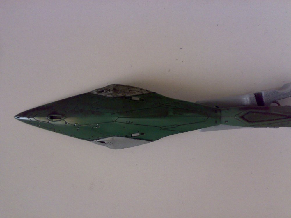

Yes. Yes, you are. And i think most people in these forums are too, me included. But it's the good kind of sick. So, it's OK. OK, progress report: Applied the afore-mentioned wash to the treated main parts. I was afraid the panel lines wouldn't be noticeable in the dark green parts but they look great. Some pics of the process in one of those parts: Future coated clean part (in bare plastic the wash works but with the Future it holds a lot better) part with the wash applied ( roughly 20 minutes to dry, according to the manufacturer) one half with the wash rubbed off and finally the completed part After that i applied some burnt iron to the exausts and after that dried another coat of Future. Snapped the main assembly together and now i'm brassing myself for the most terrifying part of the process... DECALING. One problem is the pointy ends seem to split a bit, especialy the nose (as can be seen in the last pic). I might have to apply a hint of glue to get them to look right. Any alternative ways to do it would be welcomed as well as any hints you might have on the better way to apply those nasty decals. -

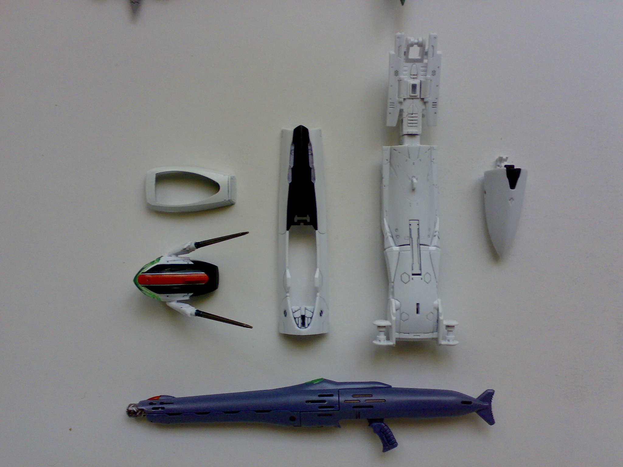

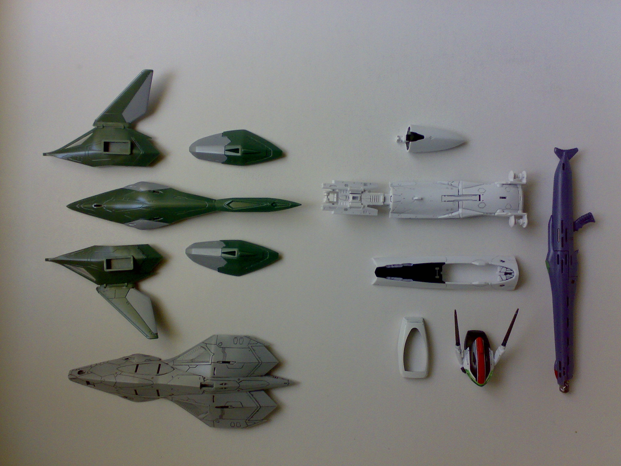

The big white one on the right wraps around the "crotch" piece (Part F-1) The 2 purple on the top left are used to "color" the clear forward sensors (Part A-9) if you choose not to tint them The green in the middle is the green sensor on the gunpod The 2 green ones on the bottom left are used to "color" the clear eyepiece (Part A-22) if you choose not to tint it -

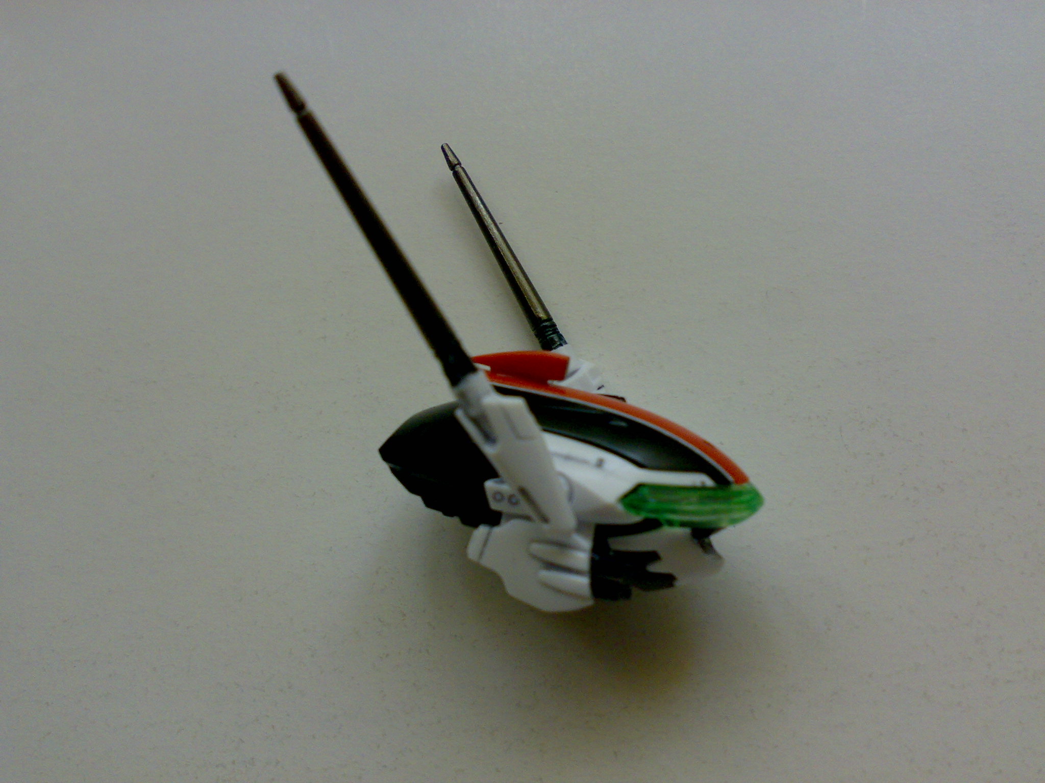

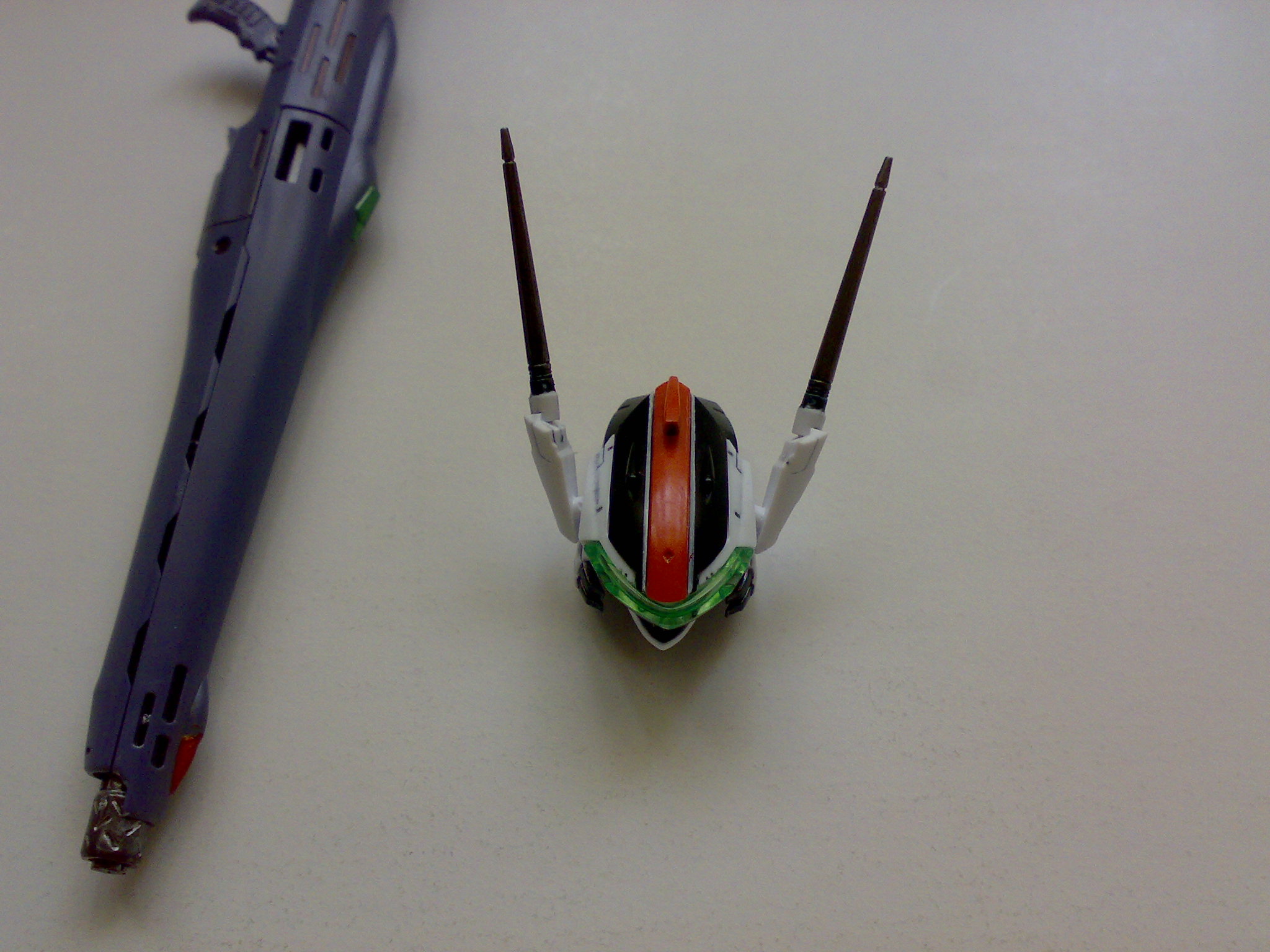

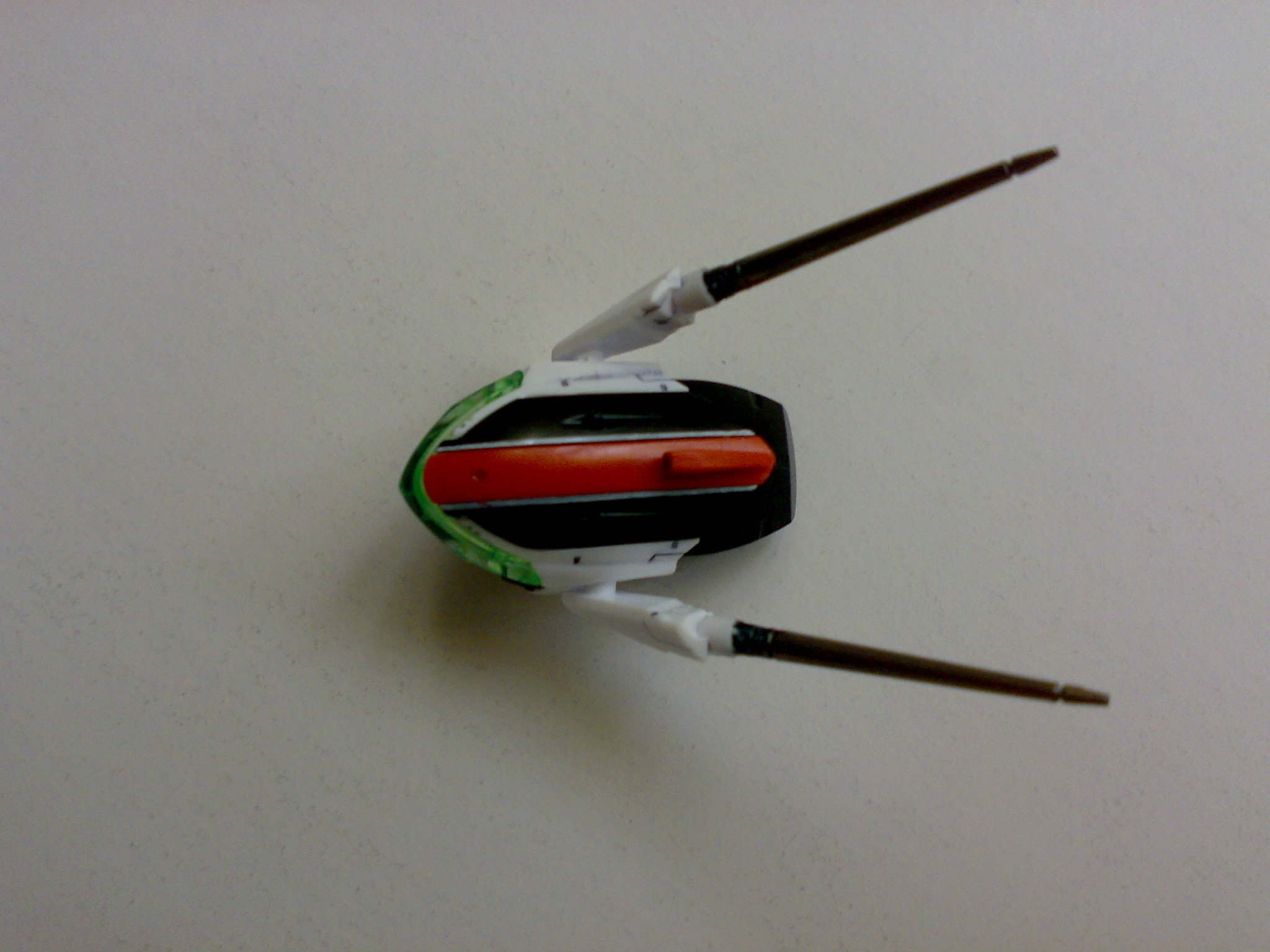

In the VF-25F's head and gunpod. for the other parts of the VF-25F i used a Gundam Marker Mechanical Pencil (GNZGP01) wich is easier to remove (too easy at times). The panel lines in the Ghost were done with Pro-Modellers Black wash. I think this last one worked the best, the excess paint is removed with a papel towel (slightly moist, if necessary) and the lines are very crisp, even small detail, like rivets, show through. I will still use the markers but only for smaller paint jobs. I'm not saying they're not a good product, but the Pro-Modellers wash makes panel lining a lot easier and quick, once you get the hang of it.

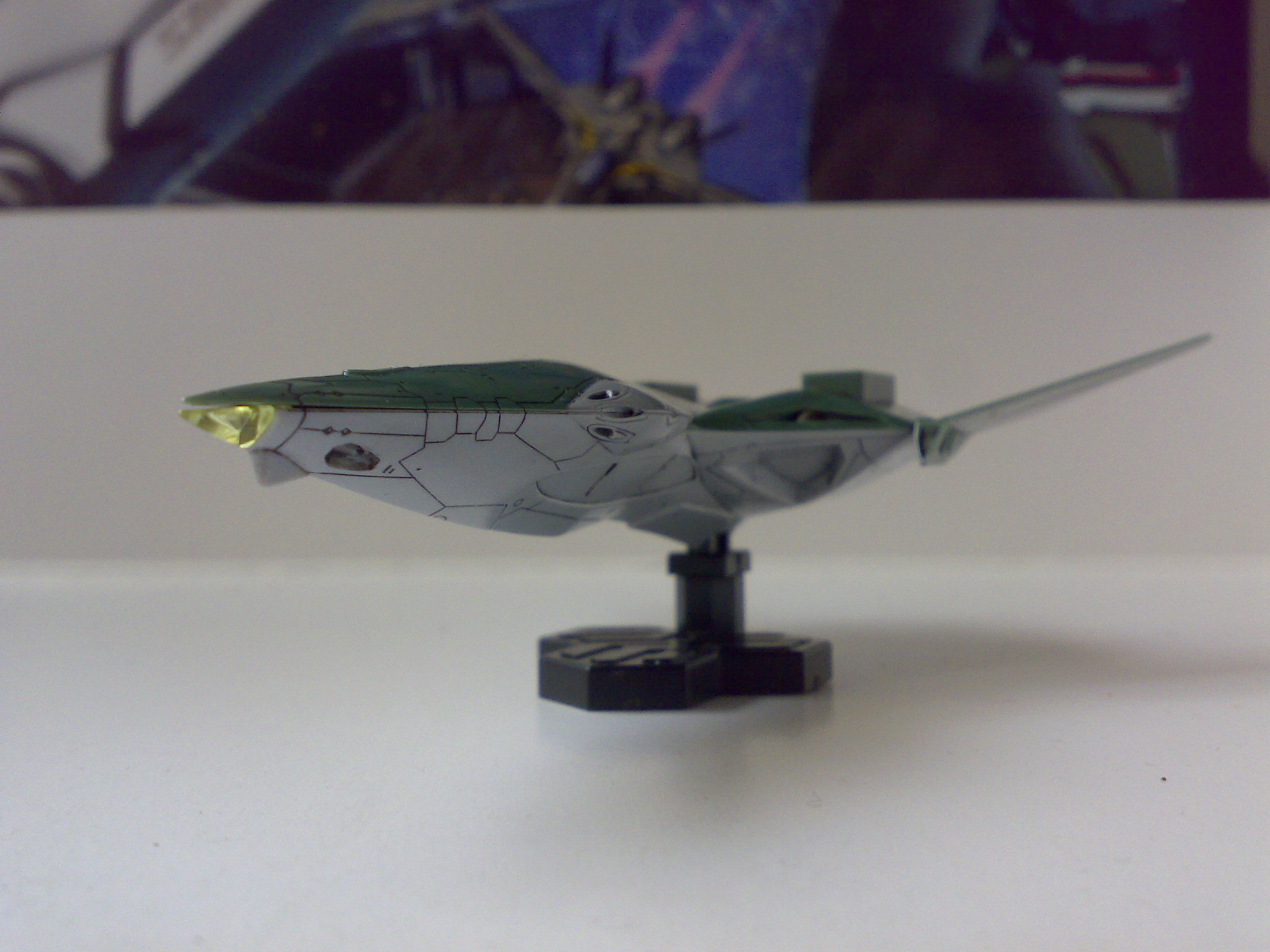

I mixed Clear Blue and Clear Red with Future and it didn't turn brown. I diped a test canopy from an old F-14 Revell Kit in it and it ended up with a very light violet tint. I wanted it with a bit more tint so, as an experiment i dipped only half of the already tinted canopy and after it dryed it was just right, for my taste, at least. The canopy violet in the animation seems to vary a lot, some times its just blue and sometimes is a grey-ish blue so its really up to anyone what shade they like. What i never got was Brown. I guess it depends on what shade of red and blue the manufacturers use for their clear paints as certain shades mix to violet and others to brown. I used Vallejo Model Color Clear Red and Clear Blue. The Green Eyepiece was tinted by dipping a wide brush in future and then in Clear green and brushing the outside. It looks great. Of course this whole exercise could be avoided if Bandai would just mold these parts in color. But at least it pulled my creative muscle to new heights.
