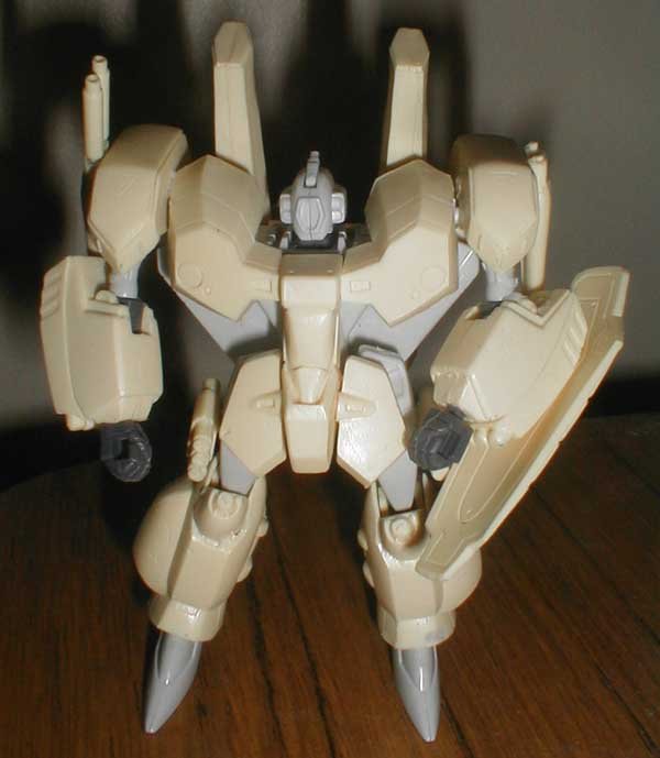

And the pile of parts. I only cast once from most of the molds, so it's about 50 duplicate parts short of a complete kit. The mostly built leg skeleton... ...And this is where I am now. A few of the exterior parts are on, but there's a long way to go... it's pretty slow going In other news, I ordered and picked up a bundle of boxes for the kits, and I think they'll work pretty nicely. The dimensions have been posted in the box art thread. I picked up a second McMaster order, with better screws, and a few drill bits. I'm really happy with the screws this time around, but all the drill bits I got are a bit to big. I'll be ordering another assortment tonight and trying again. Good thing they're cheap!
Alrighty, time for a long overdue update. First, some very good news. The first batch of molds is finally finished! I'm working on building up a kit as best I can to get a feel for how it all has to go together. Along the way, I'm taking notes to help with the final clean-up job, and for tips to include in the instructions. When the build-up is done, I'll ship it and a couple art books off to Devin to help him work his decal magic And now, a few pics I took over the past week or so... I had problems with one of the molds just because of how big it was. When I cast from my molds, I back the mold halves with plexiglass panels, and hold them together with rubber bands. But this mold was so large, the center always flexed out, resulting in massive amounts of flash. But I soon overcame that with a new binding technique I came up with I didn't bother trying a second time, but I'm sure I can get rid of that last little bit of flash too. The mold of the cannon cover thing. This mold was a huge pain in my ass Even with my new mold binding tricks, it took no less than 7 tries to finally get a good cast from it. Similar problems with this one, but it was much easier to get under control. This has to be the most unique, and one of the more difficult molds I've ever had to make. The clay job took a good deal of planning. And there are some things I wish I had done differently... ...but it doesn't matter, cause it worked well. Another angle. So far, this is the only mold I've ever had to bind on all 3 axis... A couple molds later (including a massive 3.5 pound arm mold), and the first set of molds was finially finished. 18 molds total, I think, consuming far more mold material than I had anticipated. I threw my Zippo into the picture for scale.
