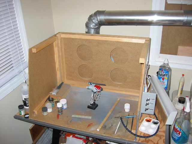

    And last is a picture of the top and the filter removed:

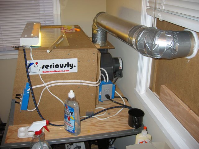

    Here's a picture of the motor around back:

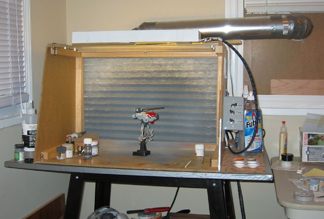

    Here are a few pictures of my booth: The dimentions are 16" deep, 16" tall and 25" wide. The filter in the back is just a standard furnace filter with the blower motor behind that. The walls are made of 1/4" particle board. The top has a plexiglass window to let light in and a florecent light sits on top of that. As Anasazi37 said, the light makes a huge difference. The 3 switches are for the light, the blower motor, and the outlet attatched to the back which usually runs the airbrush compressor. Front on with 1/100 Glaug for size reference:

    One thing about the kitchen range hoods: the motors are inside the duct. All motors spark continuously and your fumes will be going right over that. The sparks will be mostly contained in the motor housing, but I really don't think those motors are explosion proof. Just a risk you should consider. I built my own hood using the calculation and instructions from this site. The thing is, I spent about $150 to $200, about 2 weeks, and a bunch of my dad's tools to do it. The blower motor alone was about $120. The effort I put into it almost justified a $300 dollar store bought hood. Cost aside, I really recomend you get or make one. Don't skimp on the price or you'll end up with one that won't vent at all. I beleive Less Than Super Ostrich has a nice little store bought hood. Check out his VF-4 build ups to see pictures of it. Edit: Motors that run on wall voltage will frequently spark. Low power motors will not spark as much or not at all.
