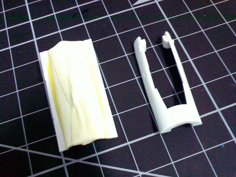

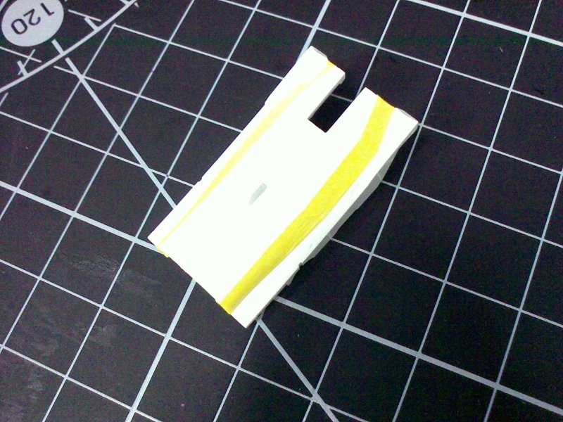

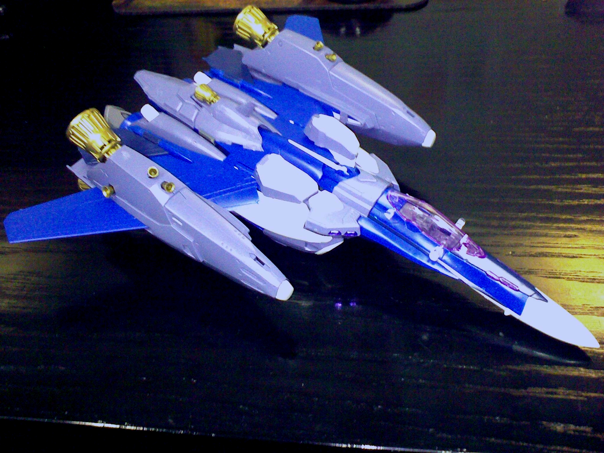

EDIT: Added pics Another brief update and a question. I masked off the underside of the Lerx for the bottom fusalage section. This is a part that is molded in white on all the kits but needs to follow the same colour for the rest of the Lerx. In the case of the VF-25G, it's a very dark blue. The S and F versions are black. I also decided to do the part that fits around the front landing gear doors, as it's molded in white and is meant to be blue, like the rest of the plane. Required Tools (hobby knife, cutting mat, Tamiya masking tape) for cutting thin strips to mask: The good stuff applied: Regular masking tape for the larger areas, and the middle nose section prior to any painting: I thought having the colours spelled out for me on the box/instructions would be a huge help and some quick testing showed the mix to be pretty accurate, so I went forward with the intention of just painting the white parts with the appropriate blues. When I was almost ready to start painting, I decided to do the right thing and prime first. My reasoning was that acrylics tend to scratch easily on bare styrene. If I primed, perhaps the primer would "bite" into the plastic a bit better and the acrylic paint would stick to the flat base better. So I put down a coat of Mr Base white and let that dry for 24 hours. From there, I started wondering if white was the best base coat for a bright blue (which the G version most definitely is). So I ended up putting down a coat of neutral grey. I'm not sure if this was the right move. For the dark blue I think it'll be OK. But the bright blue is just too translucent and I fear I'll need to strip the blue and grey and just put blue down. After that had dried (about 10 minutes - yeah not totally dried by any stretch) I put down a couple coats of bright blue. To my annoyance, the blue was not even close to the molded blue of the plastic on the rest of the parts. Perhaps I'm dreaming trying to match colours this way and all the blue will need to be repainted? So two questions: What's the best base colour for bright blue or dark blue (OK, that's 2 question in one!)? When I started putting down coats, I noticed the spray pattern on my airbrush was a bit granulated. The "wetness" of the paint meant the "dots" settled down smoothly but is this a sign of too little air pressure on the airbrush, too thin, thick, etc? Any tips would be greatly appreciated for this novice airbrusher. I took some pics but left them at home. Will edit this tonight to show progress.

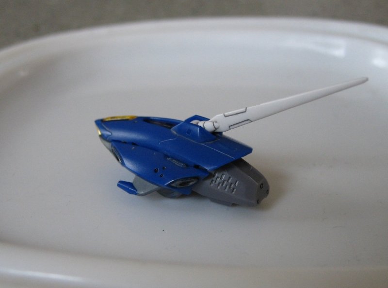

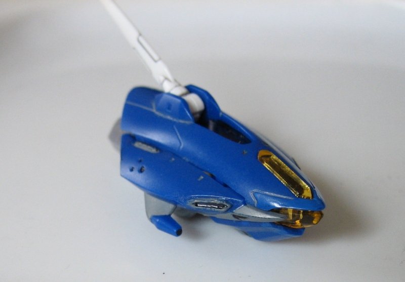

Next up, the head. Why? I don't know, I think it might be a combination of curiosity and impatience. This step gives me a chance to play with some washes for the darker blue colour. The results are not neccessarily what I had in mind but I'd like to know what people think. I also tried the add some reflectiveness to the lense assembly on the head. That's another one that I'm not sure I like. Unfortunately I used silver enamel so to remove it will require sanding. I'd love to use thinner to get rid of it but I'm fairly certain that'll ruin the clear yellow plastic. In hindsight, I think the way it comes is probably the most reflective and bright look. The silver just ends up looking black when it's fitted into the head. Probably the shadows cast by being inside the closed head... As for the blue and the wash I mentioned, I tried to go with a grey for the head, both on the antenna and the head. Again, in hindsight, I think a darker wash for the blue is in order and a lighter gray for the white parts. Which is kind of backward to what I see in stuff like WM Cheng's work. If he's got a black panel, he uses an almost white wash. Here it just doesn't quite look right. Mister Cheng, if you're reading this, I'd love to know your thoughts! The head was painted instead of decals. I used the recommended colour mix for the frame around the "eye" lense assembly. It's a very subtly lighter shade of blue and almost isn't visible as a different colour. The grey is just plain old neutral grey and I used the recommended blue colour for the rest of the body to touch up a few areas where the plastic had gone white around the sprue marks. The results were actually pretty good in my opinion. I'm hoping a semi-gloss clear coat will tie it all together (after the decals for the arrows have been applied). Anyway, here's the pics: This'll be the last update for a few days - got a crazy week and this brings things up to date with where I'm at in the build.

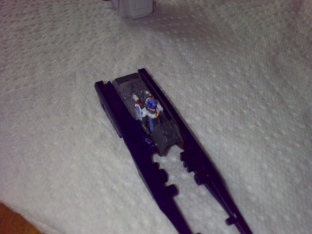

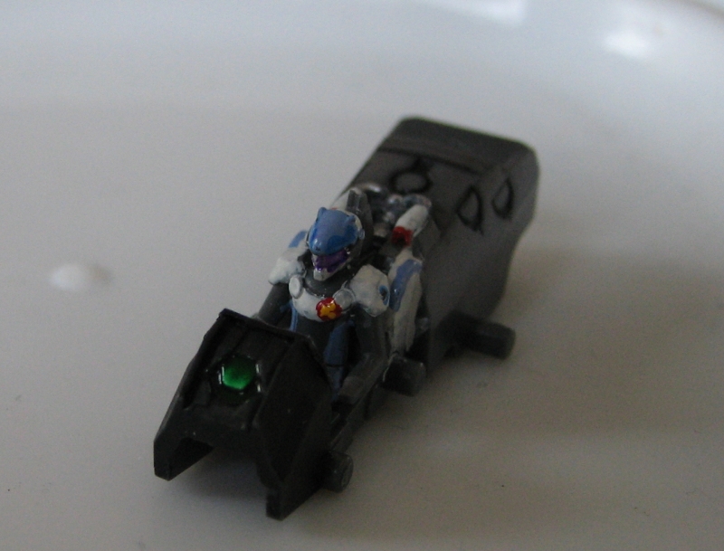

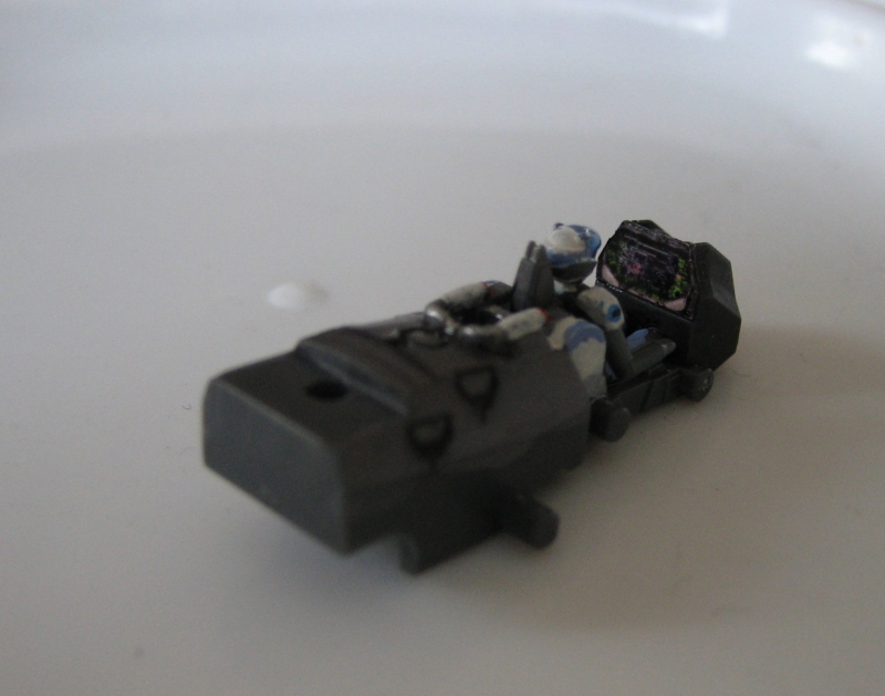

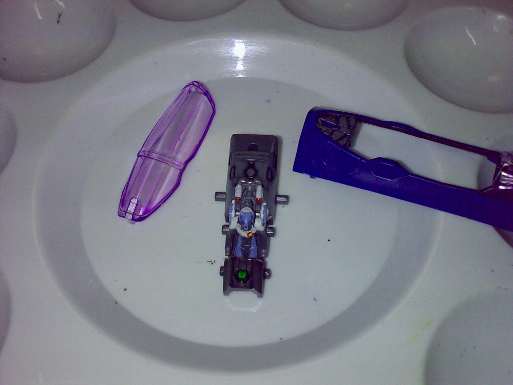

As a lot of you are well aware, the pilot figure on these 1/72 scale models is tiny! Some have suggested it's more like 1/100 scale. Either way, if it's not painted, IMO it looks pretty obvious and realism goes out the window. So how do you paint one of these little guys? I use acrylic paints from Tamiya and Gunze (my LHS didn't have all colours from one or the other) and mixed them based on the charts from the box/manual that was graciously translated for us by Vifam7: I didn't stick with the exact recommendation for the white on Mikhail's uniform, instead going with white and light gull grey, which matches the recommended colours of the white on the mech. I think it looks OK. The purple on his helmet and pants is, in my opinion, not purple enough so I went with a mix of bright blue, sky blue and lavender. I don't remember proportions but the quantities were so small, that you can probably just go with an equal mix of the blues, then add lavender until you like what you see. For the darker colours, I just left the bare plastic. The gloves/gauntlets were done with neutral grey and the blue was the recommended colour mix on the box. For the visor, I painted it silver with Testors gloss silver enamel, then put a layer of the same stuff I used on the canopy. It ran a bit but it's so small, it'll only be noticeable in close up macro pics. The SMS insignia was also done with enamels - just gloss red and yellow. Application was done with a toothpick for the most part. The visor and gloves I did with a fine brush. For the rest of the cockpit, I used the recommended RLM75 grey mixture and followed that onto the top, blue part of the fuselage as well. The grey paint didn't cover very well and I think it took at least 3 coats until it looked good enough. Even then, the edges of the patterns were still blue. I figured the wash would make that look OK when I'd finished. The front, instrument section was done with flat black and a touch of neutral grey. I printed out a copy of David Hintgen's screen cap, that WM Cheng has already cropped (check out his VF-25F build for a lot of the stuff I'm emulating). This was done on an inkjet and photo paper. It's not as crisp as WM's but for the size, it's acceptable. The resulting print was cut out and super glued on. After realising the piece was just a touch too big (it was preventing the canopy from closing) I trimmed it down and "painted" the edges with a black gundam marker. FYI, I use Tamiya acrylic thinner in about a 1/3 ratio to paints (1/3 thinner, 2/3 paint). I find this keeps it from drying while still on the brush and also hides brush marks really well. Wash was done with black artists oil and low odour thinner and allowed to dry for 2-3 hours before wiping it down with a dry paper towel. Here are the results: Pre wash: Wash applied: Wash wiped away: These last three were done on a proper camera so the quality is a bit better:
After fitting everything together for a test run, I found the following issues: The nosecone section is a PITA during transformation, lots of parts that will rub if I'm not careful and things that just are a pain to align properly when it does its fold up thing The canopy, when it rests against the backplate in battroid mode, means any coating/tinting you do on the outside of the canopy will get scratched The hinge on the back/wings area definitely needs some tightening to support the weight of itself, let alone with the boosters attached The boosters don't fit to my satisfaction. They have a lot of side to side movement with a pivot right on the wing root point. Perhaps a magnet at the back could remedy this? The upper and lower intake is just as irritating a fit as it is in non super arrangement. Magnets should help here (I've sourced some small ones) The legs hang low as some others have pointed out. It's like it's designed this way though - there's a notched section on the leg armor that is designed so the wing section can sit right on it. Not sure if I can improve this or if I'll just have to live with it (pics to illustrate this at some point). The arms are hard to swivel into the correct position so they lock correctly in fighter mode The missiles are going to be challenging to paint. I might end up using blue tack to cover the tips, paint the whole thing white, then remove the blue tack and leave the molded red in place. Doing a wash over the complex shapes will then be my next issue. On the paint subject, the booster nozzles are a really impressive molded colour but where the sprues attached ends up being black, no matter how smoothly you sand. This might require repainting (alclad?). Well, that sounds like a long list of complaints! I'm sure there will be more as I encounter them. However none of these are really that big a deal compaired to how much I still like this thing! It's an impressive bit of kit with all the details and the way things move and work together to allow it to transform. The engineering that went into it is still rater amazing and to have a product that can be assembled by a novice like me, and still work is amazing! I mentioned getting on to the pilot/cockpit part but I've run out of time. Next section I'll cover that.

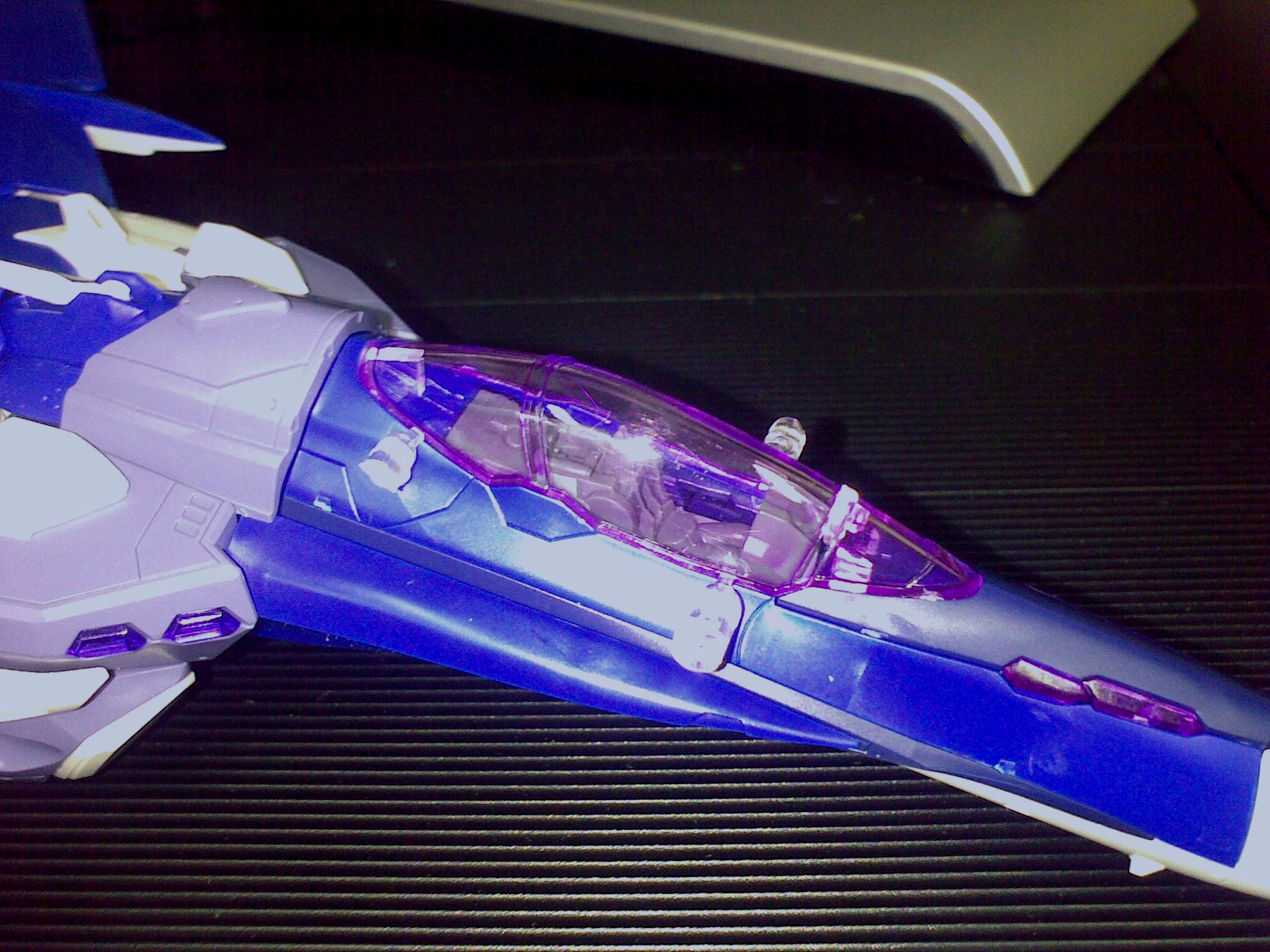

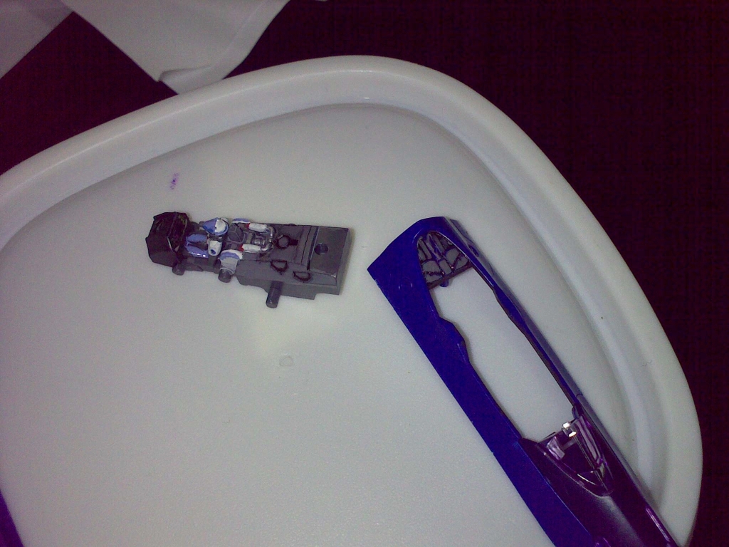

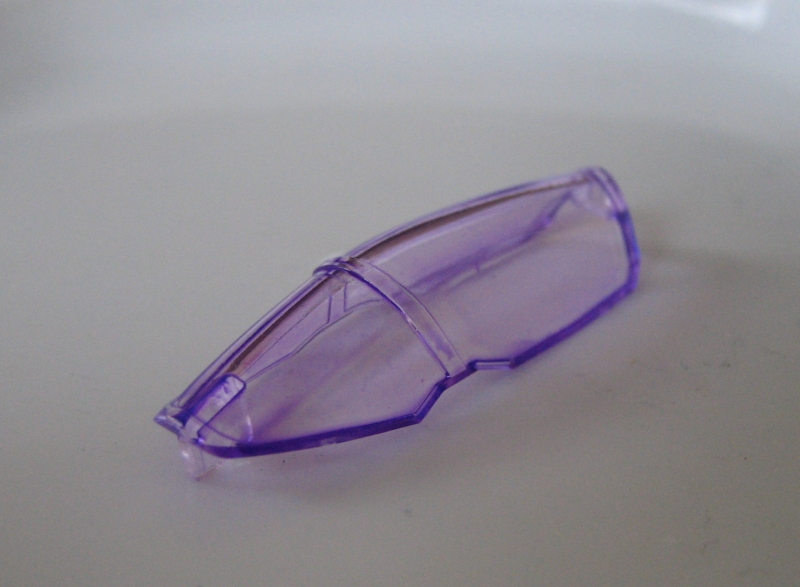

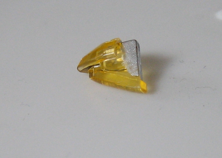

New pic just taken to illustrate the canopy problem. This shot also shows the HUD projector. At least I think that's what it's meant to be - the HUD on the anime was all holographic. Still, there's a spot there that's in the position of traditional HUD projectors so that's what I'm going with Anyway, as always the camera shows up the streaks and ugliness a lot more than just looking at with the naked eye. Plus, when the canopy is on, the dark background of the cockpit equipment really hides the tinting blemishes. -

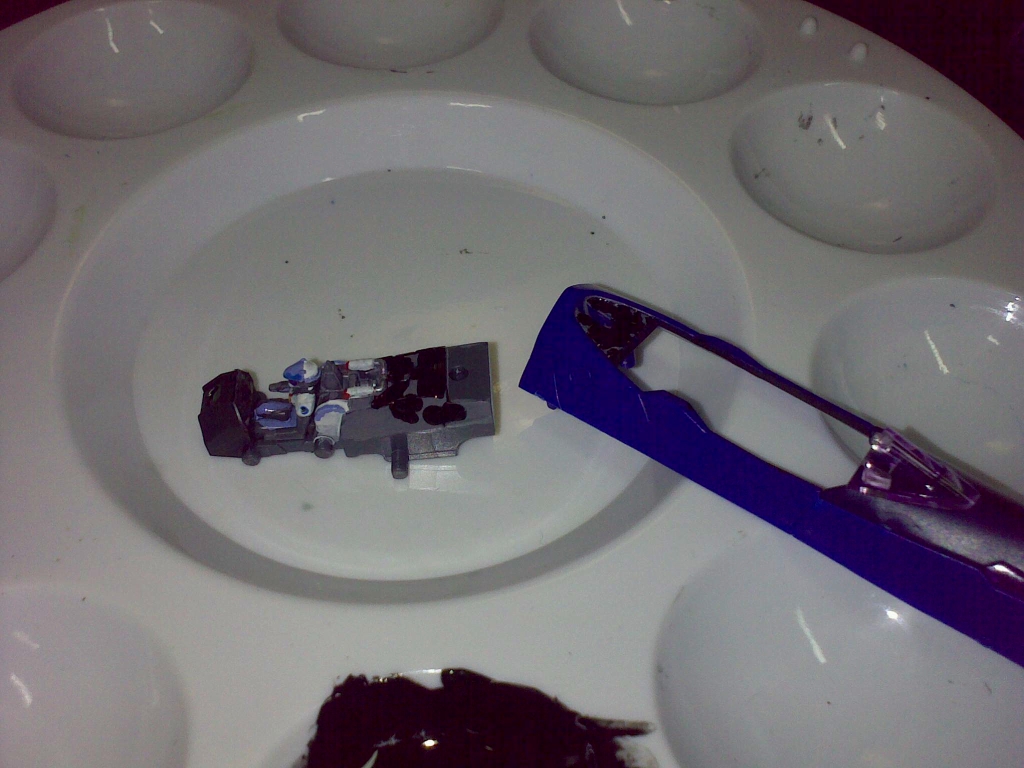

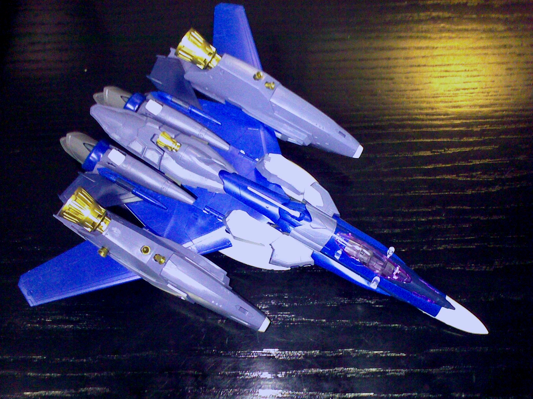

Looking very nice! Got a bit done on mine this weekend (mainly pilot/cockpit/canopy tinting): quick/dirty fit into the frame final paint application and oil wash applied after wiping the wash off I actually took a few decent pics with a decent camera over the weekend but didn't manage to copy them over to my PC at work. I promise these camera phone pics don't do this any favours! The real thing is looking pretty cool. I'm still not happy with the canopy tint (no pics shown). I must've redid it 4 times over the weekend. The Aussie equivalent of Future comes in 2 types and the only one I can find in my region has serious issues when you apply more than one coat. The second coat reacts with the first and it ends up a wrinkled mess. So I ended up dipping the whole canopy (inside and out) and carefully soaking up the areas that pooled with a brush. The result is OK and actually looks really good unless you're an inch away from it. The problem is that it will scratch very easily. Has anyone had any luck applying Testors model master clear coat over acrylic clear? It's the type that comes in a glass jar. It says it's lacquer so I'm worried it could melt the plastic. I'll try it on some clear sprue to see what happens first. -

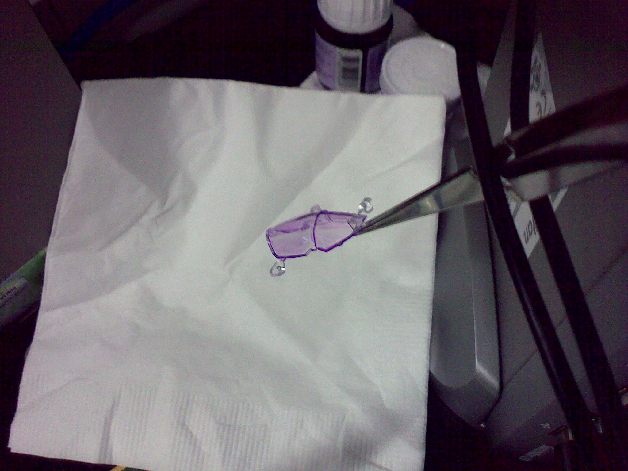

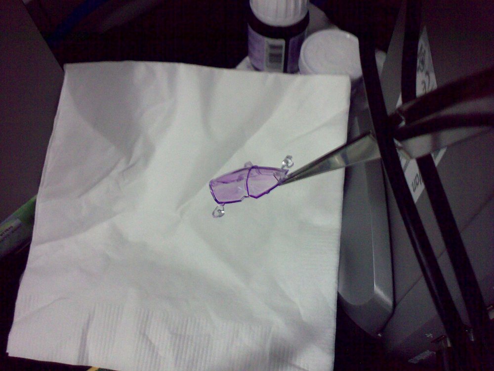

Ok, washing the parts is a no brainer! In case anyone tries without washing first, it's a huge difference. This is a fuzzy pic but after one coat it's almost acceptable. One more should do the trick. WM, did you notice the "edges" on the curved part of the canopy? On mine, these are so prominent that the tinting ran off them more than the rest of the part. You can probably make it out in the pic. My lousy camera phone exaggerates this but I'll still pop another coat on to be safe. -

Your purple tint looks really good. I've had an awful time getting mine consistent. The small parts (the sensor array and the front of the canopy) look pretty good, but the main canopy being bigger, just seems to make the liquid pool up or worse yet, thin out in odd places. The end result is a streaky, crappy looking mess! Did you wash the clear parts before-hand? I might try that. Luckily the stuff comes off perfectly with Windex. The other problem is the lack of a good Future equivalent down here in Australia. I'm using a product that seems a lot less glossy when dried and also seems to not like sticking to any surface. I once used it as a clearcoat on top of black enamel spray can paint and it just pooled up into tiny droplets. At any rate, as I mentioned, it looks OK on the small parts. -

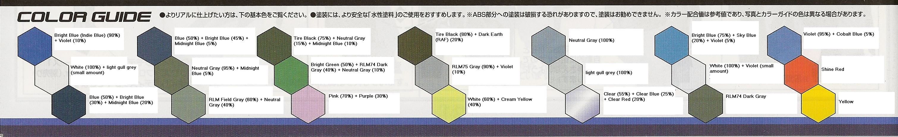

I know this is going back a few pages, but I posted up the colours for the Mikhail VF-25G kit (somewhere around post 400). I finally got my kit and am really impressed with it! The level of engineering and design that went into this is just incredible. Granted, my only comparison for transforming kits is an Imai Legioss, so it's not a fair fight... Anyway, I've got a request, now that I've got colours that are accurate, I need to know where to put them. Can someone take a bit of time to translate the headings for each colour (IE "blue part of main body" ect...)? Anyone...? Anyone...? Vifam7...? Here's original: And the one that's got the colours but no headings translated: -
