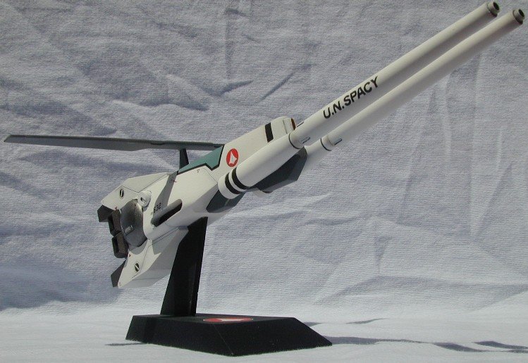

Here's a part that was really fun for me on this model. Digging through my decals box to figure out what I wanted to use on this puppy. Here's a shot of the first pass, I may use more.
