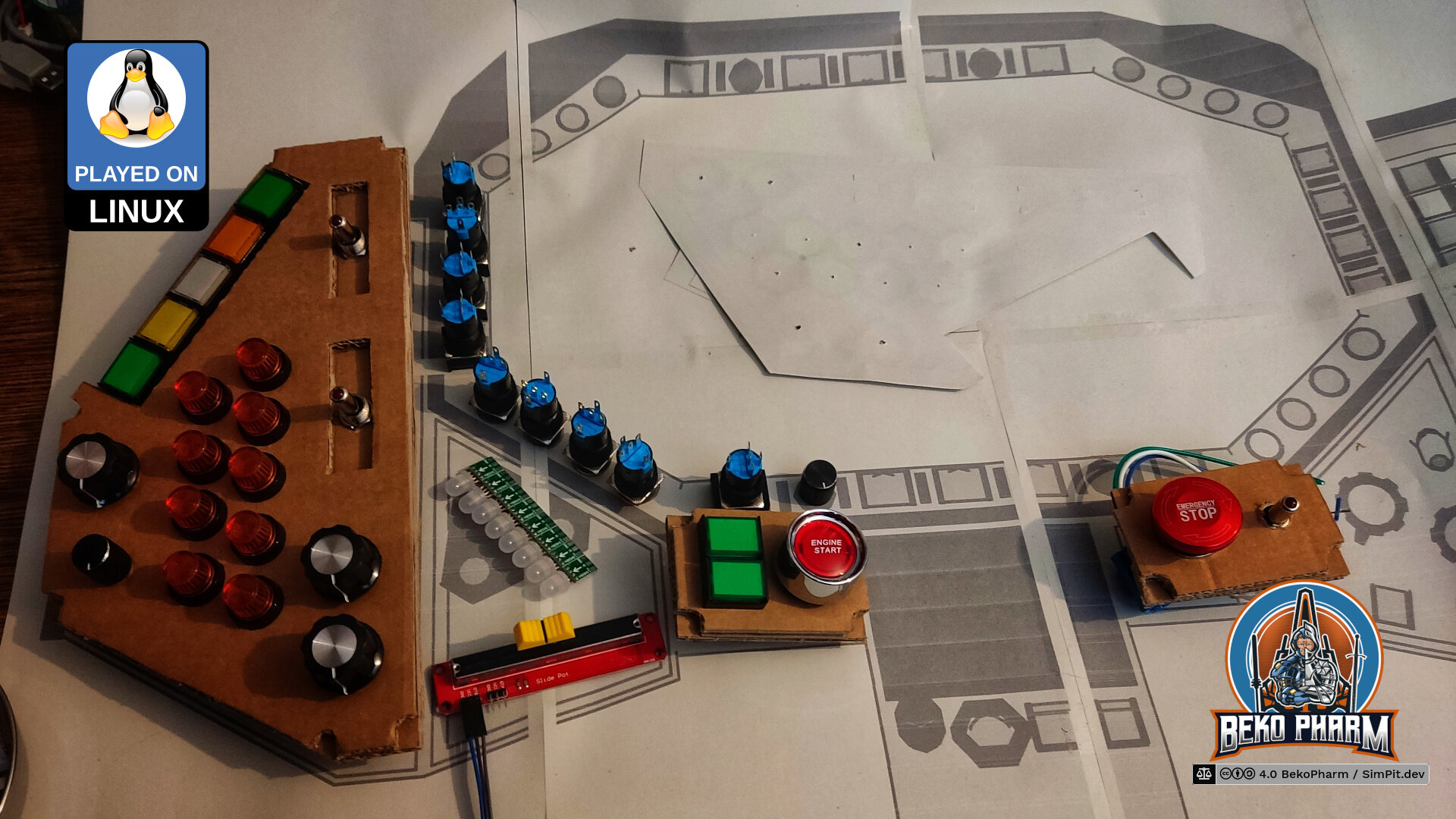

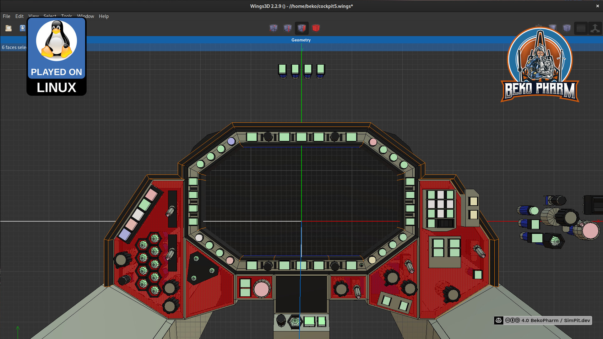

Beko Pharm Posted October 3, 2023 Posted October 3, 2023 First off: I usually don't engage in fandoms of any kind due to reason. Second: I usually do _not_ get my hands on official source material, as this stuff is hard to come by in my area for reasons we all know. So I may have some details wrong. Feel free to point them out in a constructive manner! What you see is a glorified DIY joystick controller with a LCD ('MFD') and plenty of RGB. It's design is based on a VF-1 (DYRL) and was modelled by me in Wings3D using source material from the Macross Mecha Manual (Kudos to whoever made this instrument drawing - had a good chuckle reading the inscriptions): http://www.macross2.net/m3/macrossdyrl/vf-1s-strike.htm http://www.macross2.net/m3/macrossdyrl/vf-1a-fastpack/vf1-dyrl-cockpit-instrumentpanel.png I say based because this is not an exact replica. The goal is to use it for playing PC games. Really any game so I'm keeping that part as stupid as possible. This is "just" another joystick for the PC - and am additional display connected via HDMI cable. Using all of it's features requires additional software, of course, but this is the basic design so any game could be played on the built in display OR next to it. I use it mainly to play Elite Dangerous, Star Citizen, X4: Foundations and plenty of other Space Pew Pew. I'm not aware of any Macross specific game for PC and never owned a PS 🤷 Anyway, after designing that I didn't do much with it for months. My previous version (own design) made of cardboard did the trick for quite a while. One of the final bumps to make me go was the 3D models of @Olitech Industries in the end, that I found during researching for that design. The rest is history ☺️ Important: This is still Work In Progress. I'm _still_ moving buttons around because I'm still not yet sure what I'll need but I do have a very good idea by now. This is to explain why some areas are still empty. I eventually started the build by exporting my model to STL. Inkscape made the scaling a breeze and after printing out 8 A4 papers I got the first impression how huge this would going to be in the end - and I almost stopped right there again. Next was preparing a lot of mock-up panels made from cardboard - something I have good experience with from my first version, that used my own design. When I was happy with the mock-ups I switched to wood. For this I sourced mostly from the local hardware store. Stuff they had available so I wouldn't have to pay for cutting services. The rest was done with the help of a jig saw, wood glue and staples. Wiring everything was quite a task. I did spend many evenings and sunk over 250 connectors into this - can totally recommend crimping pliers for this. I won't bore you with the details here. Next was the software part. The core of the contraption is an Arduino Mega that runs some custom code I wrote. It also controls the status indicators so whenever I get ship telemetry from games I can control individual RGB LEDs on a Neopixel string. The LEDs are not yet built on this picture but are sitting on the top as I used to have them on my first version. They eventually moved to the very retro styled orange housings. Kinda liked my own hexagonal housings too but what can I say… I'm a child of the 80s 🤷 The next step is a never-ending one as I'm tweaking and adjusting the HUD application as I go. Most of this I had figured out for version 1 already but decided to rewrite everything for the VF-1 variant mostly due to more "screen estate". The idea is to interface with games that allow that by parsing their ship telemetry data and logs and cram everything into a plumbing pipeline unifying the data format in a way that the HUD can understand without having to roll different versions of the HUD based on the games I play. This is the most custom part as interfacing with games is _hard_ - and most don't let the player do that and have to be… persuaded. Spent e.g. _weeks_ on hacking my way into X4 but I got it working in the end. So what's left to do? Well obviously building a complete cockpit around this 🤓 I may eventually go there but for now I just enjoy my Pew Pew gaming with what I have. I'm also still working on the finishing touches like deciding on the icons for the buttons: I'm still working on a walk-through demo video explaining what which part of the panel does. So… QnA time maybe? 😅 Is this a finished product? NO. Will it ever be? As well: NO. Can I build you one? NO. It's a project of passion. I'm not interested or qualified in making this my job. If you are inspired though (and I hope you are) and want to roll your own: Be my guest. I started a project page where I'm explaining all this in more detail: https://SimPit.dev - it's slow af, because it's hosted in my backyard, but ads and tracking free. I'm also steadily expanding this. Various demo videos exist also on YouTube or my PeerTube account and I foster a project page on Hackaday so pick your poison. My material is usually CC BY-SA 4.0 - I believe in fair sharing and adapting! I'm also available for questions or advice, of course, but implementing something like this to fit _your_ needs _will_ be up to you.

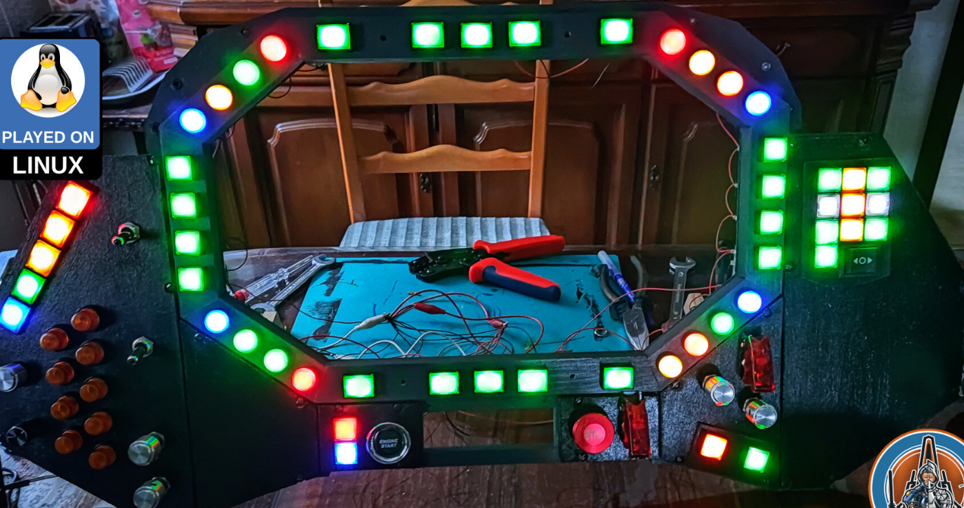

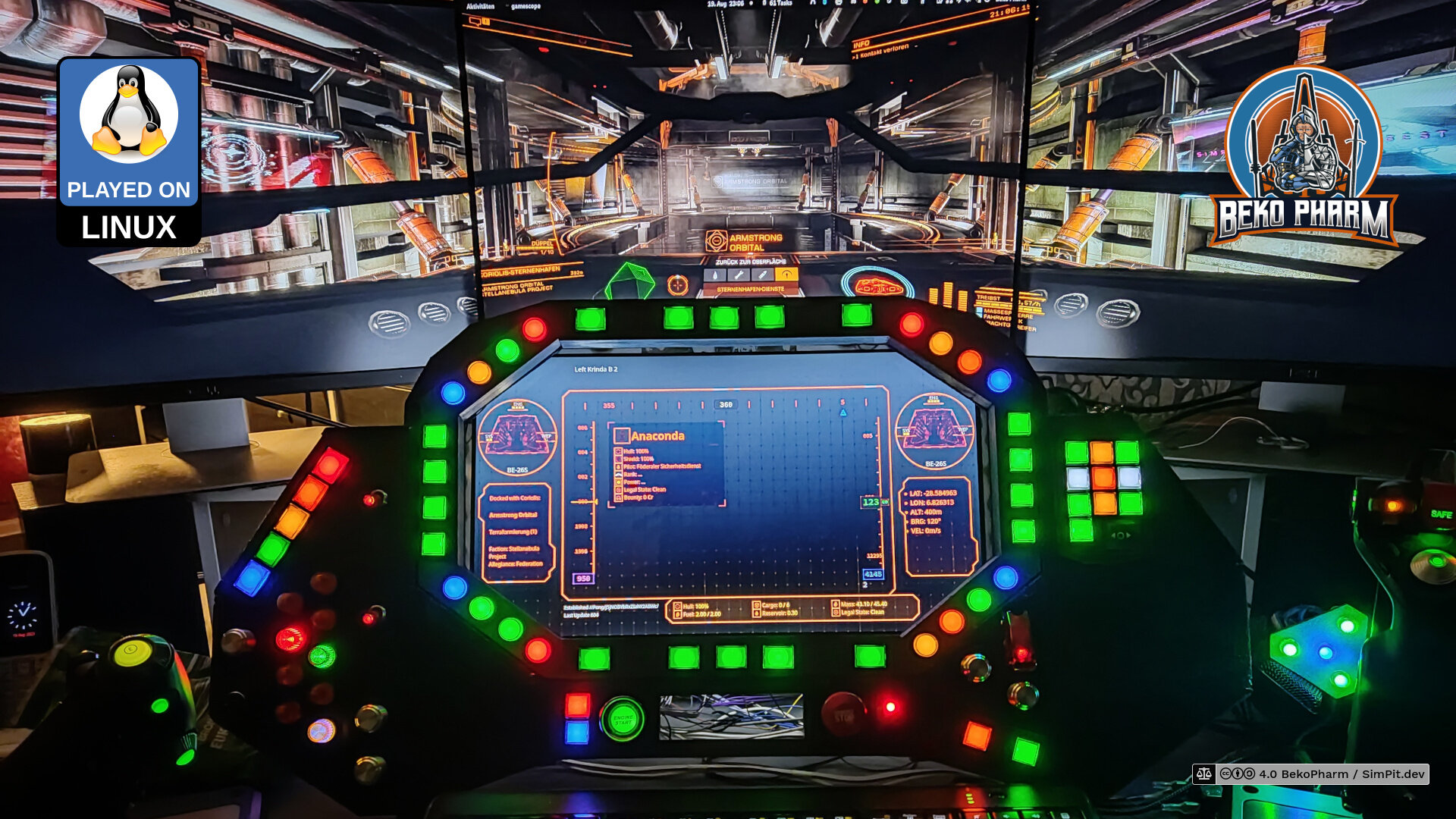

Beko Pharm Posted April 9 Author Posted April 9 Been a while since I updated this here too. It's still work in progress but the home cockpit learned a few tricks: I also gave a detailed tour in a live interview going over many of the technical details: I got a little bit distracted because I got my hands on an old ViperPit, that I'm considering to convert into a VF-0. Meanwhile I got Ace Combat 7 and found out about a VF-1 mod for this so I was mostly enjoying this after reviving the old input devices (rudder, throttle and stick were so old that I had to convert the hardware to USB-C first). Still slowly improving and upgrading it, oc. Got the additional display I always wanted to fit in there meanwhile: Let me know what you think 😎
SteveTheFish Posted April 10 Posted April 10 Neat. So what game is that? Can you play Pac-Man on that thing?
Beko Pharm Posted April 10 Author Posted April 10 5 hours ago, SteveTheFish said: Neat. So what game is that? Can you play Pac-Man on that thing? Which video? First? That's X4 Foundations with mods. PacMan? Probably yes 😛
