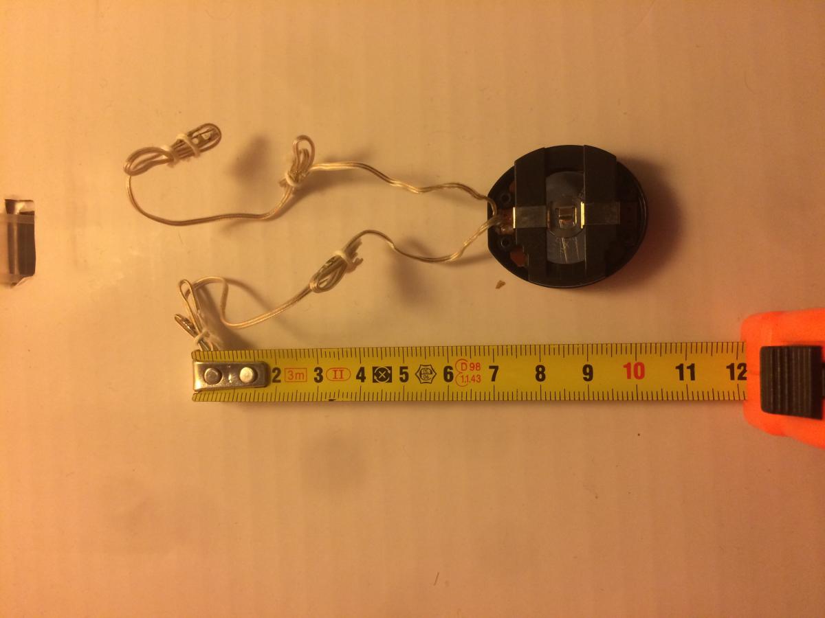

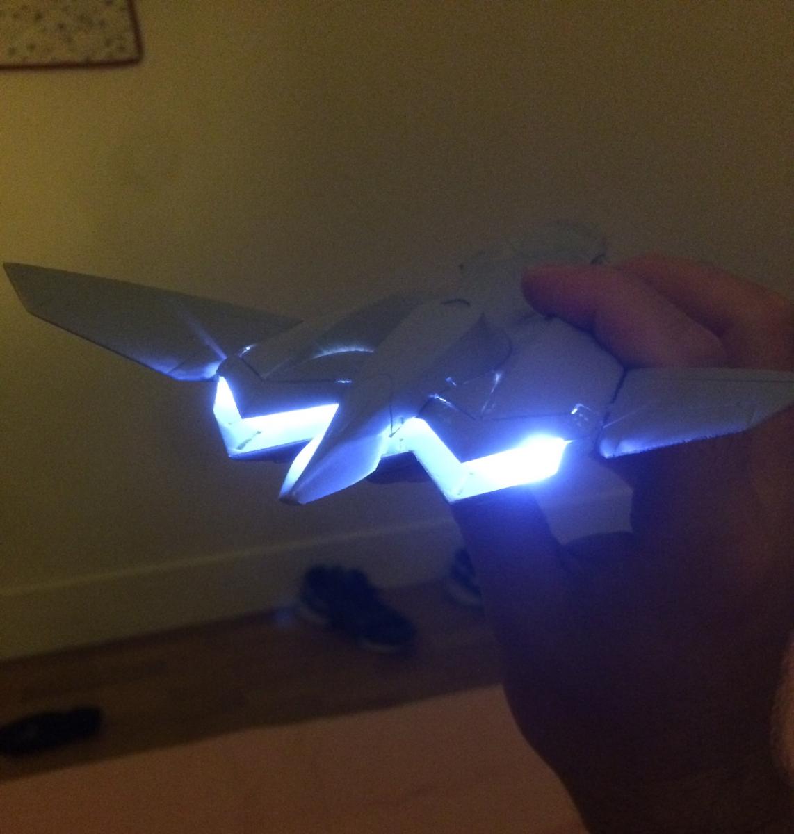

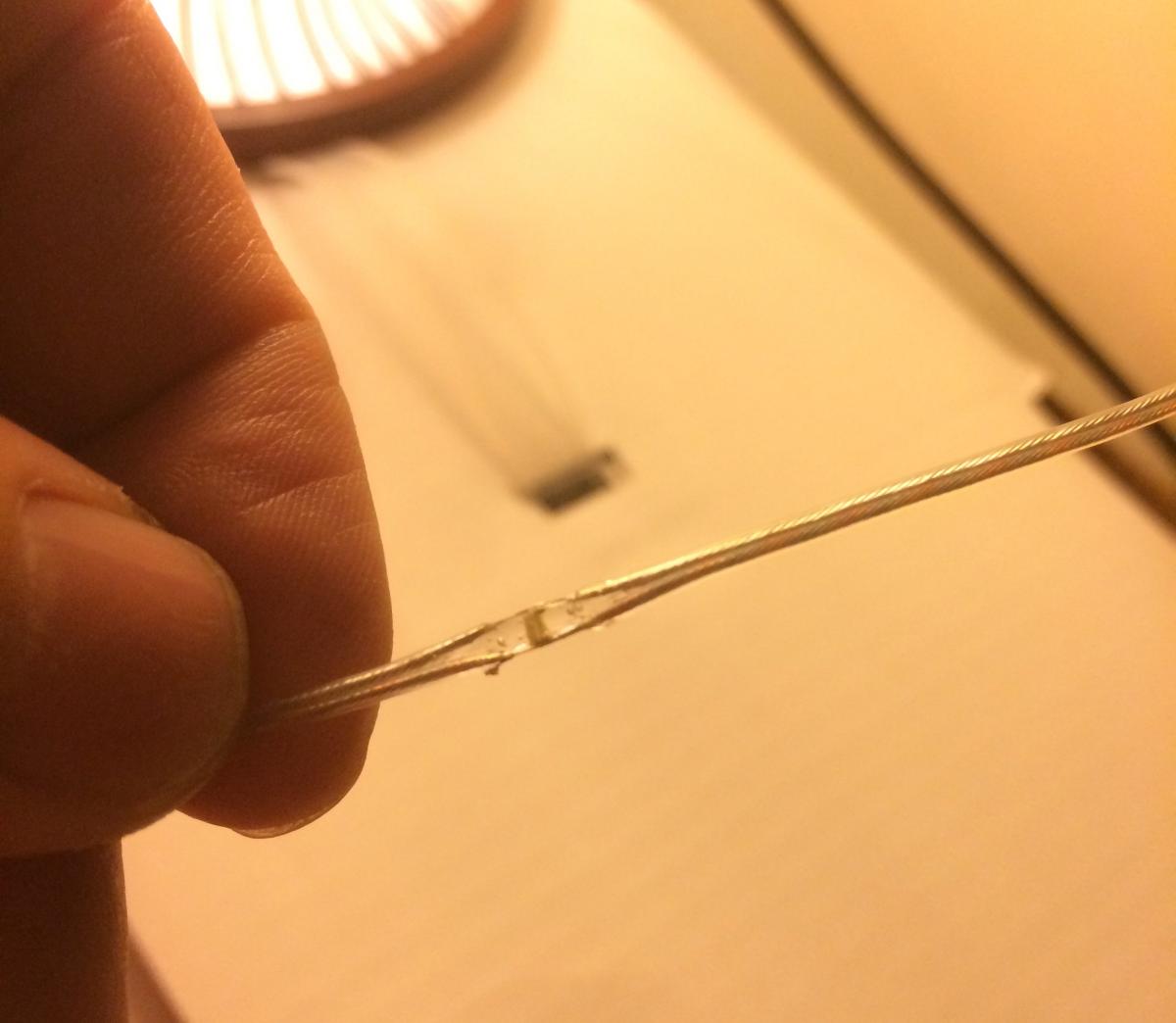

Xigfrid Posted September 15, 2016 Posted September 15, 2016 (edited) I received the luminous necklace today and dissembles it to its tiniest form. The power switch is a tad big (3cmx2,5cm) but the leds are just mounted on a pair of wires. The leds are basically PCB leds soldered directly onto the wires and glued in place. This can be very nice setup if I can reduce the switch size, and reducing the dual battery cage to a single one Test on my X-9: On the workroid: And sorry for the crappy pictures from my phone Edited September 15, 2016 by Xigfrid
NZEOD Posted September 15, 2016 Author Posted September 15, 2016 (edited) Love it make the switch a magnetic reed switch. That way its tiny AND you can hide the 1mm magnet on the underside of a peice of the model that can be "clicked" into place to turn it on, making the switch virtually invisible Edited September 15, 2016 by NZEOD

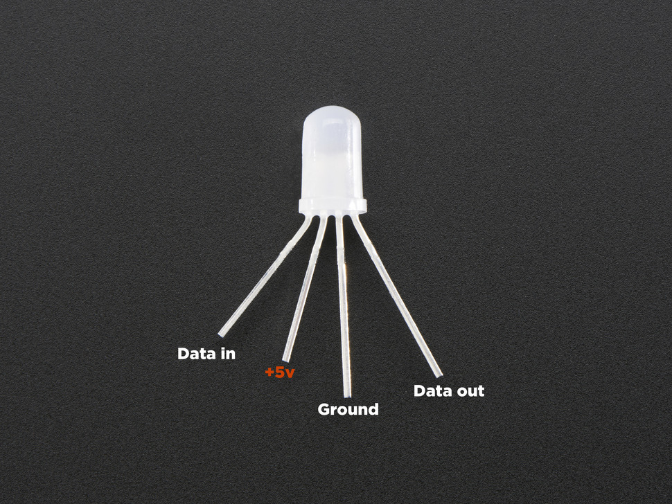

arbit Posted October 5, 2016 Posted October 5, 2016 (edited) With LEDs the long stem is always + and the short is Ground (-). Not so with Neopixels. Edited October 5, 2016 by arbit
NZEOD Posted October 5, 2016 Author Posted October 5, 2016 yeah I have the image on the workshop bench wall for that reason!
arbit Posted October 6, 2016 Posted October 6, 2016 yeah I have the image on the workshop bench wall for that reason! Another day, another electronics joke
