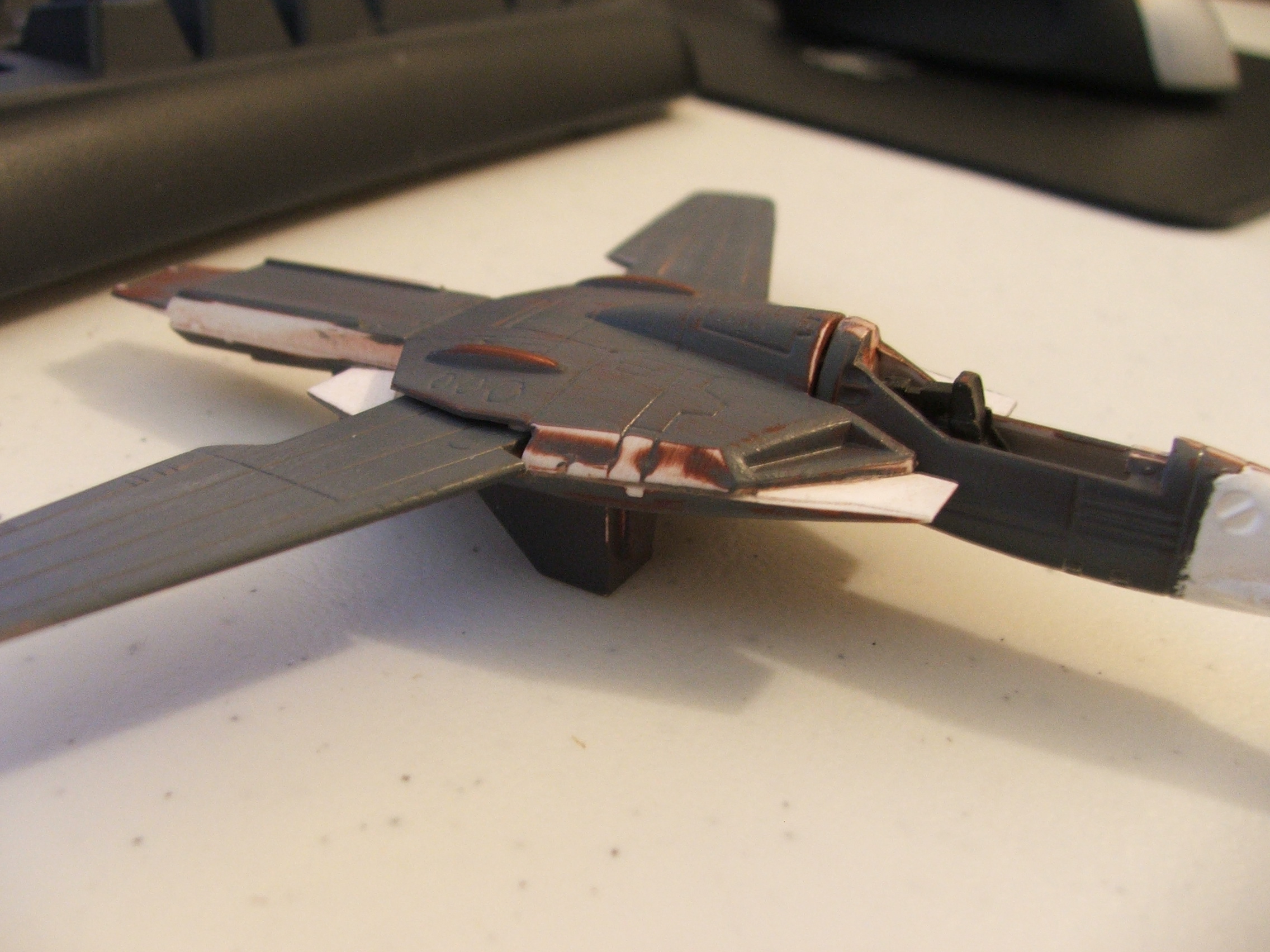

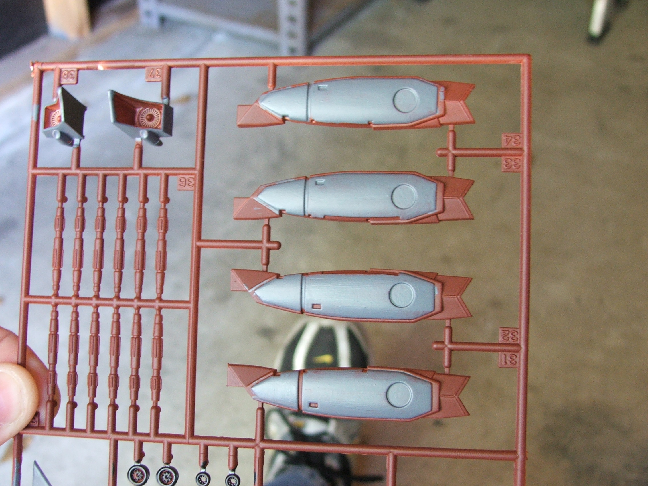

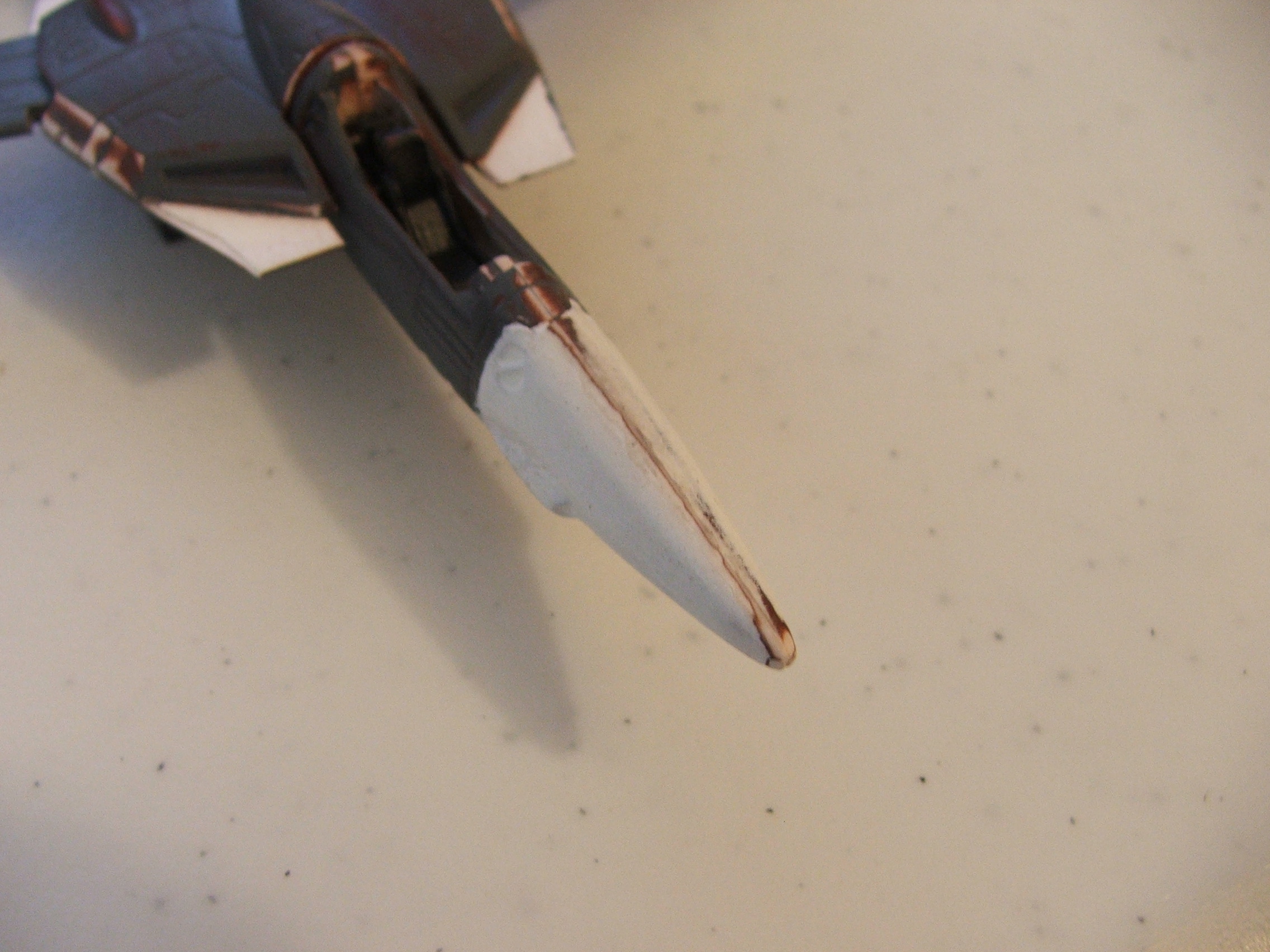

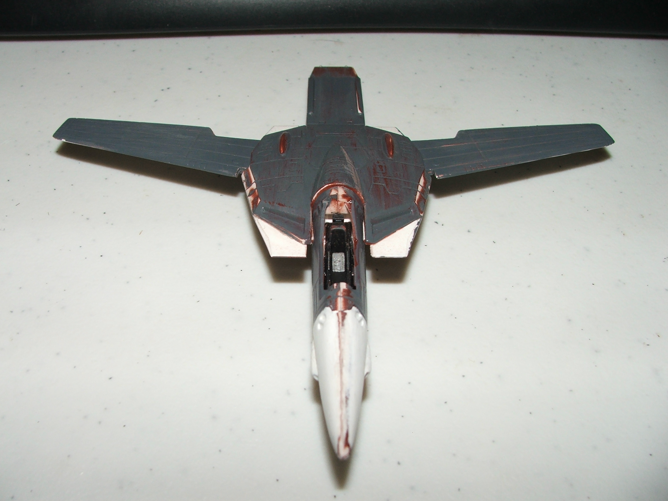

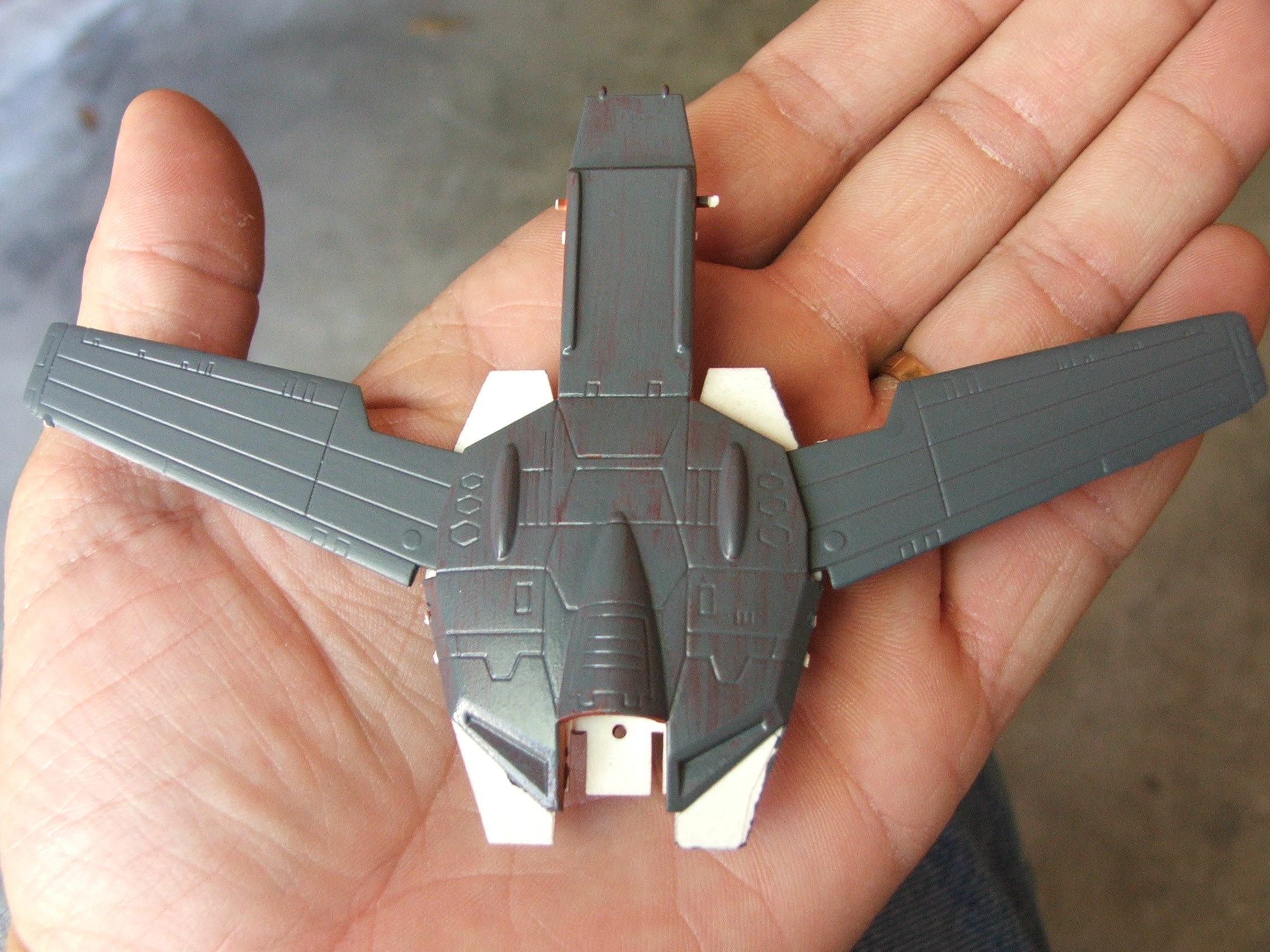

Mr. Anderson Posted March 26, 2008 Posted March 26, 2008 This is my first model in about 15 years. I wanted to start out with something cheap so I picked up this 1/100 scale at the local hobby shop. They didnt have much for Macross kits but it was cheap and I figured I could use some practice before I got my VF-0S Valkryie and Battroid. Ill be posting more progress pics along the way till its finished!
kkx Posted March 26, 2008 Posted March 26, 2008 Good strategy. I hope this will turn out to be fun too on top of brushing up on your skills. Looks like you are up to a good start already. Good luck.

jardann Posted March 26, 2008 Posted March 26, 2008 Looks like you're off to a great start. If you can eliminate the seams on those kits then you've pretty much got it beat. Is that the kit for Millia's fighter? Will you be going with the recommended paint scheme or a custom? Thanks for sharing your work and welcome back to the fun! I hope to see it when you're finished.
Mr. Anderson Posted March 26, 2008 Author Posted March 26, 2008 Looks like you're off to a great start. If you can eliminate the seams on those kits then you've pretty much got it beat. Is that the kit for Millia's fighter? Will you be going with the recommended paint scheme or a custom? Thanks for sharing your work and welcome back to the fun! I hope to see it when you're finished. Yeah it is Millia's fighter. Im trying to get rid of the seams. What method and tools do you use for getting rid of the seams? Im just going for recommended paint scheme for now. Not confident enough to do anything custom.
warpaint22 Posted March 26, 2008 Posted March 26, 2008 Looking good Mr Anderson and a good idea to start on a nice simple little kit. For removing seem lines you just need a little model putty and a few different grades of wet and dry sandpaper. A sculpting tool is great for applying putty but you can use anything handy to apply it, an ice-cream container lid cut into small rectangle pieces works well.

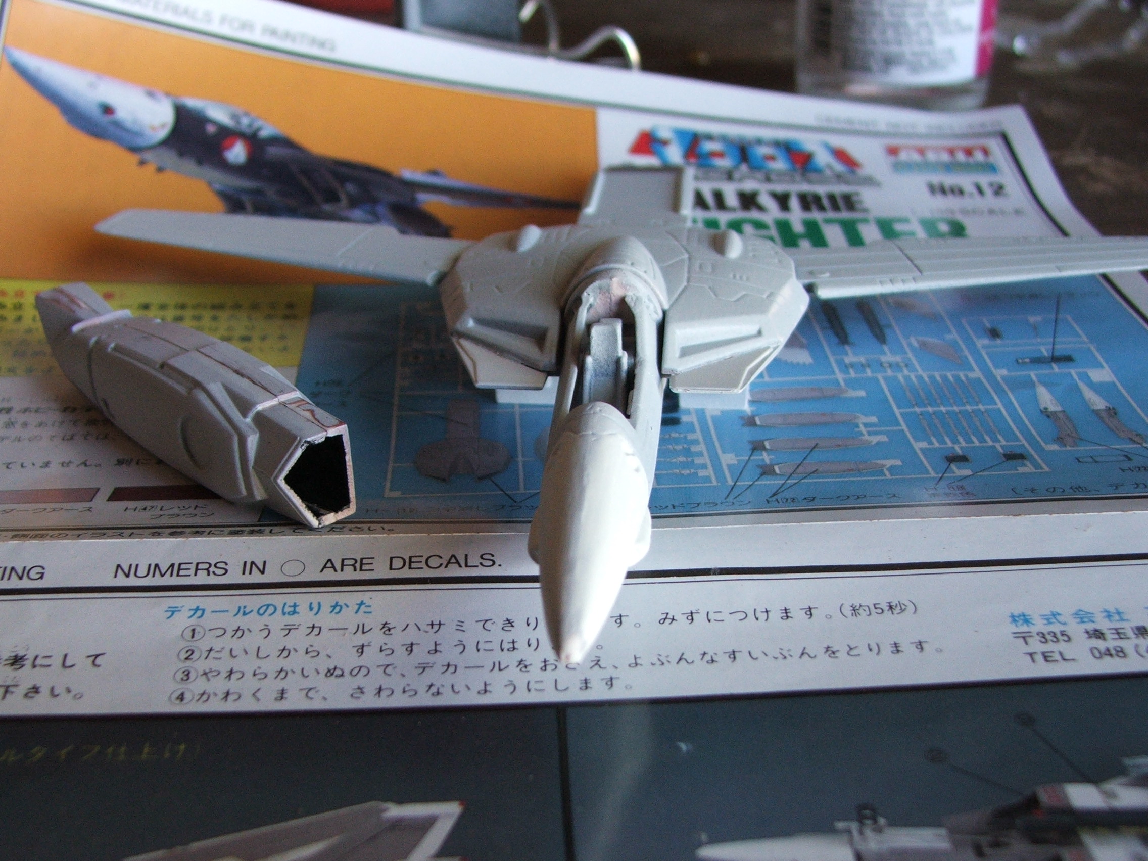

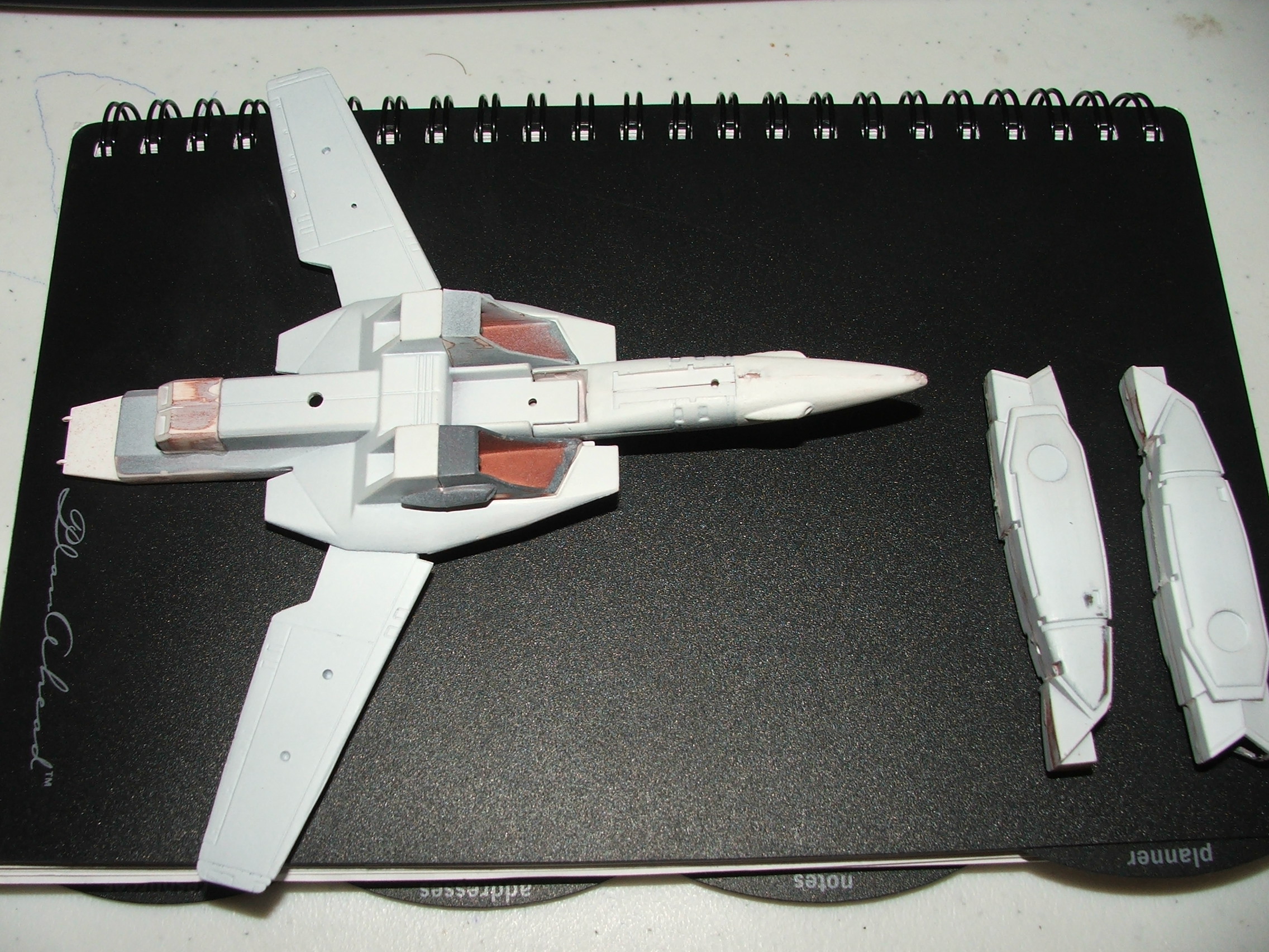

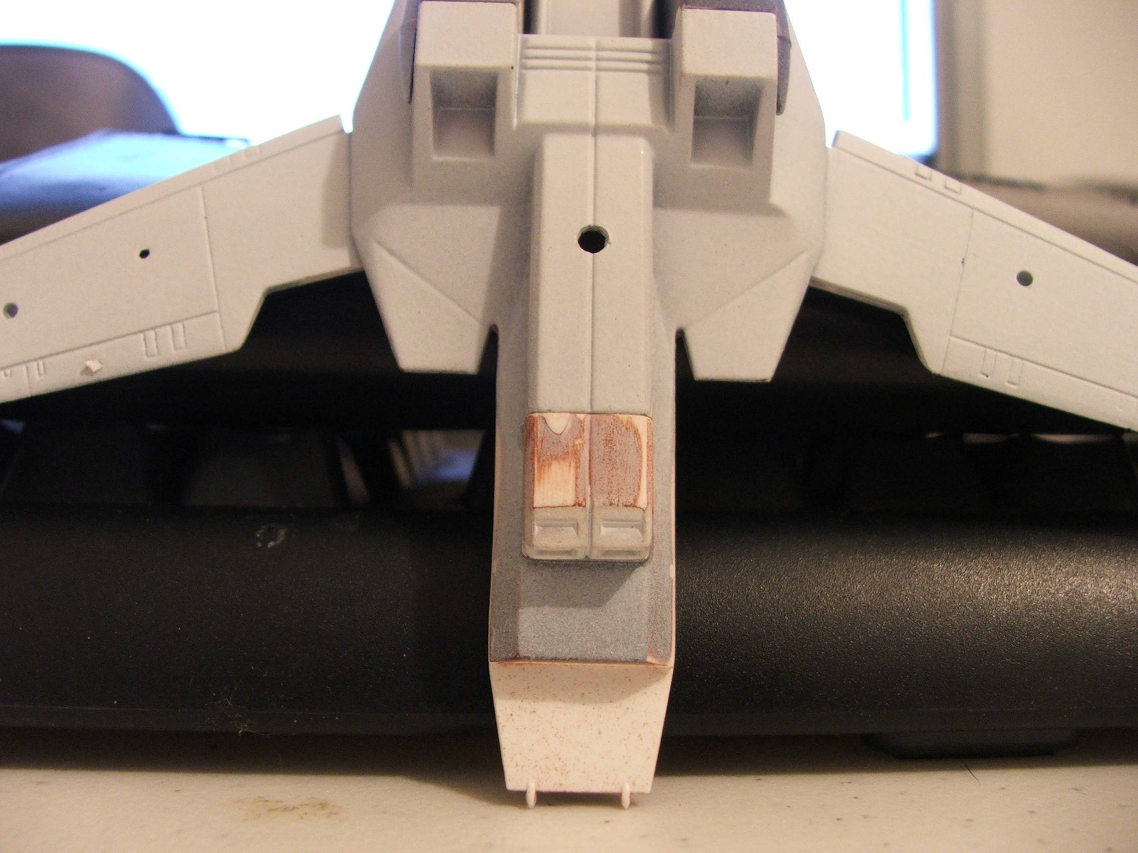

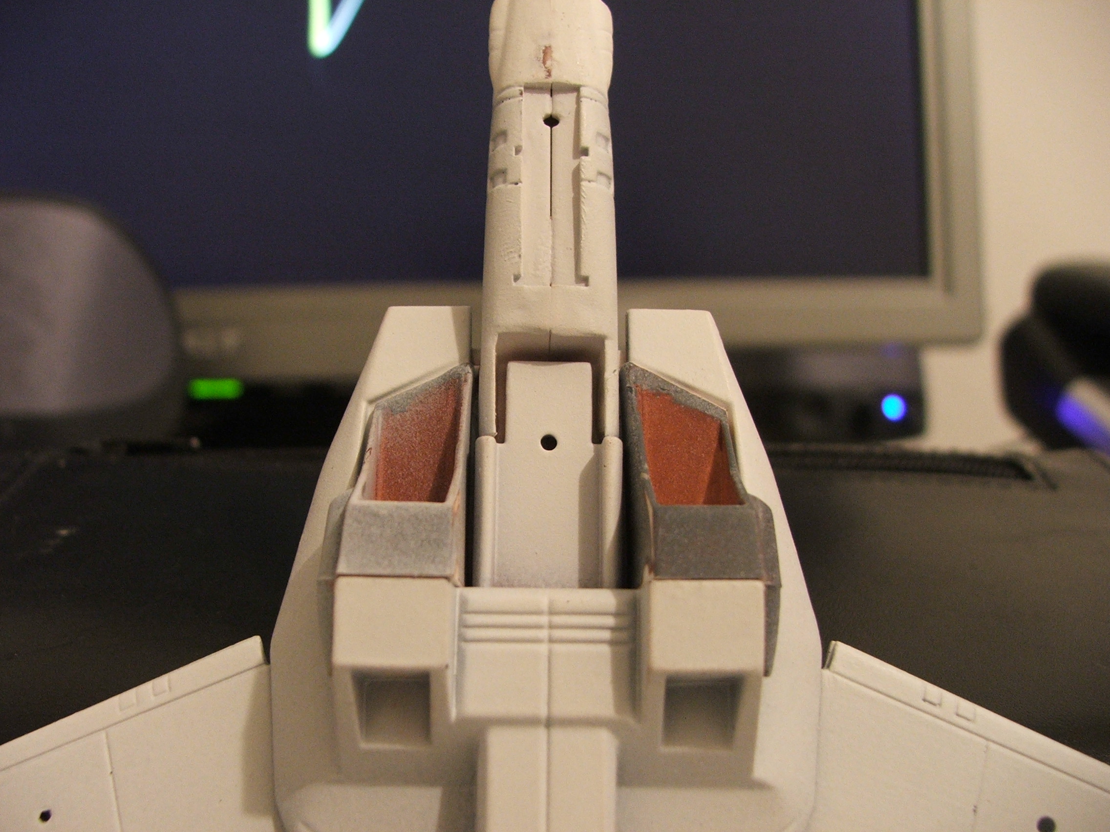

Mr. Anderson Posted March 27, 2008 Author Posted March 27, 2008 (edited) Okay so I re-primered some areas after some sanding. Went with a white primer this time. I think I lost some detail of the panel lines but oh well. Just added some more parts on today and did a lil more sanding. Some big seams im going to have to fill here! Thanks everyone for all the encouragement. I need it! Oh yeah I almost forgot....I got my airbrush kit today! Thanks Don! Should be interesting to see how things turn out. Edited March 27, 2008 by Mr. Anderson

Mr. Anderson Posted March 27, 2008 Author Posted March 27, 2008 It is easy to cover up some panel line when paiting or priming. Especially when using spray can primer. I hate it when it happen. I do not have the skill to rescribe most panel lines. For this Arii kit, the panel line are thicker (compared to a Hasegawa kit) and it is not so bad (harder to lost and easier to recover). Now that you have your airbrush, maybe doing priming using your airbrush will be better. I find that thinning down the primer and apply it using an airbrush give me much more control. It might be too thin to give good filling (when this is needed, I try to do more layer or don't thin the primer so much), but great in avoid filling in fine panel line, especially during second priming after some sanding (where I just want to have a very thin covering to let me know if the surface is smooth). Looks like you are having fun. That is important. Thanks! What do you use for primer in your airbrushes??
kkx Posted March 27, 2008 Posted March 27, 2008 Thanks! What do you use for primer in your airbrushes?? I use mr. surfacer 500 or 1000. The grey colored one. I have also tried to de-can a spray can auto-paint primer and thin it and use it with my airbrush. What primer are you using?
jardann Posted March 27, 2008 Posted March 27, 2008 Looks like you've done some good work so far, especially on the arm area on the underside. IMHO the most important areas to get smooth on that kit are the nose and the legs. The other areas are not so visible, and most of the other seams are along natural panel lines anyway. When you get that kit together though, you will have a nice sleek model of a Valkyrie. I'm just starting to get the hang of using super glue and accelerator to fill seams and I wish I had paid more attention to that method a while ago. It really is a very quick way to fill seam lines. I was always afraid of sticking the sandpaper to the glue or just spreading a mess of glue around, but using accelerator eliminates that problem. You just have to be quick to smooth it out with sandpaper before the glue gets too hard. Some people add baking soda or pure talc to super glue to make a thicker paste that will fill larger gaps, but I haven't tried that just yet.
Mr. Anderson Posted March 27, 2008 Author Posted March 27, 2008 I use mr. surfacer 500 or 1000. The grey colored one. I have also tried to de-can a spray can auto-paint primer and thin it and use it with my airbrush. What primer are you using? Ill look into those! I am using Duplicolor sandable primer white. I hear Plastikote is good spray can primer.

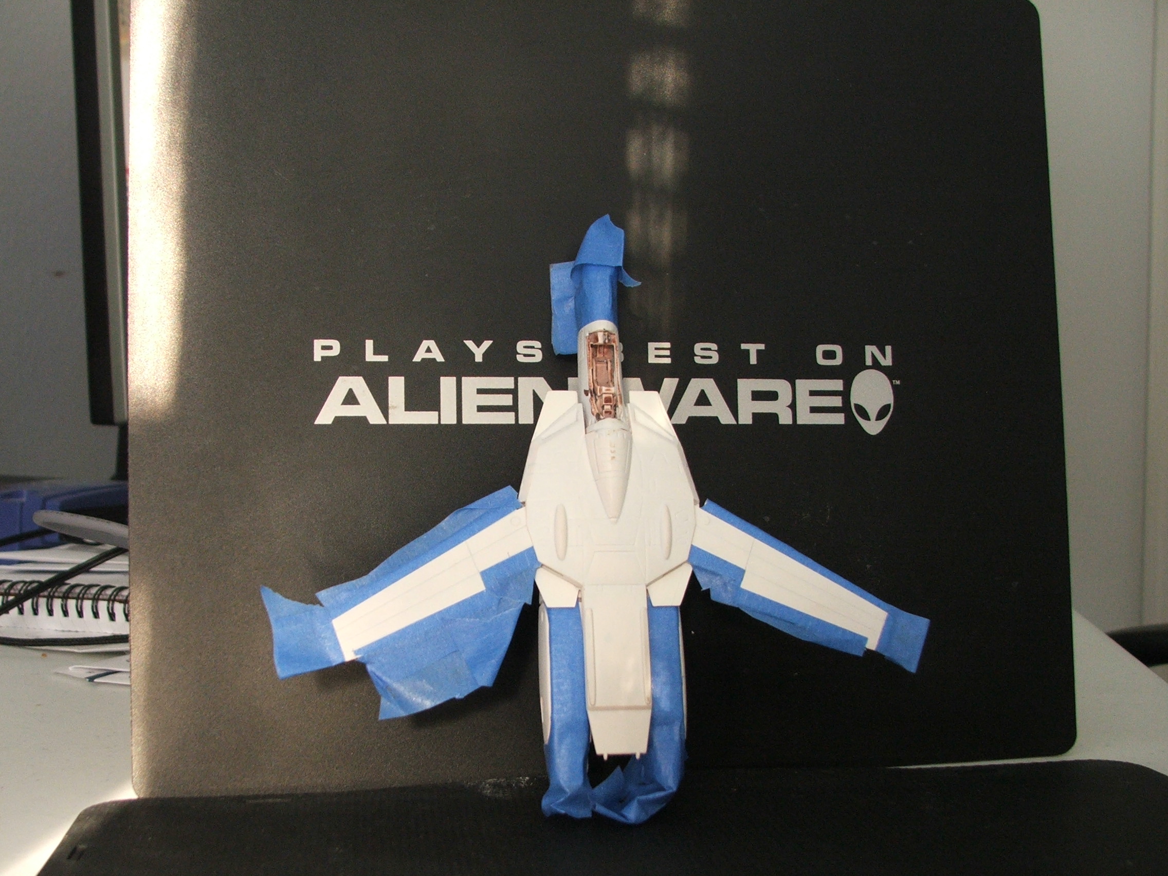

Mr. Anderson Posted March 30, 2008 Author Posted March 30, 2008 Okay . Been a lil busy but im ready to do some painting now. Did some masking today and hopefully going to shoot it with some grey tonight!
jardann Posted March 31, 2008 Posted March 31, 2008 Wooo! That cockpit looks insanely good! Can't wait to see it finished.

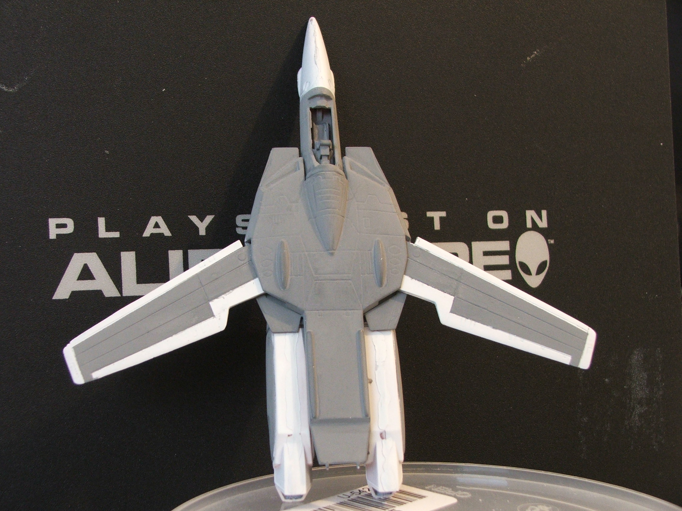

Mr. Anderson Posted March 31, 2008 Author Posted March 31, 2008 Okay so here it is. My first attempt ever at masking and then airbrushing. Turned out ok. There are some bad spots here and there, but nothing a lil touchup wont take care of. I'll have to remember from now to glue, fill, sand before I prime or paint next time I'll put some more pics up soon.
warpaint22 Posted April 1, 2008 Posted April 1, 2008 Great Job, you've done very well, congrats and thanks for showing your work.
